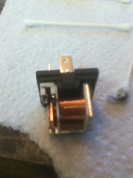

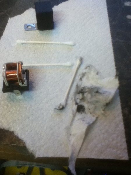

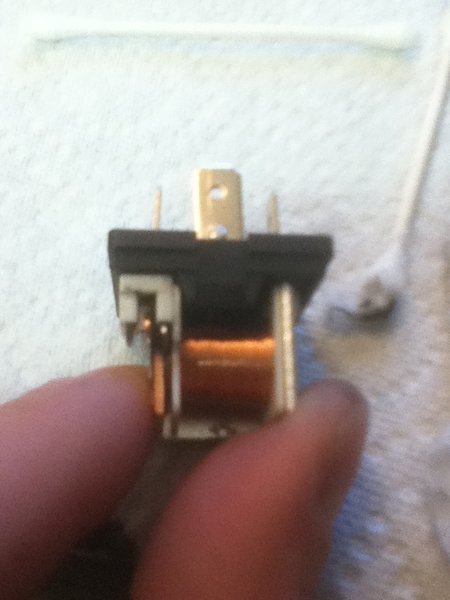

    For future searchers, this is what happens when a relay gets moisture in it. This is the relay for my light bar. I was watching FMJ when one of the city guys stopped and told me that my light bar was on. Sure enough, when I looked, it was just barely on (probably about 1/4 strength).
    When moisture gets drawn into an unsealed relay, it allows grime (dust also migrates inside) to build up on the supply contact. With enough buildup, the output side begins to get power. While it does not provide full power, it does supply some power to whatever the relay feeds.
    This is during cleaning of the contacts.
    Contacts cleaned. Notice the bar is toward the outside. Open circuit position.
    I am holding the bar into the closed circuit (activated) position. If there is buildup, it will basically bridge the contacts.
