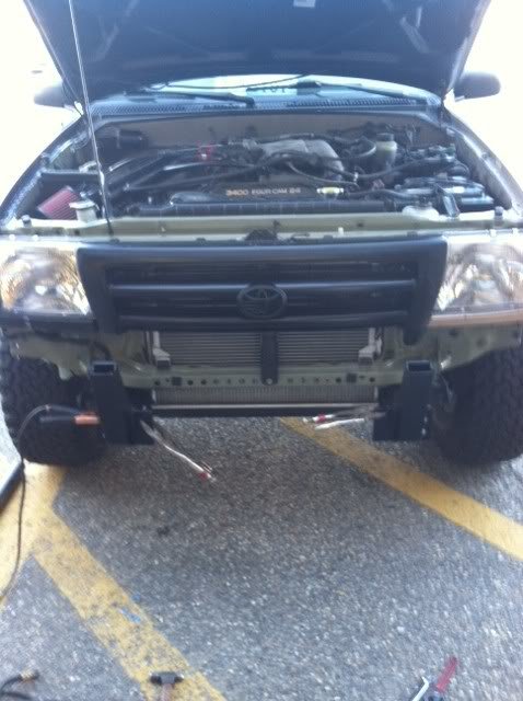

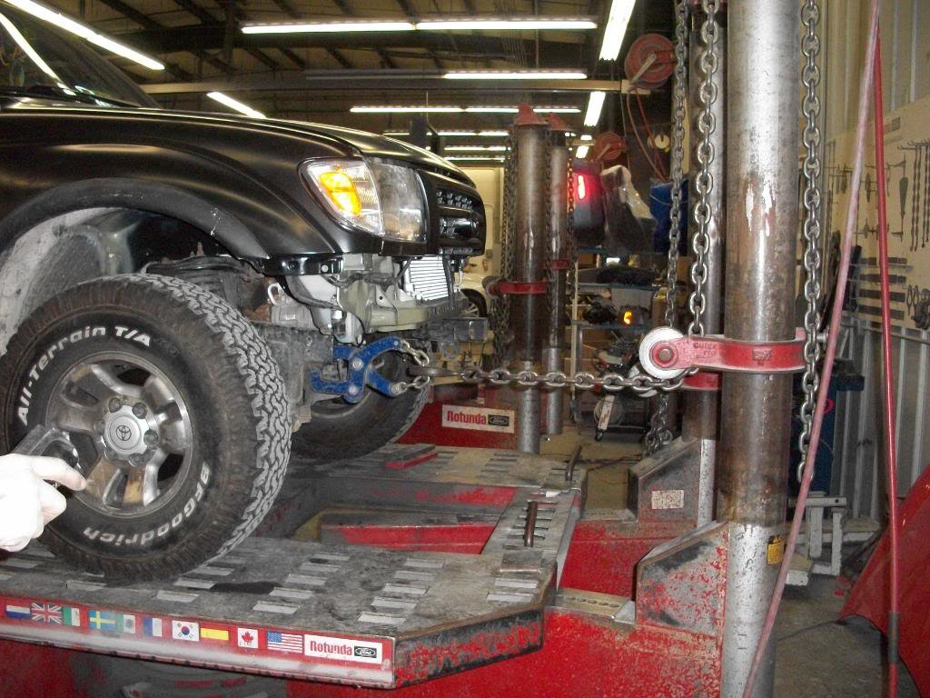

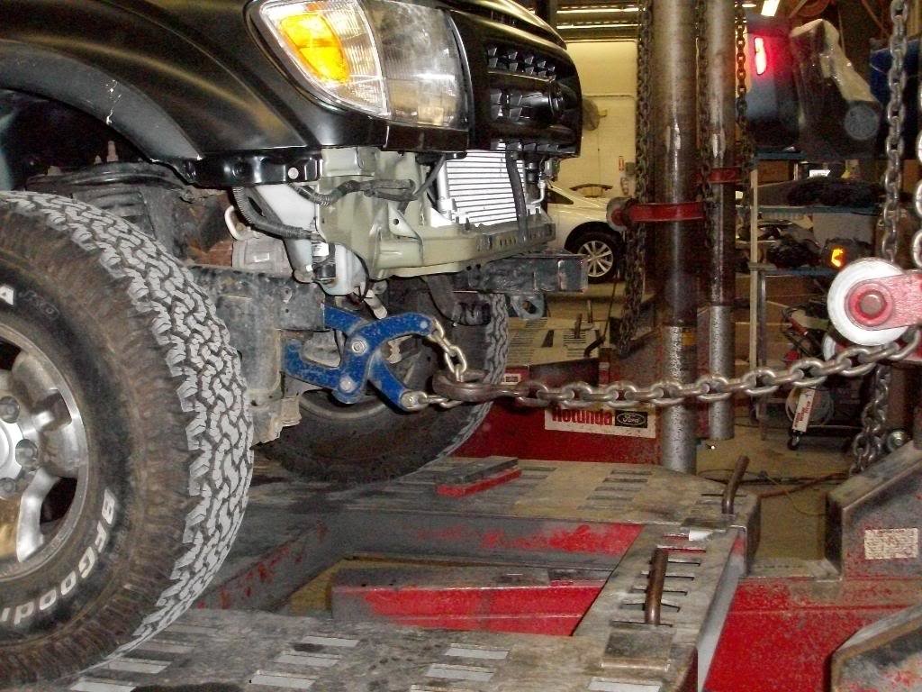

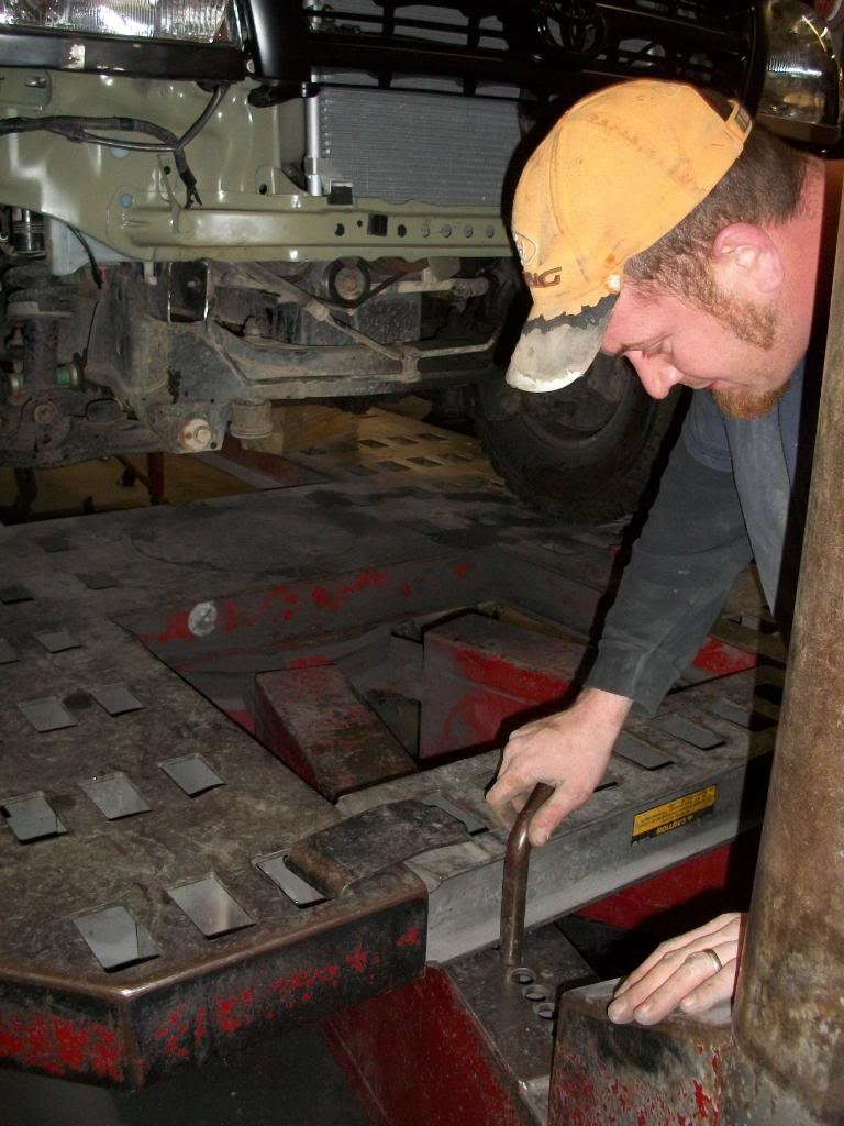

    So last night was a sucess...
    Truck goes up, antifreeze out
    Radiator out and off to frame machine
    Truck gets pinned and chained to frame machine
    Unknown buddy knows his shit as well as smokes like Dean Martin!!!!
    Measure twice and put on clamp and block suspension
    Then pull.
    seriously doesnt look like much, the pings and crackling is normal so I am told, but it sure does make a truck owner nervous.
    Again not worried cause unknown buddy is the best body and frame man in NOVA.
    Anyways we fixed the 3/4 inch shift that it needed to square it up. aligned 3/8 inch in wheel base spacing on the passengers side. welded the new frame rail section in. and was done in about 2 1/2 hours.
    Seriously dude bills out 300 hours a week in 50 hours...hes good.
    I will post as the bumper progress comes this weekend. should have from fabbed and installed except turnsignals this weekend.
    Any ideas on intergrated turn signals?? Or can you make the marker light double?? Any ideas and thought are appeciated. What do people normally do for turnys with an offroad bumper?
    Also working up a rear bumper and rear quarter rock protection this weekend to trial fit in. trying to figure out a flip down license plate with my trailer hitch hidden behind it.
    As I dont really tow anything and just the reciever for canoe rack and a tarp pole, future removable winch, I dont really mind the hitch being up 3-5". i dont know I will weld most of it this weekend as well and wing as I go.

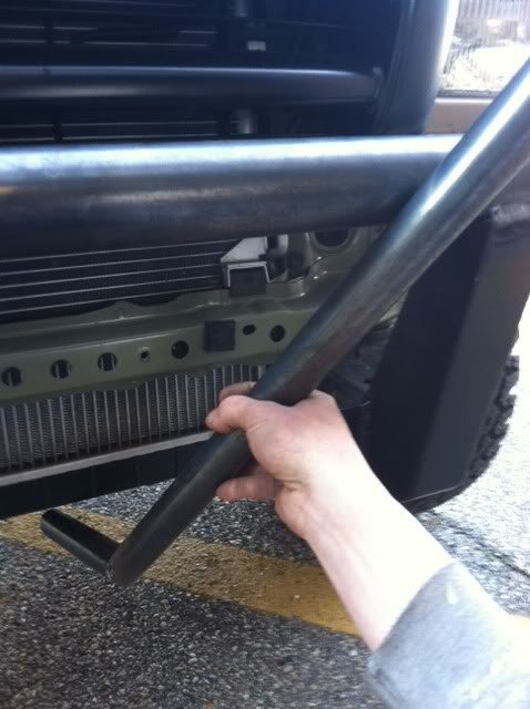

    So i started mocking up the bumper. Dang winter nights that start at 5....So ready for summer. Anyways I will try to get some pics tommorow.
    Dumped about 300 lbs of scrap off at the yard today to get the bed all cleaned out. didnt get anywhere near what it cost to replace that stuff in scrap tho!! lol. Barely enough for a 30 rack!

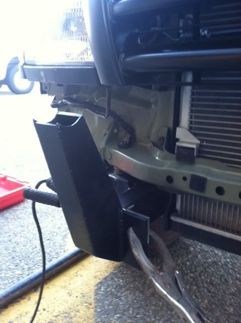

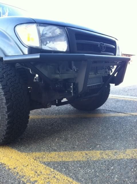

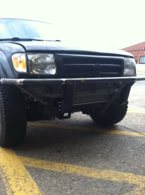

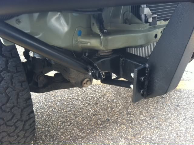

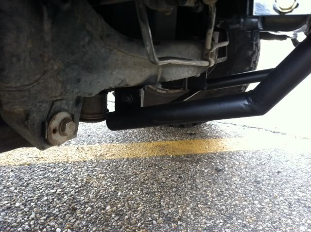

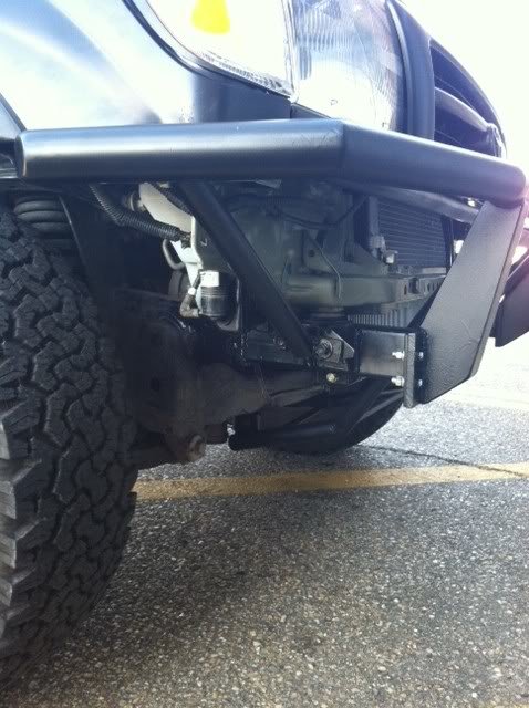

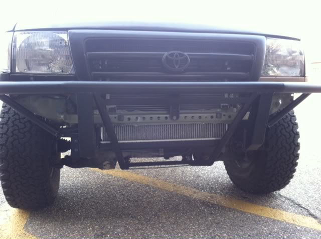

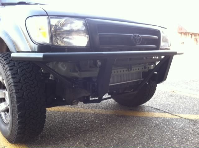

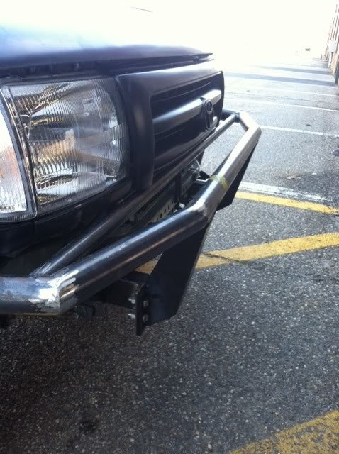

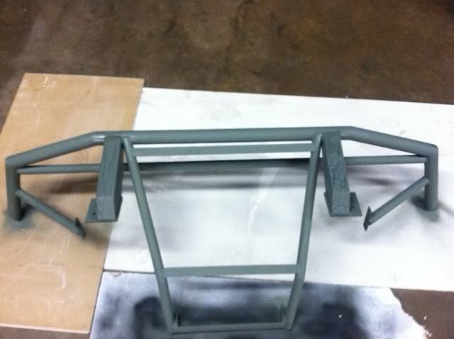

    Ok so I got some work done on the bumper...
    Started with some brackets welded on to bolt up to the upright supports I made last week.
    Next I built up the top rail tube out of some free boiler tube drop. I dont have a tubing bender so I got creative with an angle grinder.
    Next i added a cross member to be the triangle I needed for strength as well as the frame for the step/top plate I am going to be puttin in.
    Then I added some side lil arms for strength. These I tied into the original bumper mounts with a bolt on plate.
    I then added some rails that tied back into the frame again with brackets I fabbed.
    I didnt get a pic of them in while it was on the truck but I did fit them up and weld them in.
    Total so far I got about $40 in grinder wheels, paint and other materials. I got maybe 6 hrs into it as well.
    It mounts on with 10 10mm bolts and weighs only about 40lbs.
    I used 2" top tube and 1 1/4" heavy walled rails and supports. The reason for choosing this material is because it was free_ I either found it in a recycle metal dumpster somewhere on Quantico Marine base or out scrap bins in my shop. I did buy a piece of 1"X1/8"X6' piece of flat bar for some tabs for the aluminum skid plates I am making tommorow.
    I am getting it primered here
    I have to back to work tonight for a couple hours and will paint it rattle black then.
    In the primered pic you can see the skid plate brackets and the rails for it as well.
    Should have the skiddy done tommorow as well as mounting both the bumper and skids.
    this week I will be working on the sliders and rearbumper. Just getting wore out with work and play.
    Anyways I will try to post up some pics of the finished product tommorow

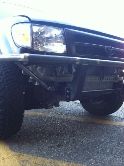

    Put the bumper on. Got my skid plate cut bent and painted but it was getting dark so no pic of the skid plate. I will install it manana. And of course take pics and post. I will be home with a real camera tommorow so I can take some really good shots
    If you look hard enough at all the bumper threads on here you can see the ideas I used for my frankensteined bumper I made. I used about 4 other bumper builds. Thanks guys for the help and inspiration.
    Working on either the sliders or the rear bumper tommorow night, havent decided but I will make something.
    Also got a hand me down Yakima load warrior I am gonna be working on sometime. It needs some TLC and a mounting system/frame, but I will cross that creek when I get to it.
    Anyways here are some pics of it painted and on. Also some bracket pics
    And a smiling dogs approval. Hes a pain in the ass when you laying on your back looking under a truck and slobber falls on your face, but hes a damn good pup

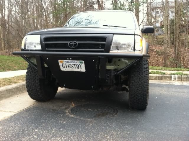

    Here is the finished product with the skid plate installed

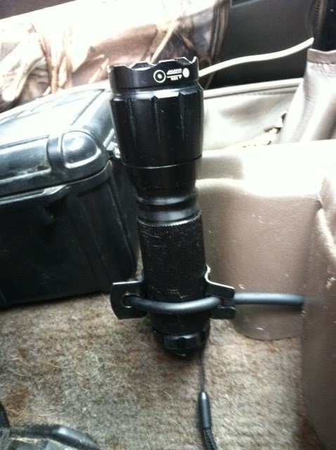

    Havent had time for much the last couple days but I did install a flashlight holder last night cause I was tired of it in my door. I just used a 1/2 inch conduit bracket and a lil rubber gasket from a boiler. nothing much but it works great. Probably didnt need the rubber, but I liked how it is like a lil stretchy strap.

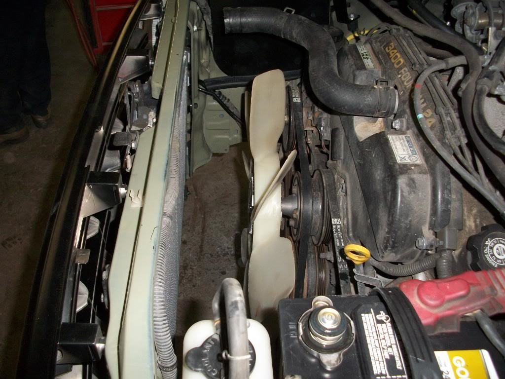

    So last night the repaired power steering belt started to sqeek. The pulley that is on it was from the accident and I straightened it as best possible. I bought 2 pumps and they were both for a 4 cylinder, even tho the vendor said they were for the V6 when I bought them. I need a pulley so bad if anyone has one or knows where to get one. Toyota wants 163 for just the pulley and 452 for the pump and pulley. At this point the pump is still good but may go south if I dont change the pulley. So if anyone out there has a pulley for a SR5 3.4L V6 power steering pump I would do just about anything cause I cant afford the 163 for it right now after all the other repairs I have done. Help!
