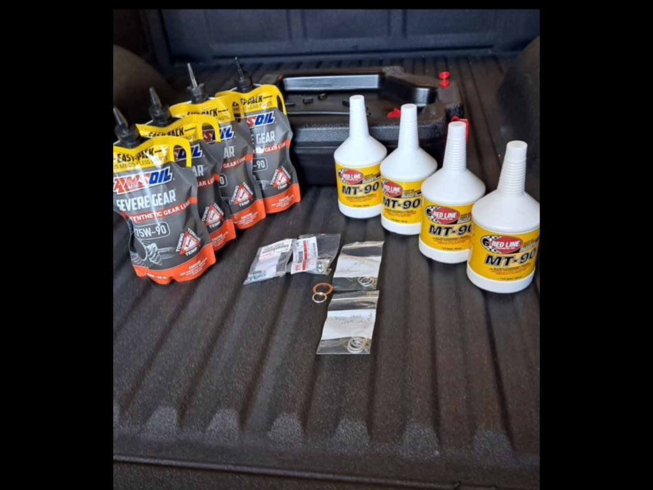

    I just changed my manual transmission and diff fluids and also recommend Red Line MT90 for the transmission and transfer unit. I used Valvoline High Performance Gear Oil 80w-90 GL-4/GL-5 in the front and rear differentials. Amazon has a good price on gallon jugs of MT-90, and while you are there, I suggest buying the Rexka 12-pieces Gasket Kit that contains the complete set of new crush washers, which you should always replace when changing these fluids. And while you are doing the fluids, don't forget to grease all the driveshaft grease fittings as part of this fluid service.
