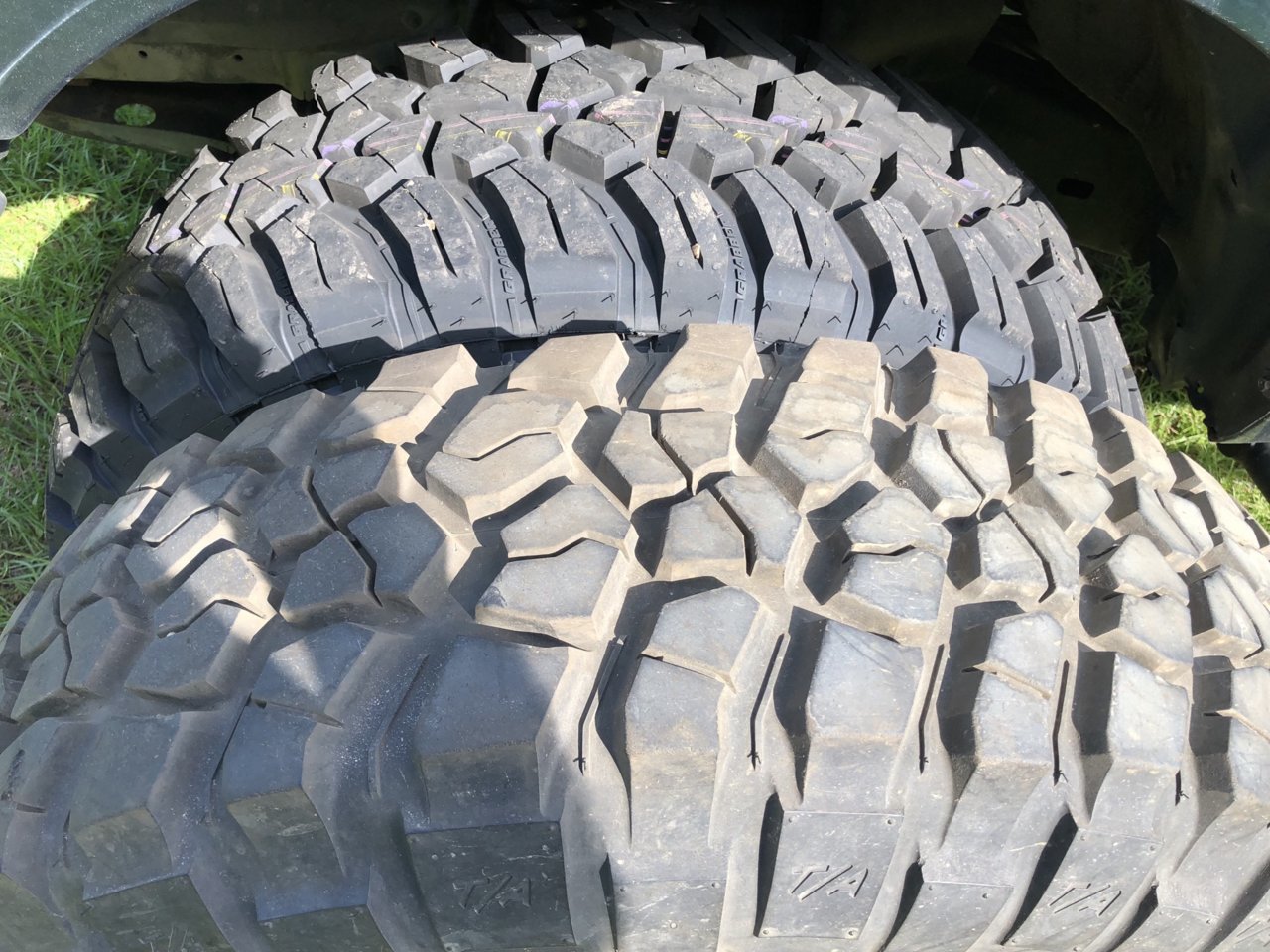

    I didn’t know they made the X3 in a 33/1050 now. How do you like them so far? Pics?

    I’ve only gotten maybe 40-50 miles on them so far but they are quieter than the same sized BFG KM2s they replaced. They look like a mirror image of he BFGs with a little bit of flair.

    I’ve got maybe 30-40k miles on these tires. So far so good for wear, wet weather, and general road goodness. Granted I have a set of 5, they still look good.

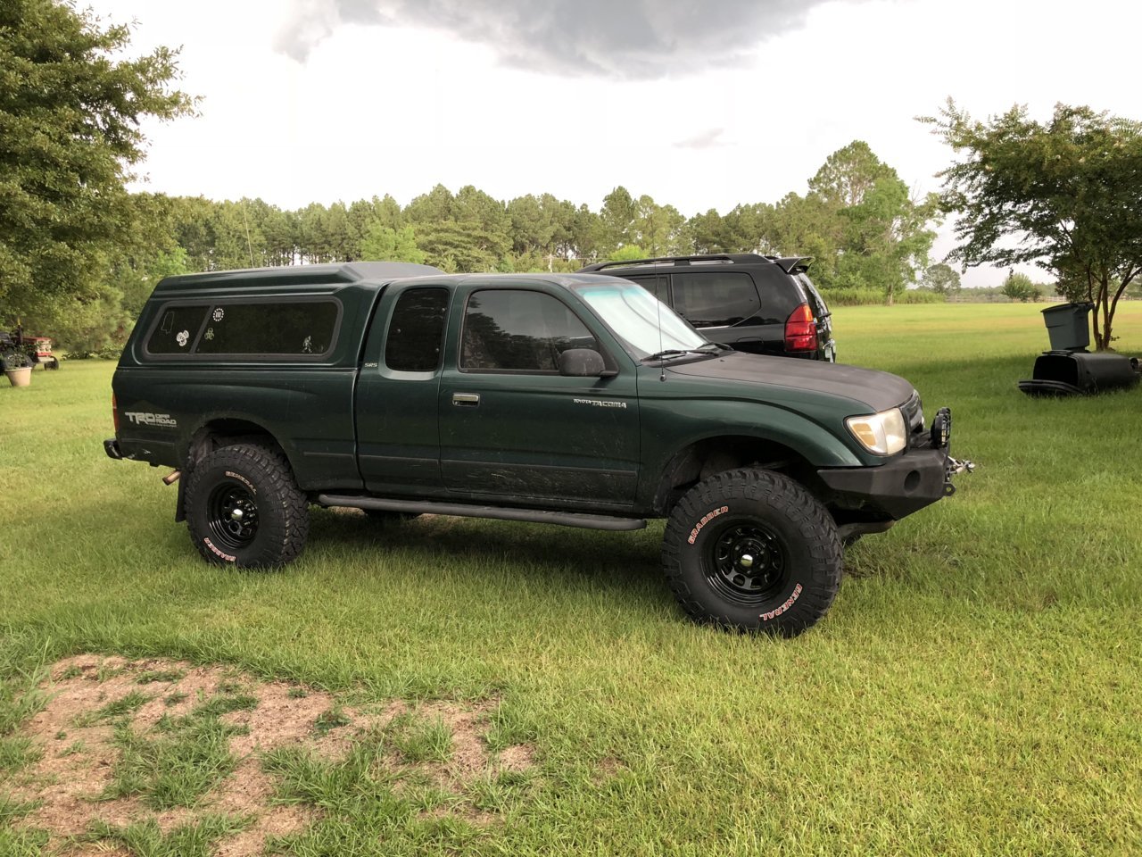

    Nice truck, I’m looking to do a slight lift and go with some pro comp wheels as well. Would I be better tire choice wise with a 15x8 or go up to a 16x8?
    Gonna stay with a 33/10.50 tire.

    Price wise, the 15” wheel. The 16” has benefits as well and I think a wider range of choices. 33/32 overall diameters and 1150 width equivalents can be found easily.

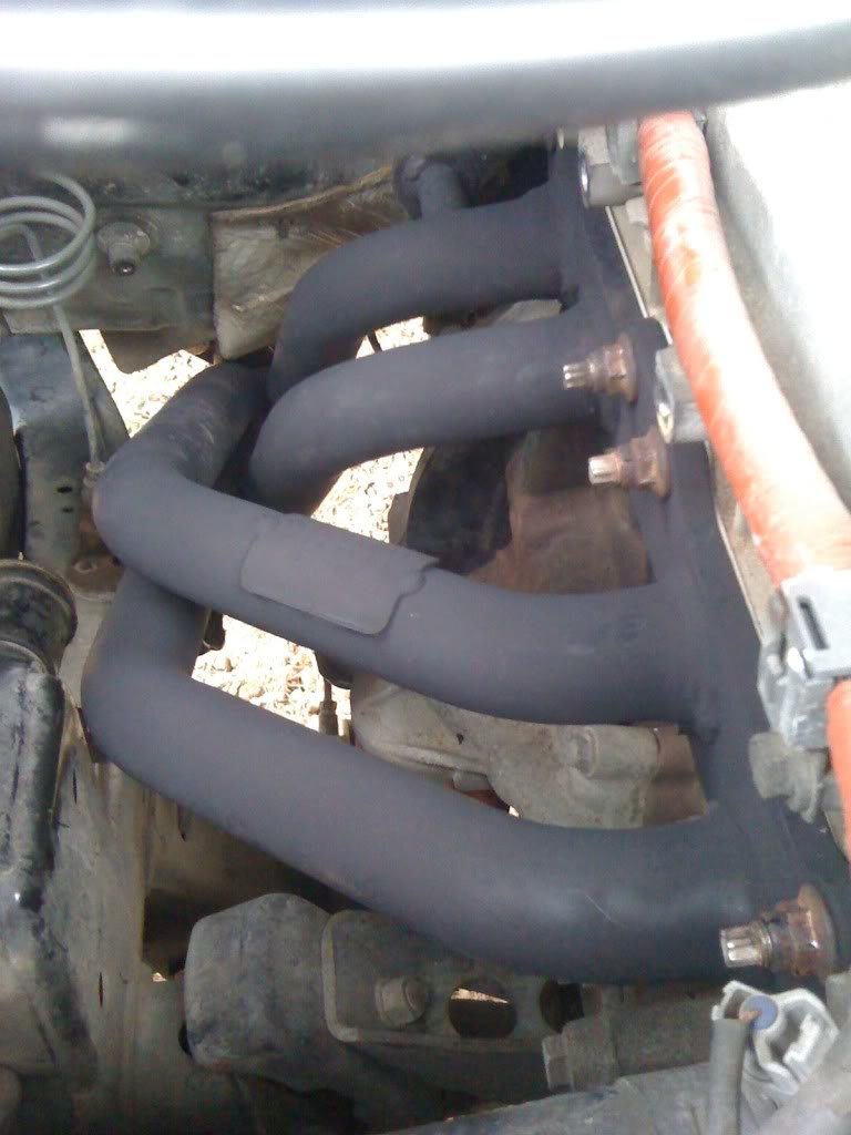

    The thread is lacking. I finally ditched the Pacesetter header because I couldn’t keep gaskets in it. I bought one off of fleaBay from Australia for a 3rz powered Prada. It looked good but had a 1/2” smaller flange. I made it work but it eventually rusted in two where it was welded together. Now I’m running another fleaBay special that so far is killing it. It’s a 2 part but uses a donut gasket like for some Honda exhausts. Cheap and plentiful but I’ve only replaced one.
    Aussie header.
    China header
