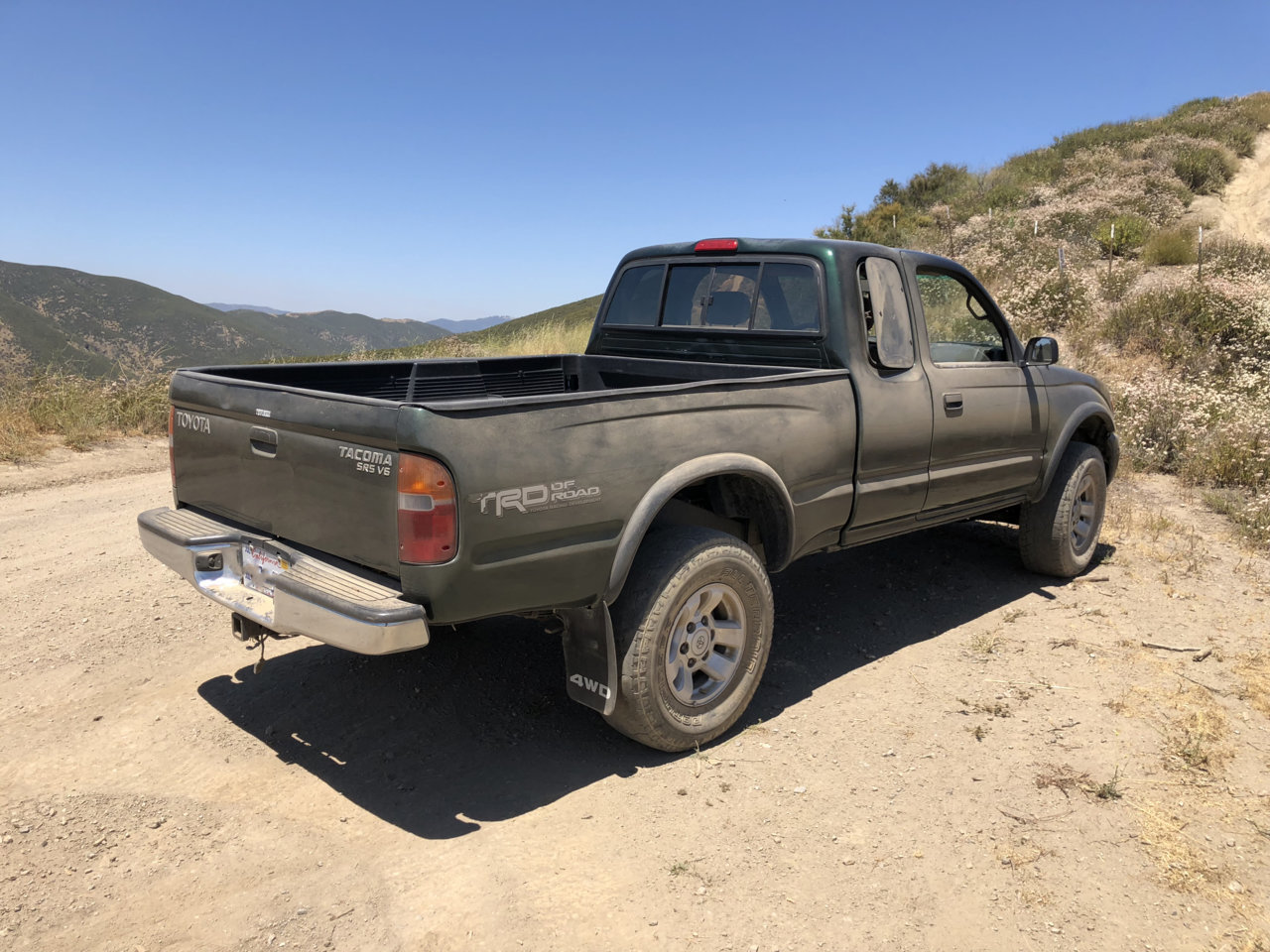

    Its too bad the clear coat is kinda hammered.

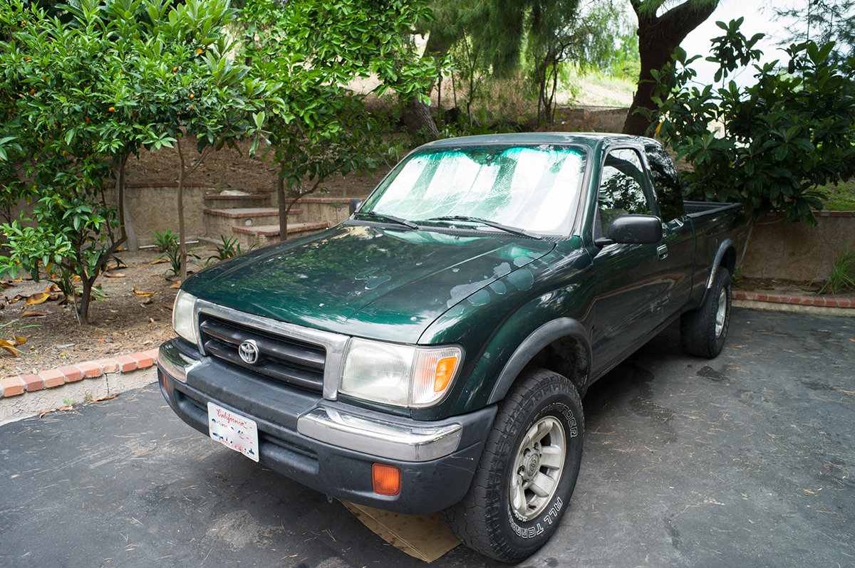

    With the first 30 min of buying it, my friend helping me scrap the tint off the front windshield. Also the seats are pretty dirty.

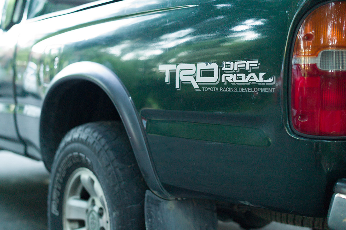

    Previous owner put on the replica door handles of the wrong color and pretty sure the wrong style/year. Went to the junk yard and got the right ones with the right screws.

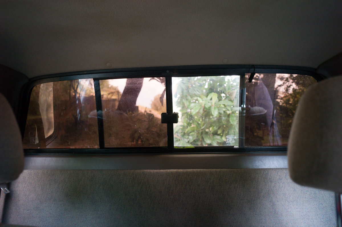

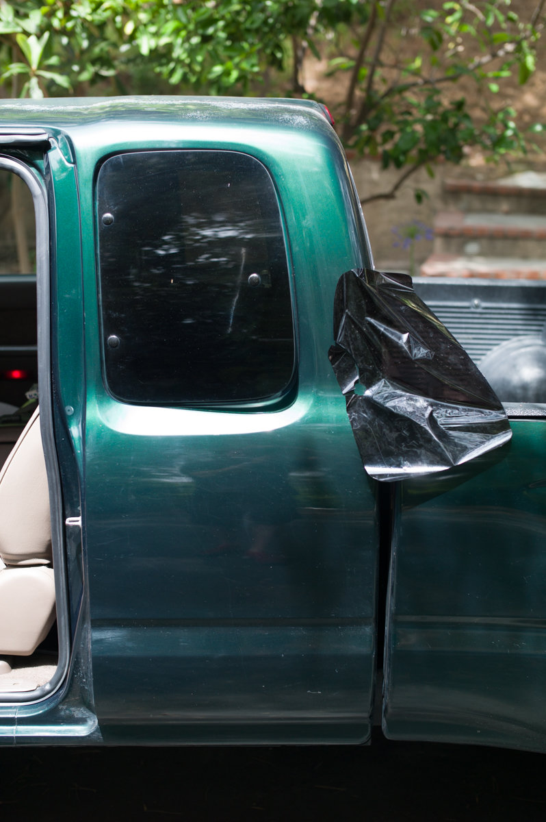

    Decided to take the rest of the tint off. It was so dark I couldn't see at night and it had a nasty brown color to it anyways.

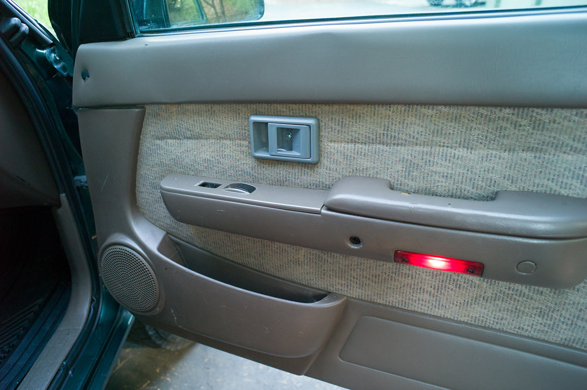

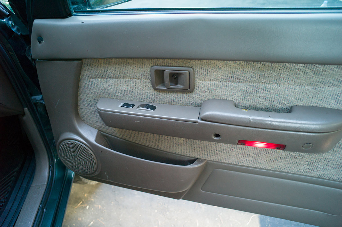

    Having a weird issue with the cab light on the drivers door (the red one). Its intermittent. Sometimes it works, sometimes it doesn't.

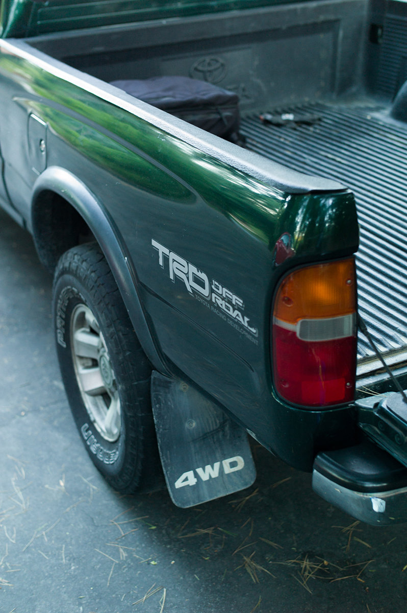

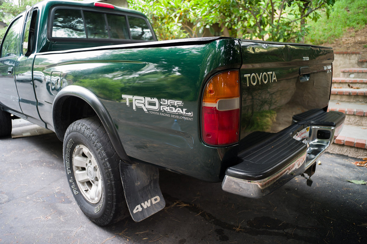

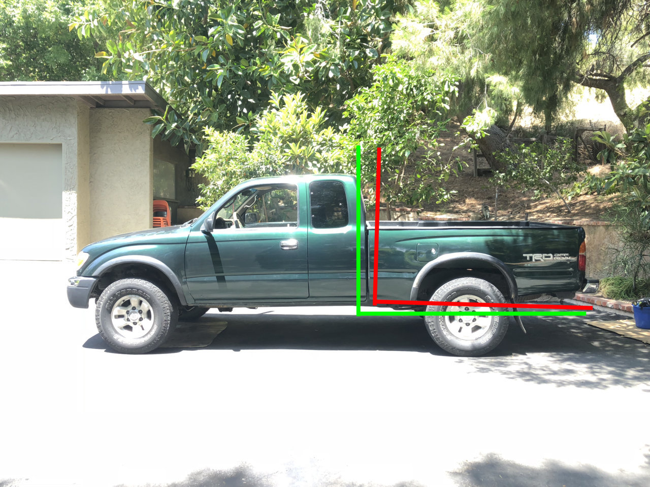

    Also trying to figure out what the bed is slanted down in the back. Ive seen some other tacos like this. I don't see any frame damage. Looks like Ill have to shim the bed up in the back to level it.

    I believe the 98-00’ trucks had the door light.
    I don’t have the wiring schematic for those years.
    So I can’t really help you there. A quick search show AutoZone has it free if you sign up for a free membership.
    The bed itself is hard to remove. I’ve had it off 3 different 1st gens. It’s been years since I had one off. Seems like the gas filler neck was the biggest thing to watch for.
    Interesting fact. The rear bumper mounting bracket can be flipped and line up perfect if you ever do a 3” body lift. I don’t really recommend a body lift. But we all live and learn. Lol. I was young, didn’t know any better, and it was cheap.
    I now go suspension lift. Even then I’d prefer no spacers.

    Thanks. I would never do a body lift. I was talking about the bed being slated down in the back. It looks like the 2 tabs where the back on the bed bolts to are slightly bent down.
    So the green line would be level and the red line in an example of what mine is. Either Ill have to bed the tabs back up or level it with shims.

    Yes, I see what you are saying.
    Shims maybe be an option. Mine did not slant in the back.
    But it was not stock for very long either, so maybe I never noticed?
    BTW, I’m still looking for that wiring diagram.
    If I find one, I’ll try to take a look and see how the door light operates.

    Took it out on its first off roading since buying it. Did pretty well, especially with fully bald tires. I hit 2 decent hills and it did well. Thank god for the locker though.
    Probably shouldn't of compounded, polished and waxed the day before.

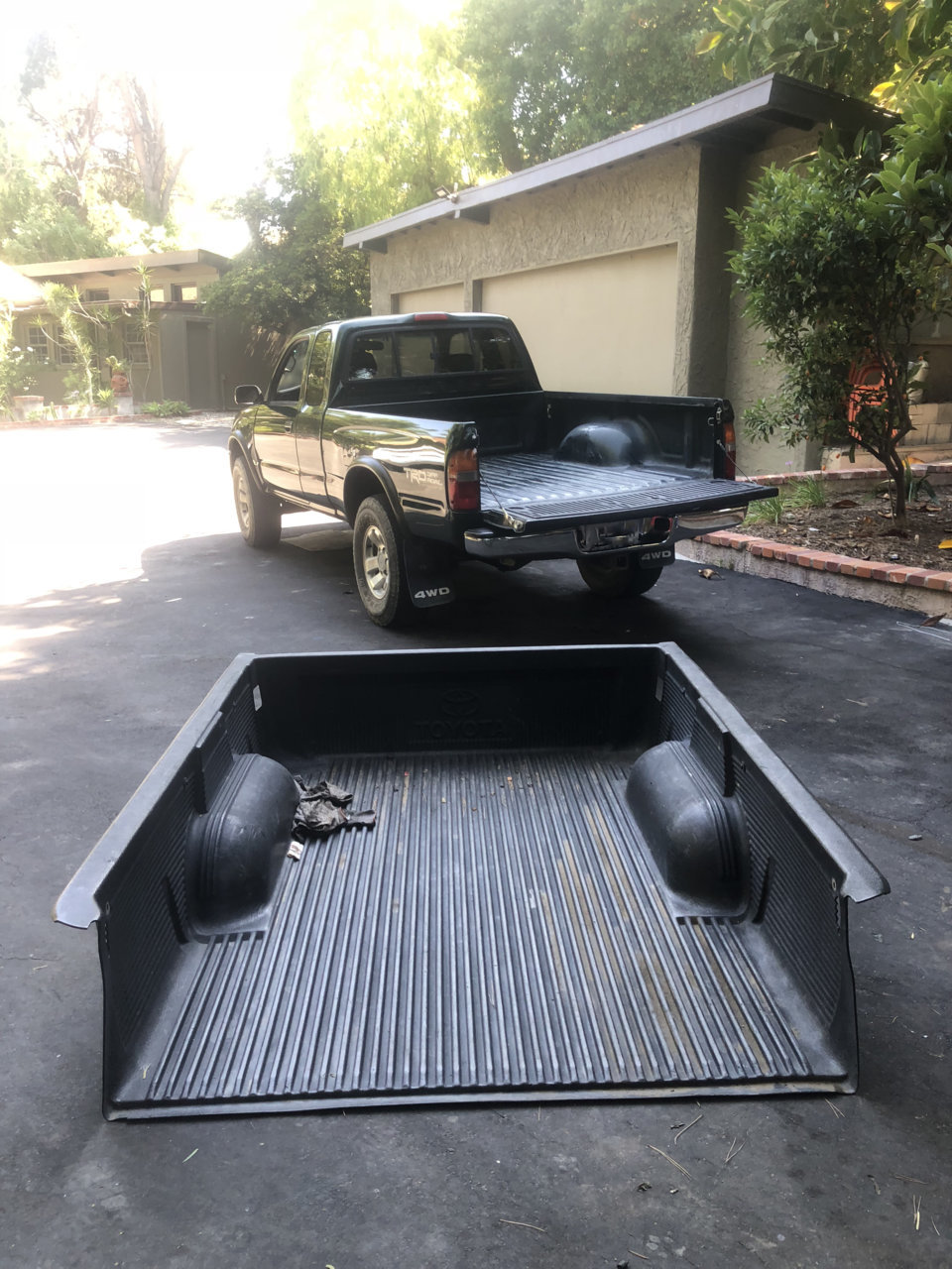

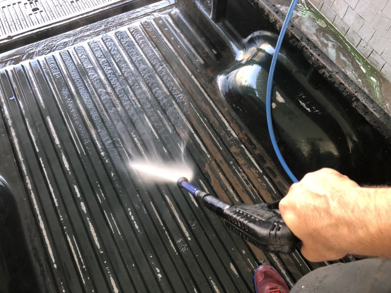

    Took the bed liner out and there was an entire 5 gallon bucket of dirt, hay, screws and random stuff. Forgot to take a photo till I was almost done.

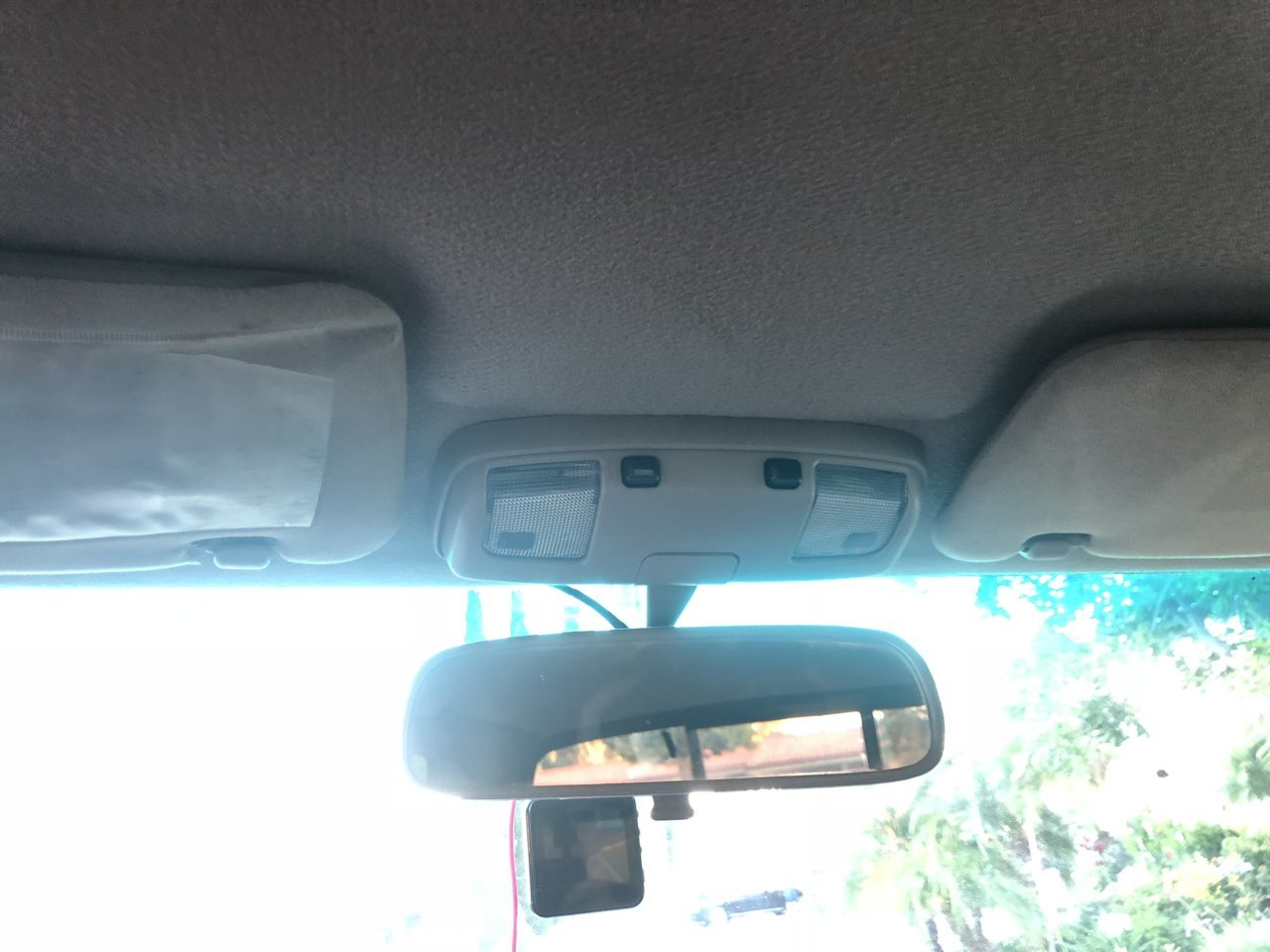

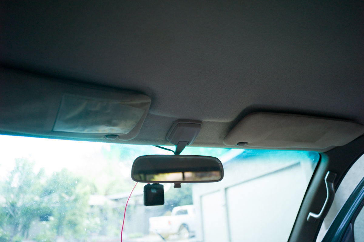

    Swapped in a 4runner map light. It wasn't till after I bought the part that I found out they also made one that functioned as a dome light (3 switch). Oh well, might swap that another time.
    Was fairly easy. Used a coat hanger and sent it through where the dome light is then pulled the wire back. If you use this type, its only 1 wire, the body of the light acts as a ground. You have to cut the headliner but the cut outs in the roof are there for this light. If you remove the mirror you will feel them and you can use them as a guide of where and how much to cut out of the headliner.

    That’s pretty cool. Probably something I would have done to mine, if I had known about it.
