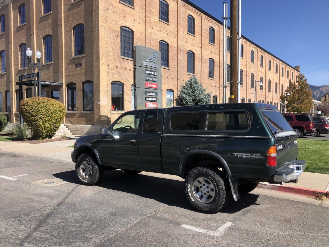

    I found a Jason camper shell in Salt Lake. It was in so so condition for the money, but I picked it up anyways because the green is kinda hard to come by. The sliding window was broken out, the trim
    all the way around was missing, the shocks were worn out and the keys were missing. I slapped it on there with some ice tongs.

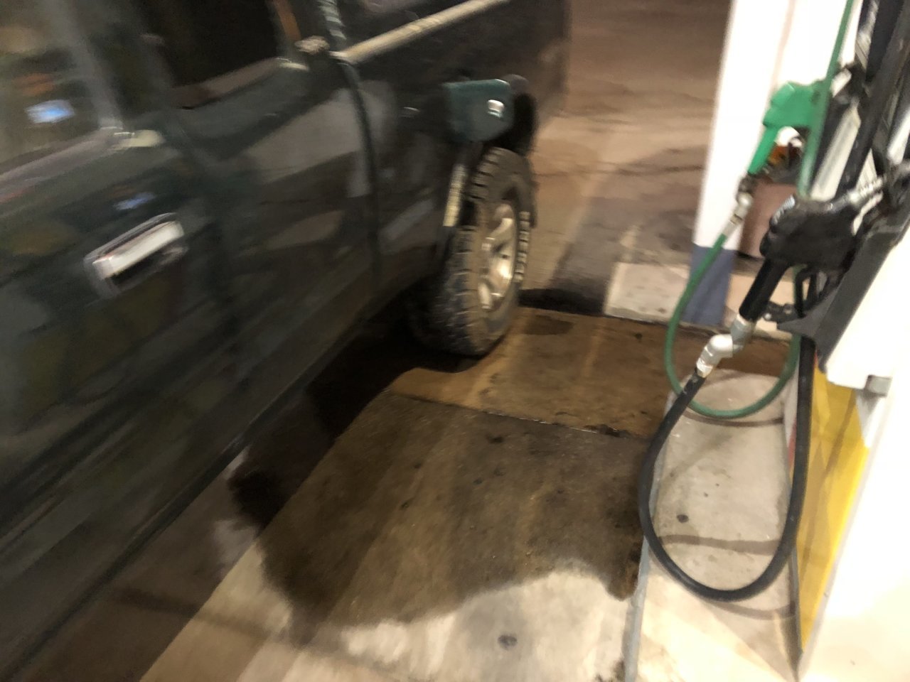

    Found a gas station in AZ where the pumps dont shut off. There were puddles at a few of the pumps. The girl at the register had me already pissed off.
    I stood at the register trying to buy water for almost 5 min while she was telling her co employee some lame story. Then claimed she gave me too much change after. Mean while the pump in pumping gas on the ground.
    They wouldn't refund me so I turned their ass in to EPA.

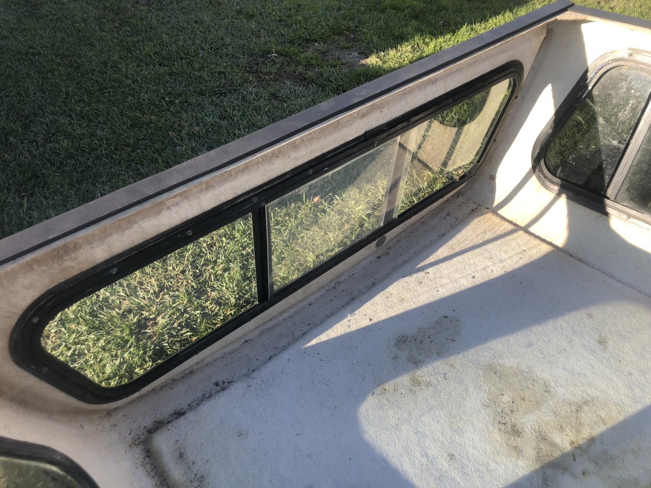

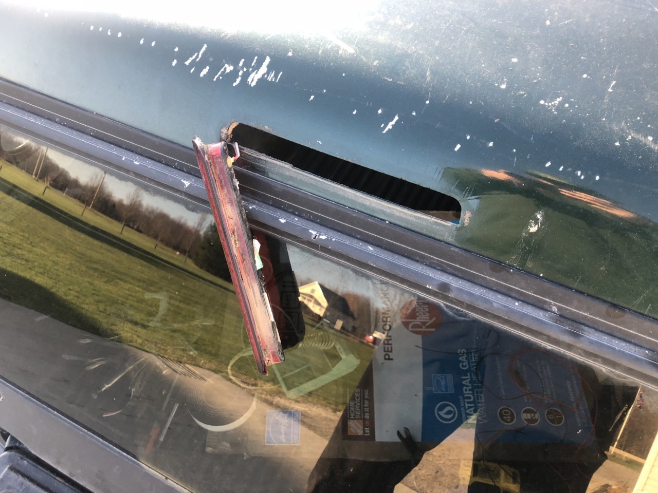

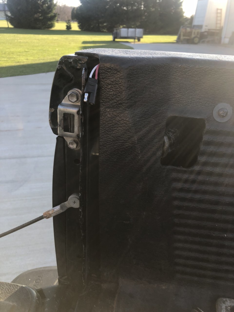

    Pulled the shell off when I got back to add the gasket and hook up the 3rd brake light.
    Added the gasket and put in a piece of acrylic where the broken sliding window was.
    Ran the wires to the 3rd brake light on the shell.
    Also the 3rd brake light was leaking water, so I fixed that too.

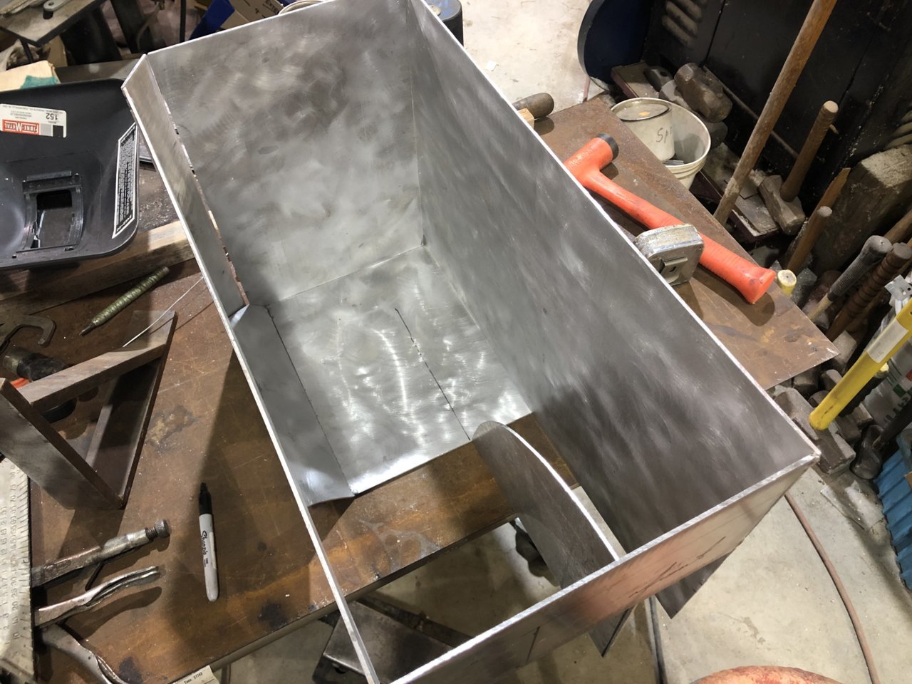

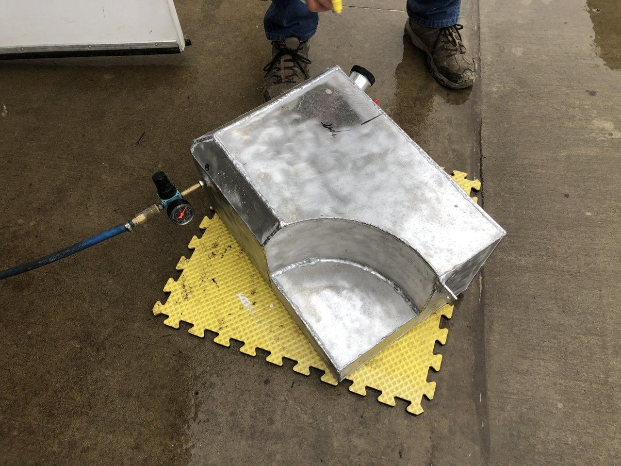

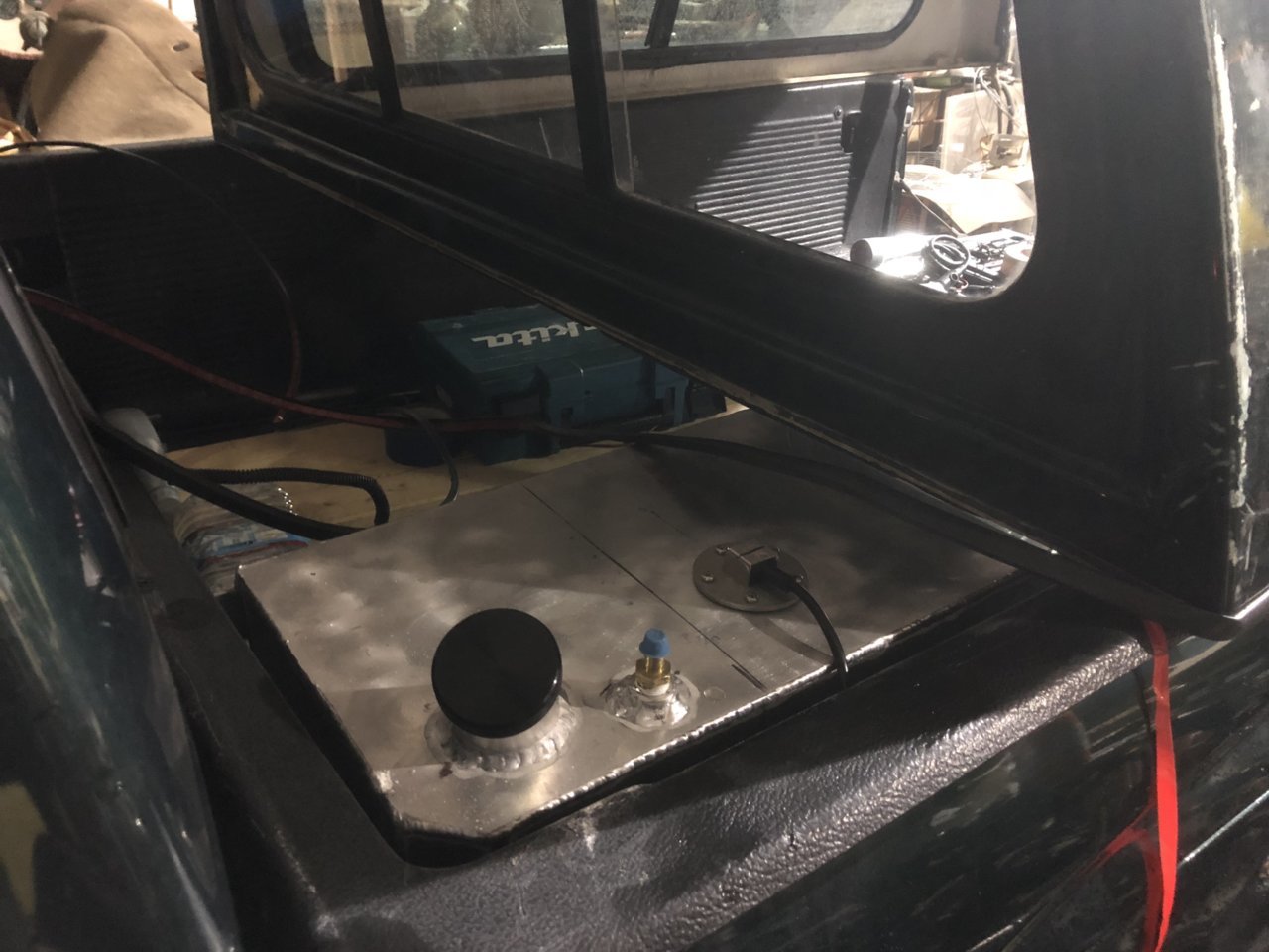

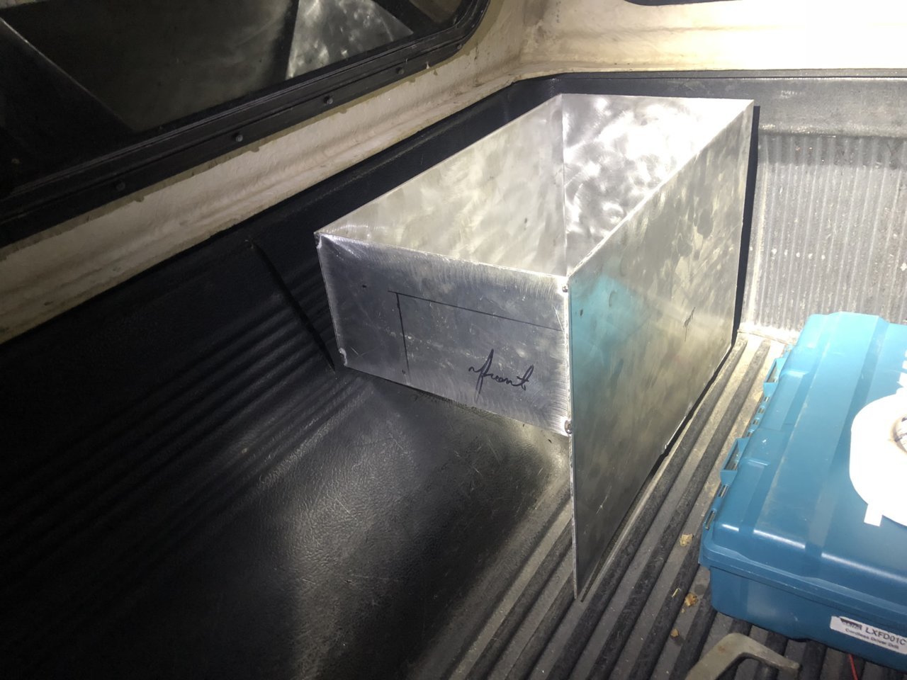

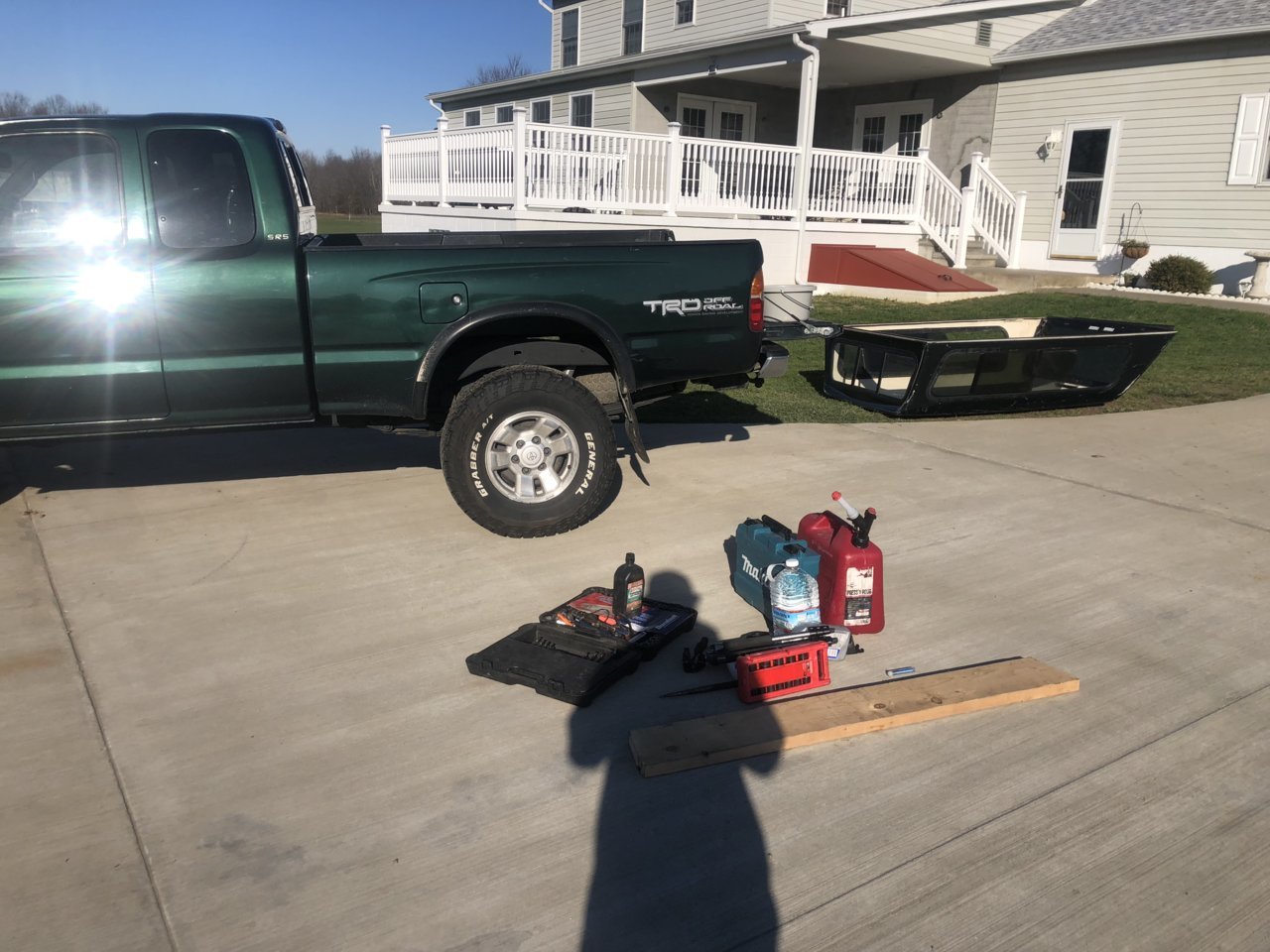

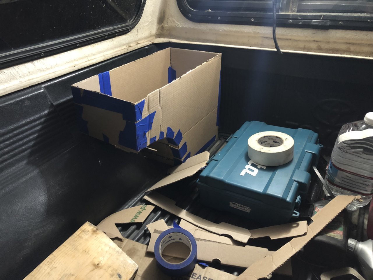

    Also kind of tired stopping for gas every 280-300 miles.
    So I started mocking up a tank.
    Trying to find a spot to put a filler.
    lowmower likes this.

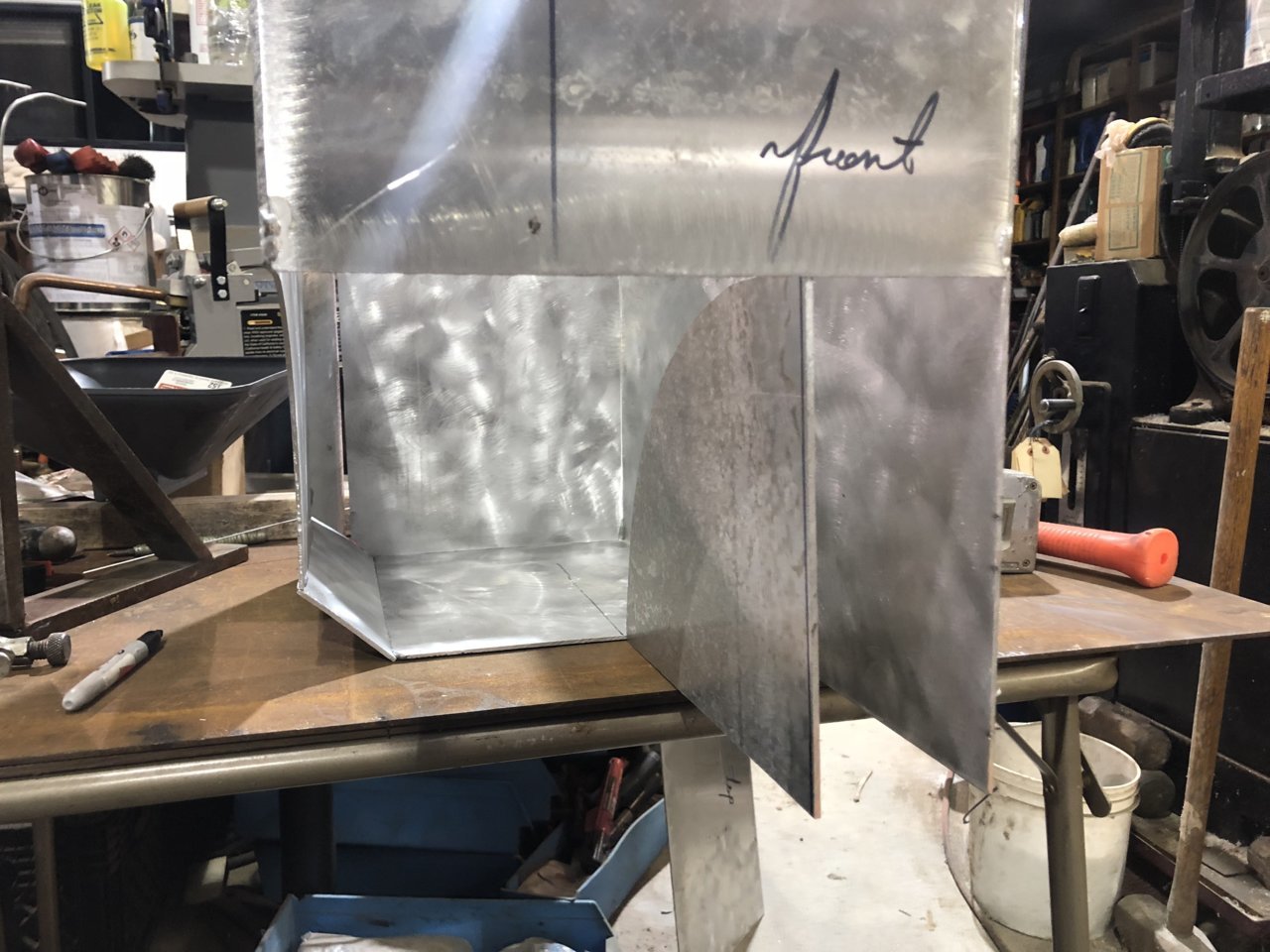

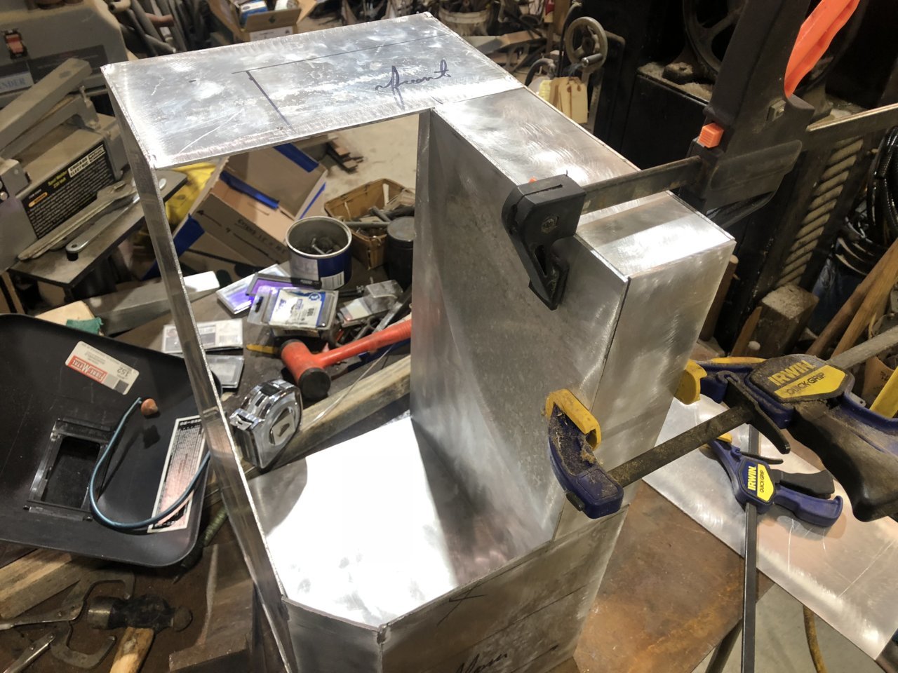

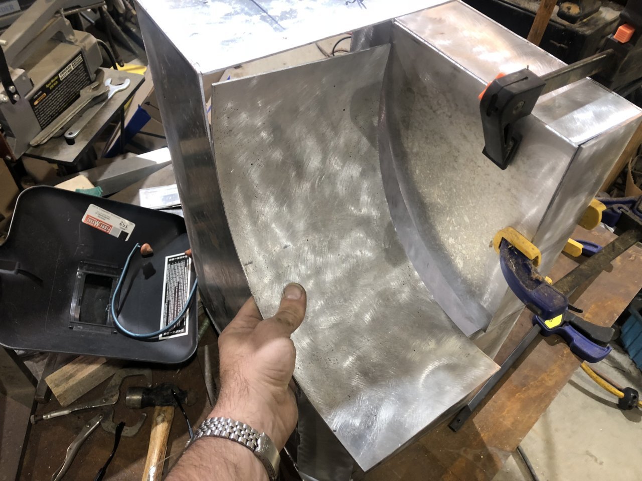

    Got a good bit of info off the cardboard one. I ended up going a little bigger to gain more volume.
    Should be about 10 gallons. I didn't want to go to big. I just wanted to extend my range another 150 miles.
    Then started with the real stuff.
    I have a bed liner in my truck so I had to account for the tank not wanting to sit against the walls of the bed because the bed liner is so dished out in the corners.

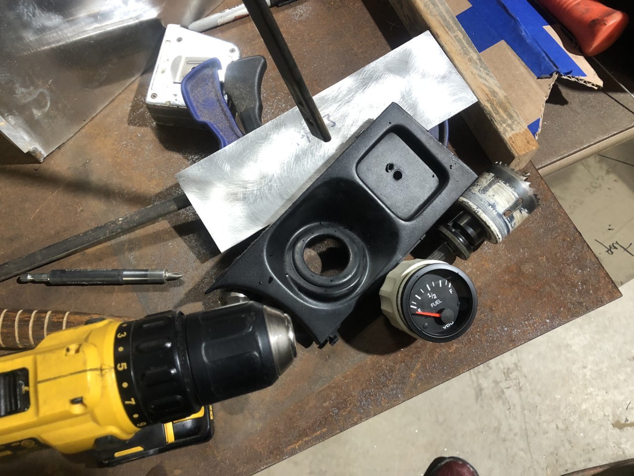

    Map Lights, Grey Wire Mod,

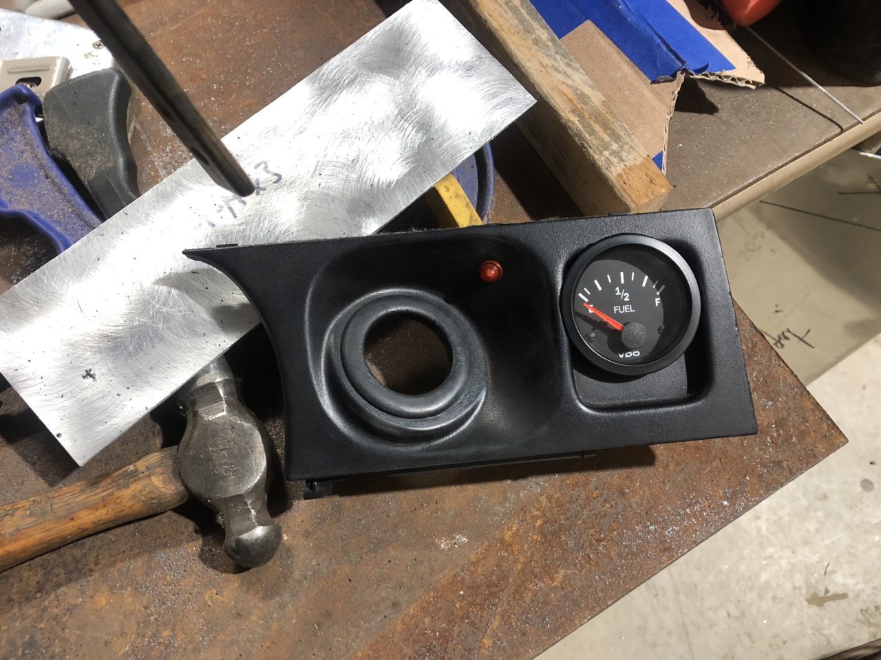

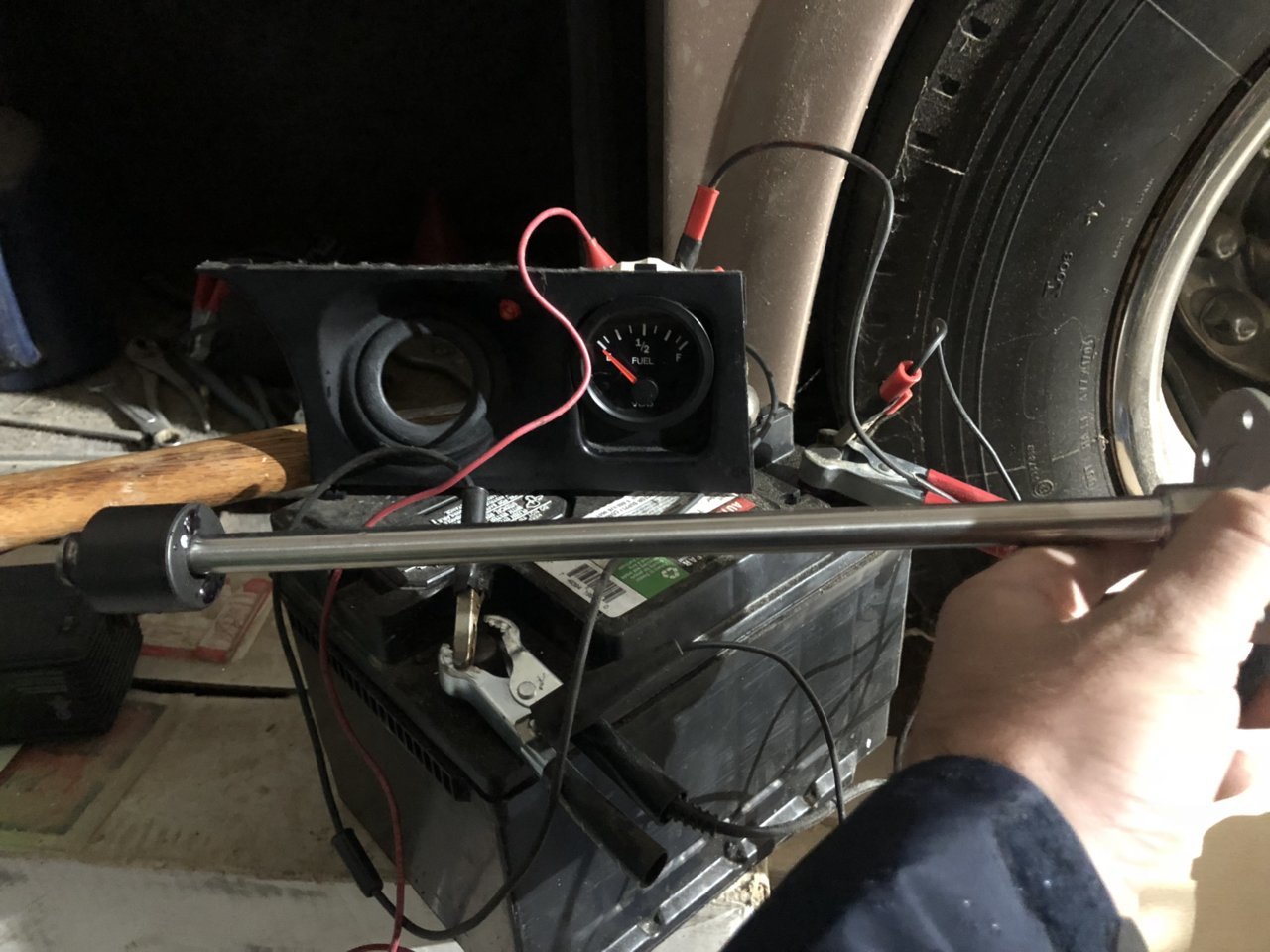

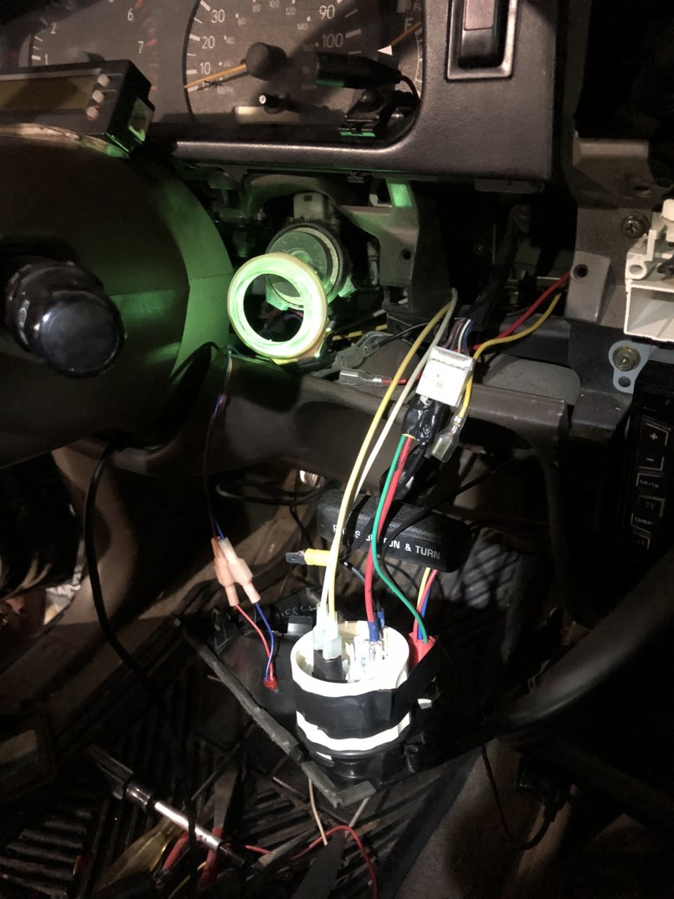

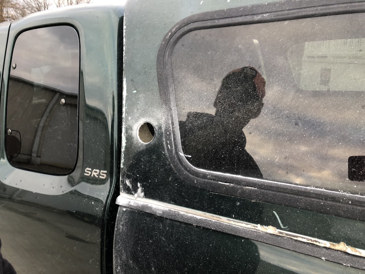

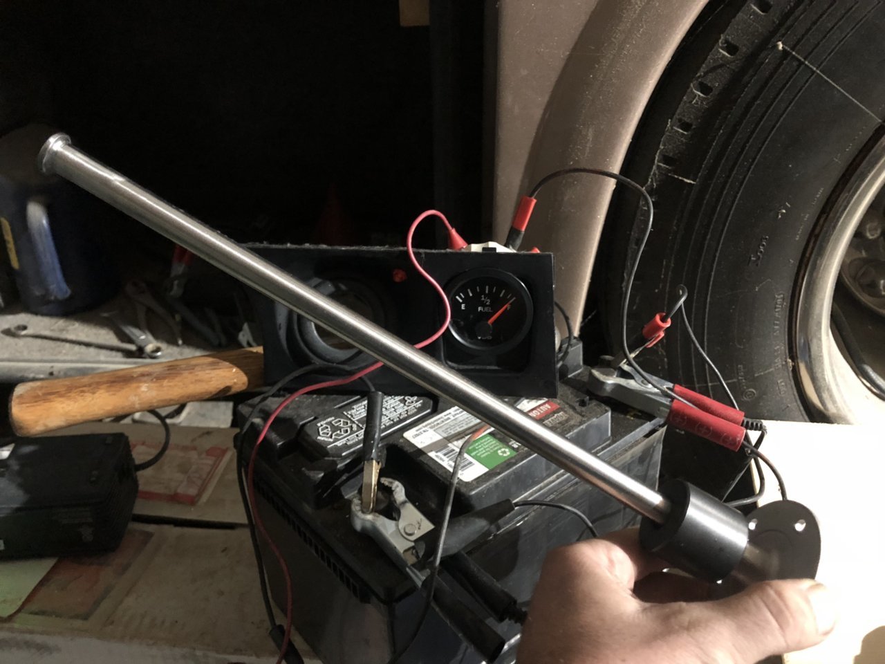

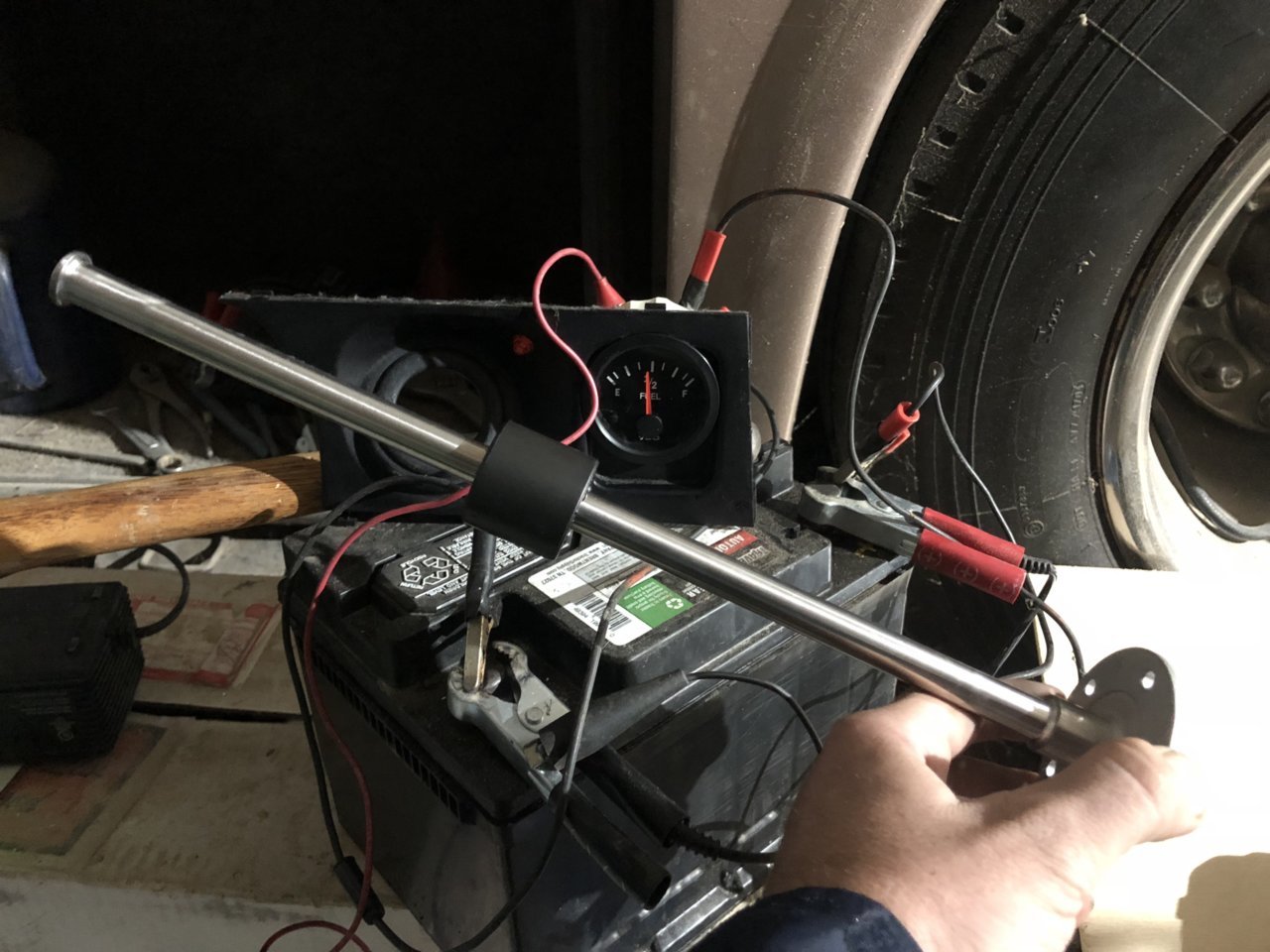

    My truck didnt come with a clock so that was a good place for the switch and gauge.
    Also relocated the alarm light.
    I bought the correct size sending unit to fit the tank. Tested it to make sure it plays well with the gauge of a different brand.
    robm7 likes this.

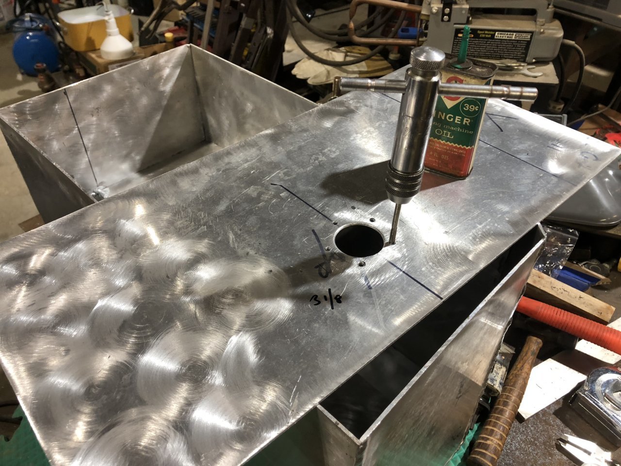

    Tapping for sending unit.
    Working on getting gauge and switch hooked up. Lots of connections.

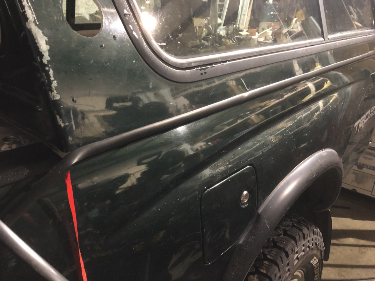

    Cut the shell for the filler. Went a little higher than I wanted.
    Pressure testing for leaks on the welds. Too many welds. Found 5-6 leaks.

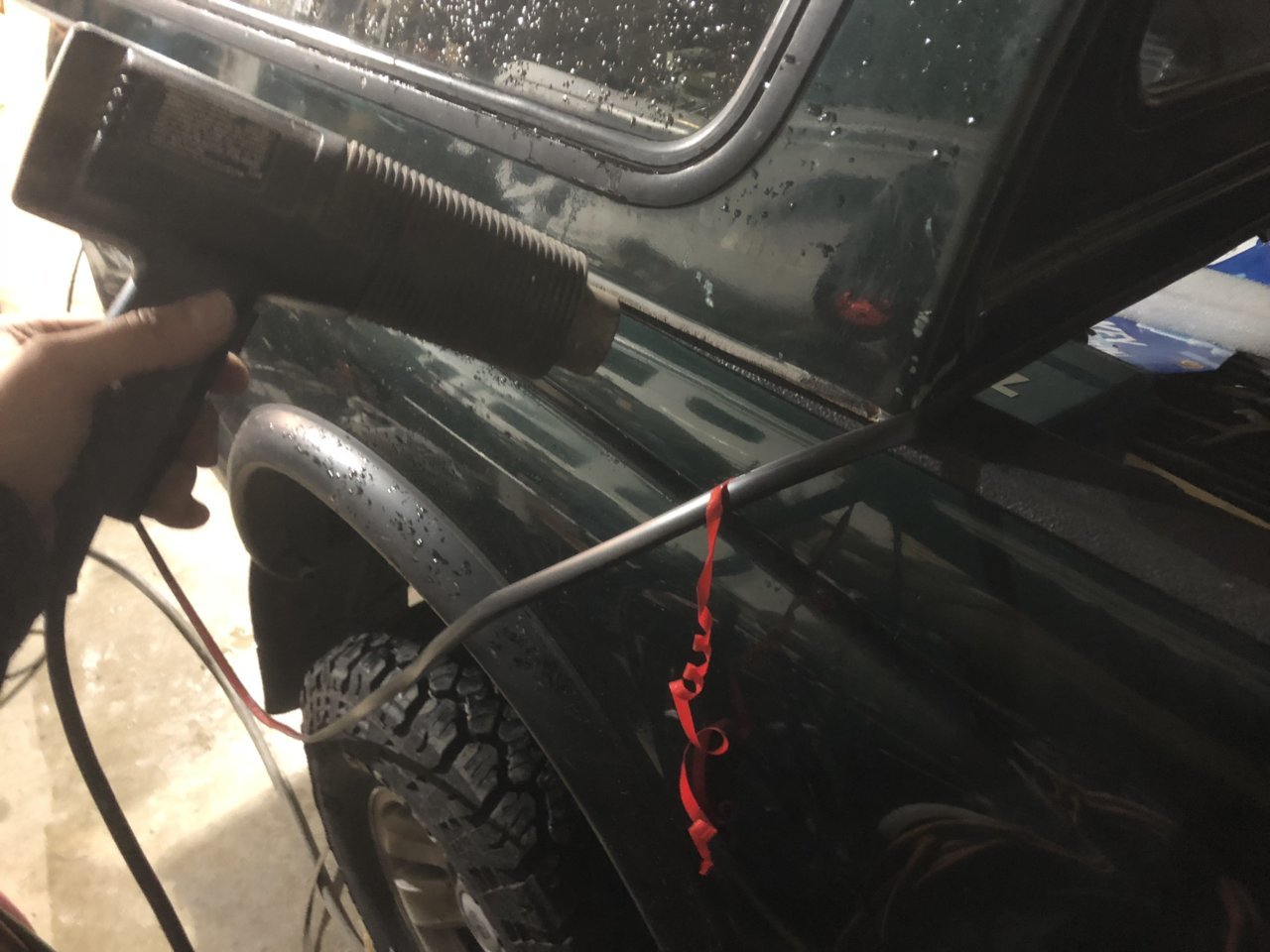

    Some where is the middle of all this. I replaced the shocks on the camper shell / cap and got a set of keys.
    Then I got some trim. It really didnt want to go on. It wasnt sicking at all and the memory of the trim being balled up in shipping didnt help. So I had to use a heat gun.
    Was a little worried about using a heat gun for the trim near the tank, but I figured this life is getting kinda old so I did it anyways.
    As a side note, the black line on the tank is the baffle inside. I didnt get a picture of it.
    The tank hook up is almost done. I need to finish it tomorrow. The hose I ordered for the filler neck isnt big enough so I have to figure that out, need to run the vent, hopefully into the
    factory vent line and mount the filler door to the shell.
    So far its all working. Its setup as a gravity feed and has a solenoid to dump it. Did a test dump into a jug and it
    seems to work pretty good.
