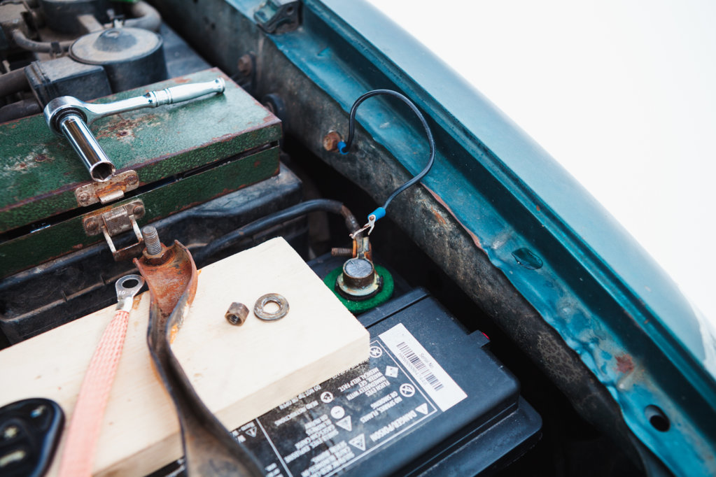

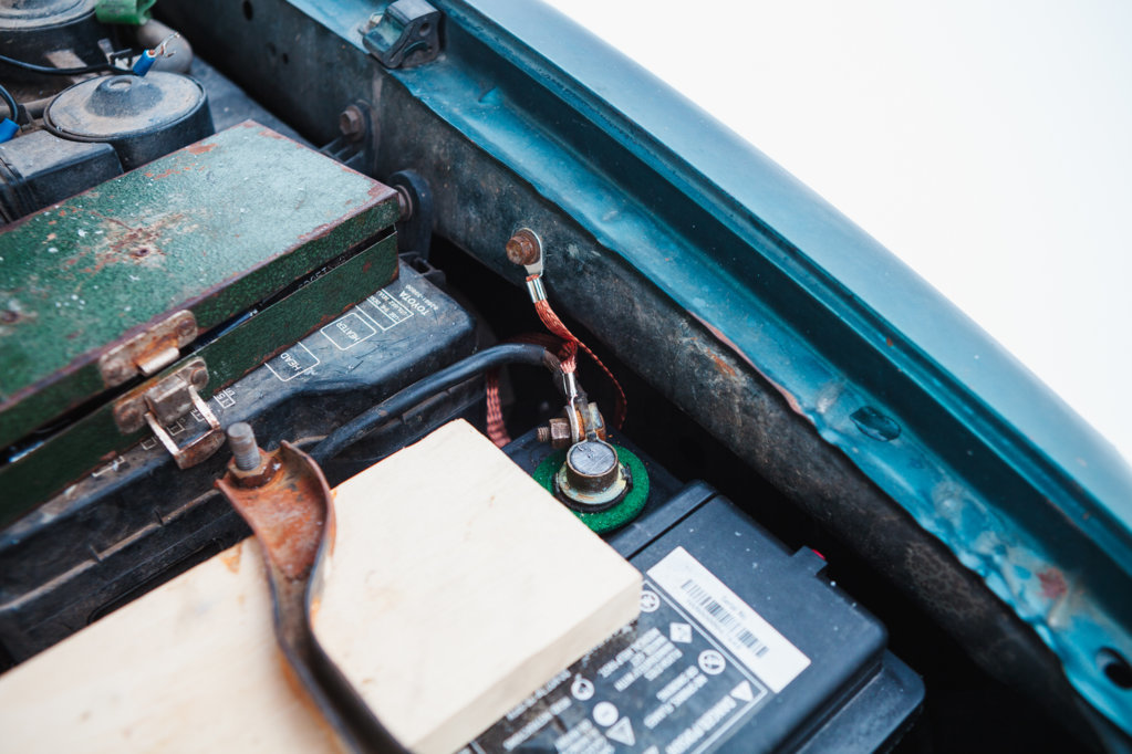

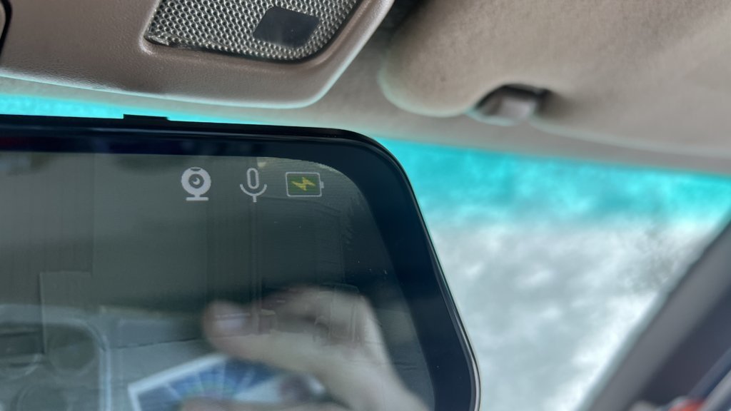

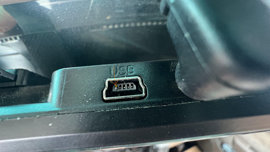

    Back to the mirror not working. Was getting kind of frustrated with not figuring this out. Luckily I looked on the top at the usb connector. The pin all the way to the left was towards the back of the connector, when the rest of the pins were towards the front of the connector (I didnt get a before photo). So I cut a small piece of twist tie wire and jammed it in there, forcing the copper pin forward like the rest and it works now with the original cord. The cold must of broke the solder joint.

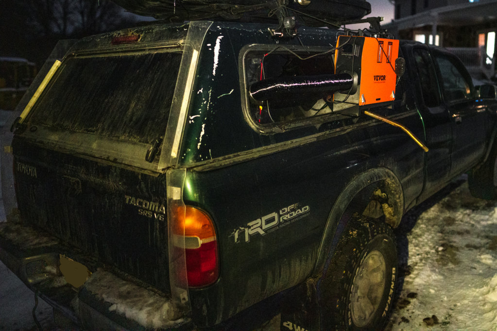

    Was also messing with the diesel heater to see how long the battery lasts for and its not great. For an item that is kinda sold as a survival item, it seems to be really picky about voltage. I dont have the greatest battery for it, but Ithought I could get 24hr run time on low out of it. Not sure if the wire are too small or what the problem is.

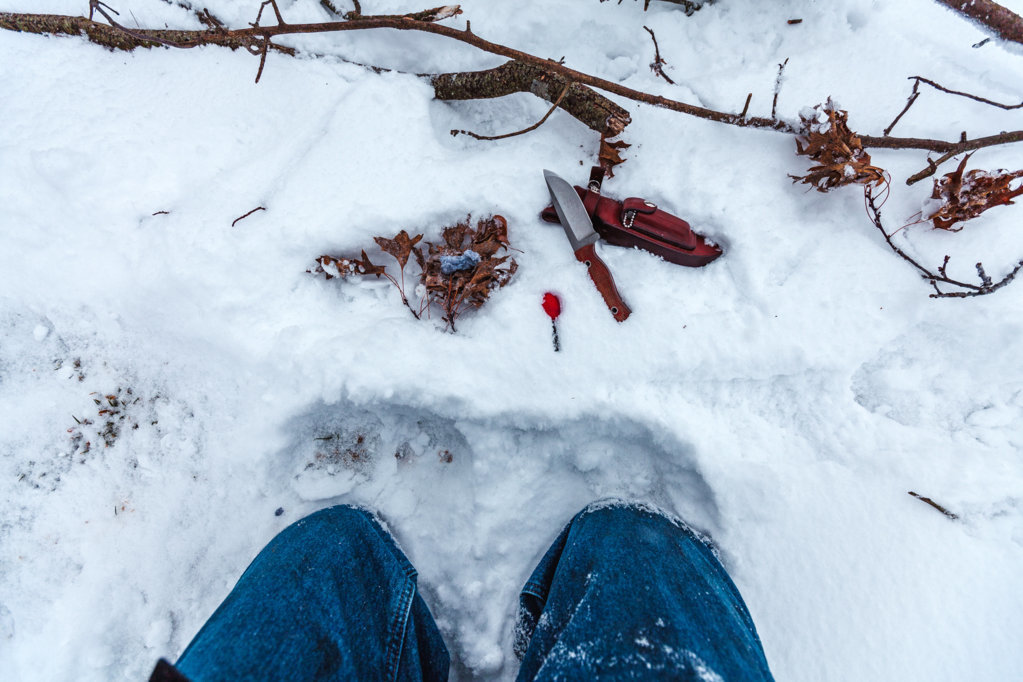

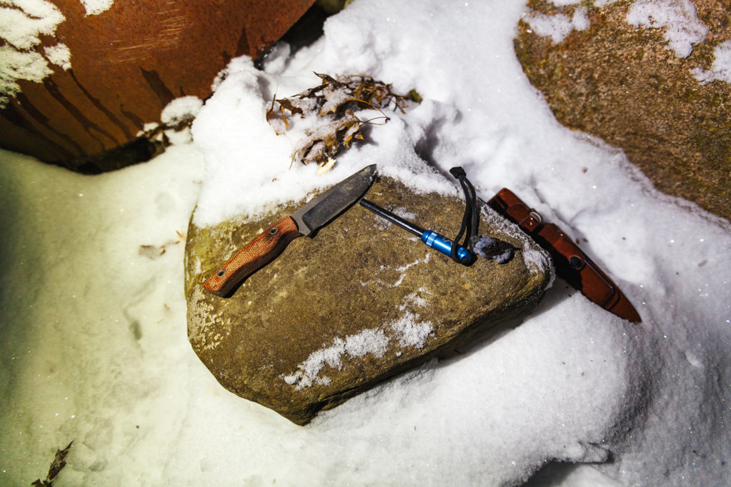

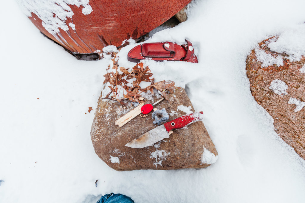

    Went out for some training today to see if I could get a fire started when my diesel heater flops.
    Pretty much failed. Tried to make it happen with a ferrel rod and learned some stuff.
    First off, never buy a small rod, its damn near worthless when it counts. It was 15-20f degrees out and made things a lot tougher.
    Tired for about 25 min and I got the lint to strike a couple times but it didnt really want to burn. Idk if it was because it was so cold or what but, couldnt get the leaves to light or the lint to burn fully.
    With the rod being so small its not that easy to strike when its so cold out.
    I tried out in the open and it was even worse.
    Then I moved to stone to have a flat working surface which helped a lot but still couldnt get it go. Struck the rod at least 100 times. I know for sure that if this is in warm conditions it could of been done,
    but I want to make sure I can make it happen when its freezing. Also tired the magnesium block and that was worthless too.
    Gonna try again tomorrow with a longer rod that I have. I might sand the top of the knife some to give me a sharper edge to strike with.
    Black97v6MT likes this.

    Just went and tried again because Im kinda annoyed I couldn't get it. The bigger rod is wayy better. But still no go. I got the lint to light but wood or leaves wont catch. Gonna need to work on a strategy. This sucks, I didnt think it would be this hard. If it was 60f degrees out it would be massively easier, but I guess the point is to make it happen it the worst conditions. Good thing I found out now and not in life or death.

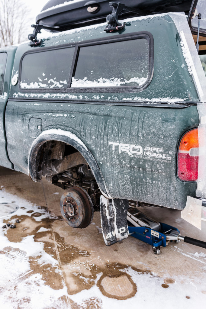

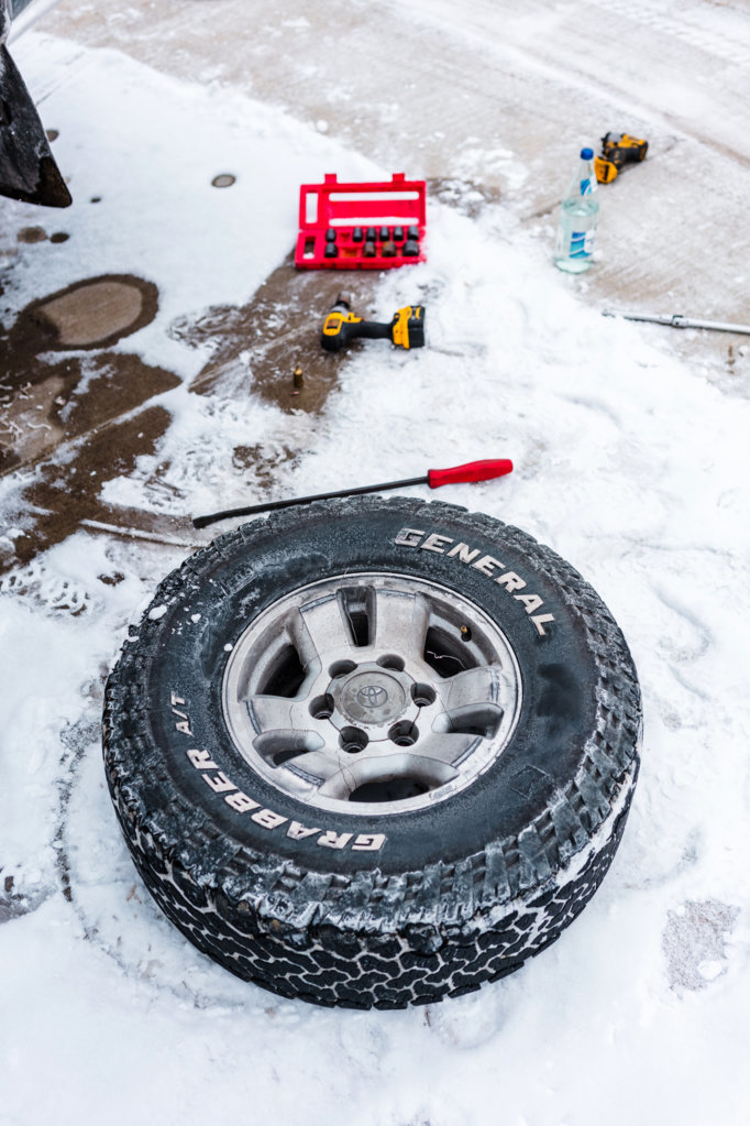

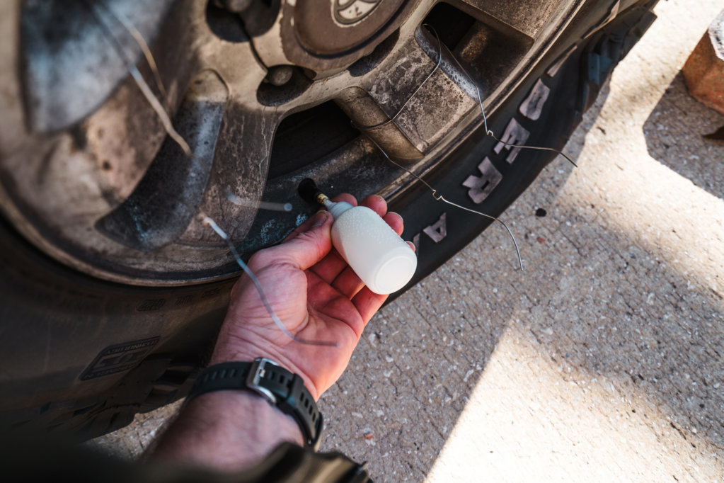

    Tires seem to have gone out of balance again. The tire shop I use sucks. This is the 4th time for multiple cars that the tires have been out of balance from them.
    I tired to fit some BB's through the valve stem and it was a fail.
    Then on another day I tried to break the bead to get the BB's in but it was like 10 degrees F out and theres no way the rubber was going to give.
    Looks like Ill have to try again later.

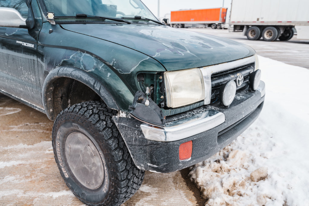

    Doing a straight shot to FL, 15 hours.

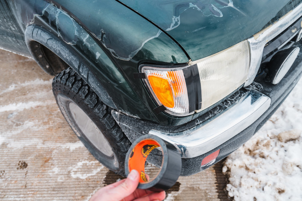

    Head wind was really strong so Im not going to track fuel. One of the front tires is really out of balance too so its not worth it.
    Head a loud sound and thought one of the wheel covers finally flew off so I stopped to check and nope, the wind ripped the corner light out and broke the bracket.

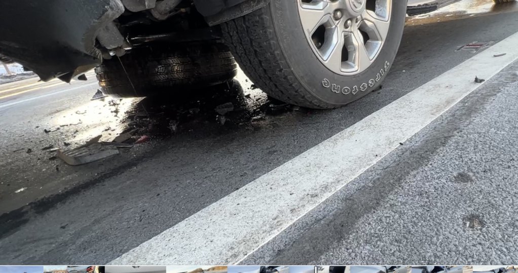

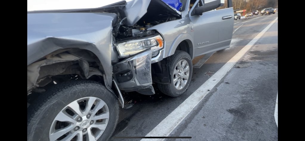

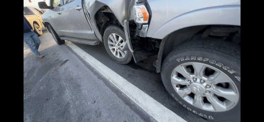

    Some guy in West Virginia decided to use some cars to slow his truck down instead of using his brakes.
    My rear camera was covered with that magnesium salt shit so its a little unclear.
    The car ended up putting all its energy into my rear hitch. Ended up bending my hitch and tweaking the rear frame down some. Got a pretty bad concussions, the rest of the trip sucked, felt like throwing up the rest of the way and my memory was foggy. A week later my neck still hurts. AAA insurance sucks and so does State Farm. Both trying to avoid any body injury coverage. Looks like I need a lawyer now.

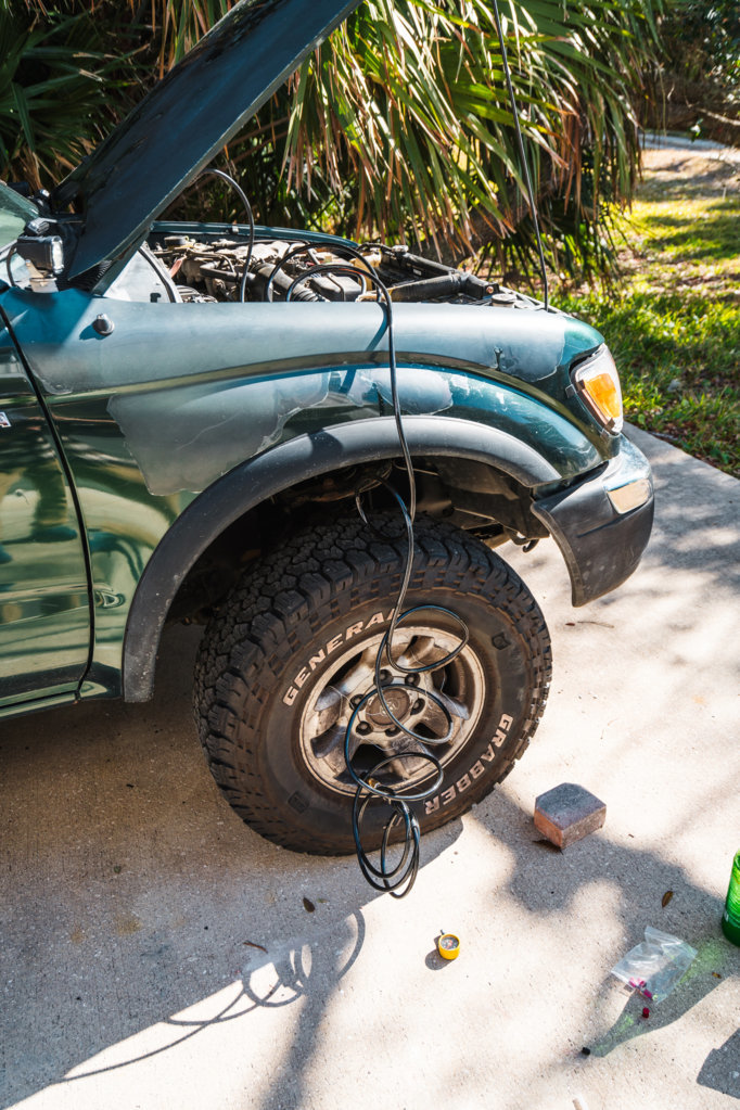

    A couple days later I jumped on getting the tires back in balance. Amazon had some balance beads that would fit through the stem, so I ordered that and did all 4 tires with 4oz per tire. Was kind of a pain, took about 10 min each tire to try and pour it in. Should of done it sooner. Much better now.
    Airing back up with the onboard air.

    Some screen shots from the video I had. The guy hit everyone going 50 easy. No brakes at all. No warning. The truck in front of him was bad. It was hit so hard the spare tire was under the passenger side of the truck that hit everyone. They pretty much became one truck.
    robm7 and Black97v6MT like this.
