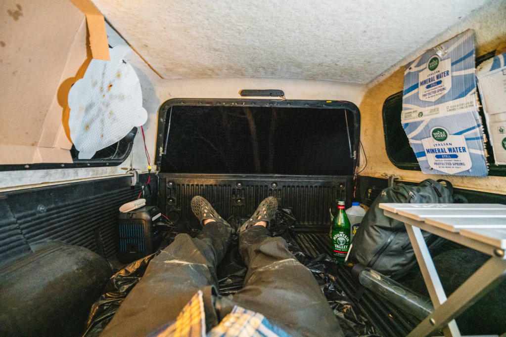

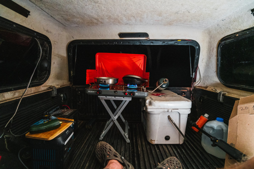

    Not really too setup in the back yet, but good enough for me. Im just using pizza and water bottle boxes to cover the windows. Eventually Ill do something a little nicer to cover the windows. Ill probably leave the rest like it is. I need my truck for different reasons so I dont want any build out. Will prob just add some better lighting.

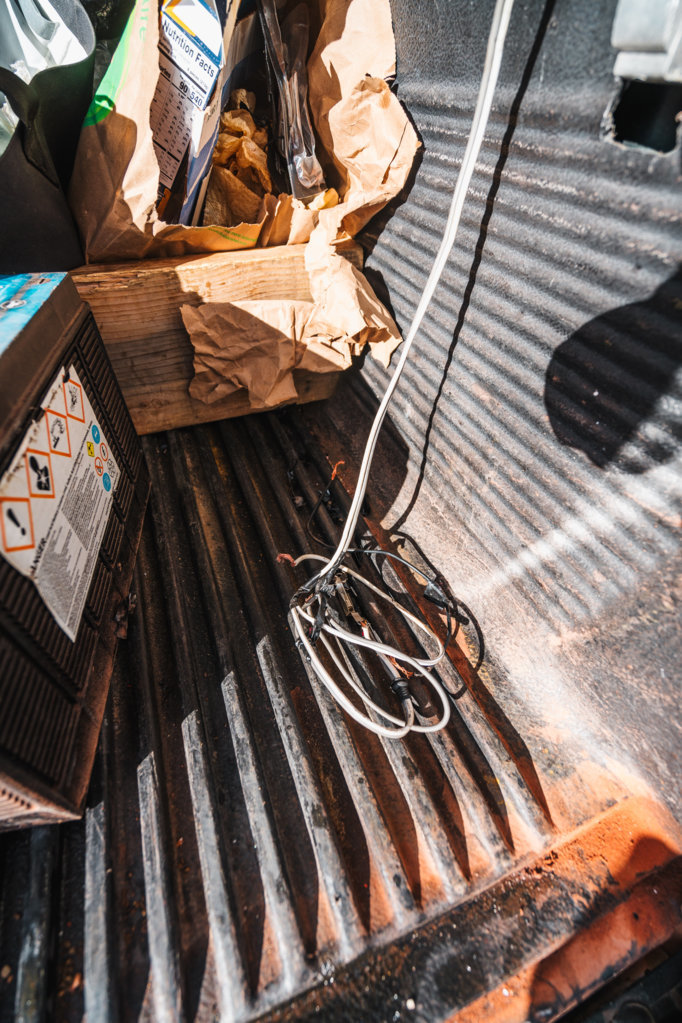

    While driving around. The battery crushed my diesel heater cig lighter plug. I soldered the thrift store one back on and it works.

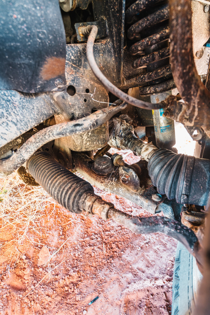

    I get to the end of Onion Creek and Im losing my mind over these bilstiens being so rough, it dawns on me to disconnect the sway bar. So I did.
    I wired everything in place with the left over stainless bailing wire I had for my wheel covers.

    Backtracked Rose Garden and on my way out of Onion Canyon. Glad it finally dawned on me to remove the sway bar. It was a massive difference in ride quality. All the harshness is gone and its finally riding right.
