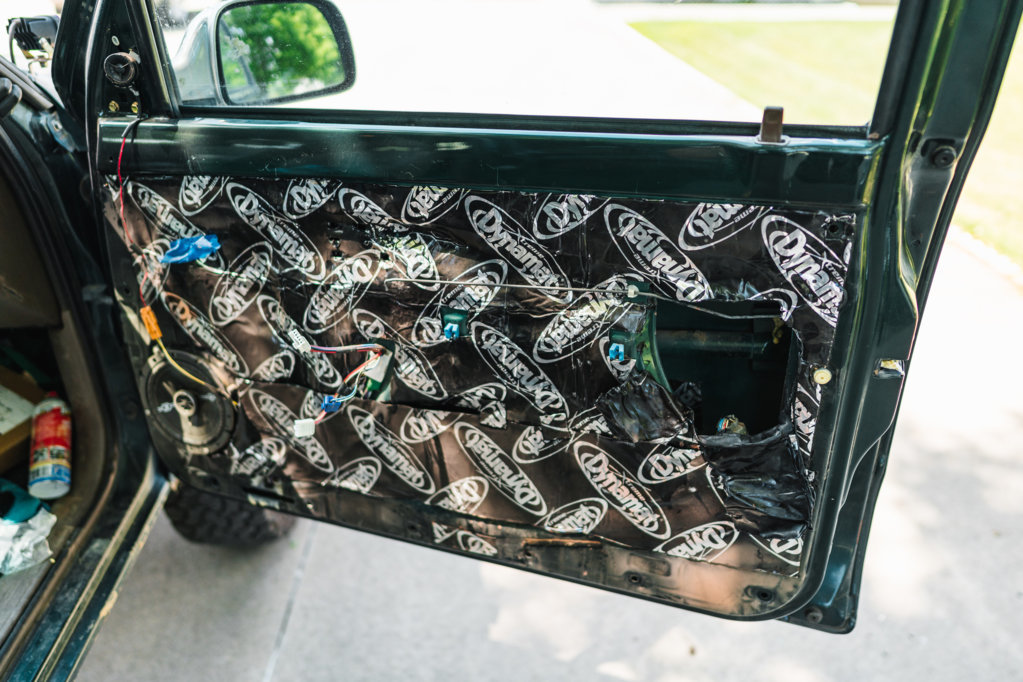

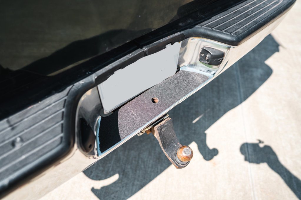

    Added velcro to the newest patches and stuck em up

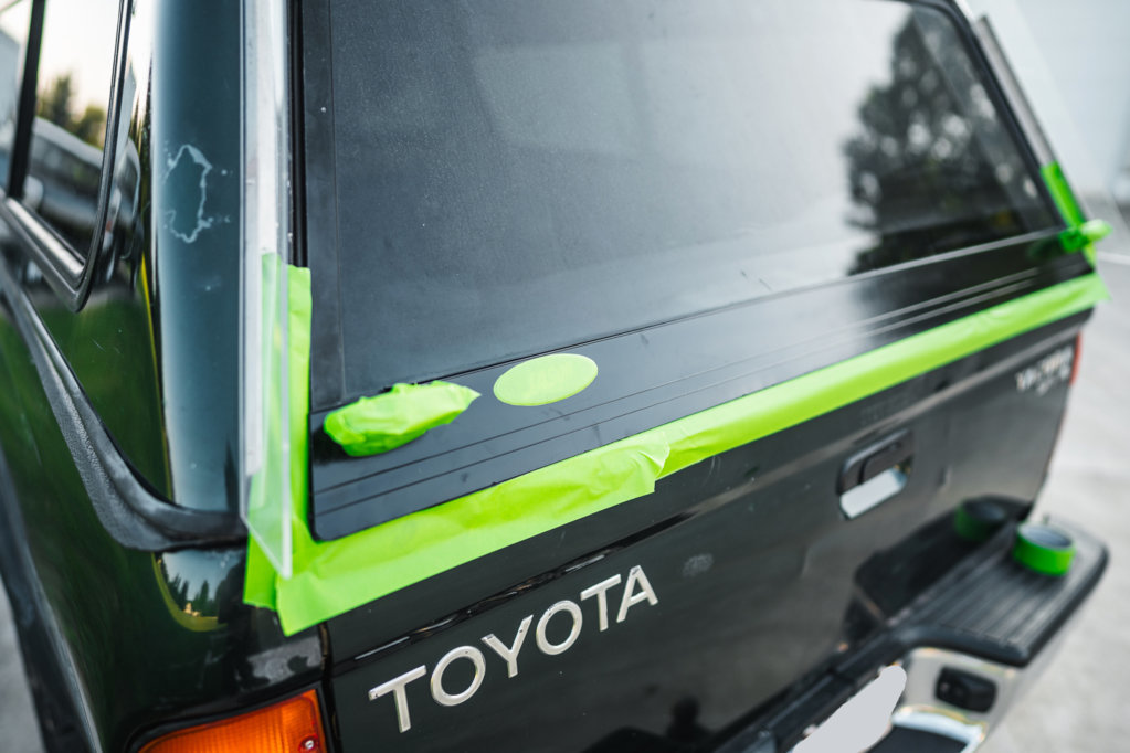

    Repainted back part of shell that was fading.
    Tired of slipping of the bummer when I step to reach in the back. Ive been waiting to add clear skate grip tape but I found this for a $1.00 so black it is.

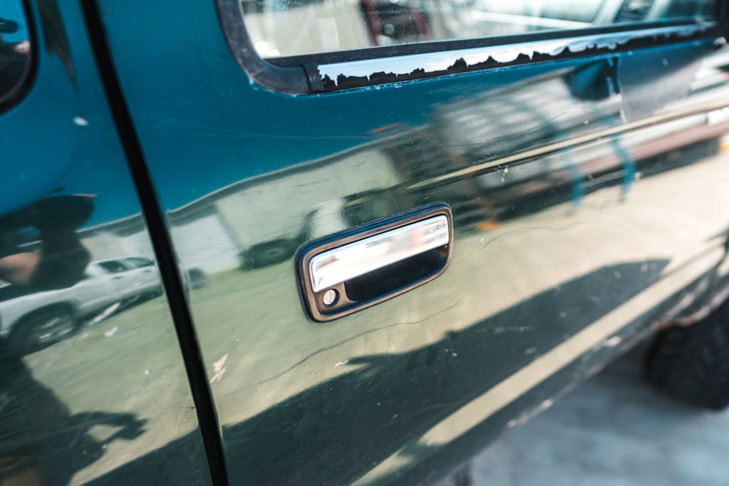

    The passenger door handle stoped working.
    Thought something was broken and it ended up being that the the outer door handle mechanism was really dry and sticking. put a bunch of white lithium grease all over everything and it kinda crazy, it opens like a new car door now. The tiniest effort will open it. Regret not doing this to the driver side when I replaced the window.
    I ordered grill clips, a screw that was missing from the door latch and 10 black number 11 lower ball joint bolts, which Im going to replace on both sides.

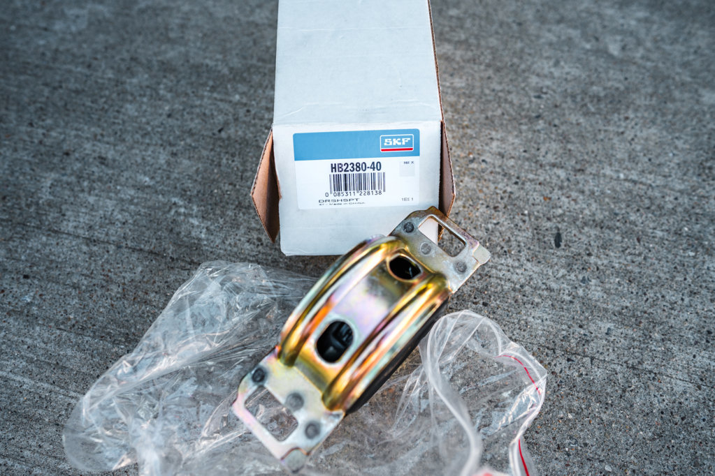

  3. Aug 20, 2025 at 7:32 PM
    #763
    taco2uesday
    taco2uesday [OP] Well-Known Member
    Jun 18, 2020
    #331856
    803
    1999 Tacoma SR5 TRD 5 Speed
    Map Lights, Grey Wire Mod,

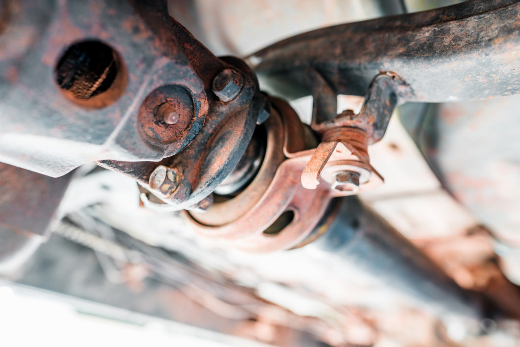

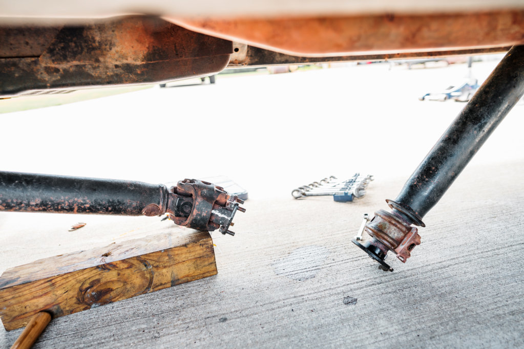

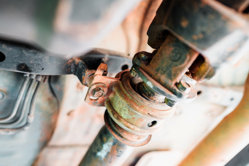

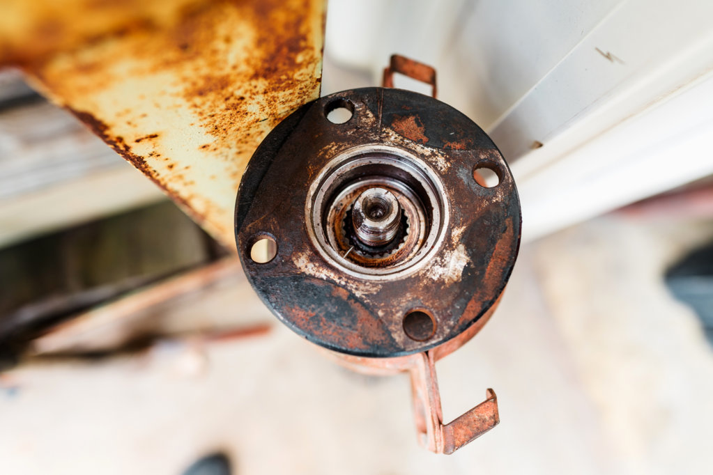

    Now im checking everywhere to try and fix this damn vibration. 5 years and over 100k of shaking has me over this truck. Tire balance after tire balance, drive shaft rebuild, needle bearing replacement, alignments, carrier bearings, carrier bearing spacers, days of testing and trouble shooting. Absolutely insane.
    Inspecting the driveline it looks the carrier is toast. Tons of slop. Looks like these things need to be change every other oil change.
    I flipped it for a 100 mile trip to see if it would do anything. It ended up getting slightly better but still didnt go away.
    As much as I wanted to order the spicer one its $100+. I opted for the SKF for $50. It appears it doesnt matter which one you buy, they are all trash quality.
    I thought I was going to be cute and save myself some headache by taking it apart on the truck. Nope, had to remove the front portion to make life easier.
    Made sure to make a mark so that I dont screw myself.
    So I reinstalled then noticed the washers were stuck to the old bearing, seems I cant escape my stupidity. Was just going to leave it, but I hear squeaking. Still might just leave it.
    Its crazy how much it sags with a new bearing. Its like it already junk from the get go. Still shaking with the new carrier bearing.
    rblalliance likes this.

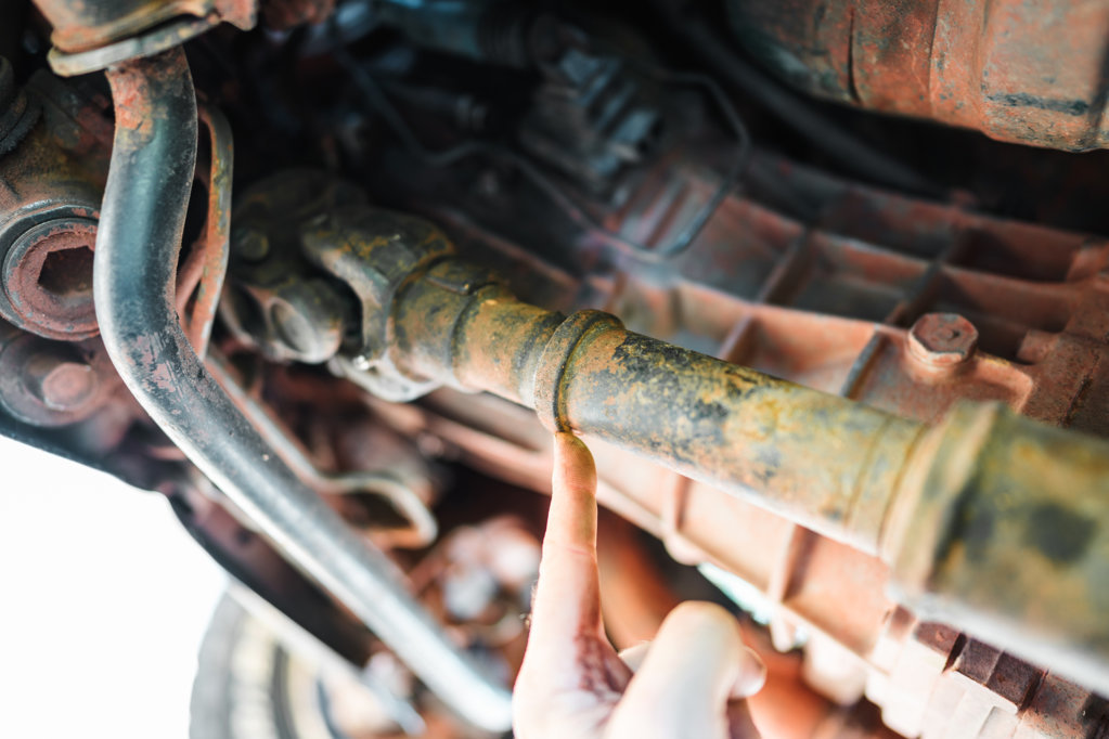

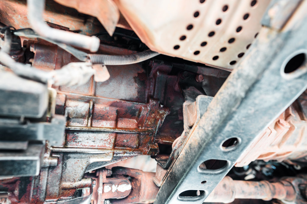

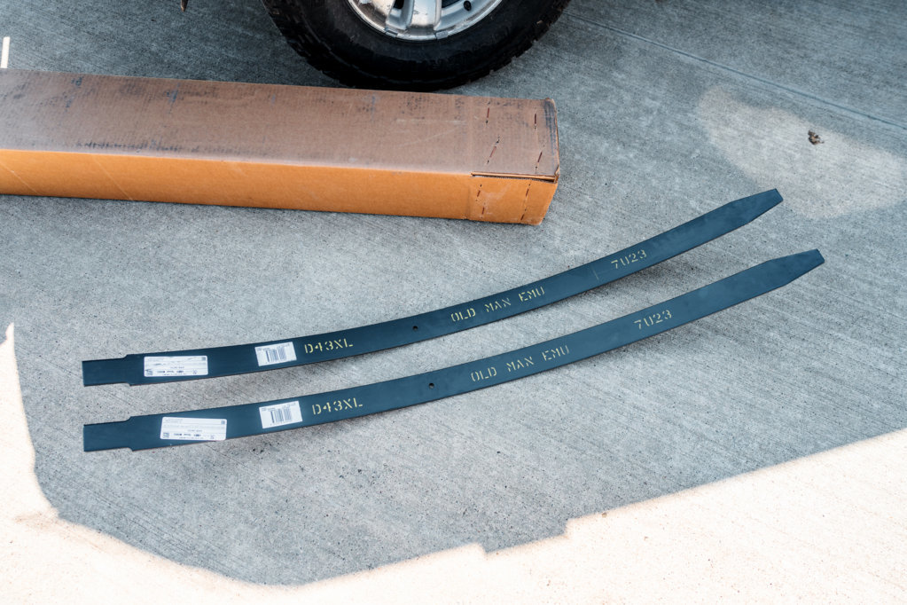

    Ordered OME AAL since I seem to be carrying so much stuff on all these road trips.
    Upon further inspection of other things that want to be a pain in the ass
    My dingle berry mount is broke
    The soft cap in my front driveshaft slip yoke is missing. I cant grease it because the grease just pours out the front. Looks like it might of gotten hydro locked and blow the cap out on the road. Its bone dry and theres lots of play in the slip yoke. I wonder if im getting some vibes from here. I know that its in neutral but it still spins at highway speeds. I might just pull the shaft and drive without it to see.
    Exhaust clamp wasnt clamping causing an exhaust leak. Cheap ass Amazon clamp. Its marked 2.5in and it measures well over when fully closed. I added some shims for a temp fix. Ill pull it eventually when my ass stops hurting from all this maintenance bs and weld it on.
    And it looks like trans or transfer is leaking from the shifter gaskets.

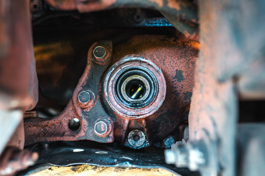

    I checked the driveline angles with a real angle gauge, not my phone and it seems like the driveline should be within the limits it needs to not vibe, but here we are, again.
    Since Im going to install the AAL Im going to just jump ahead and shim the rear axle. Its around 2.5 degrees at the rear, within the "allowed" 3 degrees but Im going to install a 4 degree shim and then take some of the sims out of the center carrier bearing. Im guessing the AAL is going to give it a slight raise increasing the angle more plus removing some of the carrier shims will increase it even more, so Im guessing 4 degrees might be the way to go. At this point no methods seems to work so Im just gonna start guessing.
    On the, make my ass bleed more list of this to do, hopefully within the next week.

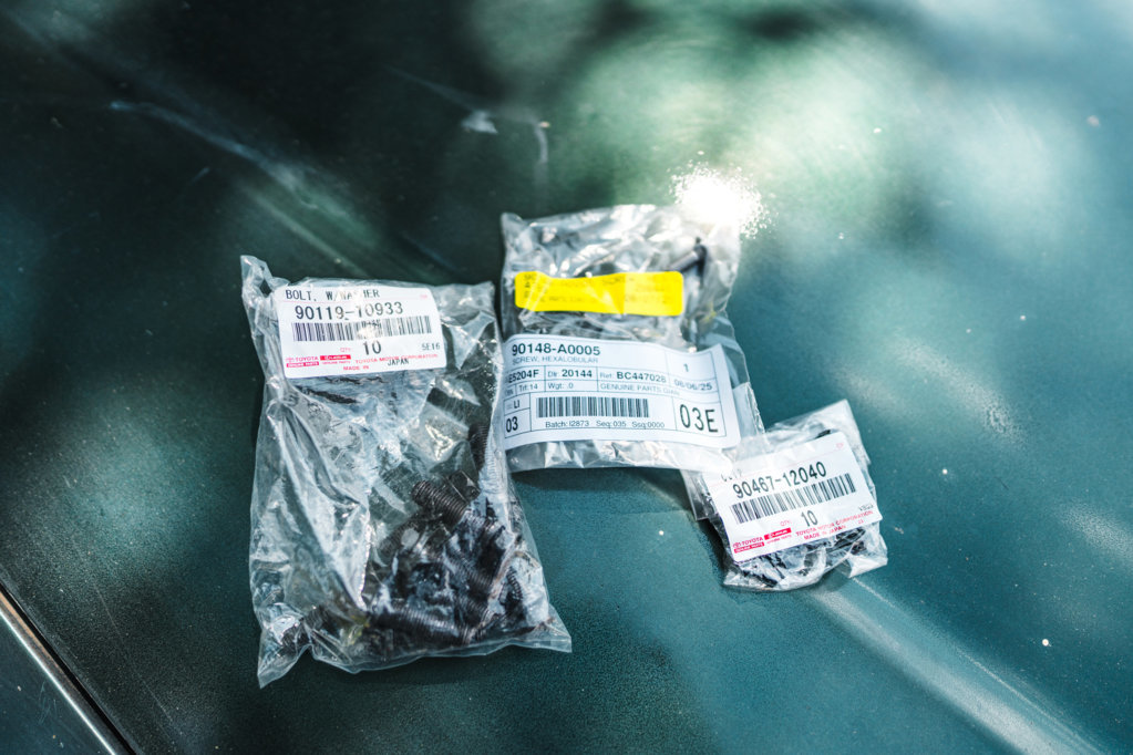

    Replace lower LCA bushings with Whiteline, replace lower ball joints bolts with toyota black number 11s. See if this helps vibrations.
    Install AAL with 4 degree shims.

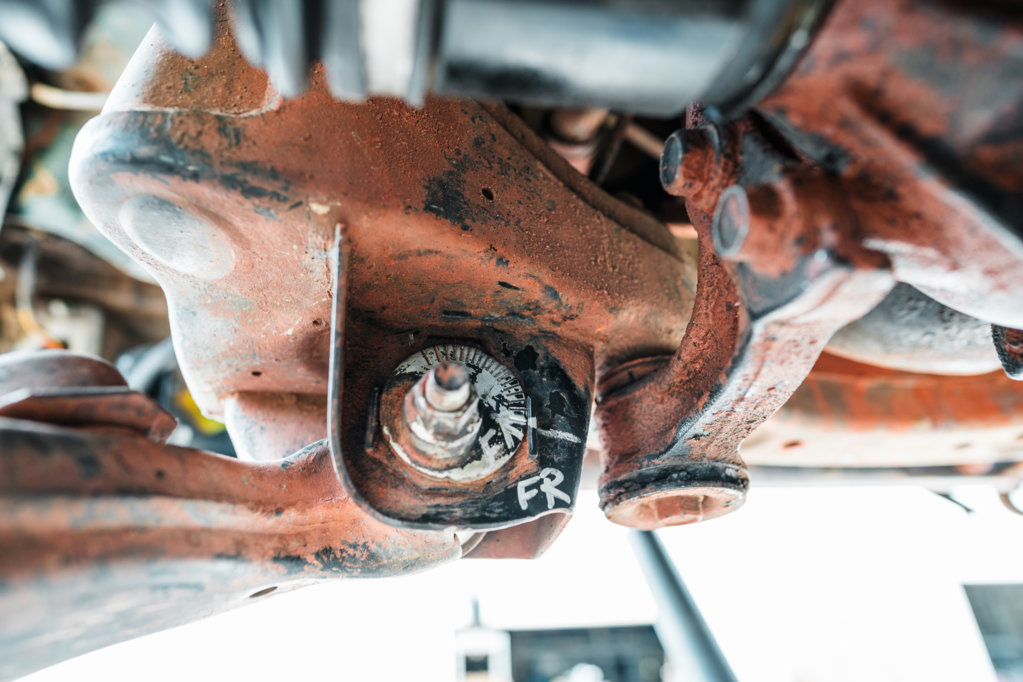

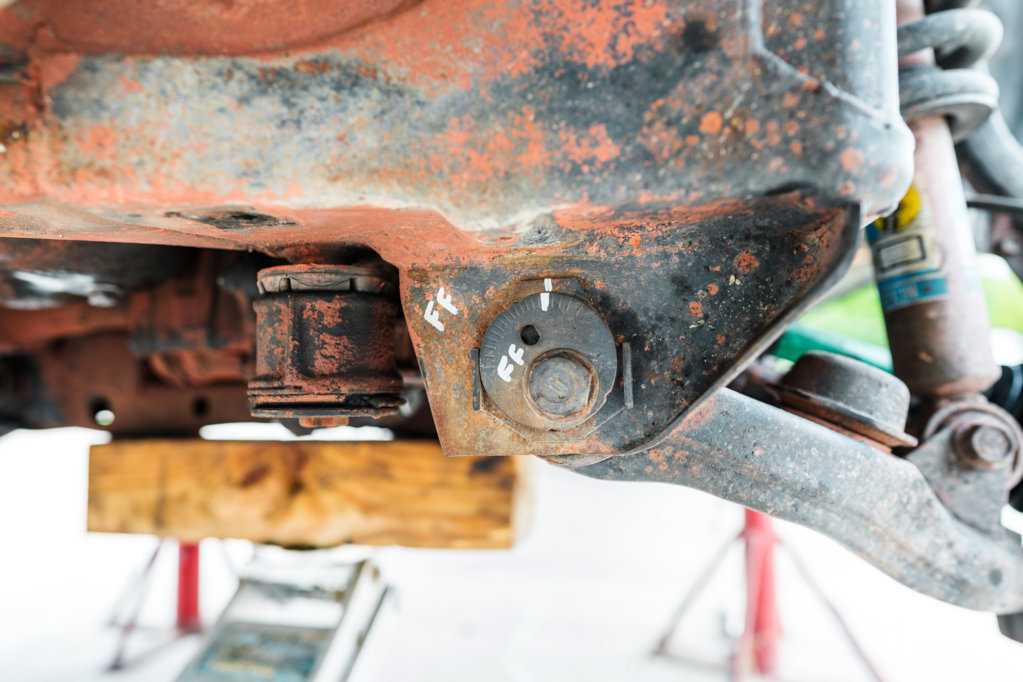

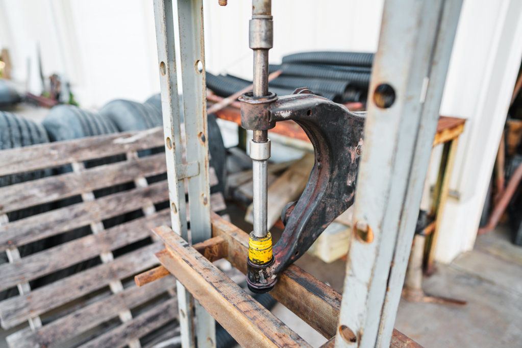

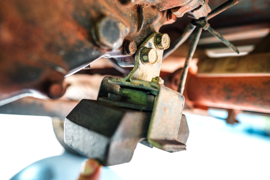

    LCA bushings here we go
    Putting these here in case I need them
    Front Front
    Front Rear
    Rear Front
    Rear Rear
    rblalliance and Rezkid like this.

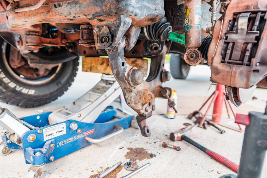

  9. Aug 21, 2025 at 7:46 PM
    #769
    taco2uesday
    Jun 18, 2020
    #331856
    803

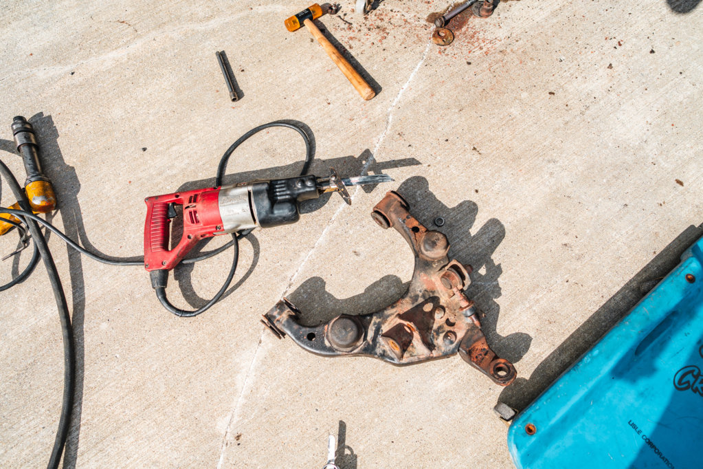

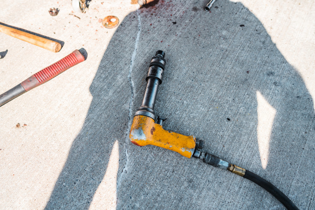

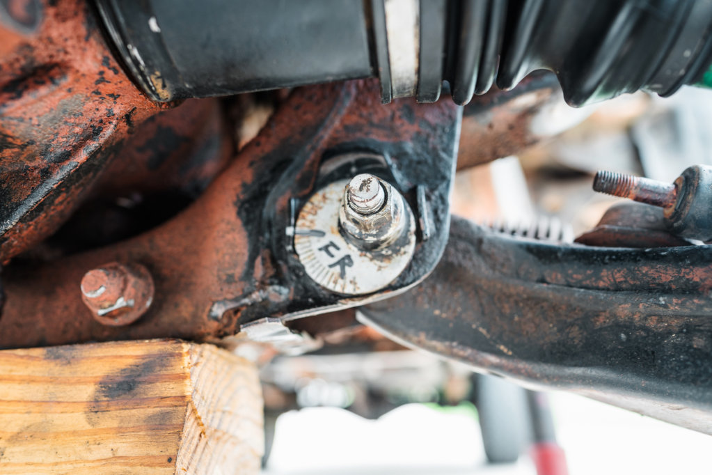

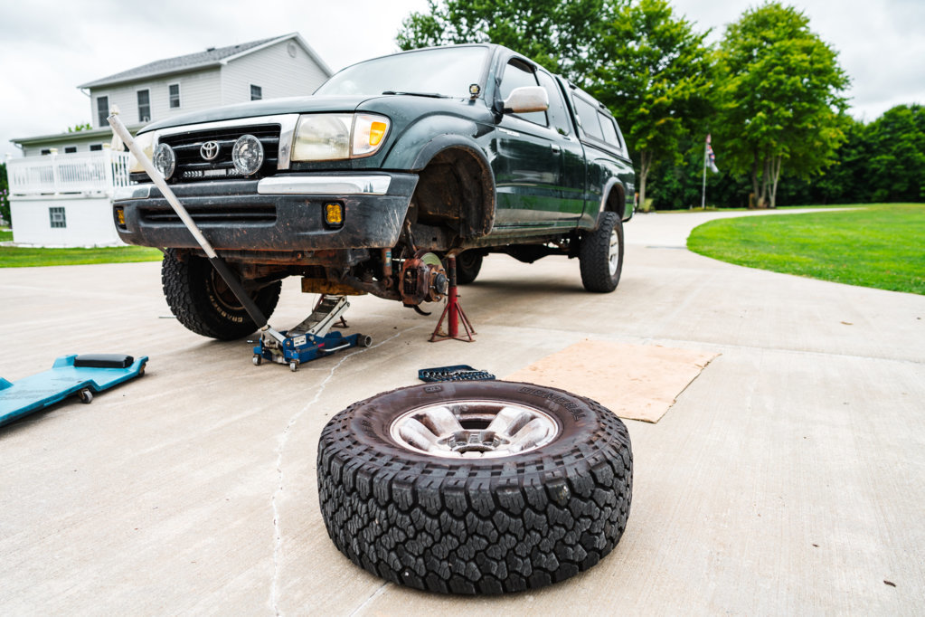

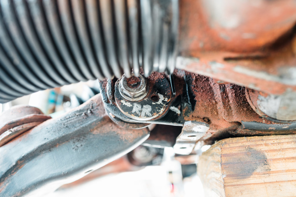

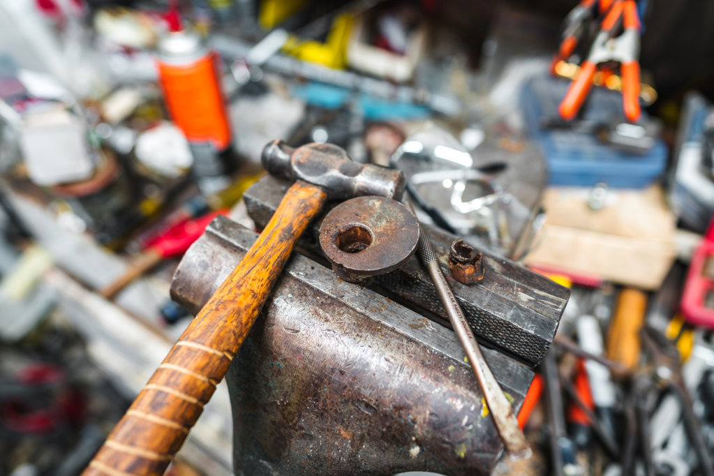

    And the nightmare begins

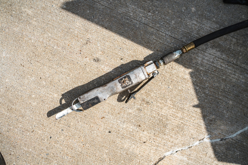

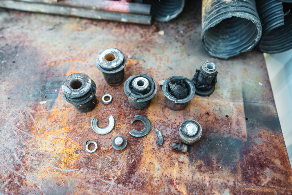

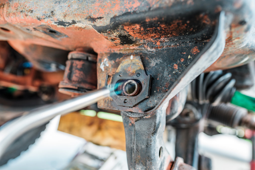

    The rear cam adjuster just fell out like it was new, the front one, was pretty much welded in.
    Torch, Nope
    Air hammer, Nope
    Air saw, Nope
    Yep
    For the next nightmare

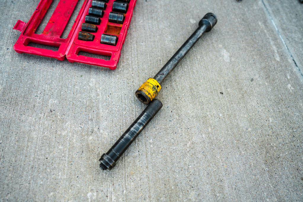

    Toyota jack didnt work, was flexing a lot, Nope
    Moved up to a bottle jack, jacked as hard as I could pump the handle and after hitting it with heat for 10 min straight it finally came loose.
    The other side (the side I had to cut off) wouldnt come out no matter. No matter how much heat or jacking. I even broke the washer in half I was pushing on trying to get it off. No photo but I moved it to a press. I had to rig it up with an extensions and a socket and press through the opening of the bushing I just took out. When it popped loose it was just like someone shooting a gun next to me with no hearing protecting. It threw one of the 10lb press shim a few feet away off the press. Pretty ridiculous.
    Just cutting the front adjuster and trying to get the bushings out took like 3hrs.
    rblalliance, Rezkid and Moonrman like this.

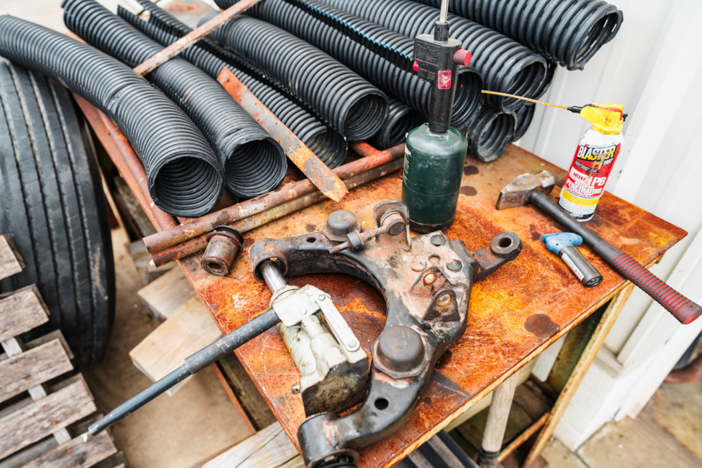

  10. Aug 21, 2025 at 7:53 PM
    #770
    taco2uesday
    Jun 18, 2020
    #331856
    803

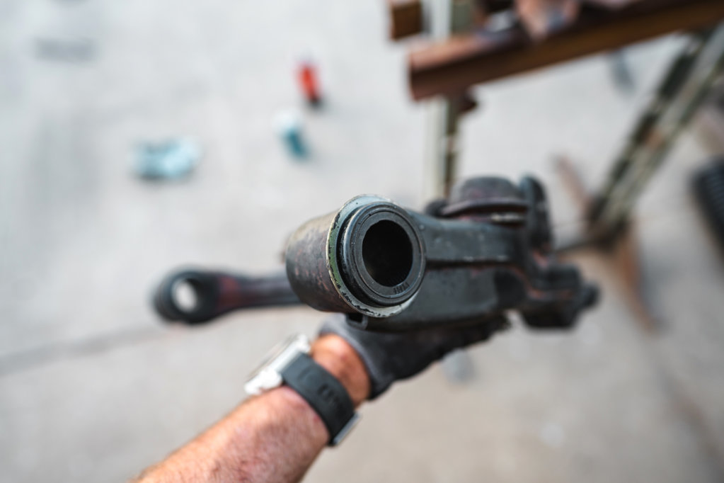

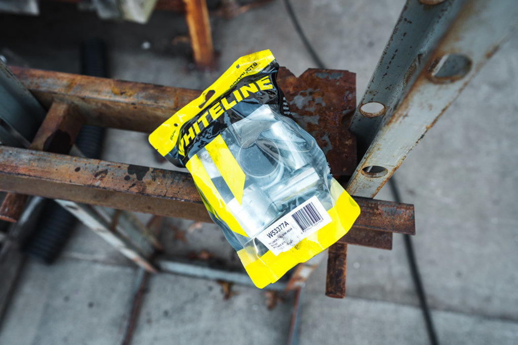

    Installing the bushings took like 3 min. Im kinda worried they might spin hitting hard bumps because they pressed in so easy.
    Now I gotta wait around for a couple days while an adjuster comes in.

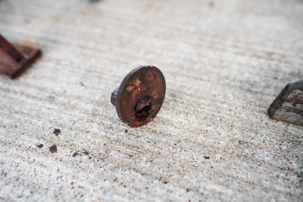

  14. Aug 22, 2025 at 4:43 PM
    #774
    taco2uesday
    Jun 18, 2020
    #331856
    803

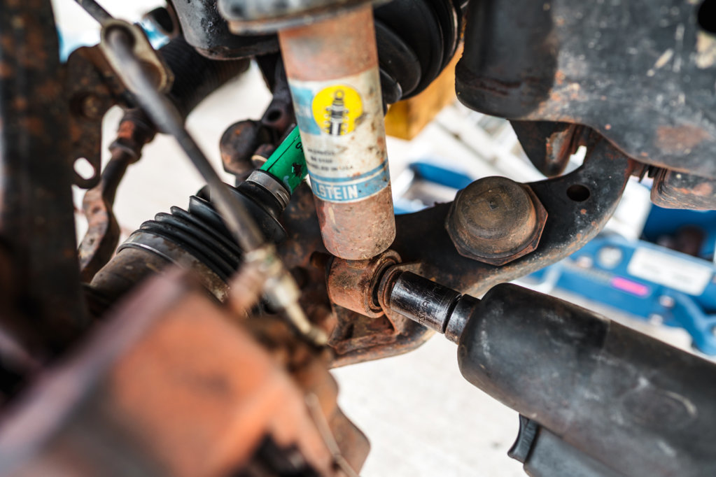

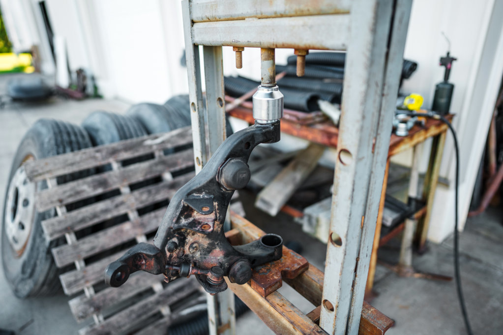

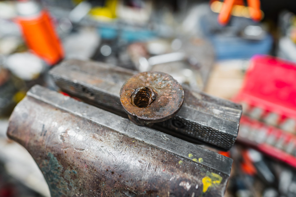

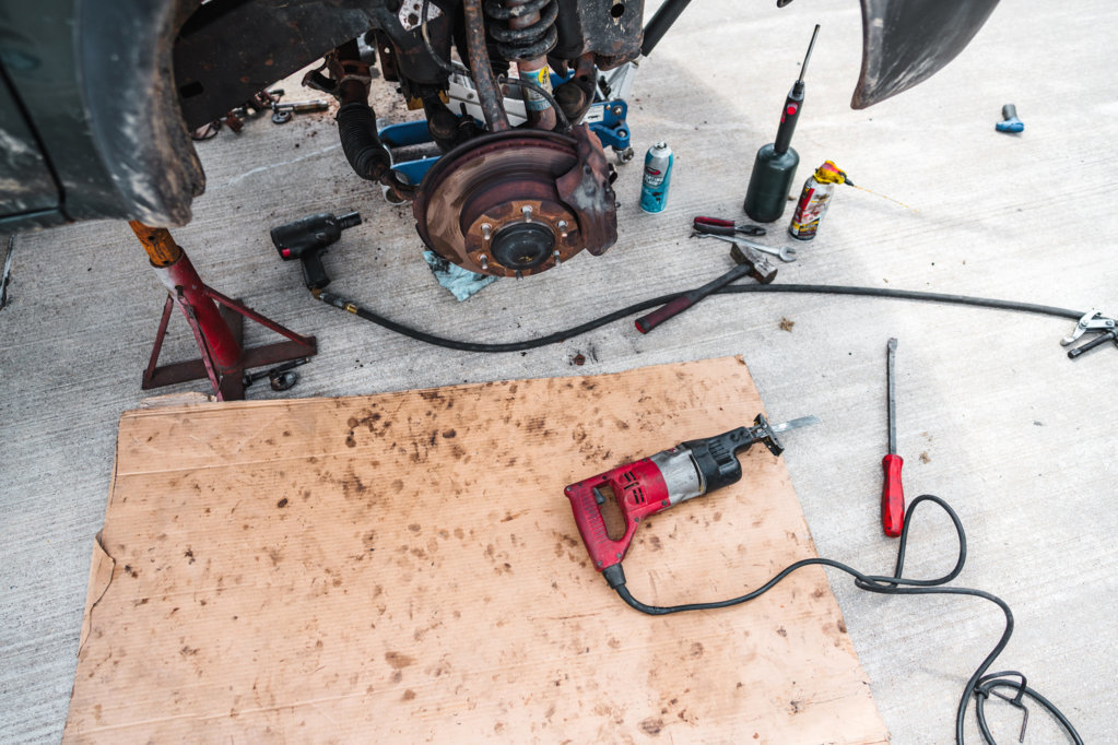

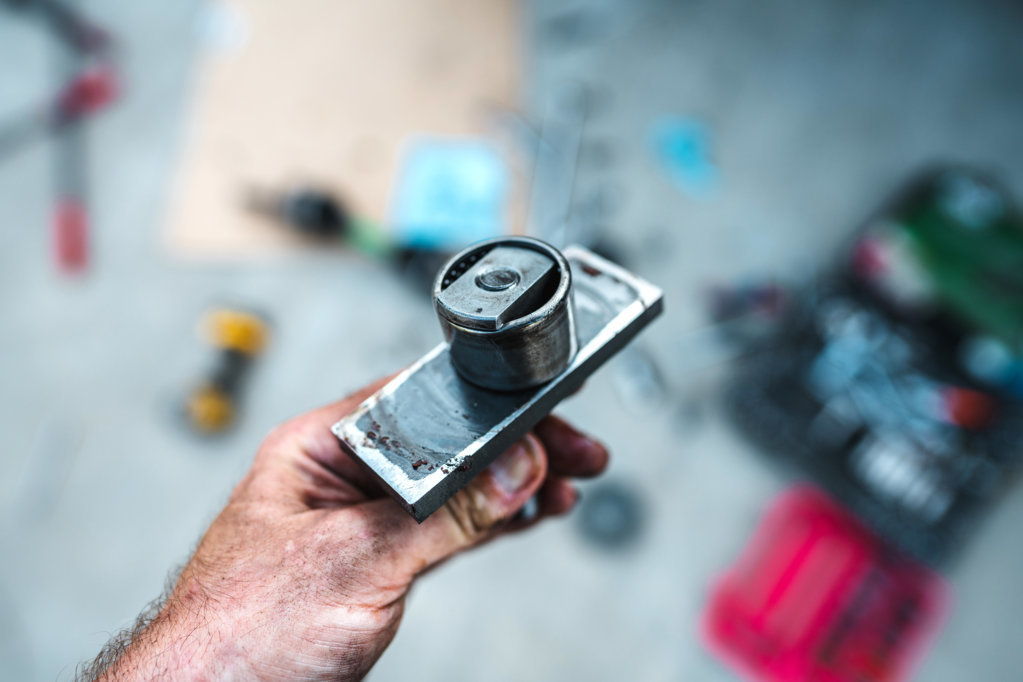

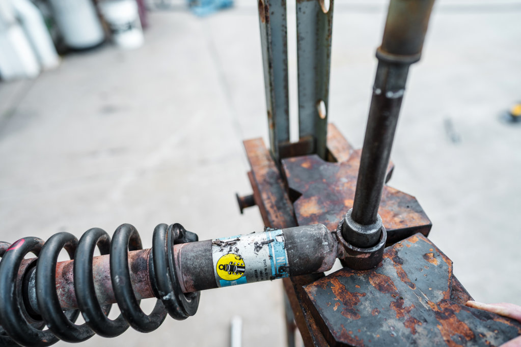

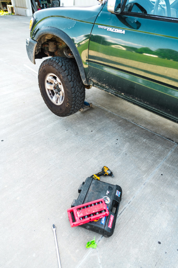

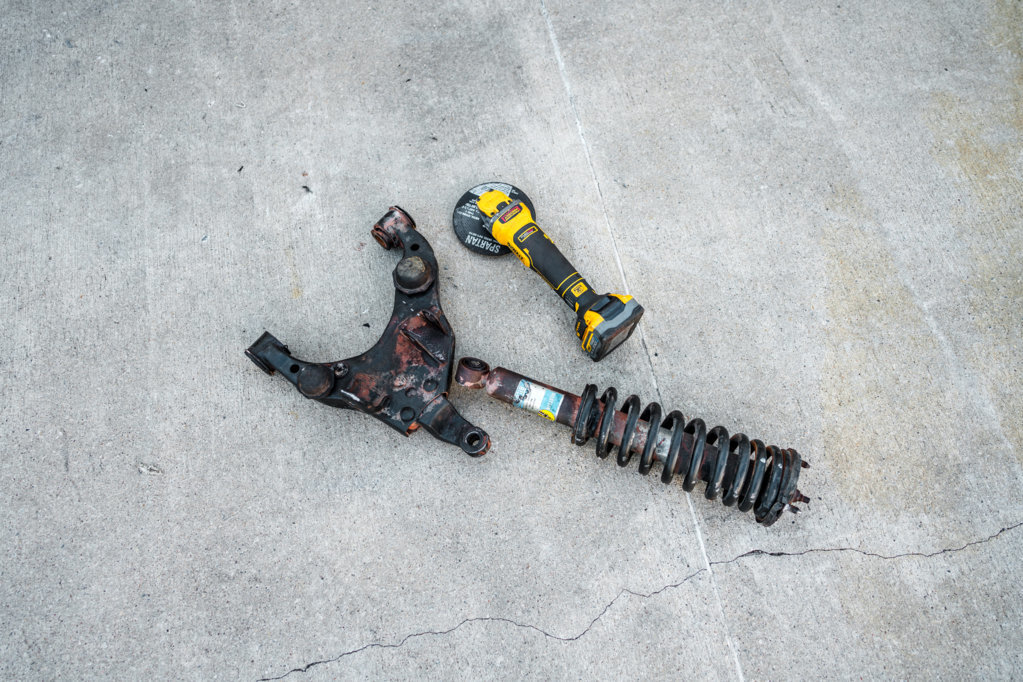

    Todays hell.

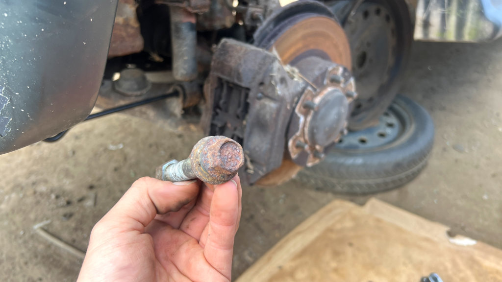

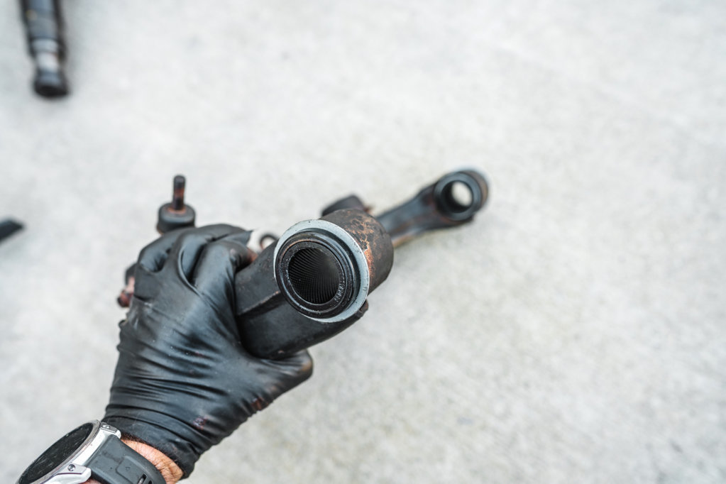

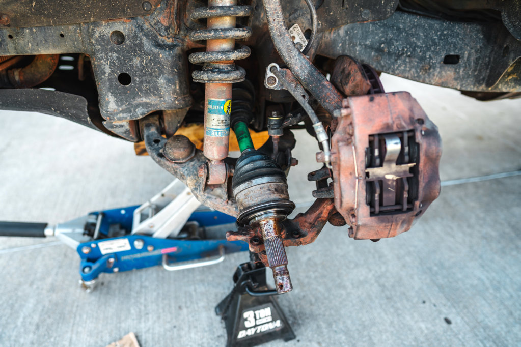

    Took 6 hours to get this side off and replace the bushings.
    Had to cut everything, both LCA adjusters and the Bilstien 5100 bolt. The strut mount it toast too. Looks like I need to get replacement for both sides.
    Didnt get too many photos today, was too pissed off.
    Bolt seized in the sleeve in the bushing and twisted the rubber apart. I guess this is what happens when you just sit back and let them put salt and magnesium on the roads in the winter.
    One of the adjusters was broke. I wonder if the alignment shop broke it and didnt say anything.
    Spent a lot of time trying to cut these off. Some of the sides I couldnt get to the adjusting rod, I had to cut through the metal bushing and adjuster sleeves.
    Trying to salvage as many pieces as possible since they are a rip off to buy.
    Some of the blades I went though to make 5 cuts
    Couldnt cut the one side of the 5100 bolt because the metal sleeve as all the way against the ear/mount on the LCA, spent 15min with the sawsall and it did absolutely nothing. The bushing sleeve was way too hard. Decided to risk it all and hit it with a cut off wheel. Took less that 10 seconds.
    Not even messing with the bottle jack
    Whitelines are in
    Pure hell. Apparently this is in good condition to the alignment shop.
    This is about as far as I can go for now. I need to order a bunch of stuff and try and find the 5100 bushings, Im not buying new struts too.

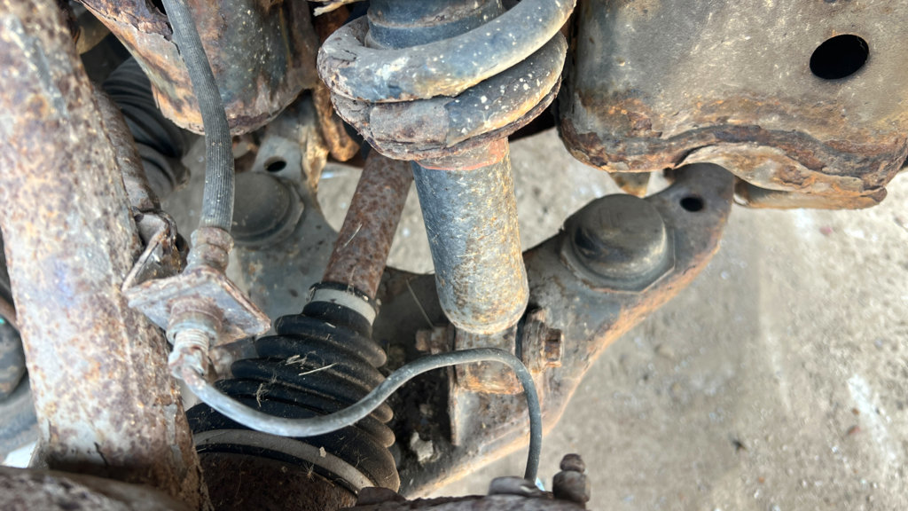

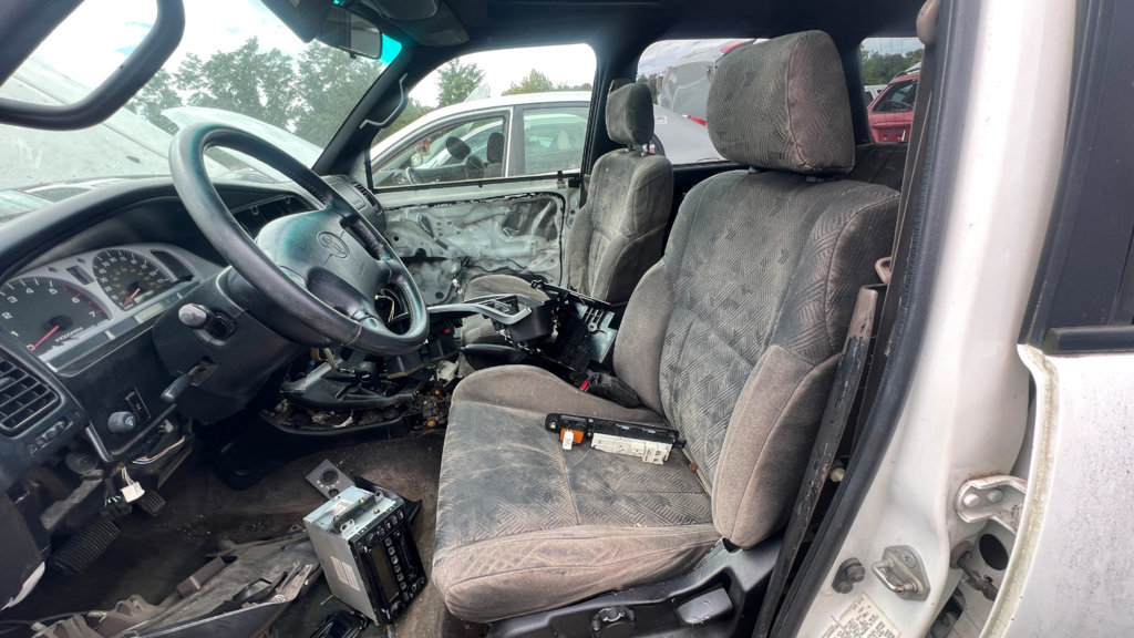

    Seen there was a 4runner in the junk yard went to salvage some strut bolts.
    Seats were nice but someone painted the whole interior black including the seats. Bummer, I would of taken them if they were left brown.
    Only got one and its pretty rusty.
    Didnt get the 2nd one, someone installed it backwards and I didnt want to fight for it.
