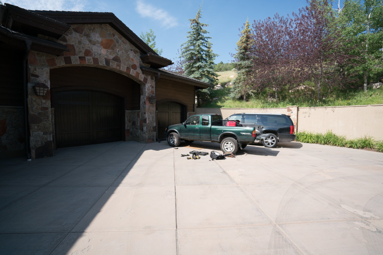

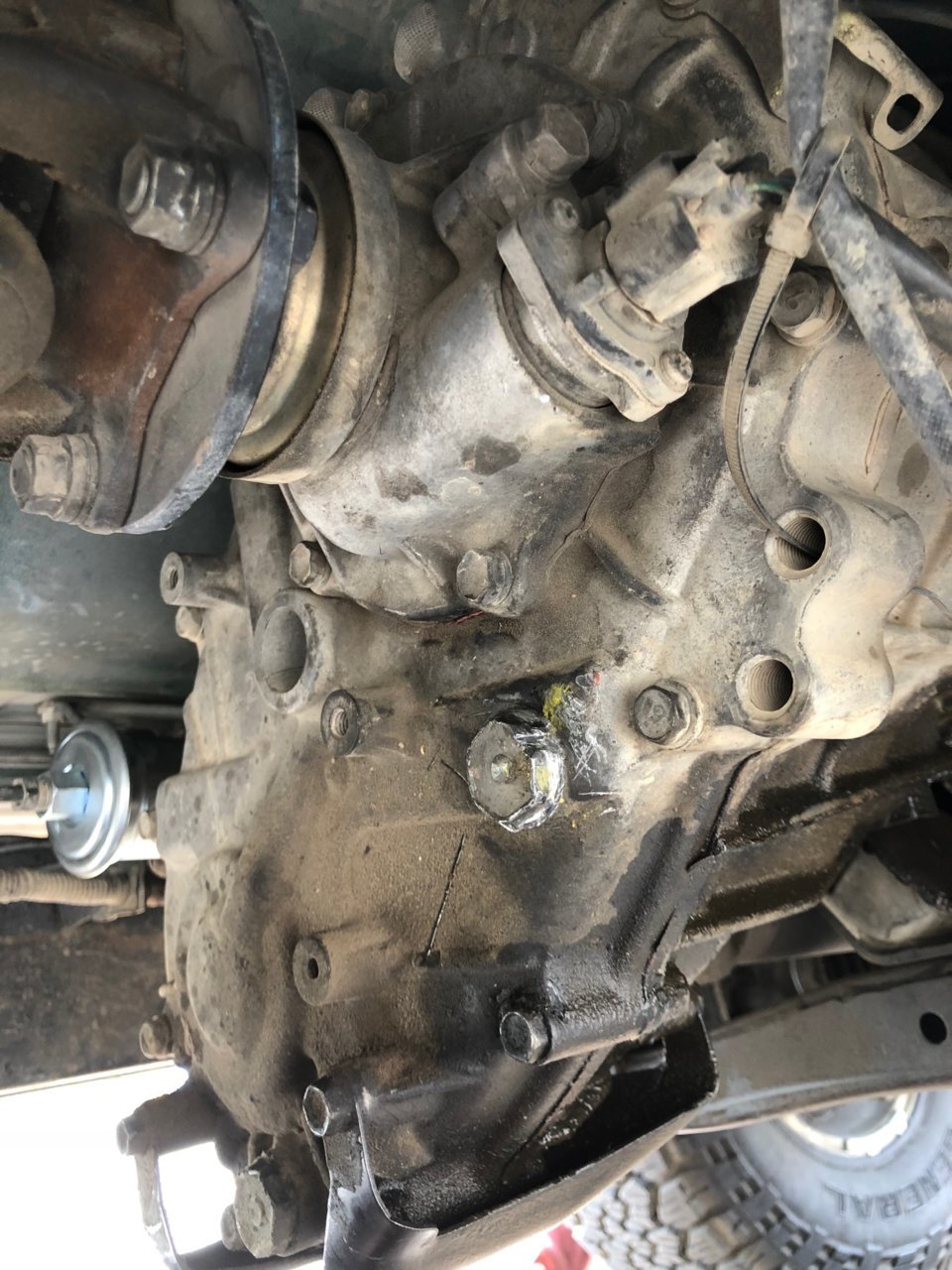

    Getting into Utah and after losing a ton of front diff fluid, I decided to empty it and see how much was still there. It down by half, but no major metal.
    The next day I went and bought a bunch of gear oil to refill it. It was dumping out. I came across a product called blue devil stop leak and it seemed to slow things down a ton.

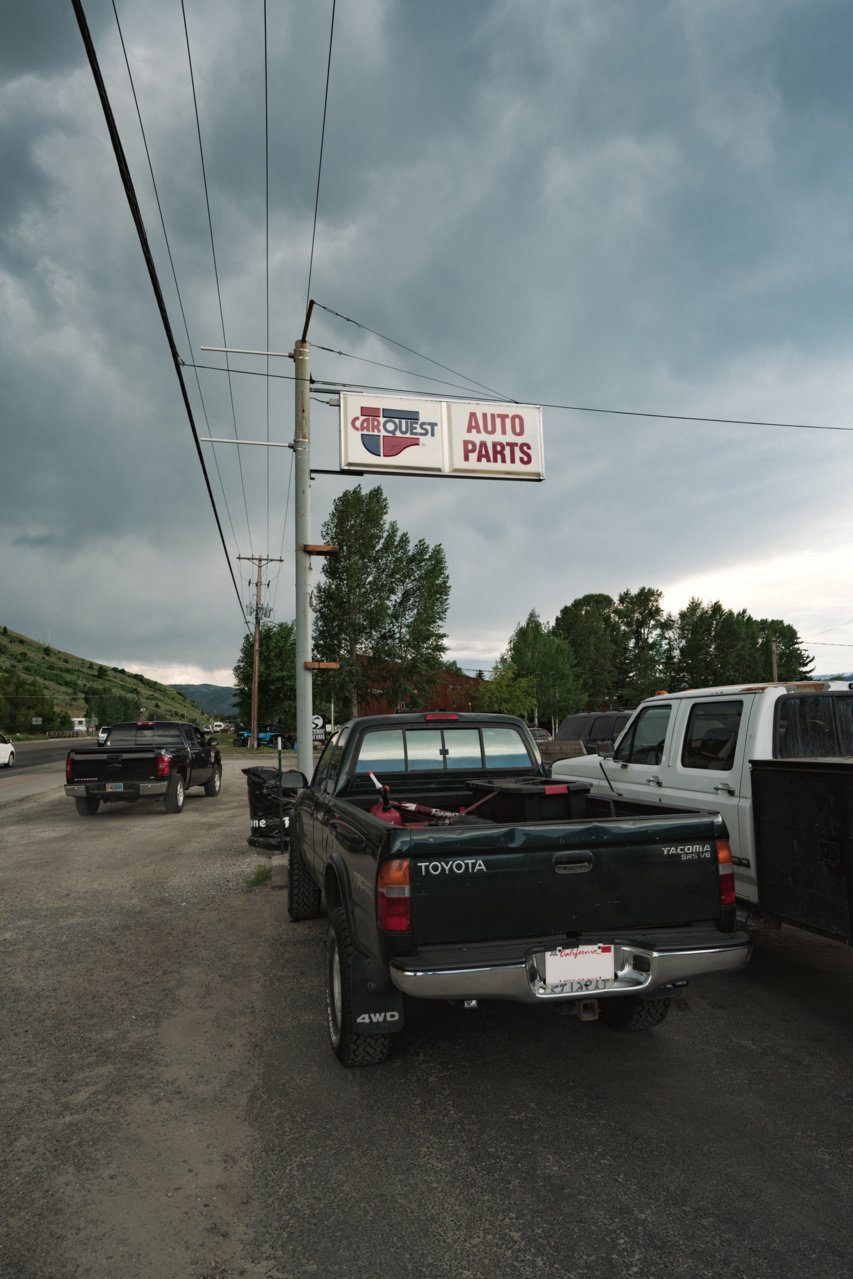

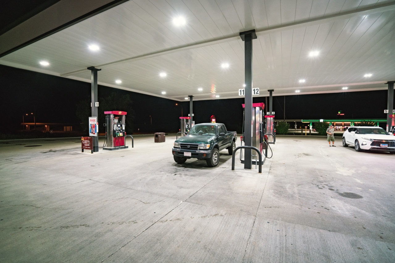

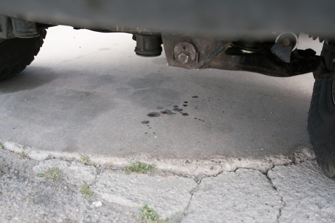

    Utah to Wyoming. Steering rack problems and front diff leaks. Left my skid plates off and kept an eye on everything ever gas fill up (300 miles).
    I found a camper shell in Utah but had to leave asap to make a delivery. I was kicking myself the whole way through Wyoming, there was so my epic places to stop but I had to get there.
    Lost this much just filling for gas.

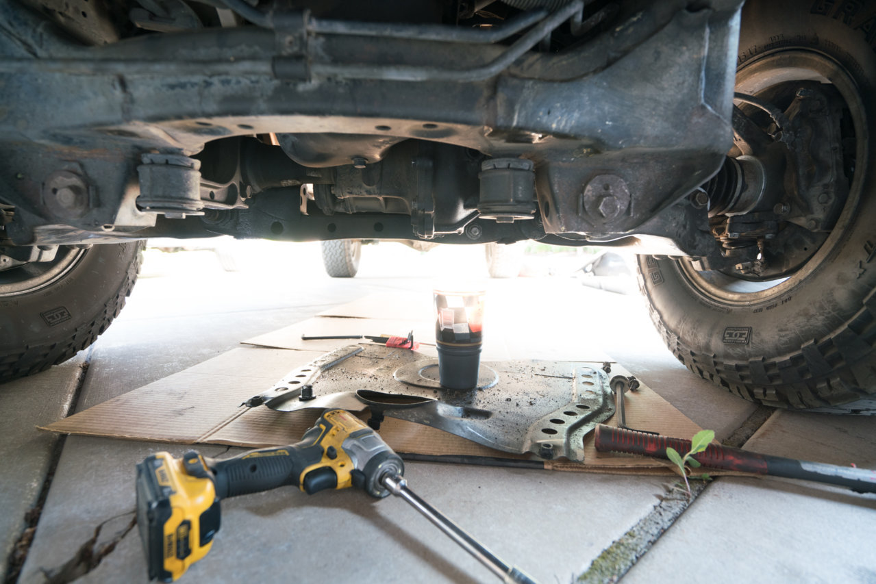

    Made my drop and decided to go to the Grand Tetons, but first....
    Needed a hand pump to refill the front diff and some double face for my broken phone mount.

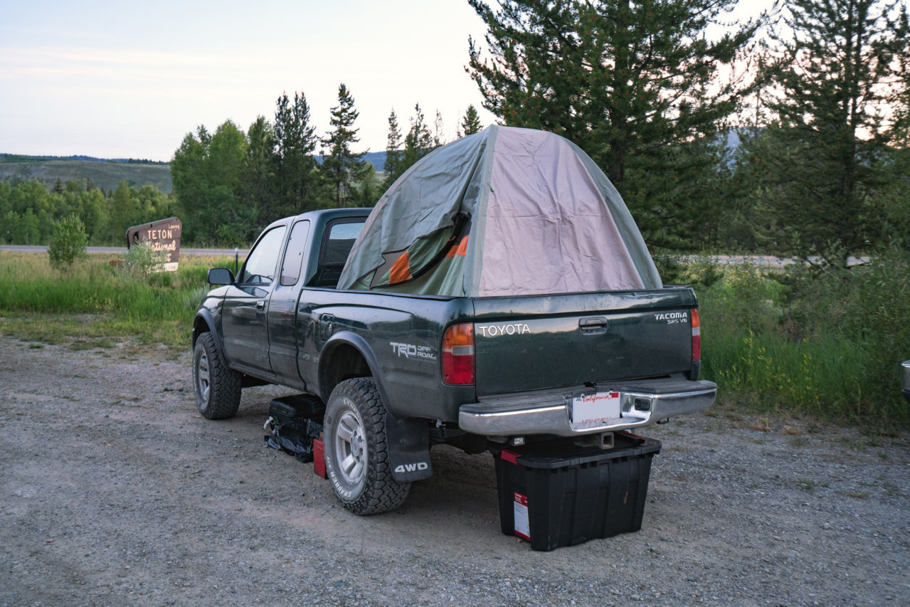

    Since I still haven't found a camper shell I decided to just put a tent in the back and slept next to the Tetons. Wasn't too bad other than the truck not being level.
    Had no idea there was a comet happening at the time.

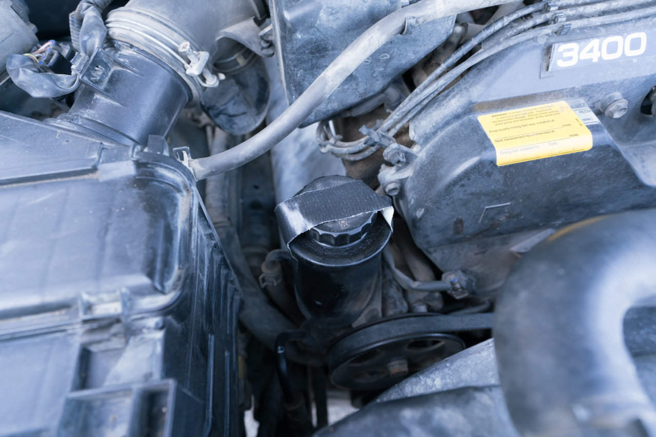

    Was trying to figure out how to solve my steering problems. I thought maybe air was being trapped. So I unscrewed the lid and taped it lose. It seemed to help just a tiny bit but didn't solve it.

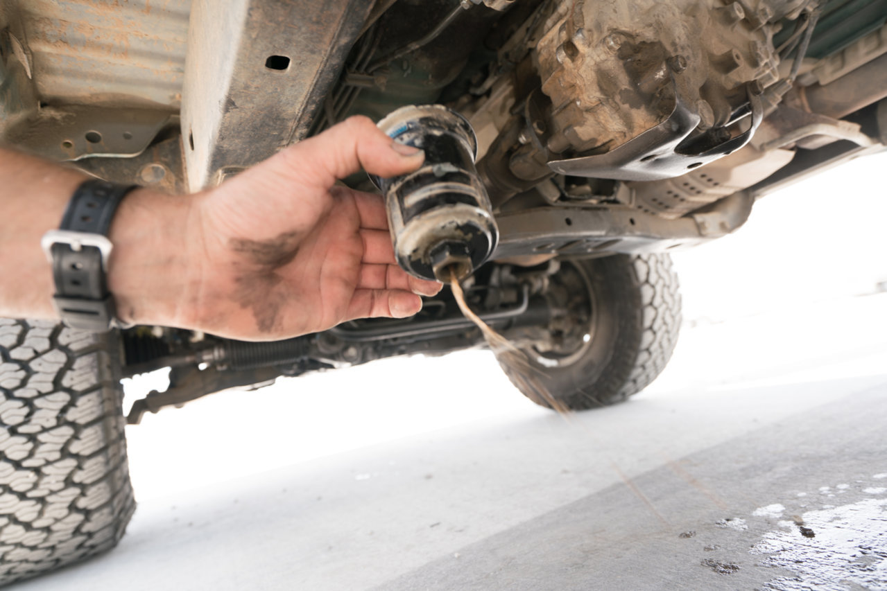

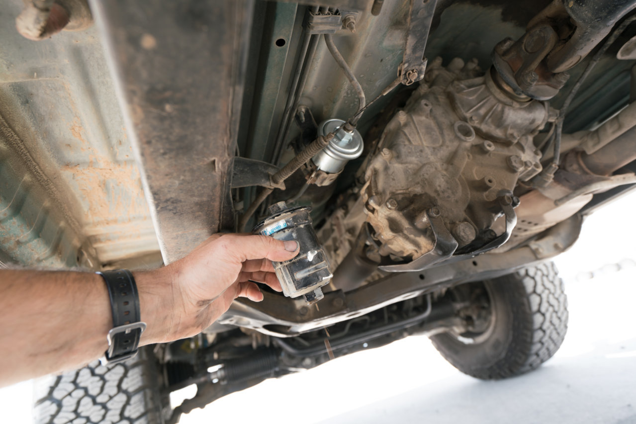

    To try and help some of the sluggishness going up hills at elevation I decided to pull of and change the fuel filter. Thanks to the previous owner the filter was from 2005.
    The wind was blowing like crazy and gas was spraying everywhere. I thought the truck was gonna burn down.
    Once I got the new filter on and gas was done getting sprayed everywhere, I shook some gas out the back to see how dirty it was and it was almost black.
    Thanks to the previous owner again, I can't check the t case oil level.

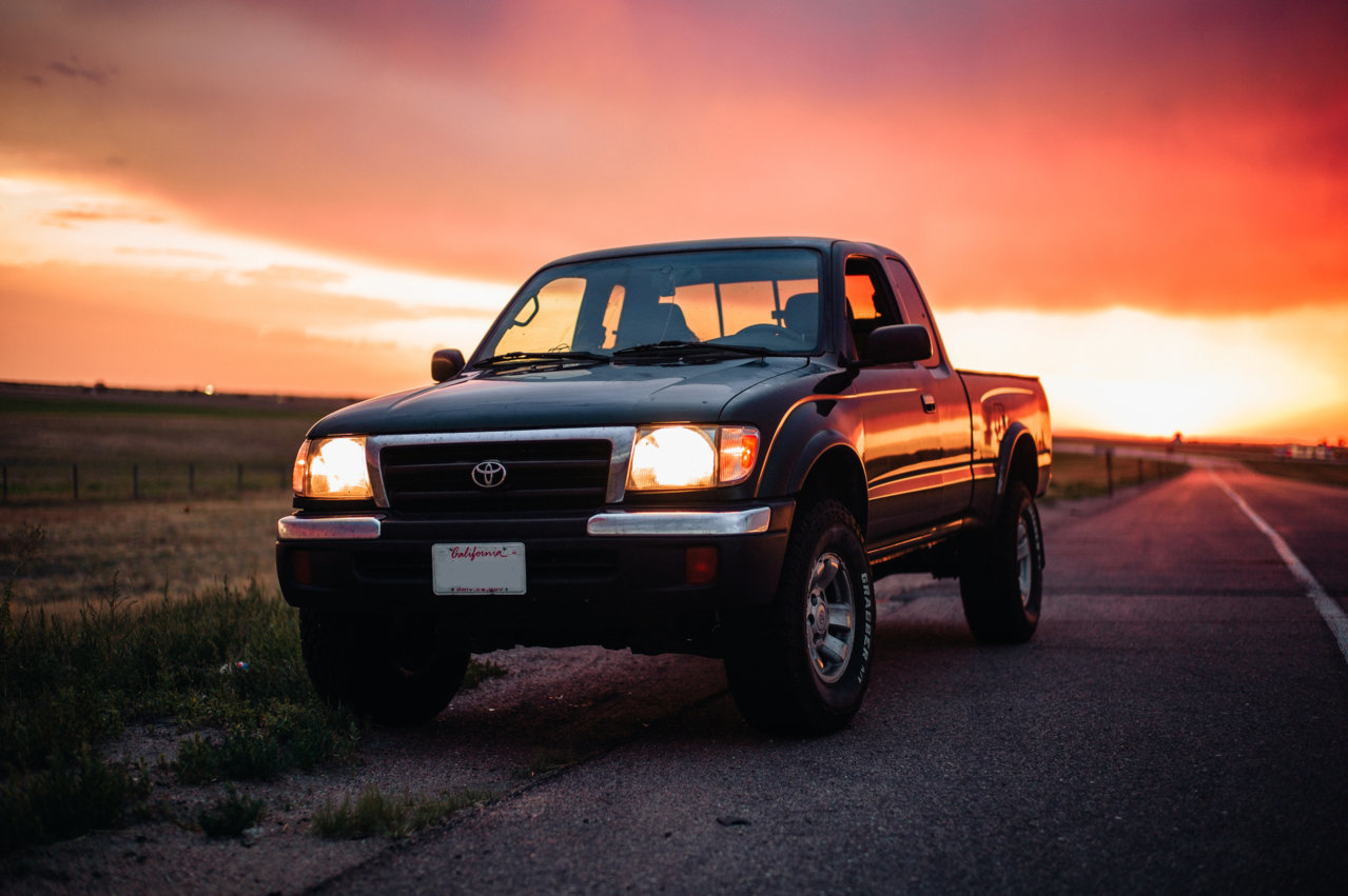

    Nebraska
    Pulled off to get a sunset shot.

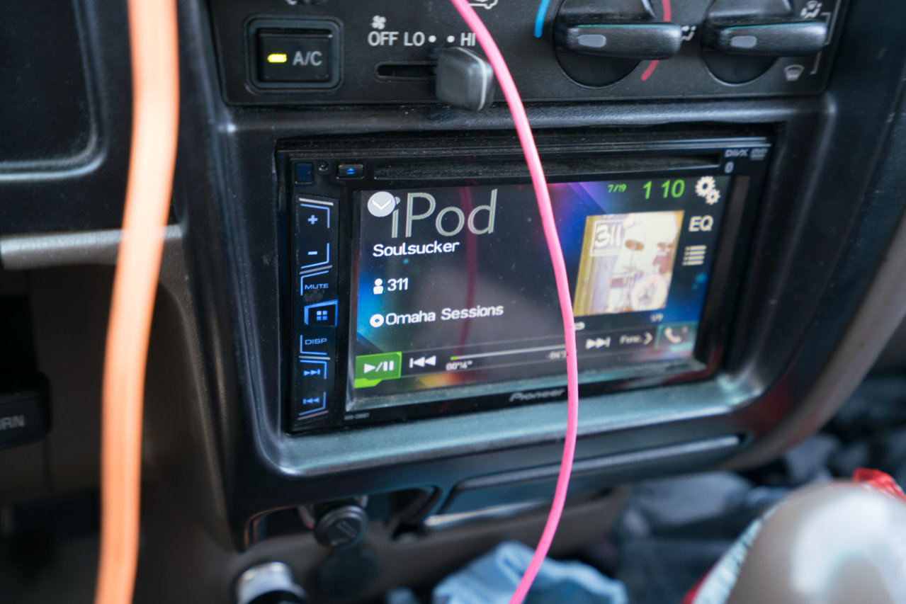

    Figured since I was in Omaha Id listen to the Omaha Sessions album.

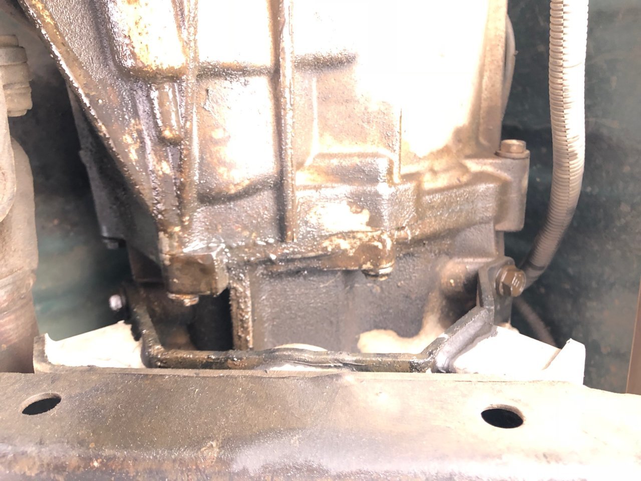

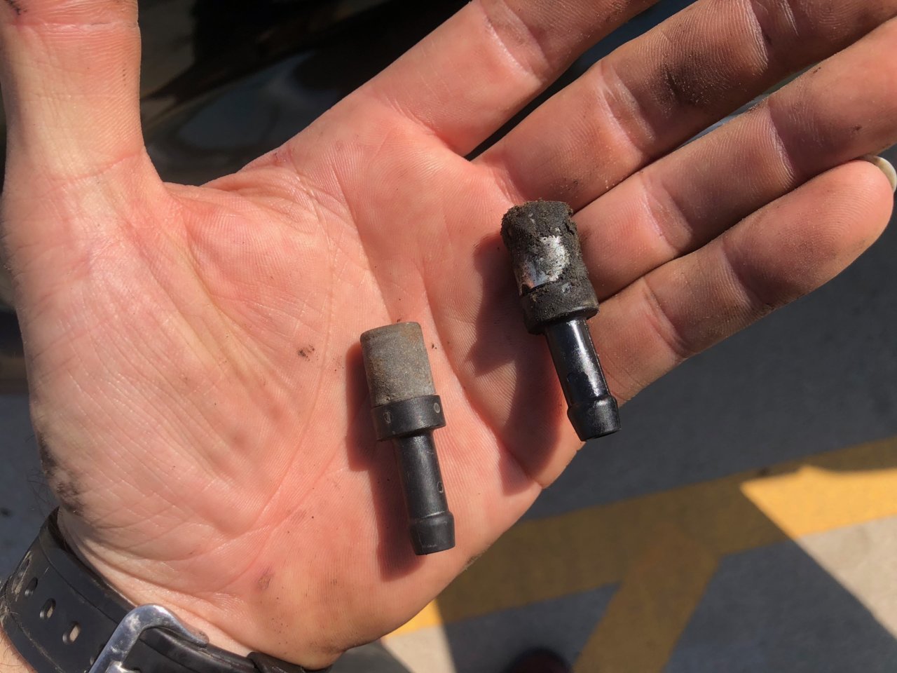

    At about this point the front diff and trans is leaking like crazy.
    While driving I was thinking why the hell is everything leaking so bad when it was all fine before. I thought it might be all the elevation. I did go from LA to 10,000 feet in Wyoming. I figured Id check the breathers. I stopped at the next junk yard just in case.
    Check the front diff breather and it was fully caked closed, so I grabbed one off a 4runnner. I tried to reach up and find the trans and t case breathers but everything was too hot so I let it go.

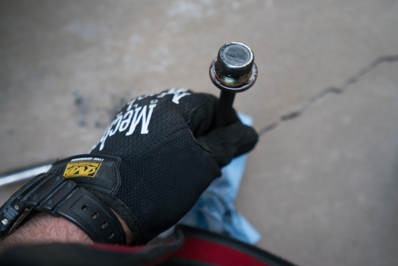

    Now I started to smell burnt oil so I pulled over right away. I check the trans and I was coming from there. It was down on oil, so I changed it at the next exit. There was anything on the magnetic plug so it looks like I got it in time.

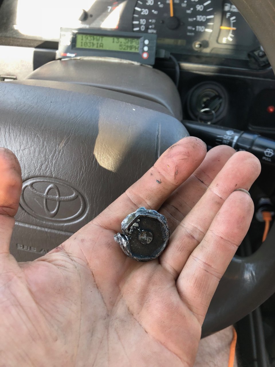

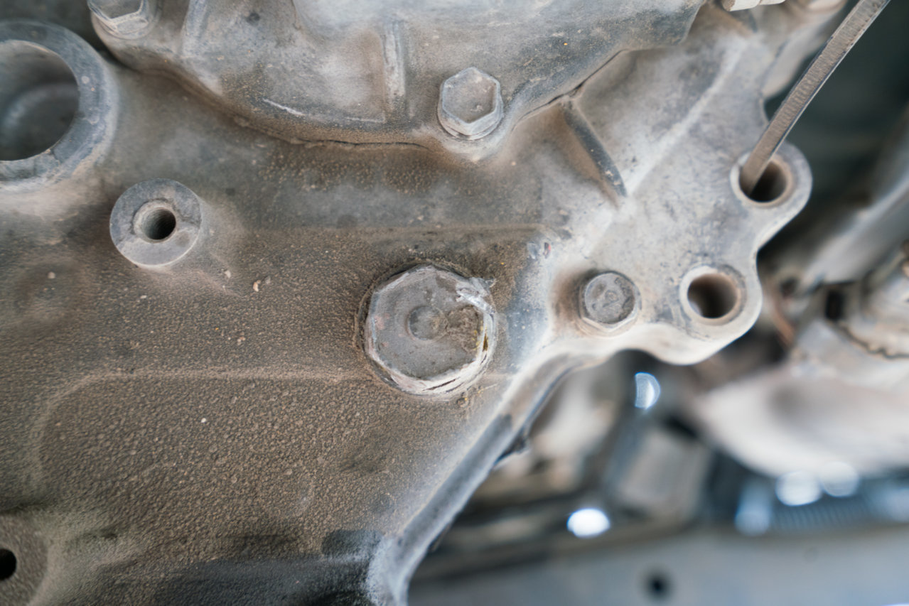

    Now at this point I desperately want to check the t case oil but its fucked. I tired my best to get the plug off with no luck. If you care about it you can read about it and see photos here... Its a long thread and an adventure on its own.

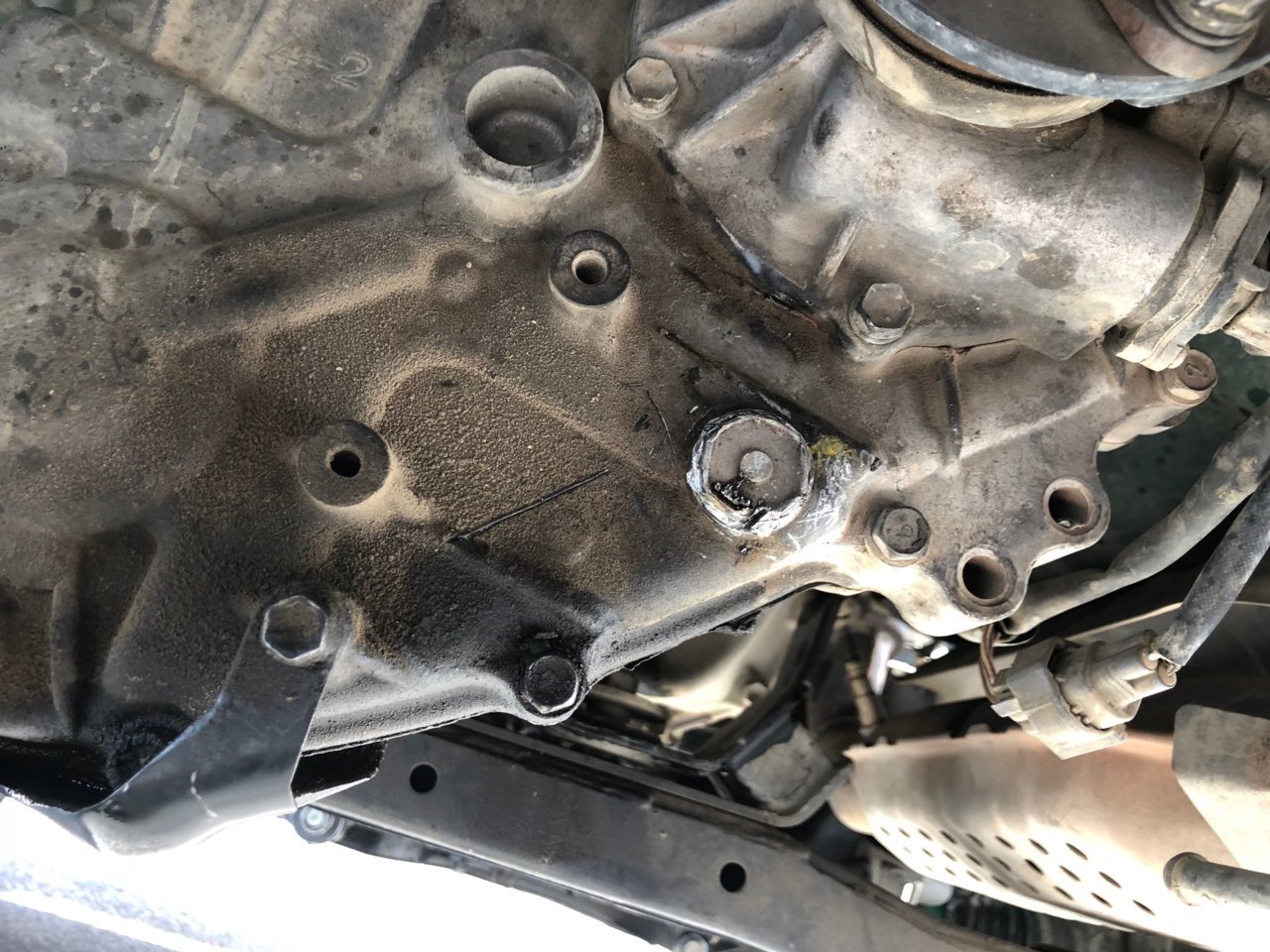

    If you're not into checking out the thread, long story short I got the fill plug out with a torch and vise grips. The asshole previous owner filled the entire case all the way to the top through the top fill plug up by the shifter. When I took the fill plug off it shot out like a fire hydrant and made a big ass mess.
    I had a spare plug in my truck so I was covered once I got it off.
