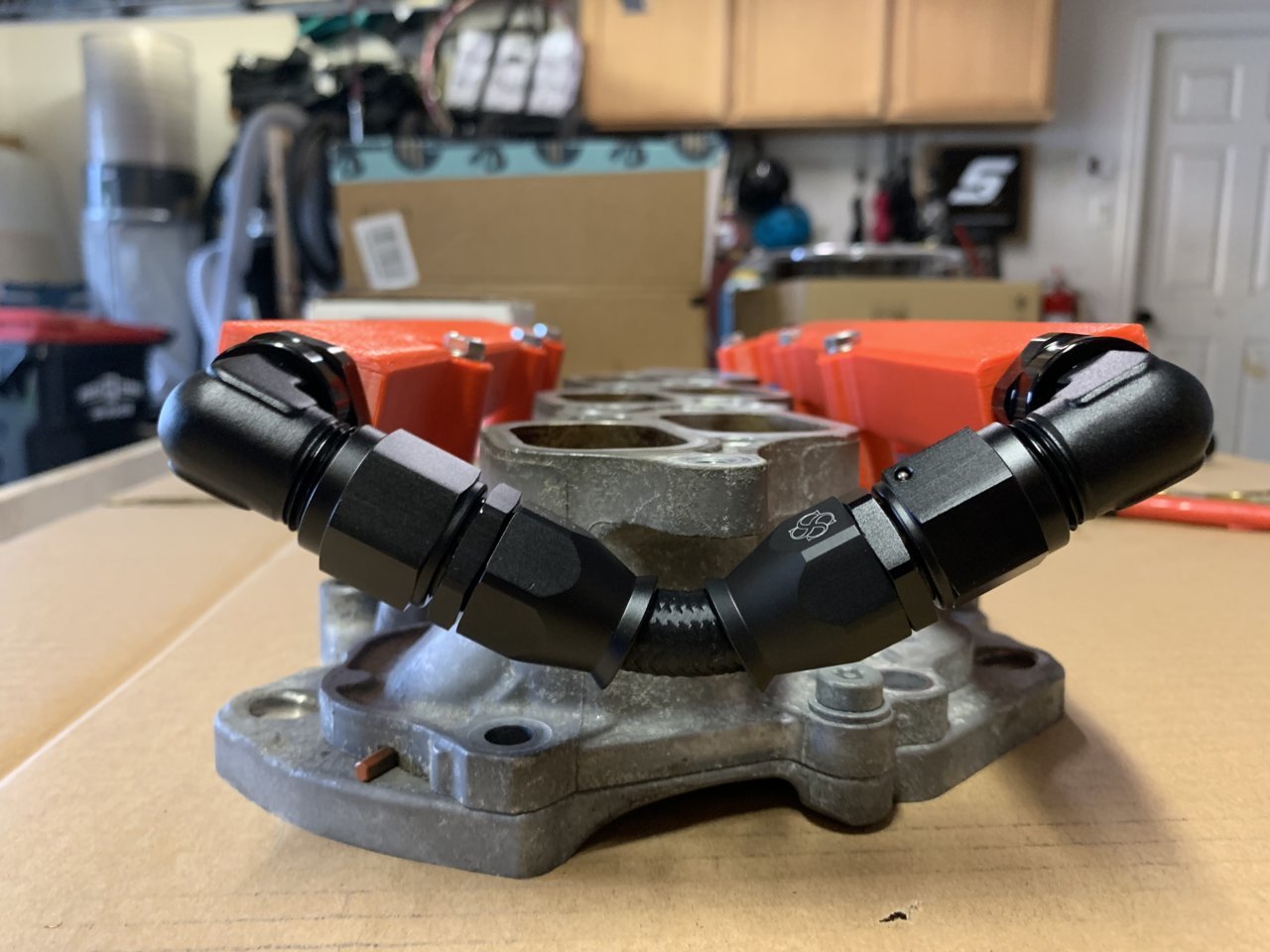

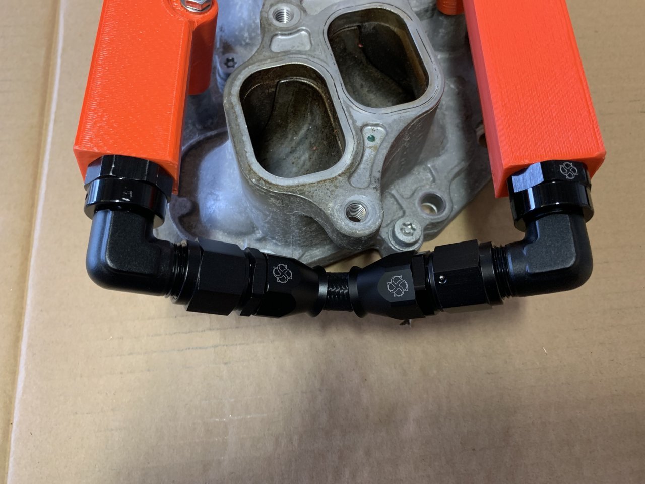

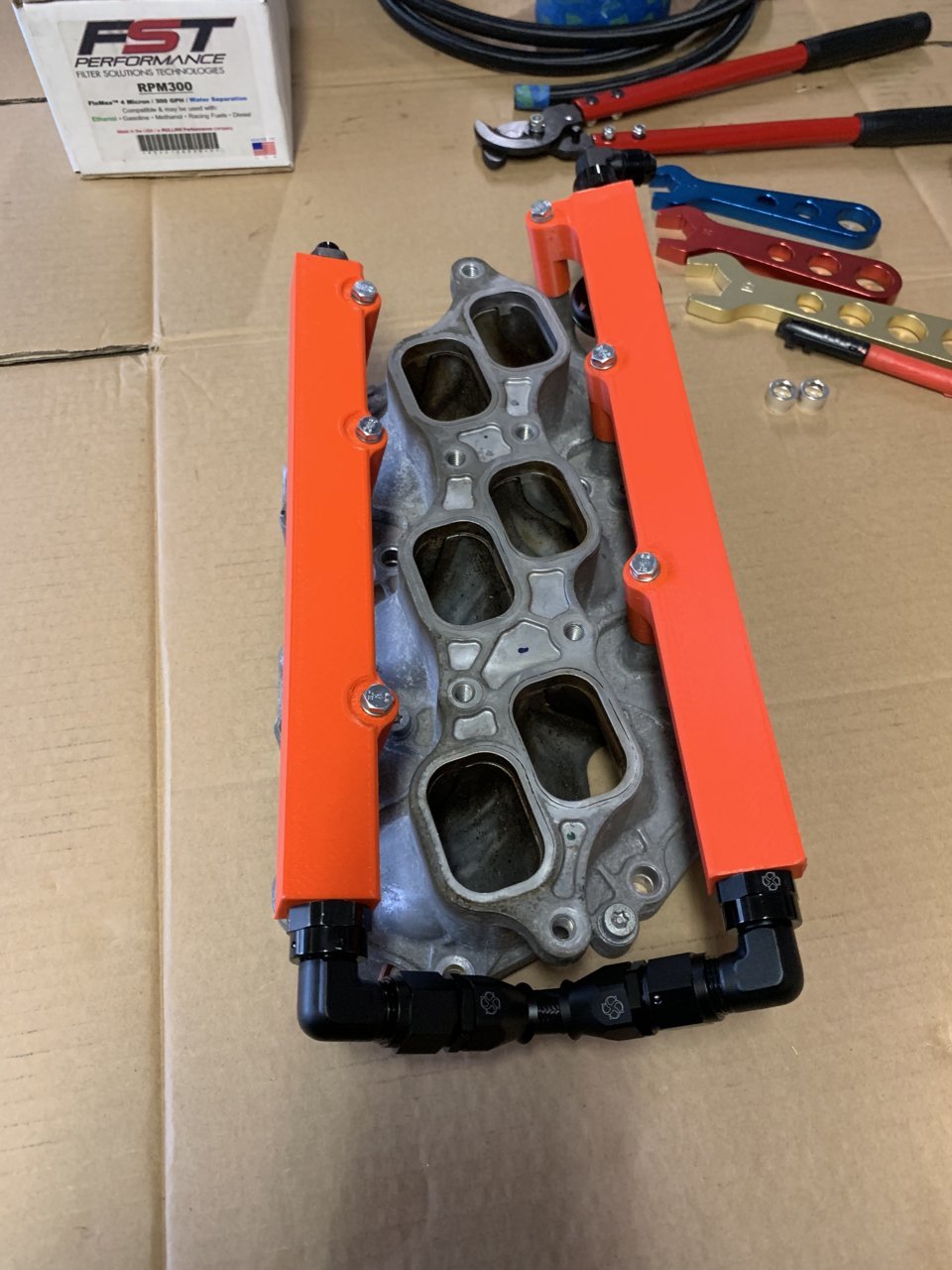

    Spent the day straightening my garage and got it to a point where I can actually do stuff.
    I did some experimenting with different fittings I have on hand for making the little crossover assembly. Since the rails are fairly close together, there isn’t much room to play. So I angled the fittings down and made it with a short section of PTFE in the middle. I think the angle is ok, the hose doesn’t kink where it bends.
    I’m sure there are tons of configurations to accomplish this but this is what I came up with. It’s raining a bit here, so I haven’t looked at the truck to see if there are any potential instructions.

  17. Jun 29, 2019 at 2:19 PM
    #257
    GT7
    GT7 One piece at a time
    Aug 15, 2014
    #136201
    2,502
    Grant
    Phoenix
    2013 DCLB
    Very clean
    JustDSM and loginfailed like this.
  18. Jun 29, 2019 at 2:21 PM
    #258
    loginfailed
    loginfailed Well-Known Member
    Aug 29, 2016
    #195923
    5,156
    Dwayne
    Houston, TX
    2014 DCSB 4WD
    Thanks, the pretty fittings make it easy to make it look good!
    I’m open to other suggestions on how to configure it. I thought about doing a hard line or compression fitting setup, but I don’t have any of that type of parts around to try it.

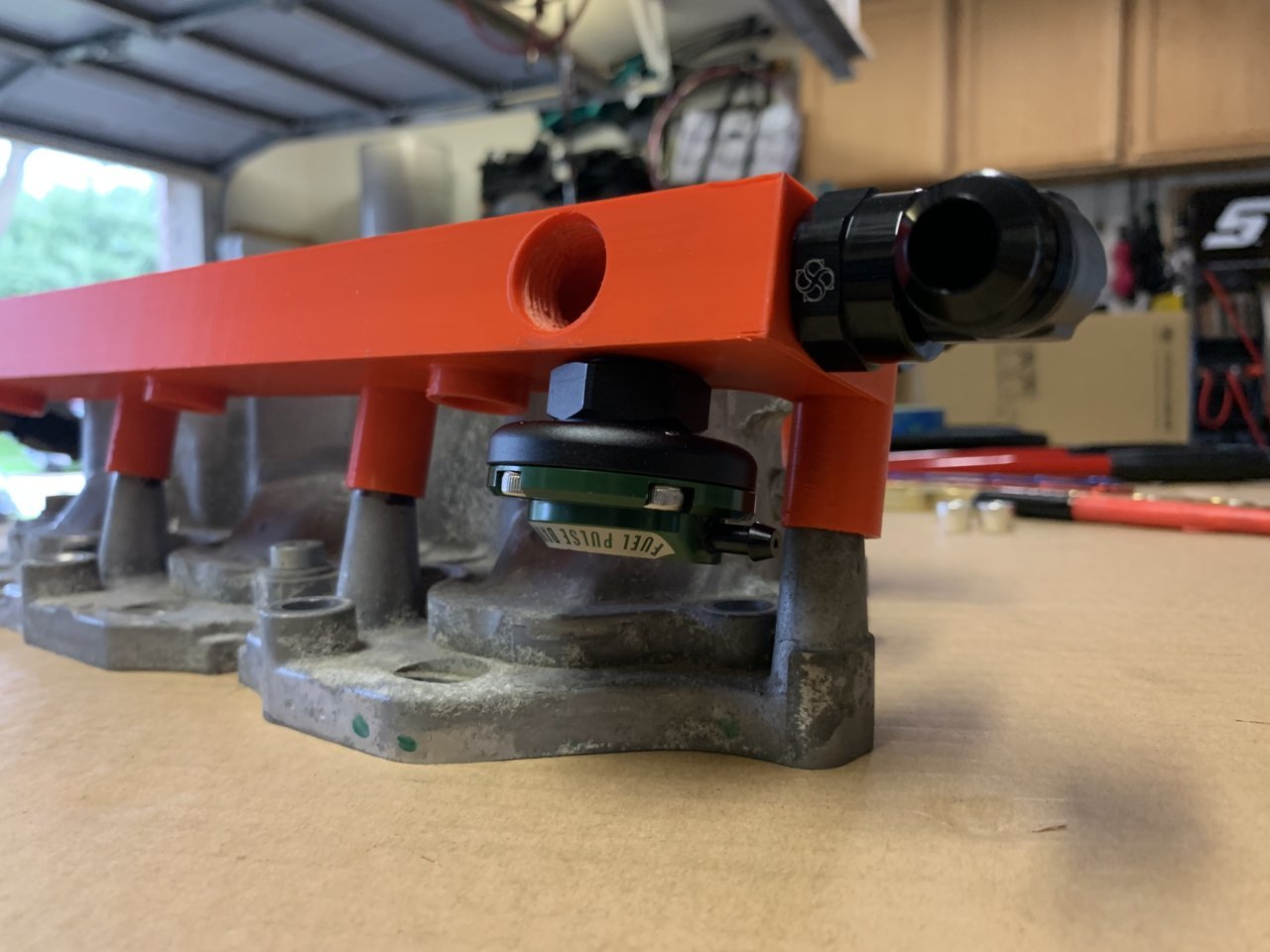

    Here is the location for the recommended fuel pulse damper. This is the firewall end of the driver side rail. It won’t look exactly like this, there will be a little bulge where it screws in to keep the damper threads from impeding fuel flow and the hole on the side won’t be there.
