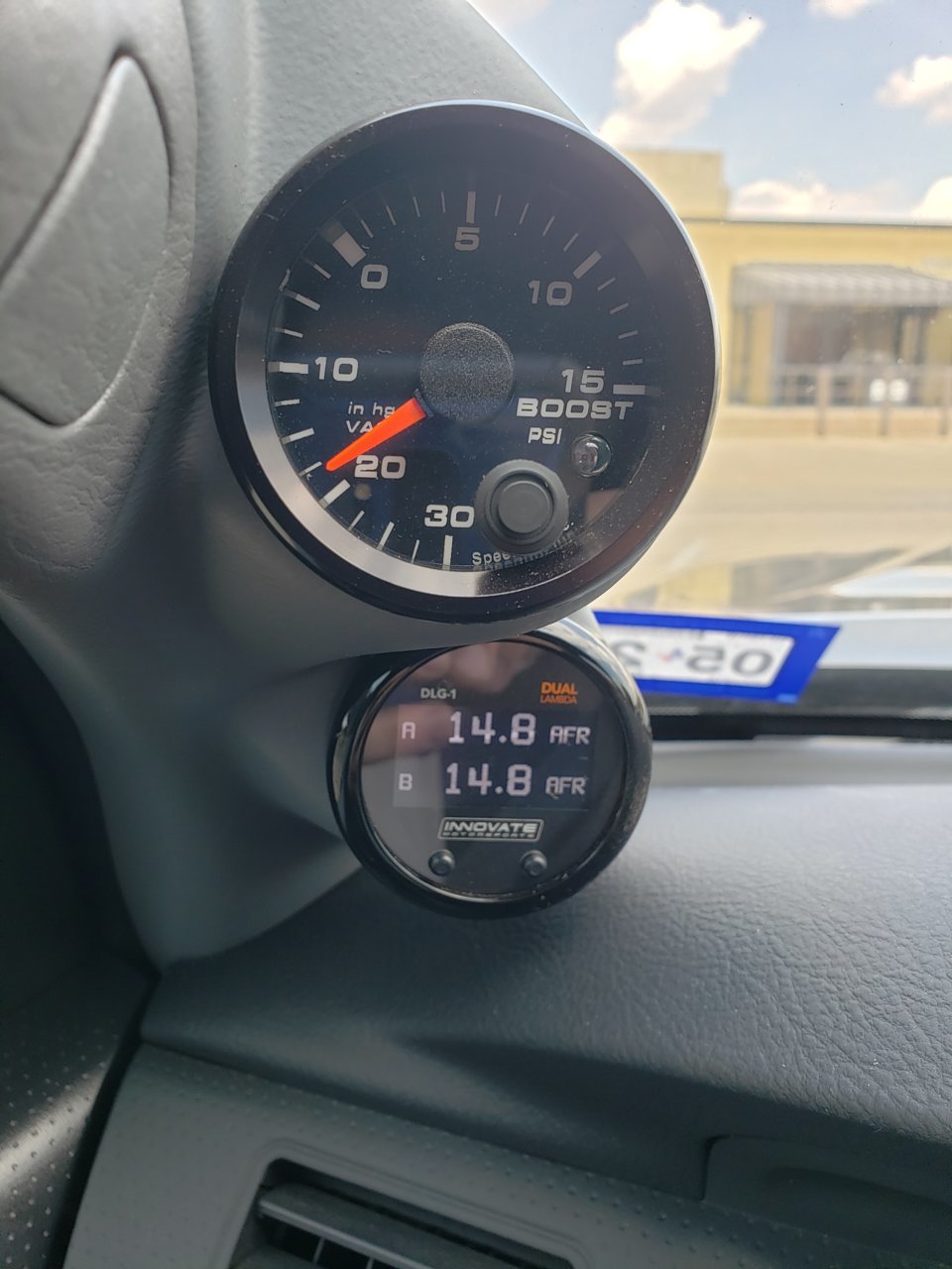

    I would go with the boost gauge that goes to 15! We sometimes go a bit past 10.
