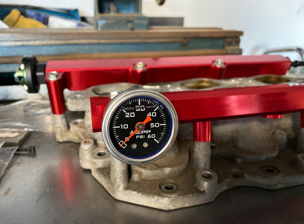

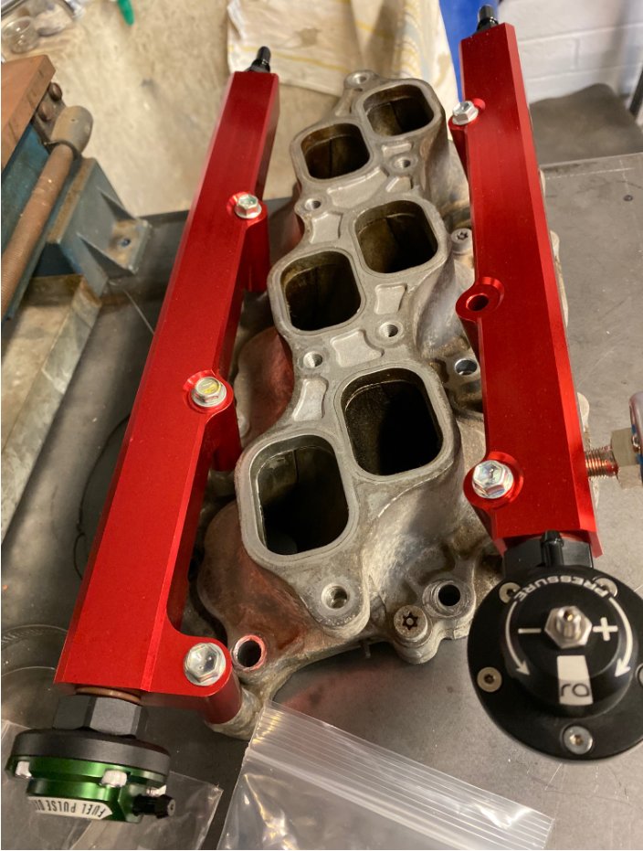

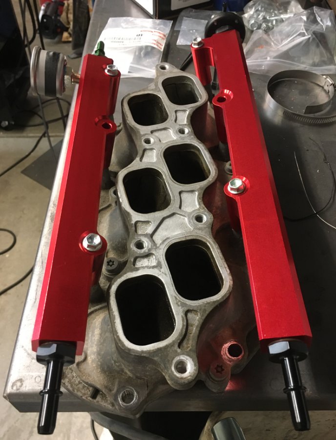

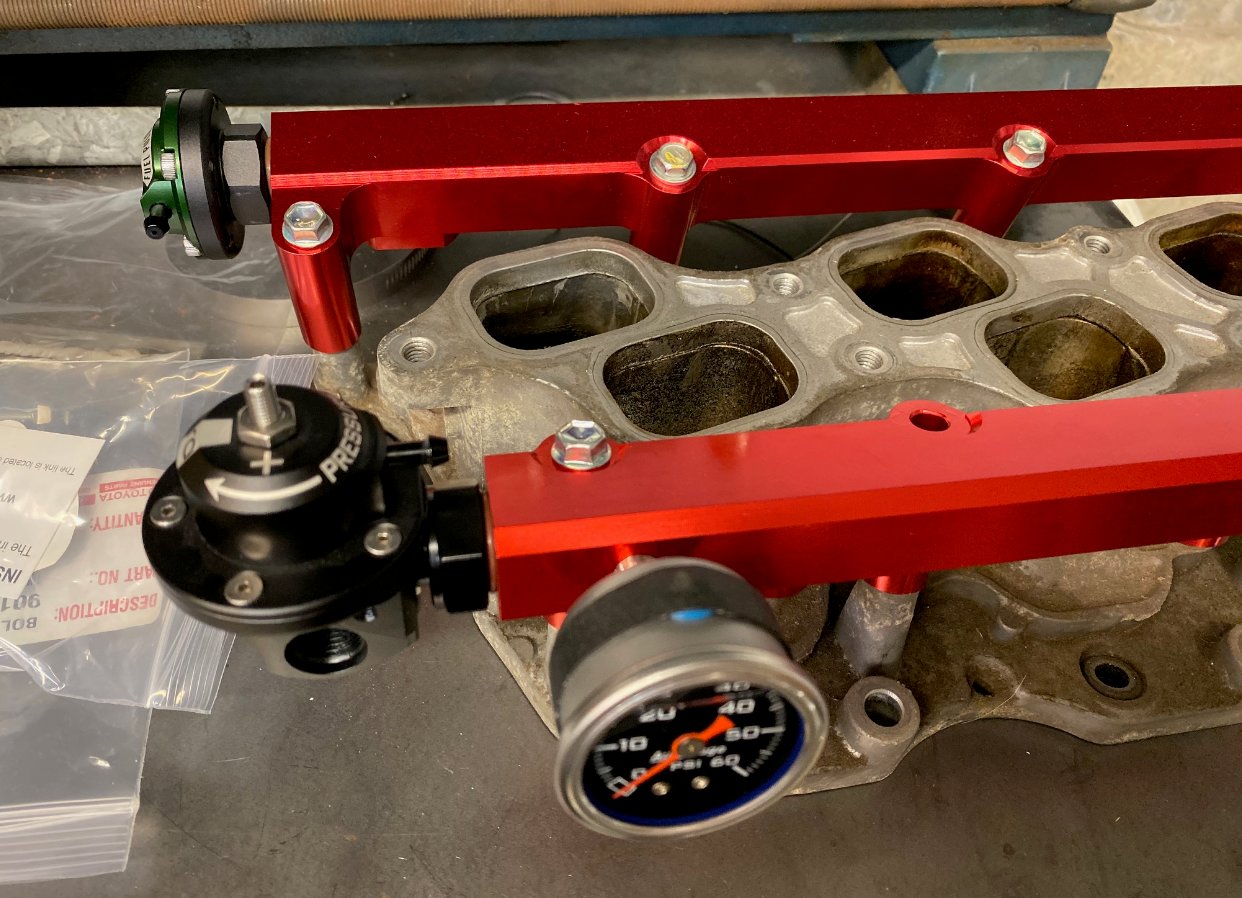

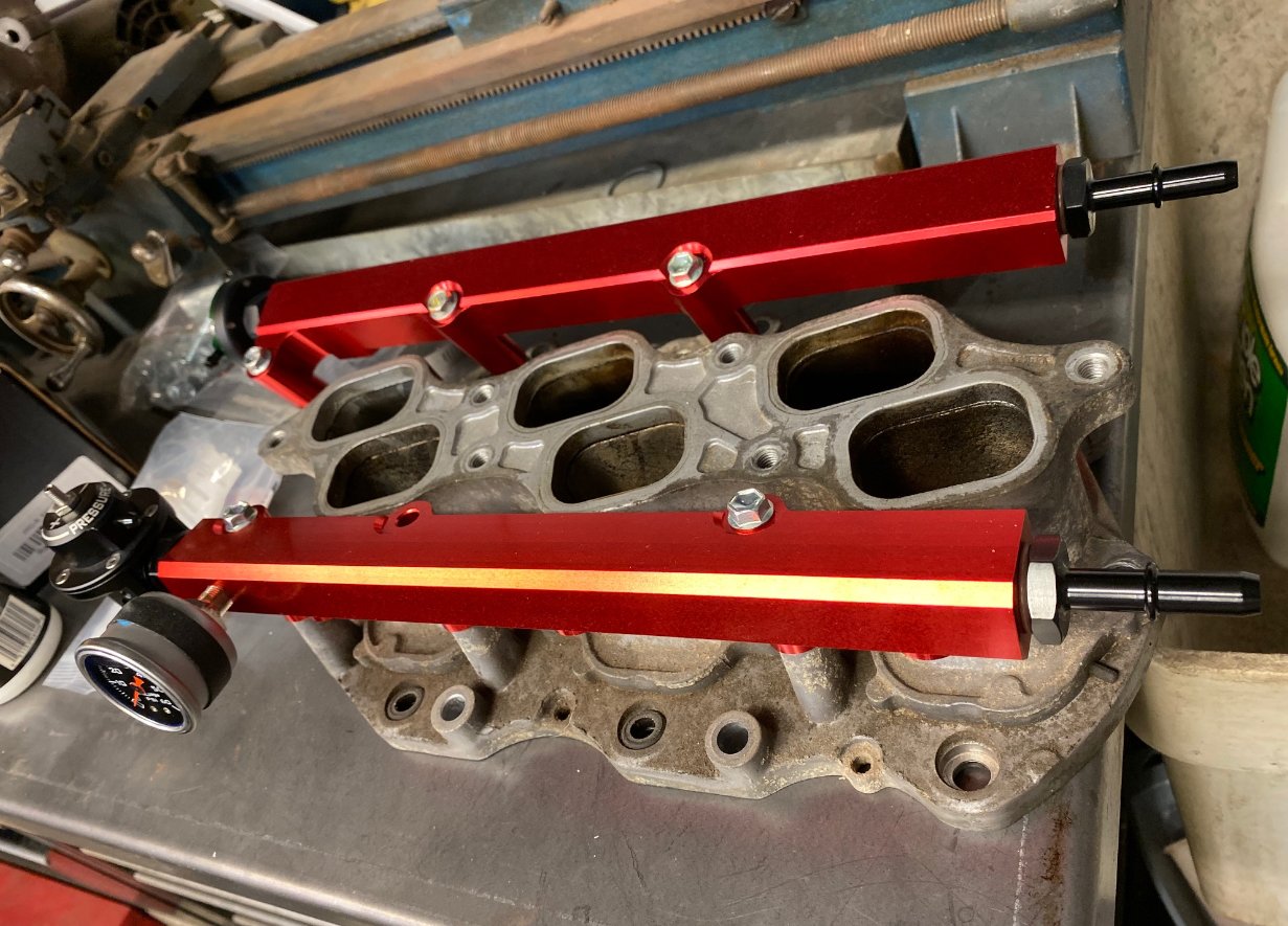

    Coming together.
    I didn't realize that the low pressure side of the regulator was -6 and not -8. So, I have the wrong fitting there. Gotta order up a couple more goodies.

    Damn.. Those do look nice!

    Did they come red or did you powder them?

    Got specs for the bolts?

    I think the stock bolts might work. If not, 91551-80665 is a perfect fit. 6x1.0 65mm long with 20mm of threads. Holes in the manifold are 25mm deep. Rails are 45mm deep.
