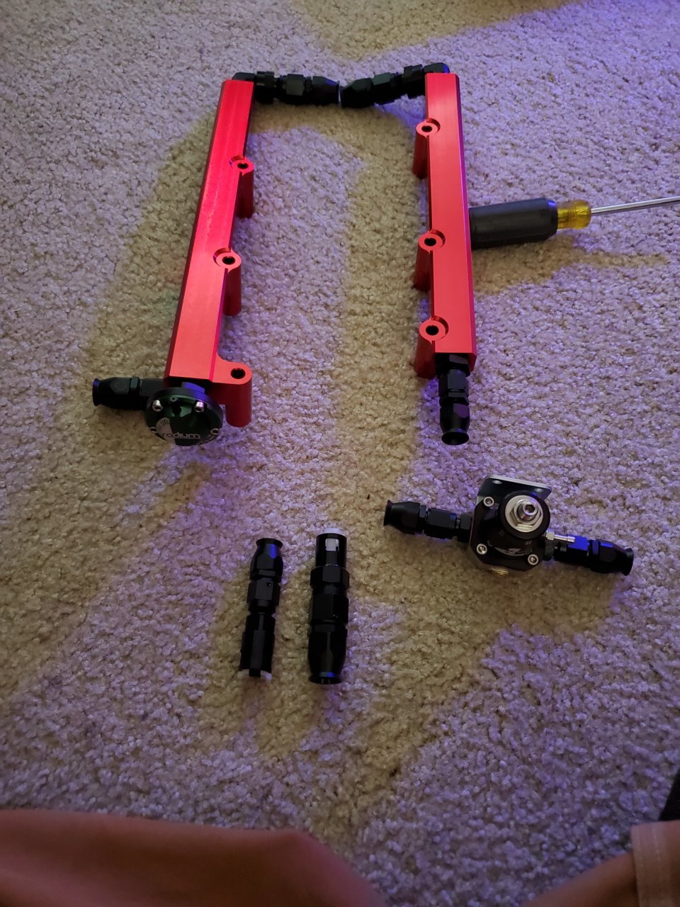

    feed back guys. do i need anything else besides the gauge? fwiw i got a few feet of fuel line each side. glad to mail off any extra.15765550077014099684755593285273.jpg

    The rail is designed to place the Radium Fuel Pulse Damper on the underside, it'll likely work in that configuration but thought I'd still put that out.

    i have no idea. i just followed the list and fit parts together according to the diagram posted here. seems like im still missing some items.

    would a 45* fitting be better? im just trying to copy part for part the diagram you made.

    so the fuel pressure gauge....by the time its sung its upside down. dare i crank it another half turn? or use my methanol glue and keep it solid that way?

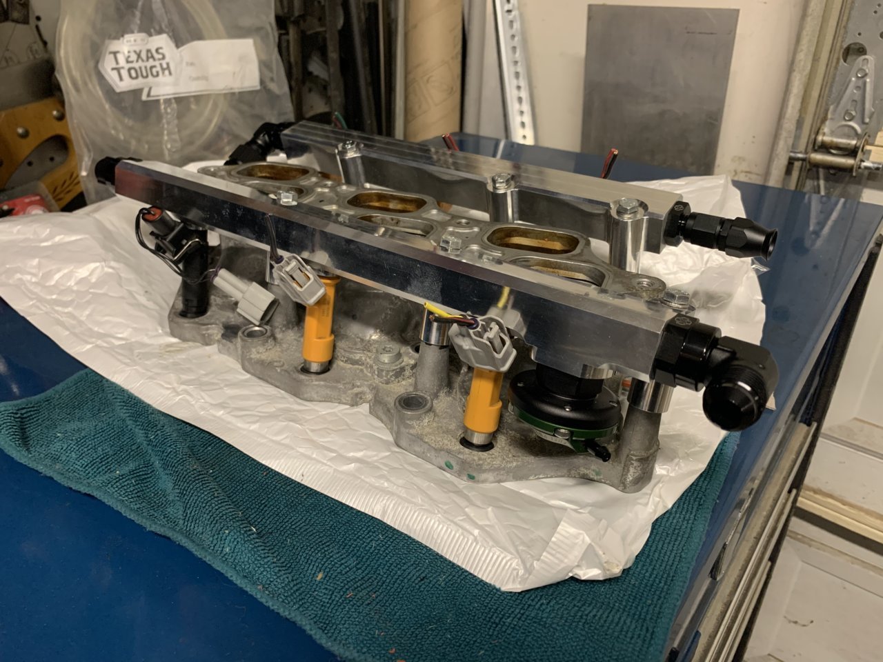

    I’m not entirely sure, but what you have in your pic for the passenger rail would probably fit. It mostly depends on where the regulator is going to go. I haven’t decided where to put mine yet.
    Like @05Taco4x4 said though, on the driver rail the pulse damper is supposed to go on the underside and the rear port is the input.

    thanks! i switched the dampener to the underside. curious on how to get the gauge oriented correctly. dont want to damage by over tightening. but dont want it borderline tight.

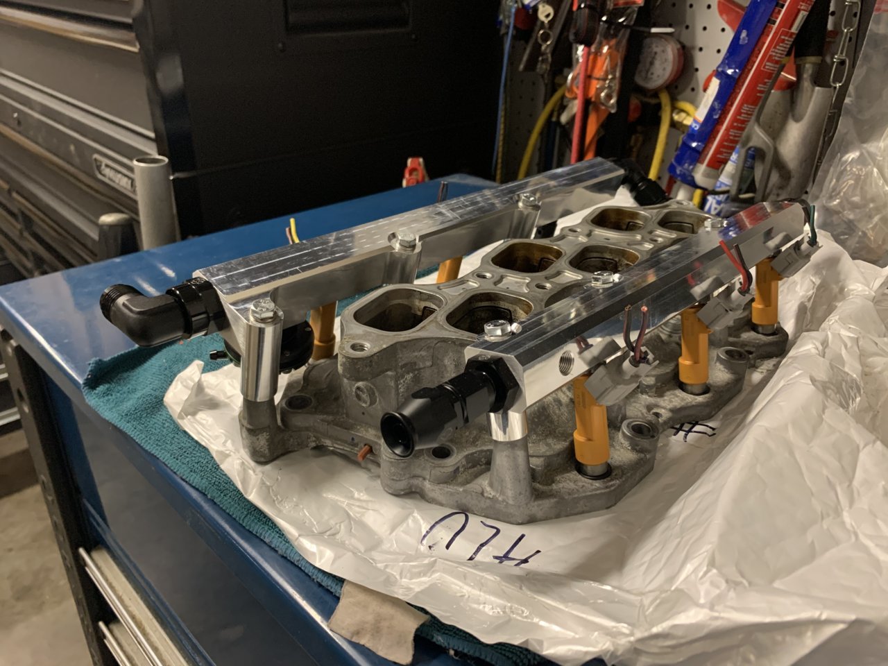

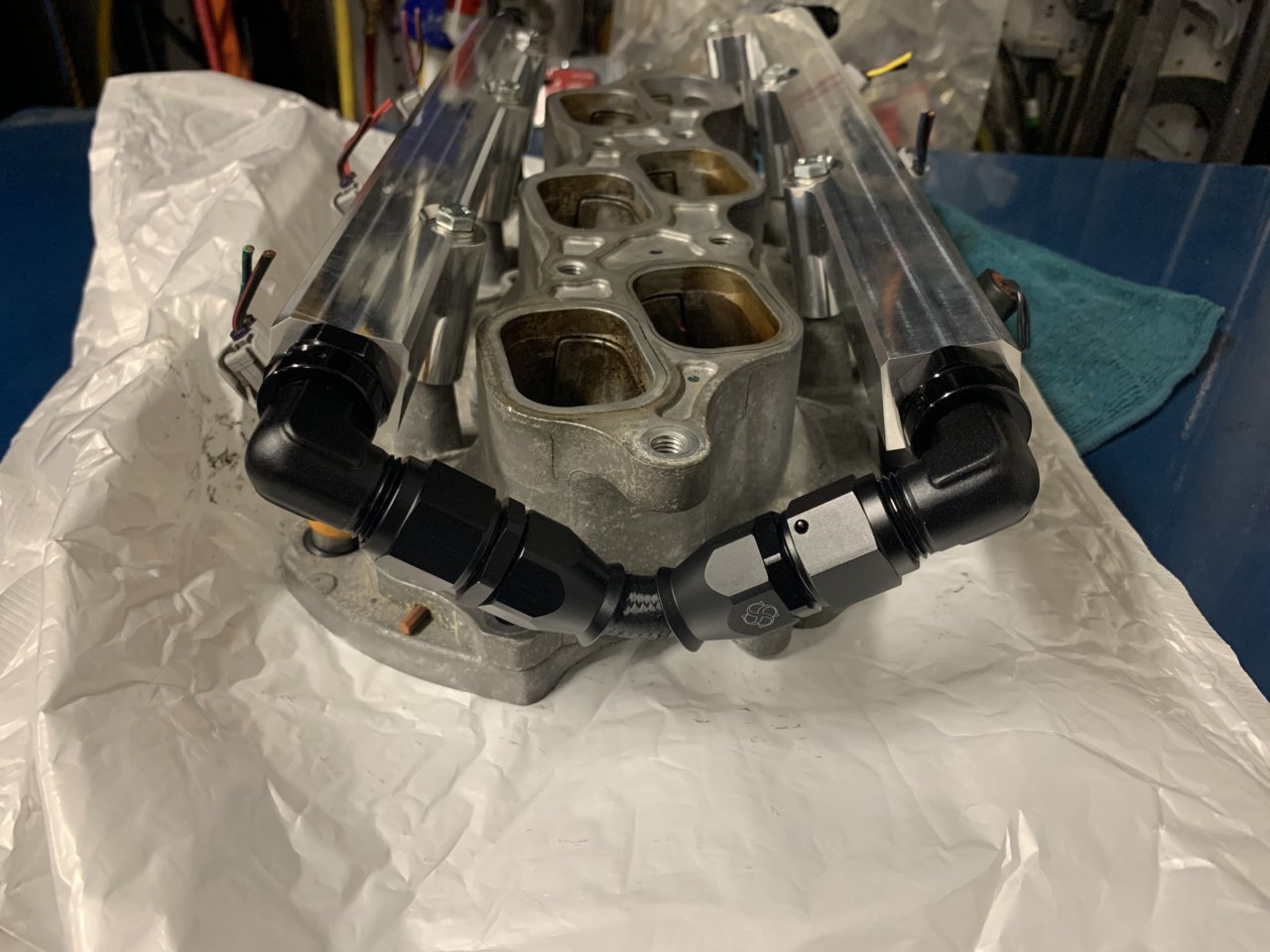

    For reference, this is how I have mine mocked up.
    Front
    Driver side
    Passenger side
  12. Dec 19, 2019 at 7:47 PM
    #492
    White lightning boosted
    White lightning boosted Well-Known Member
    Dec 30, 2017
    #239848
    8,273
    Jesse
    Poulsbo
    15' DCSB OR S/C
    Lift, pedal commander, led foglights, led interior lights, led back ups, led under lighting, urd tcai, led headlights, methanol injection, 76mm tb, hood struts, dif breather mod, ratiotek trans kit, x-series gauges, true cool trans cooler, belt wrap mod, 2.8 pulley
    awesome! quite a short section of braided line huh?
    loginfailed[QUOTED] likes this.
  13. Dec 19, 2019 at 7:48 PM
    #493
    loginfailed
    loginfailed Well-Known Member
    Aug 29, 2016
    #195923
    5,156
    Dwayne
    Houston, TX
    2014 DCSB 4WD
    Yeah I’d be careful with overtightening. Don’t want to ruin the regulator or the gauge. Maybe someone else can chime in on how to proceed in that situation.

    Yep, that’s all it needs! :rofl:
    There could be a better way to do it, but that’s the parts I had available.

    does the gauge mount to the regulator? or fuel rail? i was trying in the rail. believe i remember that from a pic here ive seen.

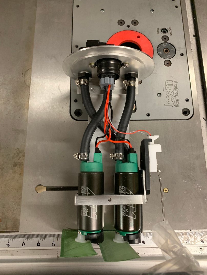

    what is this sorcery!?!?! What benefit do you get from running 2? I have 1 of the AEM I am planning on swapping out.

    It can serve two purposes. A redundant pump in case the first one fails or a staged setup in case you are making big power and need more fuel at higher loads.
    Totally not necessary. I just did it because someone said I shouldn’t. It looks bad ass though!
