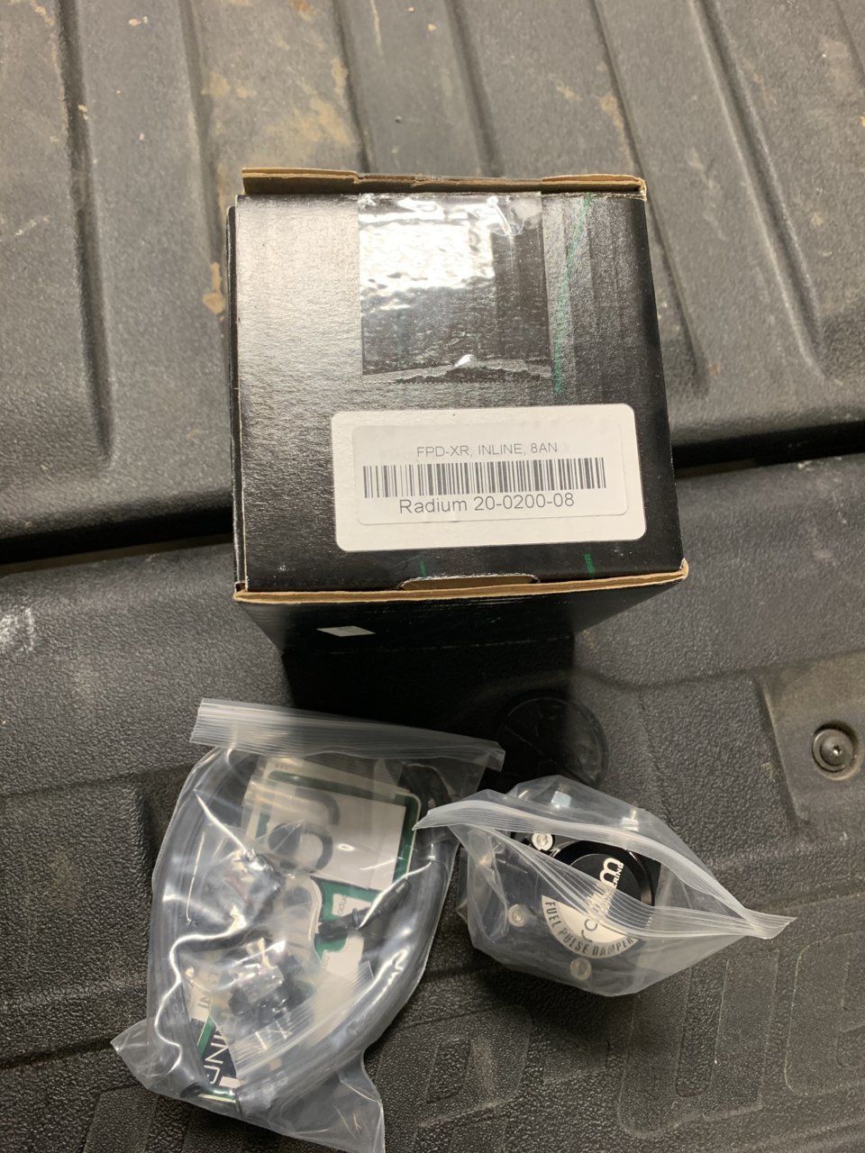

    I lied to y’all, that’s not a regulator but an in-line pulse damper. I didn’t get the direct mount because I wanted to run a different route with fuel lines just to be different. All else stays the same.

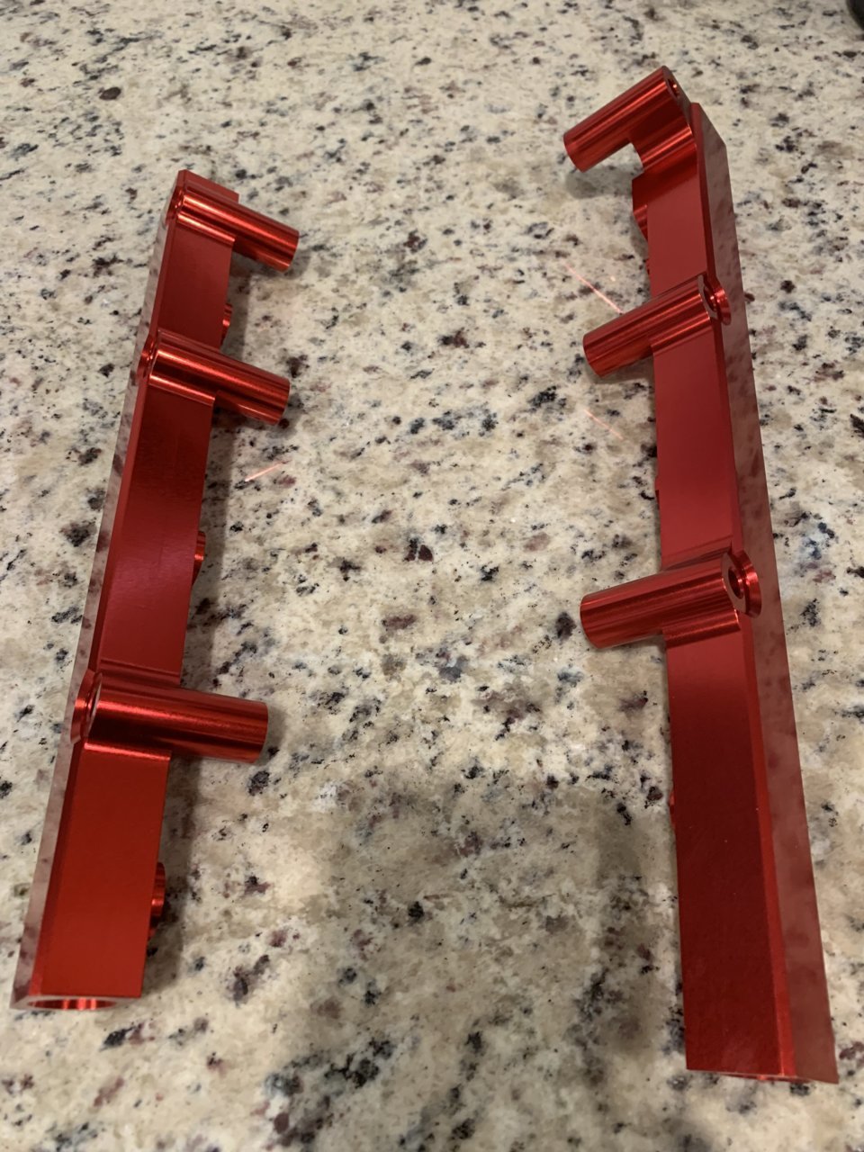

    Added
    A spacer would be needed to run injectors of stock dimension with the FIC rails; I had CAD them and was quoted something north of $100 for six little spacers roughly the size of nickels so yeah. I would get an aluminum spacer from the hardware store, cut/sand to size and drill a hole in it if was me haha

    I have to say, I am a little disappointed that no one has installed theirs yet- I need car porn too

    i want to but unsure of how to mount the regulator.
    i believe i have all the parts.

    Which regulator do you have?

    If Radium, just screw into back of passenger side rail, cap off one of the two holes in the regulator and return the fuel with the other hole.
    Not necessarily clocking it like this but you'll get the idea with this pic

    think i need to put a 45* on it. just tough in winter no garage....and nobody to copy:anonymous:

    Yes, and I'd remove the bracket

    Or you could mount it remotely and attach a line between the two.
