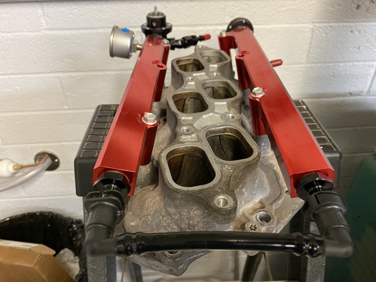

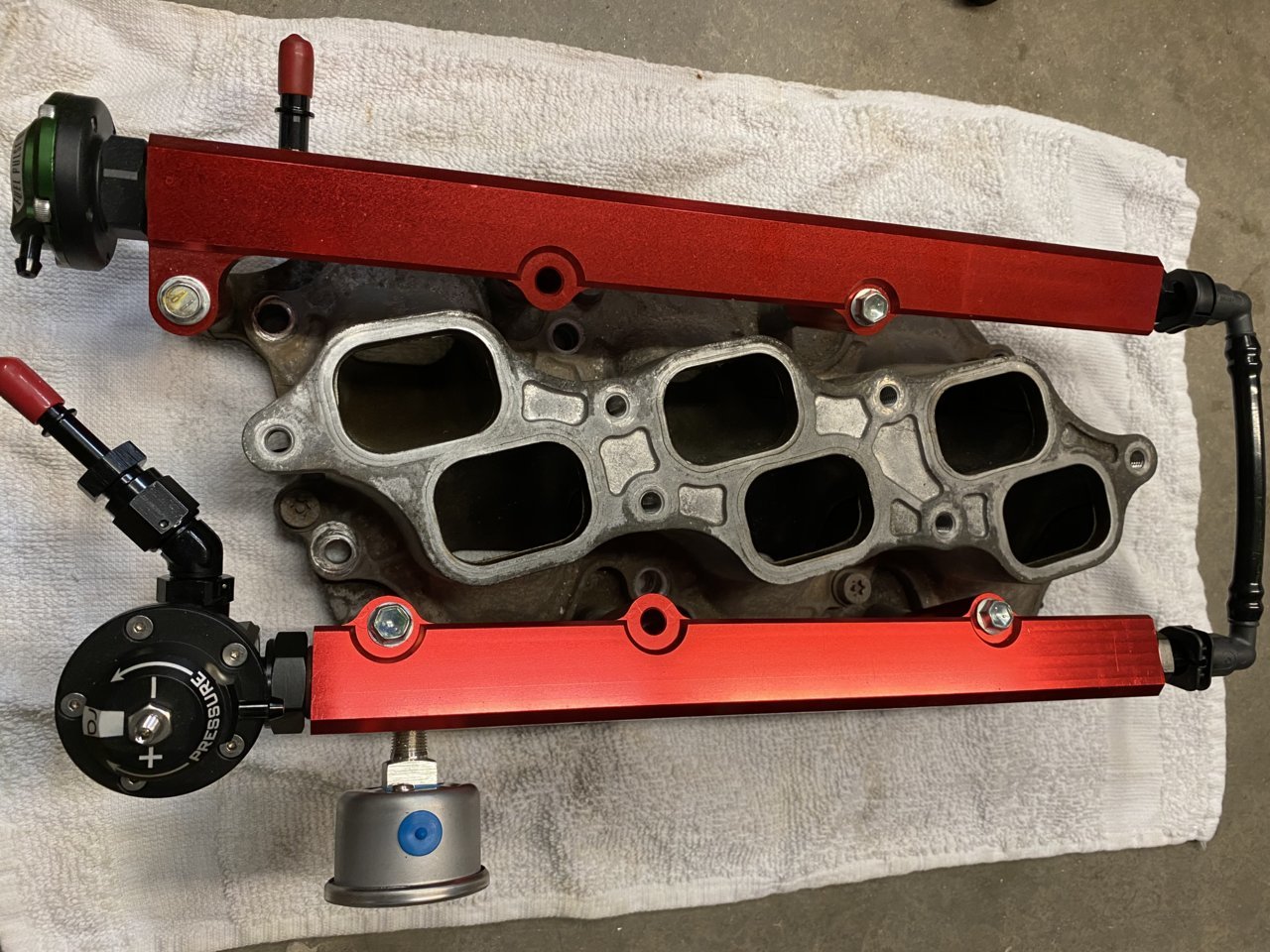

    Well, I finally got around to making the dumb crossover tube. So, these things and the new squirters are ready to go in the next time I have the blower off.

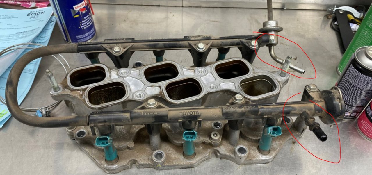

    Is that a security torx bit I see on the intake? Why Toyota... what a joke

    Random bolts. I like how they sold a bolt for the 3.4 S/C it’s just called the mystery bolt.

    Yes they are. That gasket between the halves, is not a purchase-able item either. Or at least not in the past. So unless welding it together, don't disassemble it.

    Looks great. With the way you've setup your fittings, that will be a very quick swap in.

    My guess is that there’s some machining happening after those two parts are bolted together. They use the special bolt to deter someone from pulling it apart and ruining things.

    At first glance I thought it was used to bolt it to the motor. So glad to learn that it is not and I definitely should not take it apart. Your setup looks great btw.

    Thanks. That’s the idea. Wanted to make it plug and play as much as possible. I can always upgrade the fuel lines in and out in the future. But, it’s really not necessary. The stock stuff is more than adequate for the hp levels we’re playing with here.
