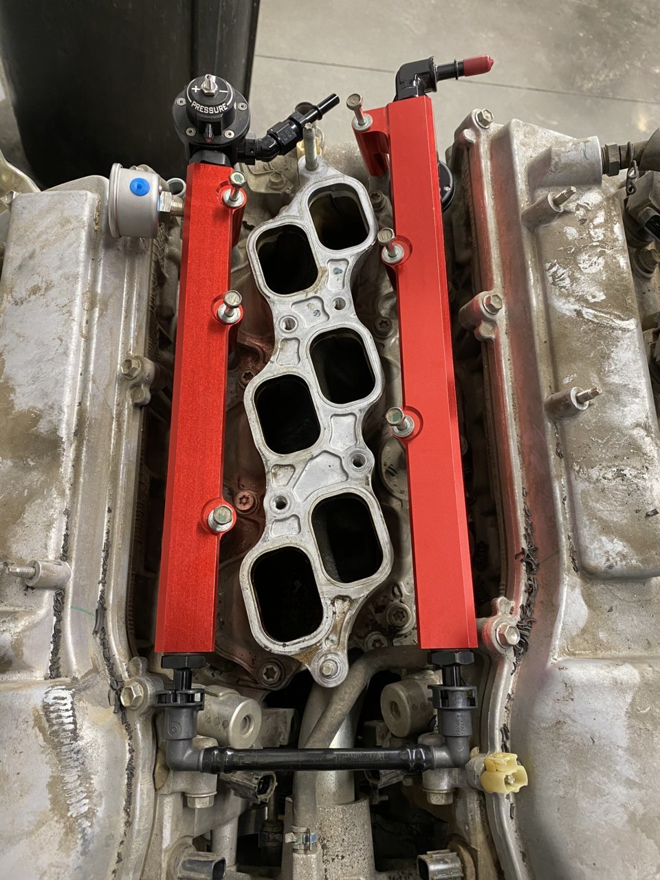

    I'm not positive that it won't I guess. I could swap it with the dampener if I need to.

    I've seen your other work, so I know you'll make it work. Just wanted to bring your attention to that.

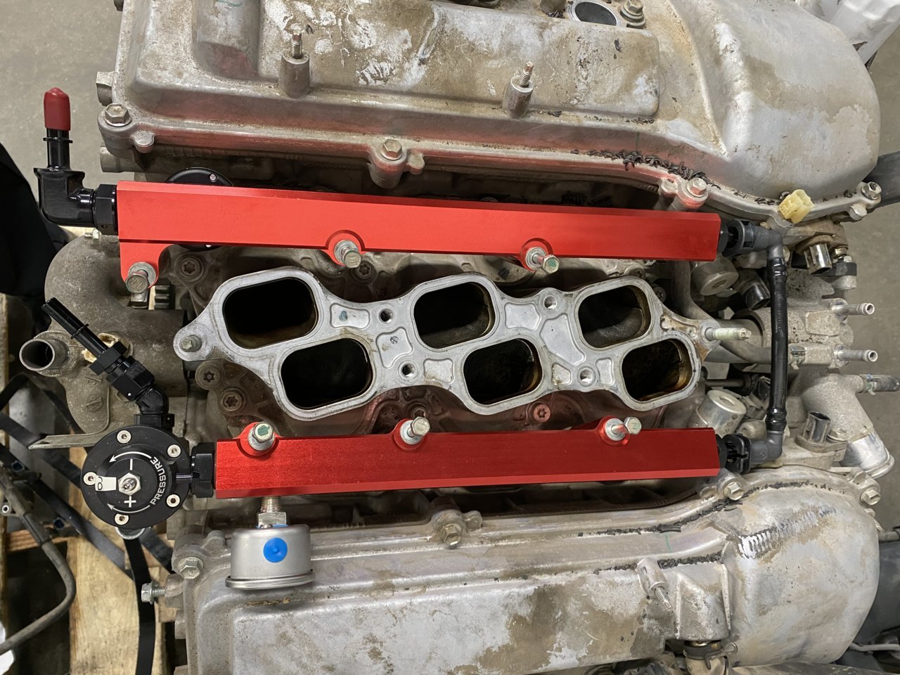

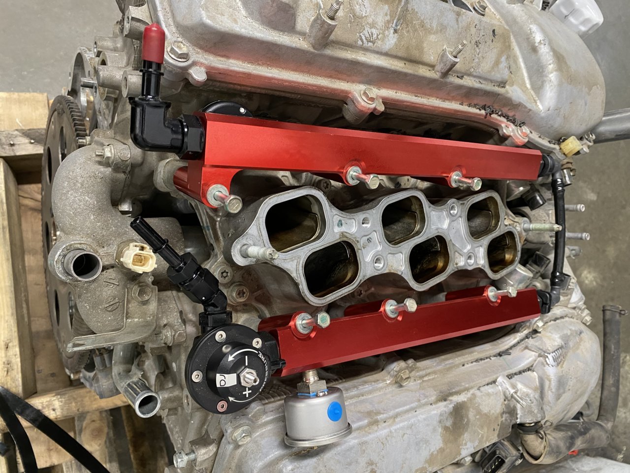

    Yep. Had to swap the damper and the inlet. Otherwise, it all looks like it’s going to clear just fine.
    Pressure gauge seems like it may need a re-think. Not really a necessary part. And it's a bit of a liability as well. May just end up capping that port.

    Keep it on long enough to set the non vacuum referenced pressure on the pressure regulator, then take it off.
