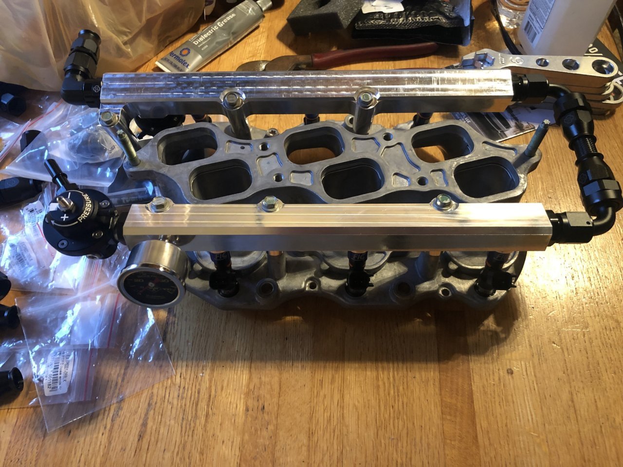

    Somebody is getting excited!

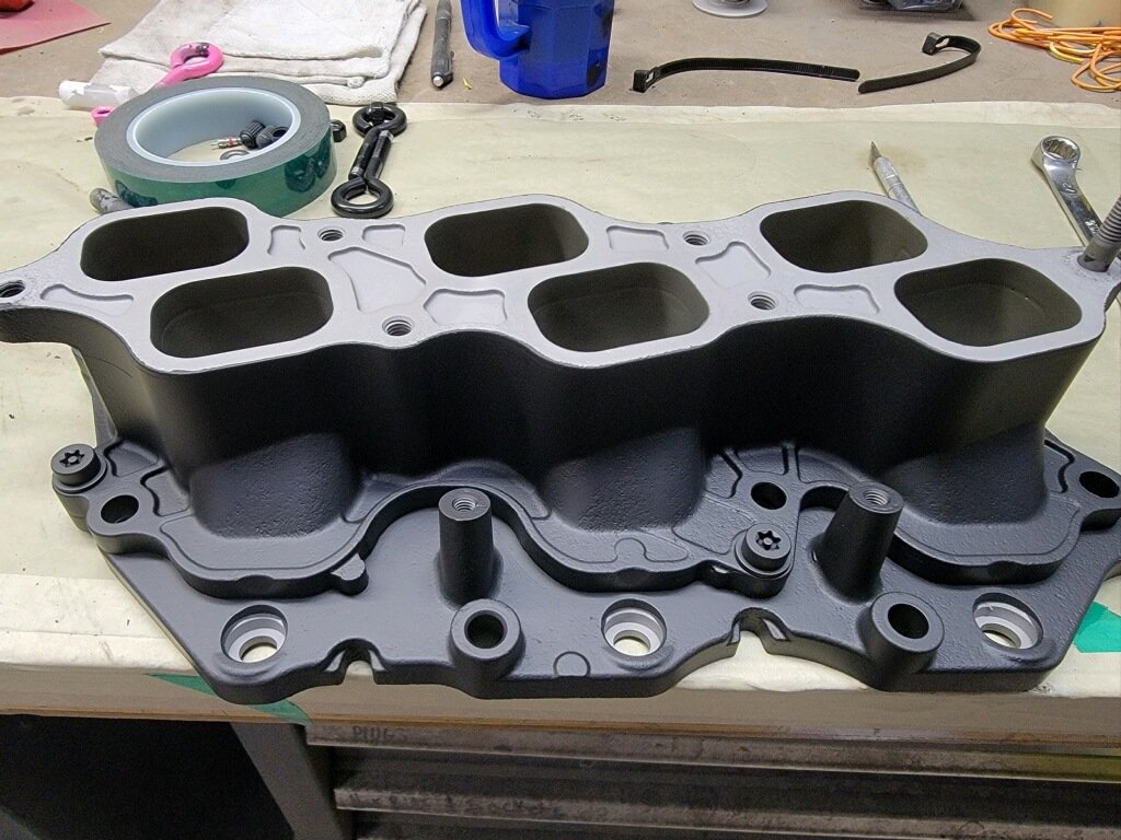

    Yes, but only to check fitment of everything else. I redesigned the crossover, didn’t like how tight together those fittings ended up being.
    Decided to do a bunch of other installs with the entire front of the truck ripped off. Should be together relatively soon. Running stainless hard lines and a bunch of electrical work right now. Have stuff out for nickel plating and powder too.

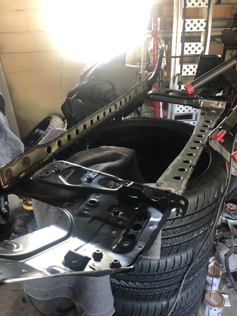

    I’ve had most of everything installed (Ron Davis, URD FMIC, SC, plumbing, Howe pump, Tundra rack, etc) to check fitment and braze gussets all over the core support. Still have the reinforcements around the holes cut for pluming to do. I let this project snow ball into a bunch of sub projects.
    Thermal emissive outer and piston coated ports.
    Fresh core boxed in.

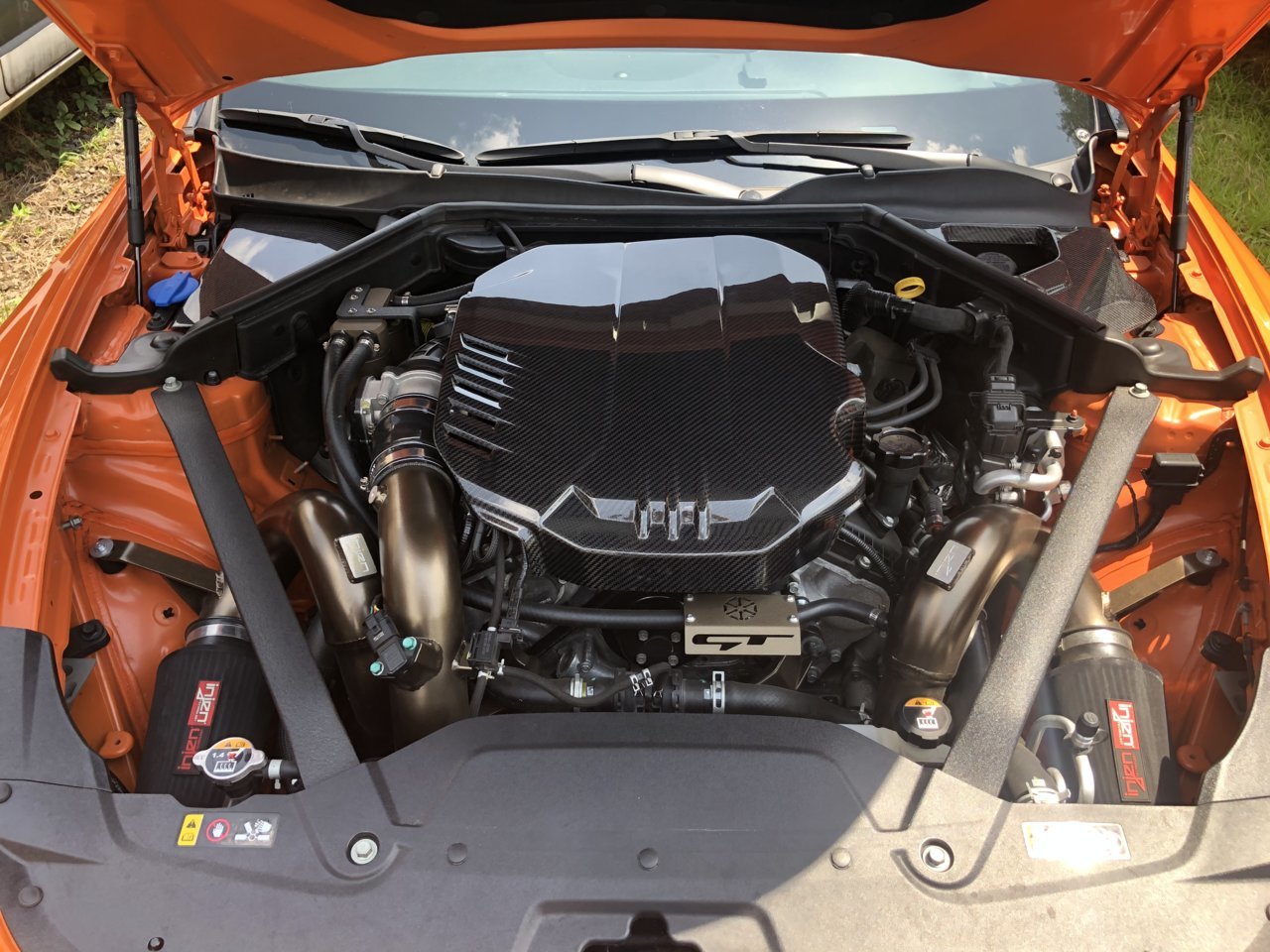

    I’m going to figure out some core braces diagonally from the inner fenders so those little pieces above the headlights aren’t so tasked.
    I was considering boxing those little pieces, but think struts will be better.
    Something like these…

    So does this car have a history of cracking the core support?
  12. Aug 9, 2022 at 12:17 PM
    #692
    Hawk373
    Hawk373 Well-Known Member
    Dec 10, 2013
    #118276
    1,321
    2012 TRD Sport DCLB
    DMZ, ADS, King, JFR, SOS, ECGS, LSK
    Just how it’s designed from factory.
