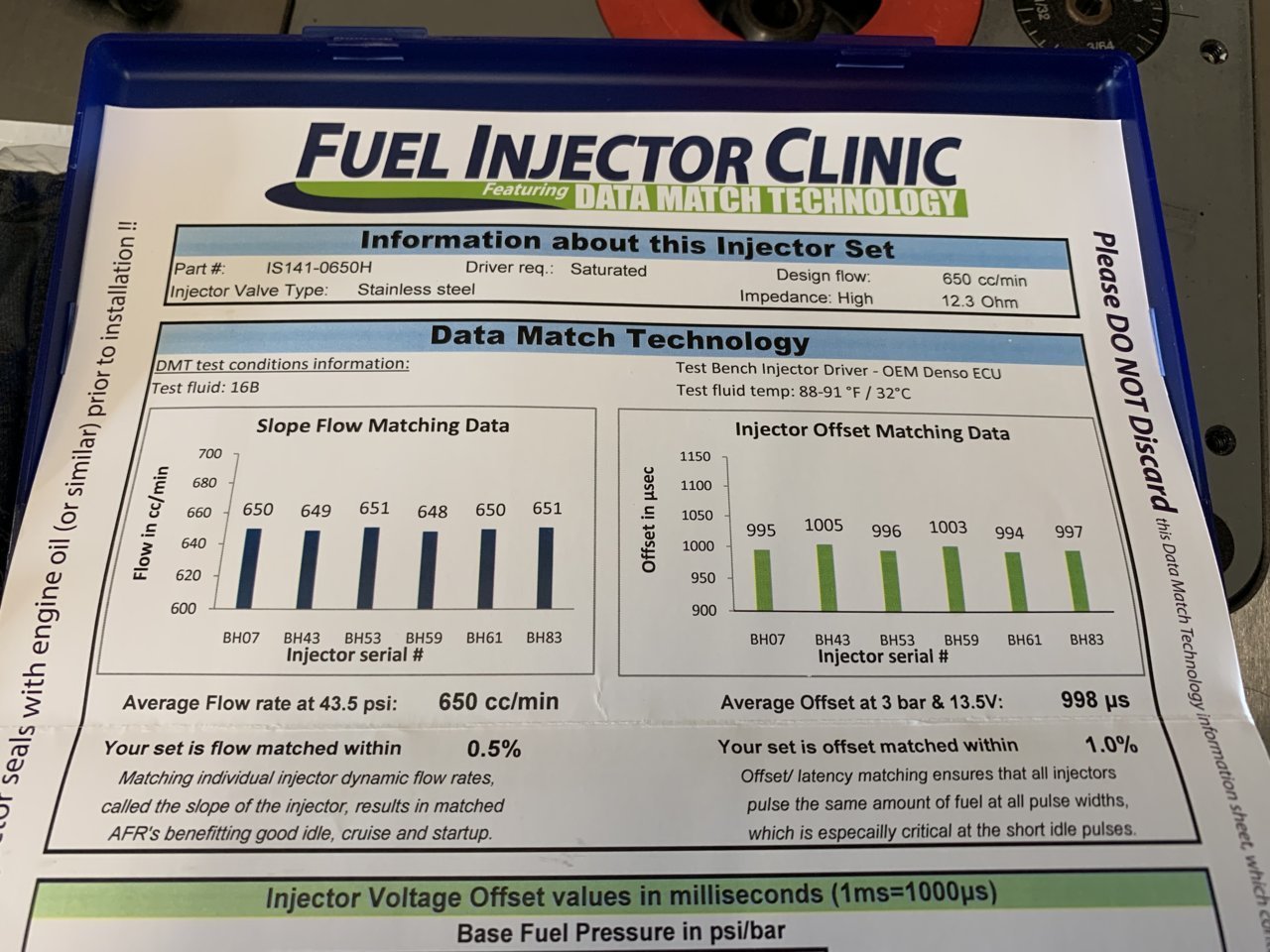

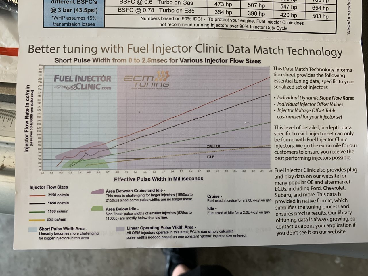

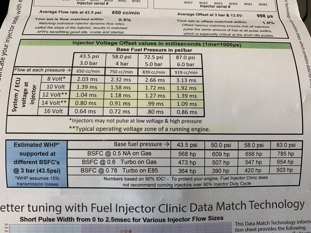

  18. Jun 12, 2019 at 5:04 AM
    #78
    loginfailed
    loginfailed Well-Known Member
    Aug 29, 2016
    #195923
    5,156
    Dwayne
    Houston, TX
    2014 DCSB 4WD
    Yes, they take tons of the same injectors and test them. They then assign a serial number to each one. They take the data collected and put into a database and then match your set of 4/6/8 injectors with serial numbers that have the closest matching data. Here is a data sheet that came with mine.
