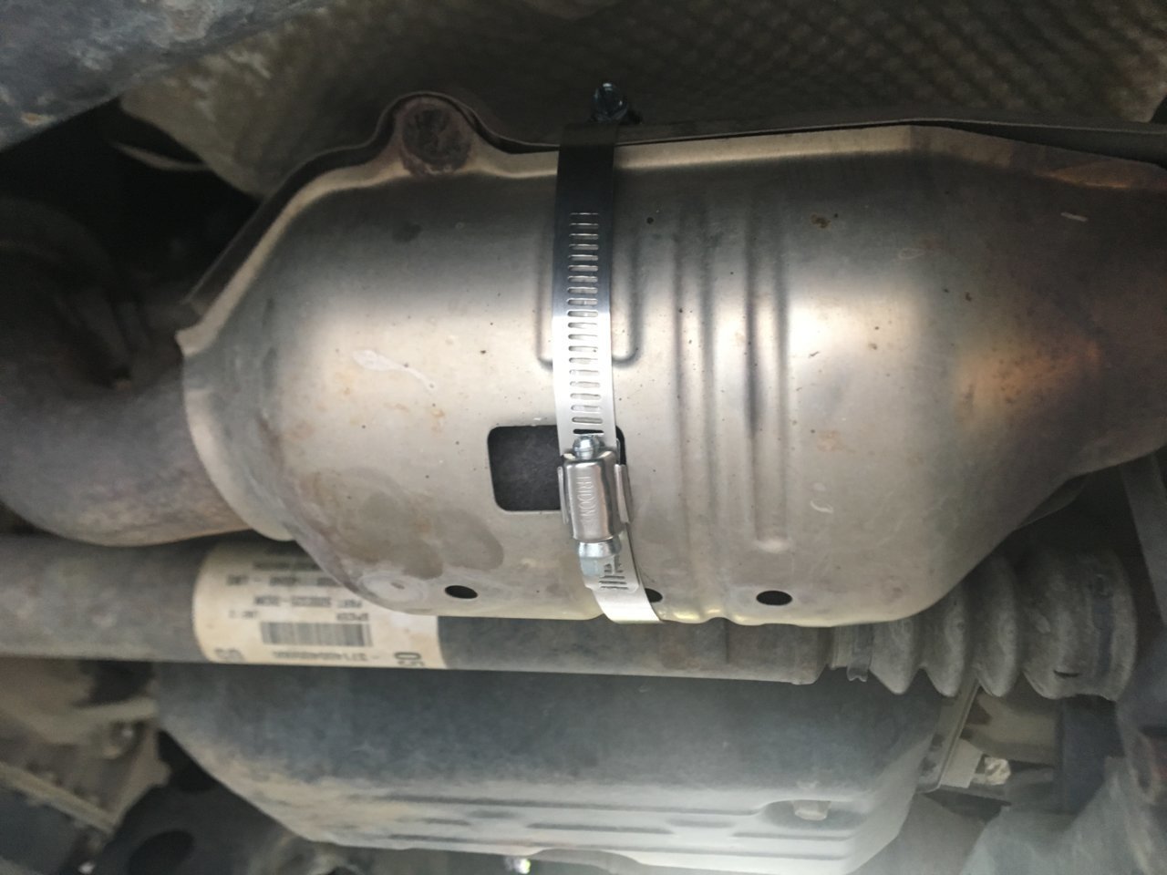

    The only obnoxious noise my truck makes like that comes from the heat guards for the exhaust rattling.
    06Tacooo likes this.

    I know of 2 options
    Clamp it, or wait.
    If you wait long enough it will stop when it falls off.
    Toms2Yotas and WRDD Taco[QUOTED] like this.

    yup all mine got ripped off after upgrading to a URD headers + exhaust
    TnShooter[QUOTED] likes this.
