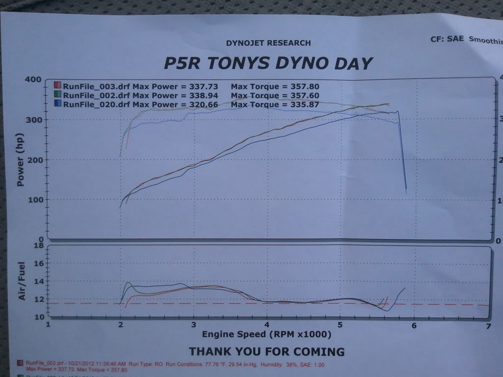

    Sdxrunner619's 2005 SWB Drift truck (Pre LS swap)
    338 whp/ 357 wtq @ (10 psi?) Had URD 2.85" pulley and NST O.D. pulley. 2.5" Y-pipe, 3" exhaust, Eb
    Got her dynoed today. Made some good numbers. The first graph shows pre nst pulley and post
    "This graph below, is kinda cool. Shows my truck stock, with just a flowmaster, and in its current stage of tune. Shows what $5,000 or so worth of add ons.....Tonight or tomorrow, im gonna do some tunning below 3,500 running way to lean....at least I got the maf Cal working.:thumbsup:"

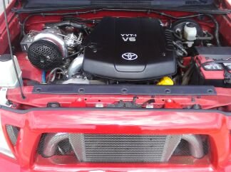

    SIK X's Turbo kit @ ~5 psi. S
    Stock injectors; Factory FPR Mod; Stock ECU.
    320 WHP 350 WTQ. AFR's are high 10's to low 11's.
    Grapgh is small. His camera not mine.

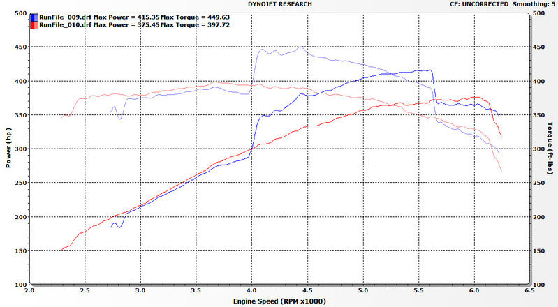

    Death5hawdow's 2006 XR.
    Back to back run after getting some jetting done (not puter tuned yet) heat soak (no dyno fan as it fell off the lift lol), stopped the juice at 5,800. (Nitrous , 30 shot)
    TRD 9 PSI Peak (holding 8ish) w/ a baby shot.
    93 Pump Gasoline
    Stock Y Pipe w/cats LOL
    Was quite the ride from idle to redline... Thing made TQ EVERYWHERE and raped 40-90s and 60-100s.

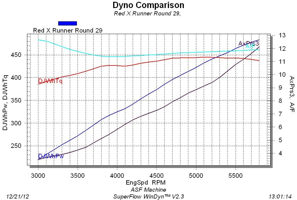

    RRX's 2006 XR URD MK3 S/C Stage 3, Full URD exhaust.
    483 whp/ 445 wtq @ 12 psi w/100 octane. Stock internals. (Dyno was elevation Corrected for sea level.)
    4800' elevation, 42 degrees F.
    4th gear pull.
    Light blue: A/F
    Red: whtq
    Blue: whp
    black: psi
    "Well my elevation is 4800 ft. The weather was a nice 42 degree day.
    I did throw some 100 octine in for that last tune and run.
    I did have a run on 91 octine that was 449 whp and 415 wtq and that is the tune I am running now.
    You can hate all you want but the dyno I used is accurate and my truck was running good and the conditions were good.
    The condition were so good for my truck we could have made more than 500whp but my engine is not built for it yet and I did not want to trailer it home. I am working on building me am engine now to handle the power.
    And I do know that these are just numbers but I wanted to see what my truck is making compared to stock and to get a good tune in it so that I am not running just a baseline tune."

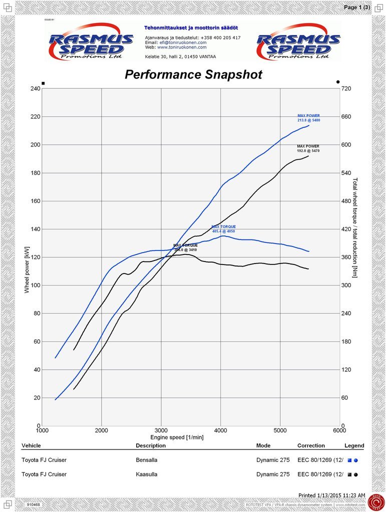

    Truck: 2007 FJ Cruiser, 6M/T
    Mods: TRD Supercharger, Unichip (non-reflashed ECU), TRD CAI (newer type), Magnaflow 22" muffler, Lovato CNG kit
    Dyno: Rototest VPA-R5™ (measured from the rear axle hubs without the tires, center diff locked, front drive shaft removed)
    Elevation: 150 ft above sea level
    Max. pressure: 6 PSI
    Results (blue lines with gasoline, black lines with CNG):
    387250d1421179331-airsprung-cng-fjii-kon_62f9121d918a705fec36526450ca1cea36ac995e.jpg
    Base line (went wrong, the speed limiter killed the engine, not the rev limiter): http://www.fjcruiserforums.com/foru...37481d1415395134-airsprung-cng-fjii-image.jpg
    Mods were the same TRD CAI and Magnaflow muffler. Purple line with gasoline, green with CNG.

    is 12:1 afr not a touch high for that much boost? I mean it looks like it holds that pretty constant across the boost spectrum but asking for a friend

    Yes, it is. However, he was using 100 octane. Thus a higher knock threshold.
    Your friend surely is inquisitive.
    The AFR dips below 11.5, then creeps back up to 11.9, by 6000 RPMs. It was in the safe zone, but could be more consistent.
    A datalog would show why the AFR was creeping up. Could be simply that more fuel needed to be added in the tune. Could be that it was running out of pump, or injectors.
