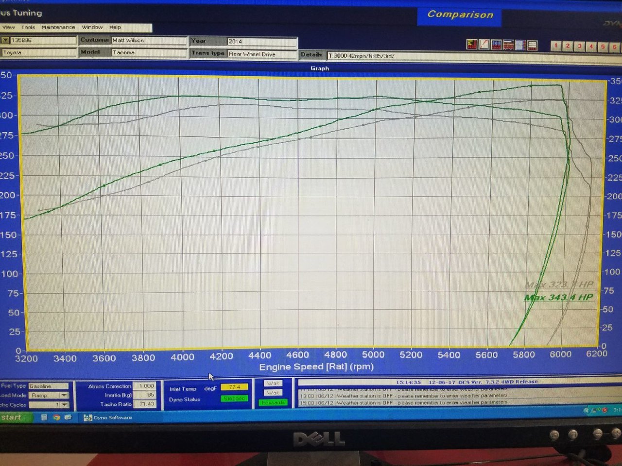

    I didn’t get a before tune dyno sheet, but here is one of the afters. I think actually this pic I am posting is comparing tune to stock, tune being the green line.
    Numbers were
    TRD Tune: 323 HP / 318 TQ
    OVTune: 343 HP / 329 TQ
    About the truck when it was on the dyno:
    Magnuson supercharger w/ 2.85 pulley. Has the bypass valve jet removed.
    AFE “cold” air intake (dry filter)
    JBA shortie headers w/ factory cats welded on.
    Banks 3” Monster exhaust
    Deatschwerks 255lph fuel pump
    Dyno runs were done on stock tire size 265/65/r17
    Now I just wish I could get on the dyno to see what difference my valve body kit and urd ypipe made.

    Good job! Thanks for posting up! The best thing about your dyno is that your timing is very safe, and you made extra power.
    As a point of reference, on my friend's N/A 1GR picked up about 20 whp. In the mid to high rpm range. On an N/A engine! I'll have to look it up again, but it is in the N/A dyno thread. Lucario Runner's 4Runner.

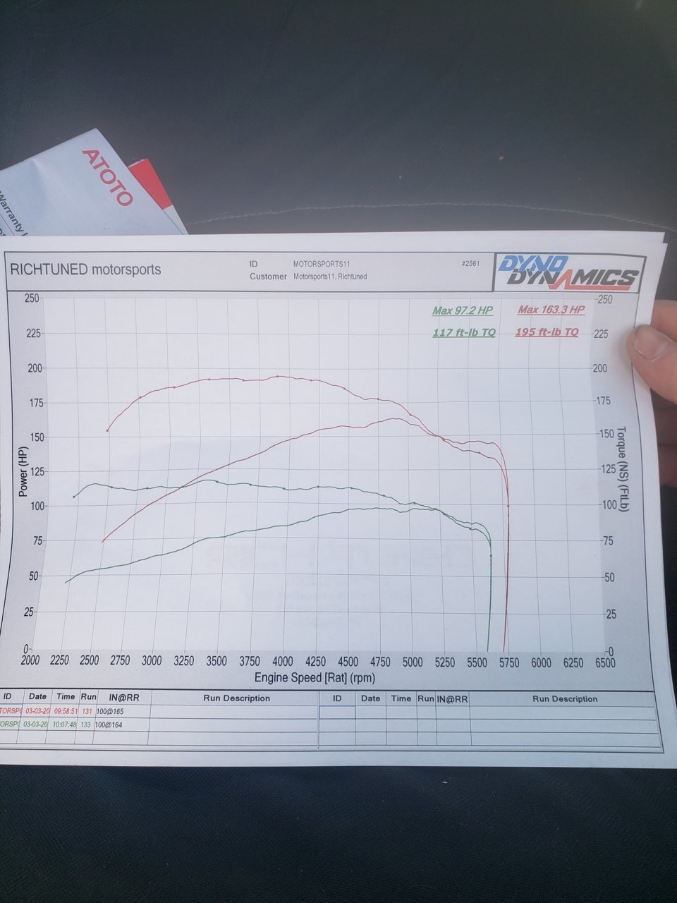

    Bunch of built and bought mods
    Dyno tune
    Toyota tacoma 2trfe 5spd manual
    GT2871R 6 psi boost
    Aem 320 lph pump stock tuning
    285/75r16 mt tires
    Green stock naturally aspirated

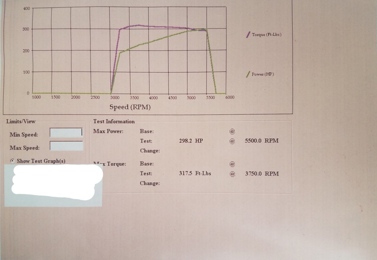

    Meh.. I feel like it was done wrong and traction was kicking in, but here it is.
    2012 TRD Sport V6
    298.2 HP/ 317.5 TQ on Mustang Dyno
    - TRD JustDSM tuned
    - 2.8 Qwikchange pulley
    - Mightytacoman 3* Cam gears
    - FIC 650cc injectors
    - NGK Ruthenium HX 95125 plugs .039 gap
    - AEM 320LPH E85 capable fuel pump
    - NST lightweight OE billet crank/ WP pulley
    - NST custom built lightweight billet supercharger crank pulley
    - Mishimoto 160* thermostat
    - RatioTek HD upgraded transmission valve body
    - Bosch 010 auxiliary supercharger coolant pump retrofit
    - Custom 1.5 quart supercharger coolant reservoir byMightytacoman
    - Modified Y-pipe
    - Black Widow Venom 250 muffler
    If we are basing it purely off the original post Dyno graph of the all OE 1GR, that would indicate a 106.5 HP gain over OE with the modded Supercharger.

    how did your AFRs look?
  20. Jul 14, 2020 at 5:22 PM
    #120
    12TRDTacoma
    12TRDTacoma Powered by Ford, GM, VW, and Mercedes
    Aug 20, 2012
    #85133
    16,671
    Rob
    Concordia
    12 TRD Sport DCLB 4x4 Supercharged
    Boosted
    11.4 under WOT.
