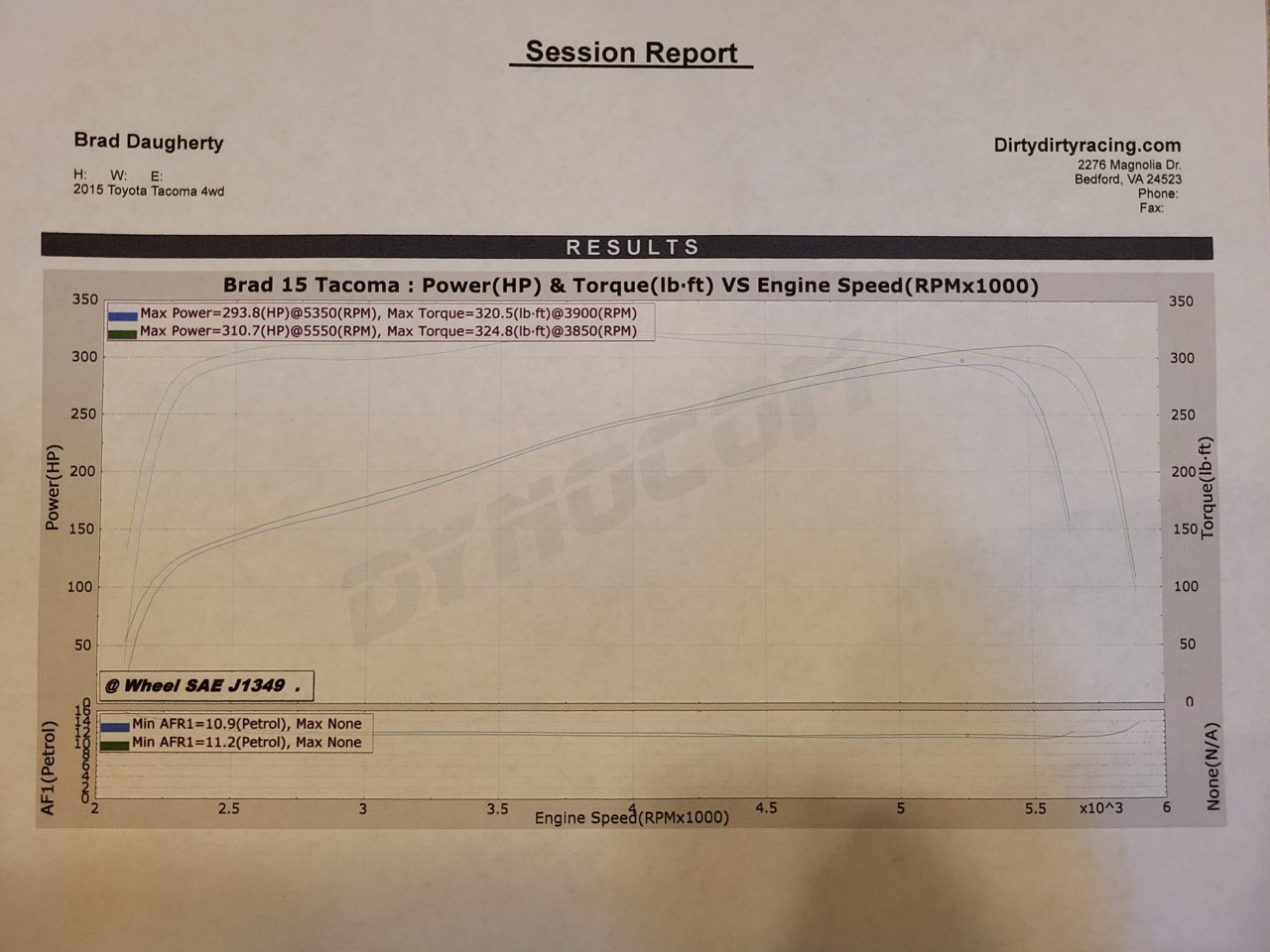

    Had to wait on my dyno guy to get back from vacation, but the results are in! Thanks to @JustDSM for the tune. Before and after tune are the two runs shown on the graph.
    Disclaimer: JustDSM said my truck was running leaner than most with the TRD tune, so he had less room to play with the numbers. Therefore I would believe that sets my gains as a low baseline.
    End result: 310.7whp and 324.8wtq. So a gain of 16.9whp and 4.8wtq from the tune alone. Gained hp and tq throughout the entire rpm range, but had the biggest gains between 2.5-3.5k rpm and above 4250.

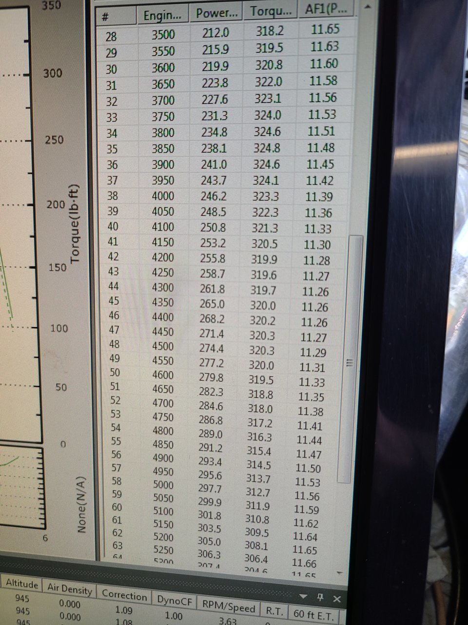

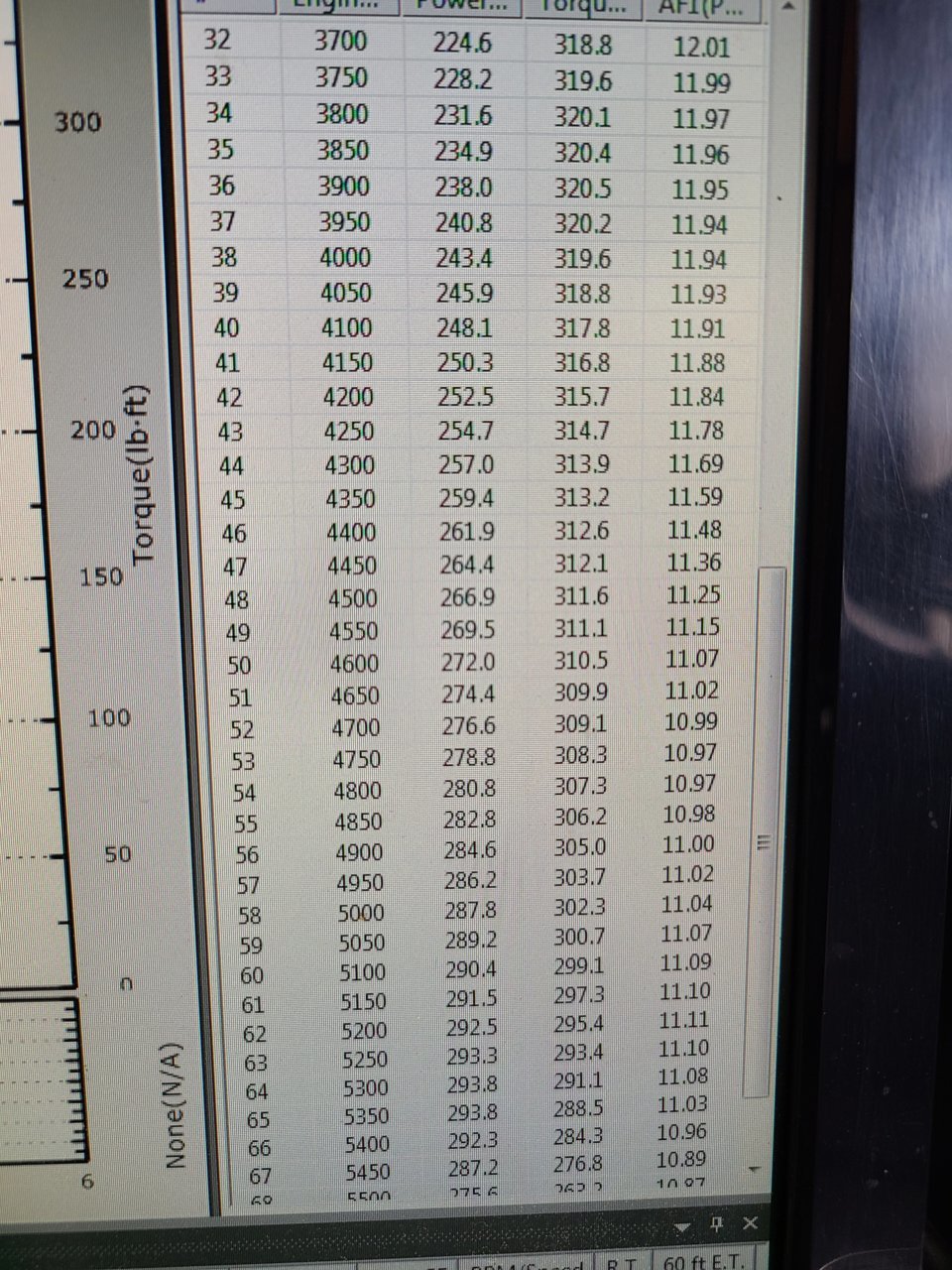

    With the tune my a/f ratios are actually safer up to 4.5k rpm (they were around 12) before going rich, and now sit right around 11.5 throughout. Can't complain about having a safer tune while also picking up some extra power!
    Again a big thank you @JustDSM for doing the work, and never seeming annoyed when I'd call you up with questions! The guy that dyno'd my truck tunes domestic vehicles as his business, and his words to me were "that's exactly what I would have aimed for if I was tuning your truck, that guy did a good job." Really hard to argue with that. 20210722_183119.jpg
    A/F ratio comparison between the TRD tune vs HPTuners/JustDSM's tune. This does a great job of showing how little he had to work with, and how well he stabilized the ratios throughout.
    TRD tune
    HPTuners/JustDSM tune

    Glad you posted all of that data and details, mate. Thank you. :cheers:

    What was the ambient air temp and R.H. during the second run? I see it was 92F and 45%R.H. on the first attempt.

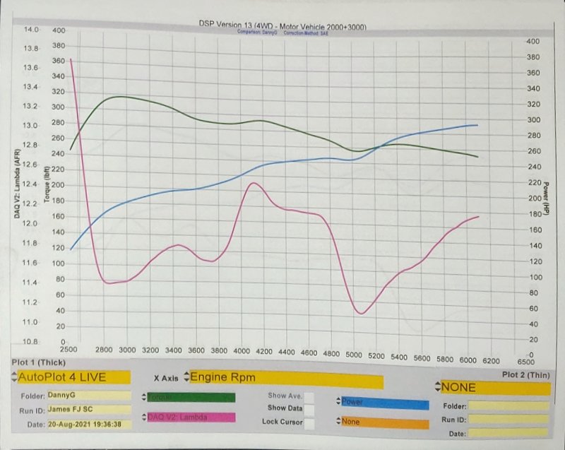

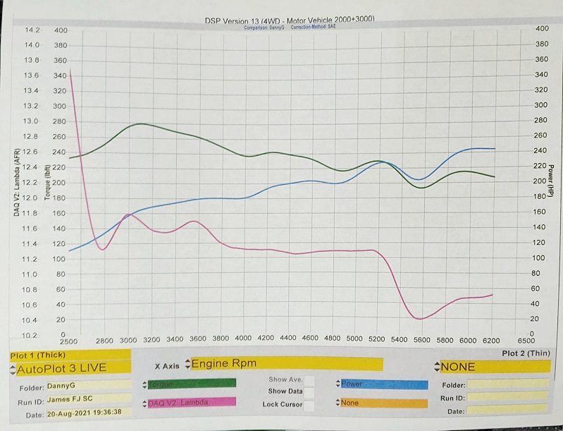

    Per @Torspd suggested dropping this here. You can see the delta between back to back runs. Ambient temp was ~77°f. Had a bout of heat soak and you can see how much difference it makes.
    Mods: Mag s/c with 2.7" pulley, iridium VKH22 plugs, 2.5” AFE exhaust, Aeromotive 340, Ripp coil packs, NST water pump and supercharger pulley

    What about the heat soak?

    ~40 hp loss. The problem was mainly my plated bumper and blocking a lot of air from the fan. I pulled off my bumper bash plate and temps stabilized. Real world testing the heat soak may be more relatable/noticeable in stop and go traffic but on the highway, air is drawn in at different angles. Though I don't have any measurements until I can further data log with a better tuner hardware. With the current trend of heavy plated bumpers, winches, lights, coolers on coolers, heat soak is not out of this world though.
