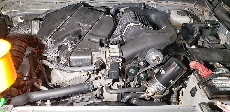

    What have you got between the oil cooler and the oil filter?

    Greddy oil port adapter.

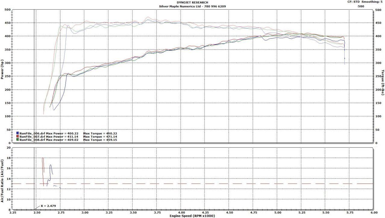

    Latest addition, from @Athlaos . :thumbsup:
    Quote, "Updated dyno chart - changes since last time are Kelford camshafts, URD EL headers (replacing JBA long tubes), an additional AEM 500ml/min water/meth nozzle for the stage 2 system (ramps up with MAF reading), and some adjustments and/or fixing some issues that were causing over-richness at WOT.
    Unfortunately the AFR sensors weren't working so didn't get any data on that. Data logs do show they're OK though," end quote.

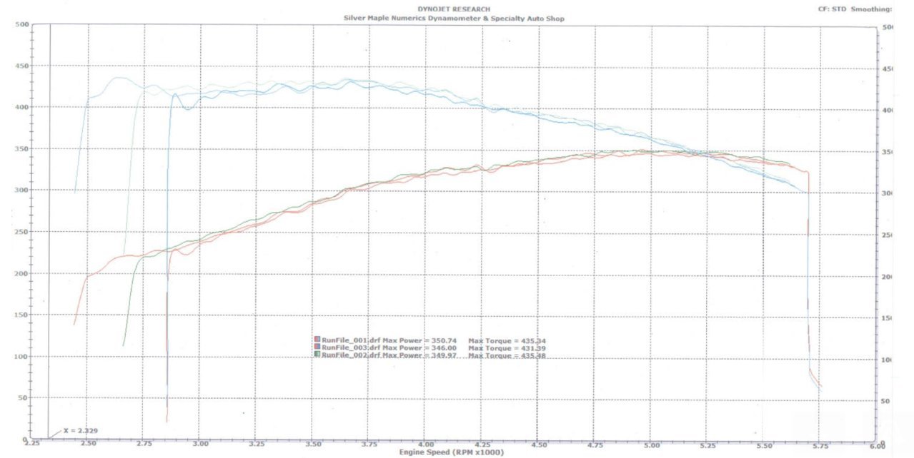

    Quote, "Here's the old chart; one other change that I didn't mention is I solved a lot of my belt slip too, which caused the boost to go from 12psi to 14psi (at WOT - boost is 15-16psi under partial throttle).
    New chart attached again for a more direct comparison.
    It LOOKs to me - anecdotally - that the exhaust and airflow really opened up, flattening the torque curve quite a bit," end quote.

    @Athlaos - Those are stout numbers for the Magnuson! Great work!

    You sprinkle some magic on that tune?

    Nope, I've not touched that one!

    That TQ curve is awesome 450 under 3k! Who says smaller pulleys don’t produce more power! Water/Meth injection does. Curious how much those camshafts helped out. Nice work @Athlaos That’s one of best dyno charts I’ve ever seen for TRD SC

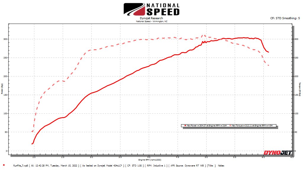

    8A72A4D7-A11D-422B-AA5D-554E29A93DF2.jpg 8A72A4D7-A11D-422B-AA5D-554E29A93DF2.jpg This morning seal level
    2012 4.0 auto
    4.88s 35s
    2.82 Quick change pulley
    Momentum gt
    AEM 340lph
    Cam gears
    Dt shorties
    Flowmaster high flow
    borla pro xs single dual 2.5

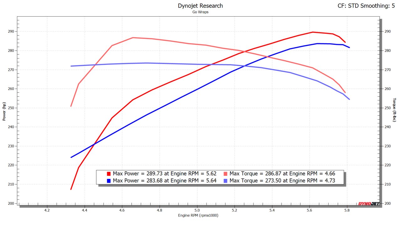

    2008 Tacoma V6 Supercharged with 2.85 pulley. Boost reading on dyno was 7.5psi.
    I showed up to the dyno shop with the RB solenoids installed already for the baseline pull. And swapped to the stock solenoids for the remainder. I did it this way so there wouldn't be any surprises with the install while at the dyno shop. I also use the Motorad low temp thermo and normal operating temps (ECT) are in the low 170s, which is pointed out below.
    ".........the dyno testing was performed with the Red Bullet solenoids tested FIRST (baseline). And then a break in action to R/R to the stock Toyota solenoids (~25 mins) before performing dyno pulls with the stock toyota solenoids. The BLUE and RED dyno pulls (curves) would be the most accurate in comparison since both runs were performed under a normal operating temperature range. The peak HP and TQ numbers don't matter as much as the delta between those numbers in each pull."
    Stock Solenoid: (HP/TQ) (Engine Coolant Temp and Intake Air Temp)
    BLUE CURVE : 283.68hp / 273.50tq (ECT 169F and IAT 68F)
    Red Bullet VVT-i solenoid:
    RED CURVE : 289.73hp / 286.87tq (ECT 174F and IAT 73F)
    Dyno Shop = Go Wrap Motorsports in Fremont, CA.

    The torque gain is most impressive.
