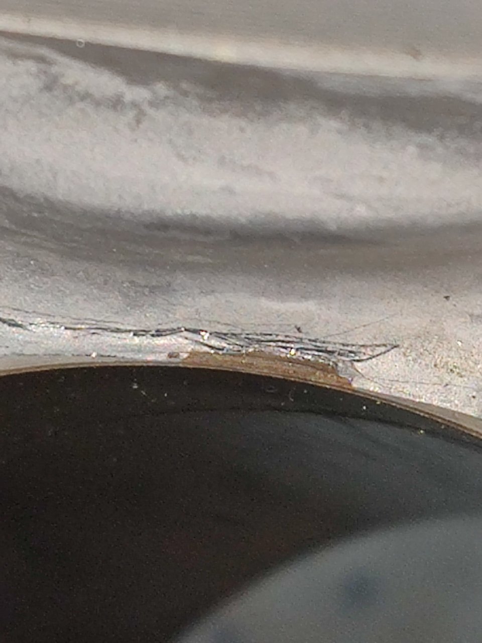

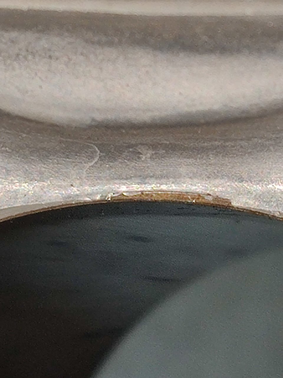

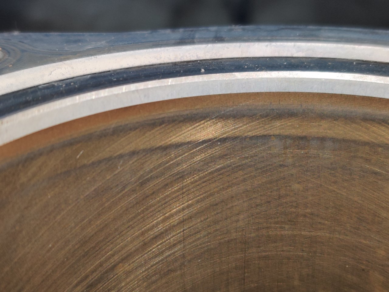

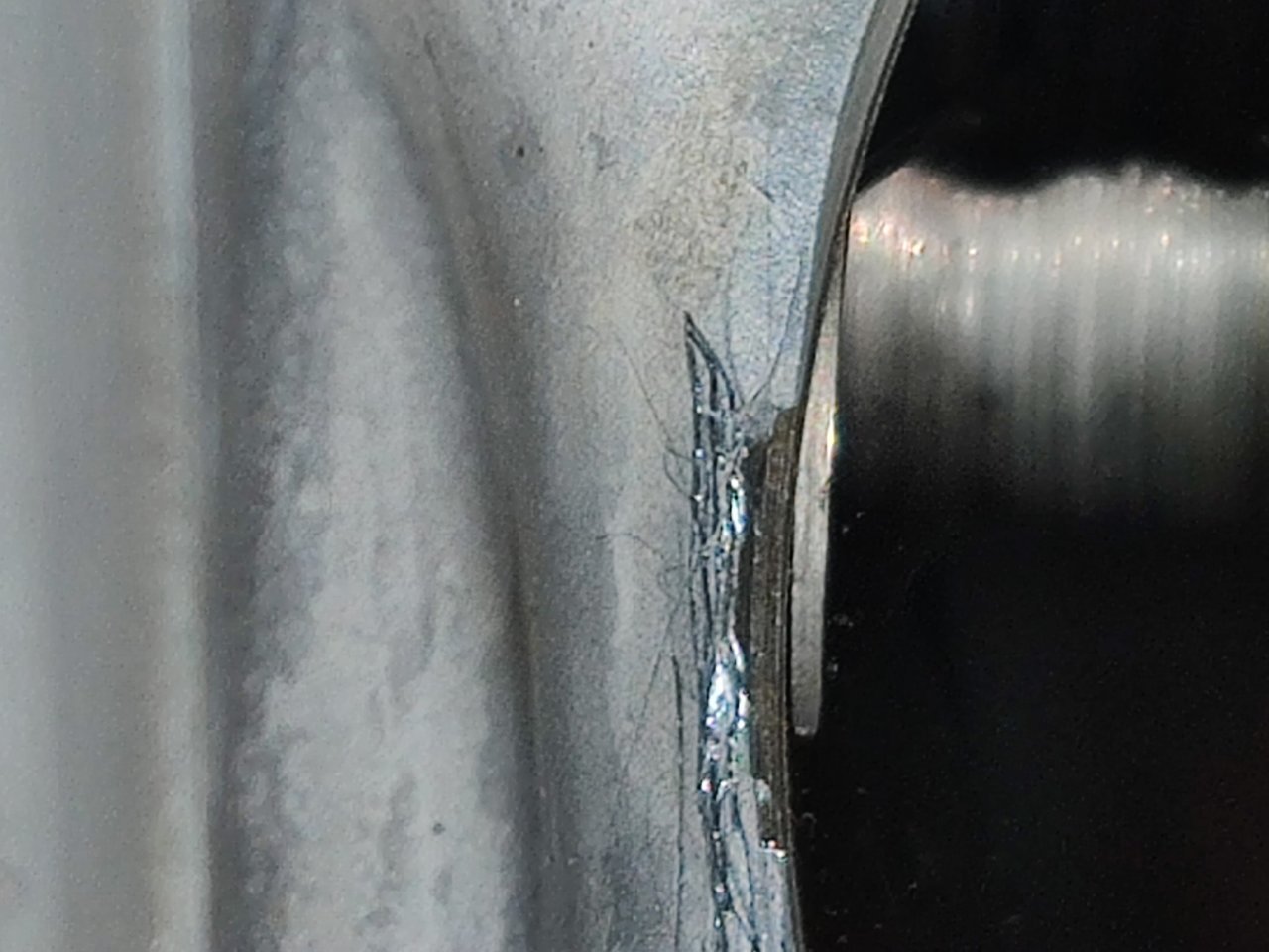

    Note: I will post a couple of pictures after I write this post. I will edit so they are with this post. (pics are on the phone)
    I picked up my block this morning and it had to rain on me. :annoyed: So my evening consisted of taking scotch brite to all the iron parts to get the rust off. I then cleaned off any excess dust and coated everything with WD-40 to prevent future rust. "and the fun never stops with this project." LOL.
    After all this time at the machine shop they mentioned it looks like they could bore the stock cylinder .010" over maybe even .020". After touching up the block I started to look at cylinder walls and the edges of the liners to see for myself and understand why they think the stock liners could be bored. I seen from the bottom of the cylinder where the edge of the liner was sticking out passed the aluminum.
    I thought, " well I'll be damned". I started to pick at the aluminum at the bottom of the cylinder to see if I could find the edge. I think I did find the edge. :eek: I seen a flat edge and then a taper. I think the the taper I seen might be the "spiny type liners"
    Now for the fun brain storming. As long as they are not machined pass the point where the taper start, then I should be able to bore the cylinders. Now, now, I know I need to leave some material before the taper. I took a few pictures of it. In one of the pictures I placed a .030" feeler gauge next to the liner as reference. Without measuring it, "I don't have a way", it looks to be about .030" thick. This being said in theory I can bore the cylinders to .020" over for the pistons I have. This would leave .020" left on the walls.
    I'm sure some will ask how that is. It is because you take off half the thickness in a radius so when the full circle is completed it will be the size you want.
    How far con one safely go??? Who has a junk engine block for trial and error?:rofl:
    Now for an adult beverage.
    Bottom
    The taper after the flat edge
    .030 feeler gauge reference
    Top of cylinder
    Not that the liner stops 3.5mm before the top.
