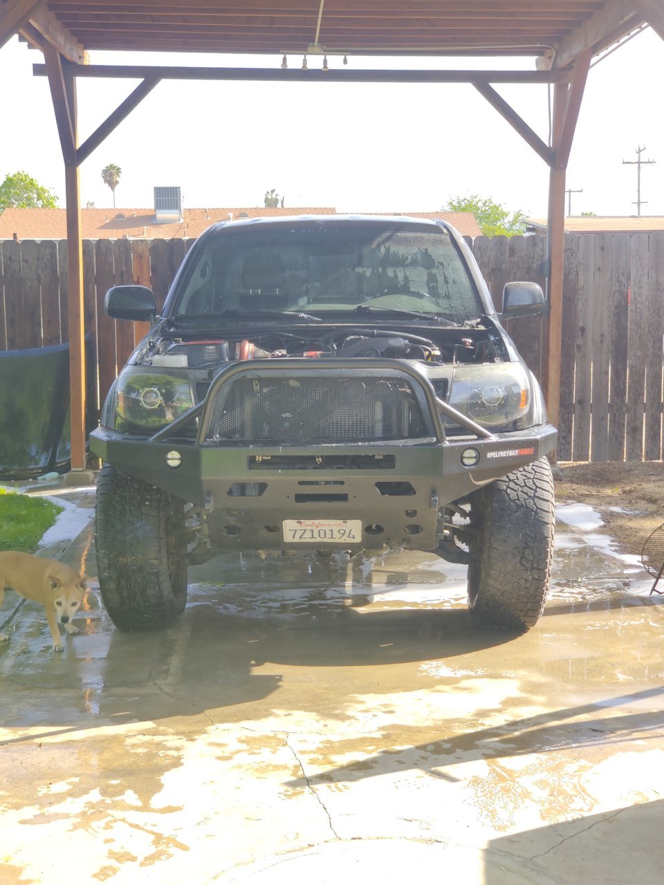

    Another long day of working on little things. Air box, exhaust, power steering pump. AC compressor, etc. I even gave her a good rinse. She needs a full detail after 5ish months. I primed the engine by pulling the spark plugs and ECU fuse 1 and 2. Then cranked the engine for about 5-7 seconds. I let it rest for about 20 seconds, then cranked it for about 10 seconds. Put the plugs and brand new coils in. Finished up some interior stuff then started her up. Purrs like a tiger. LOL!

    I do need to add, I was worded about the fuel that had been sitting for so long. Well, it was not an issue and I was on the reserve. LOL! My test drive consisted of $120 trip to the gas station and not getting a full tank. :eek:
    I put about 5-6 miles and it's great to see her parked in the front.
