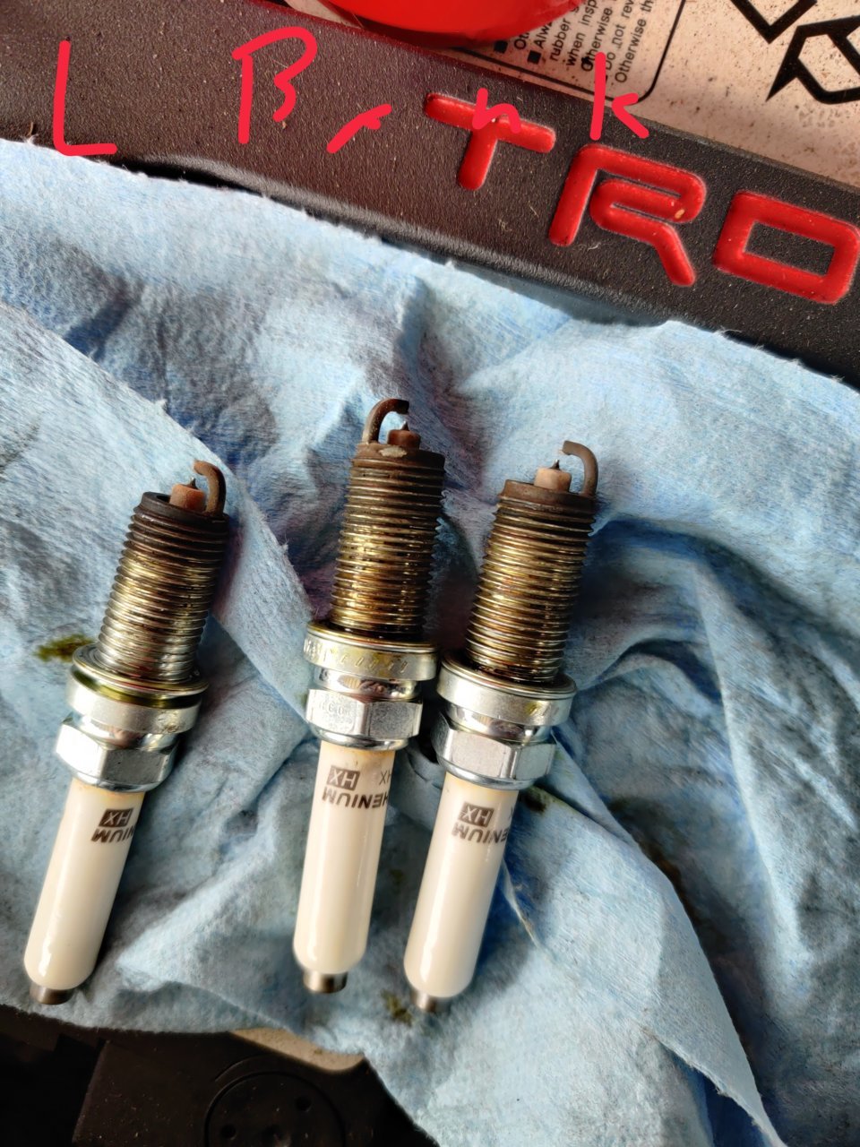

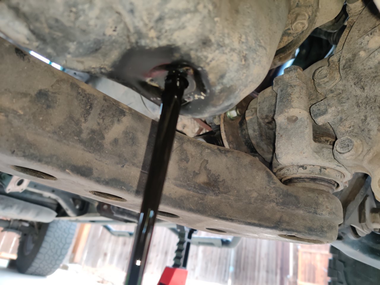

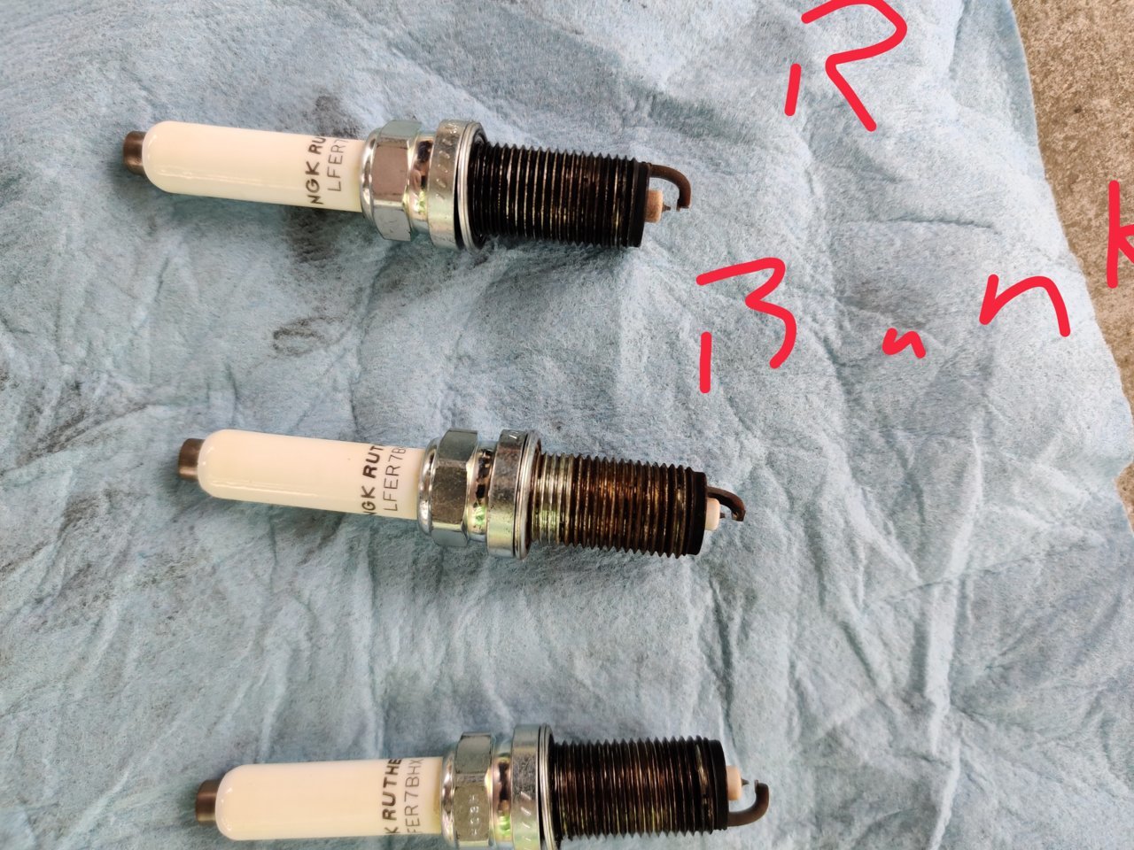

    The pics

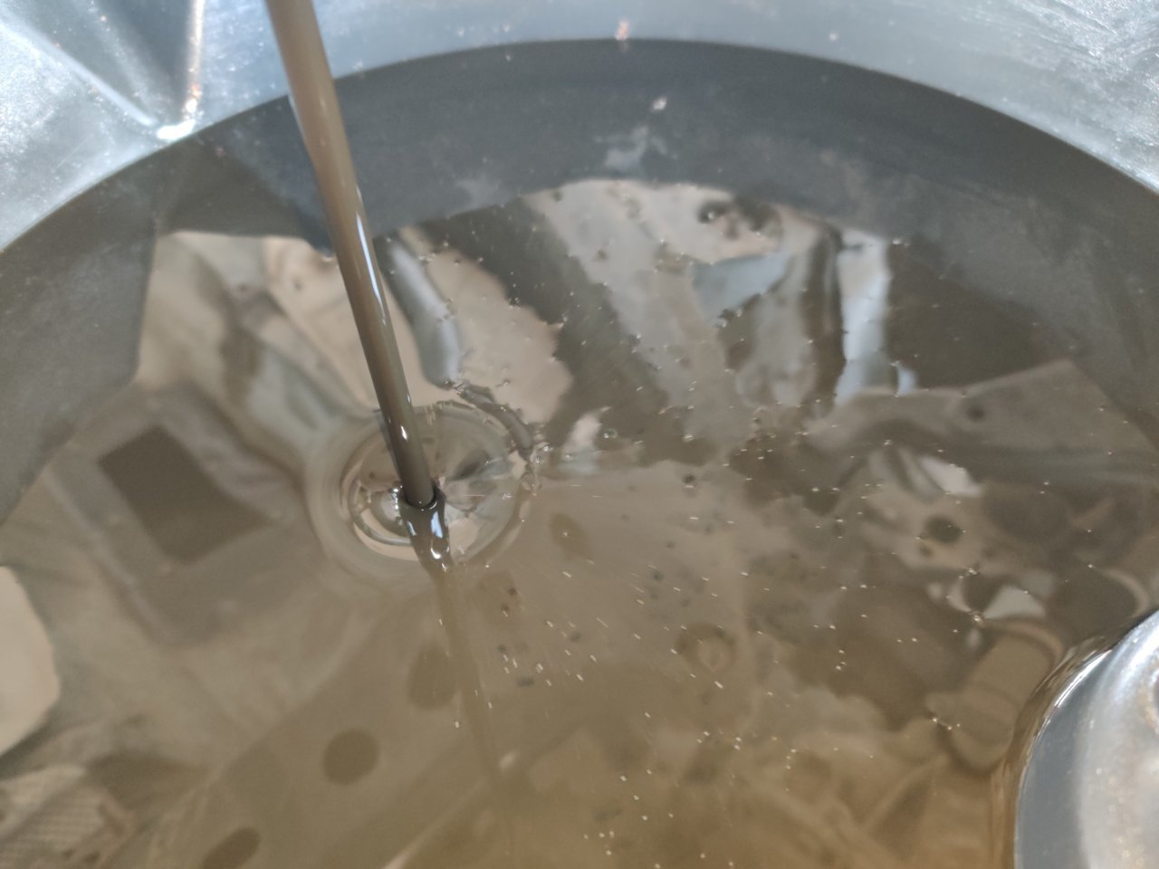

  4. Nov 8, 2021 at 7:22 AM
    #24
    Knute
    Knute Well-Known Member
    Aug 13, 2020
    #337515
    5,148
    '06 4.0L Tacoma TRD Sport
    Stock, 4WD, Access Cab, White,
    Don't want to sound like a DebbieDowner......
    You oil seems to have yellow or brassy tinge to the color. Could this be from the crankshaft/piston rod journal bearings?
  5. Nov 8, 2021 at 8:01 AM
    #25
    clip
    clip Well-Known Member
    Mar 12, 2021
    #359021
    616
    VA
    15 OR
    pinstripes. lots of pinstripes.
    Inconclusive due to camera white balance probably.
    I'm surprised with that much glitter in the oil the motor showed no symptoms of a failing bearing or something.

  6. Nov 8, 2021 at 8:06 AM
    #26
    Knute
    Aug 13, 2020
    #337515
    5,148
    Possible.
    Although, with a super charger boosting cylinder pressures, the journal bearings will be supporting increased loads. The oil film between the crank/piston rod could be too thin to support the increased load allowing metal to metal contact releasing brass colored flakes.
    Just a thought. More will come as the engine is disassembled.
    I'm always interested in determining/understanding the root cause of a failure.
    rheath08[OP] likes this.

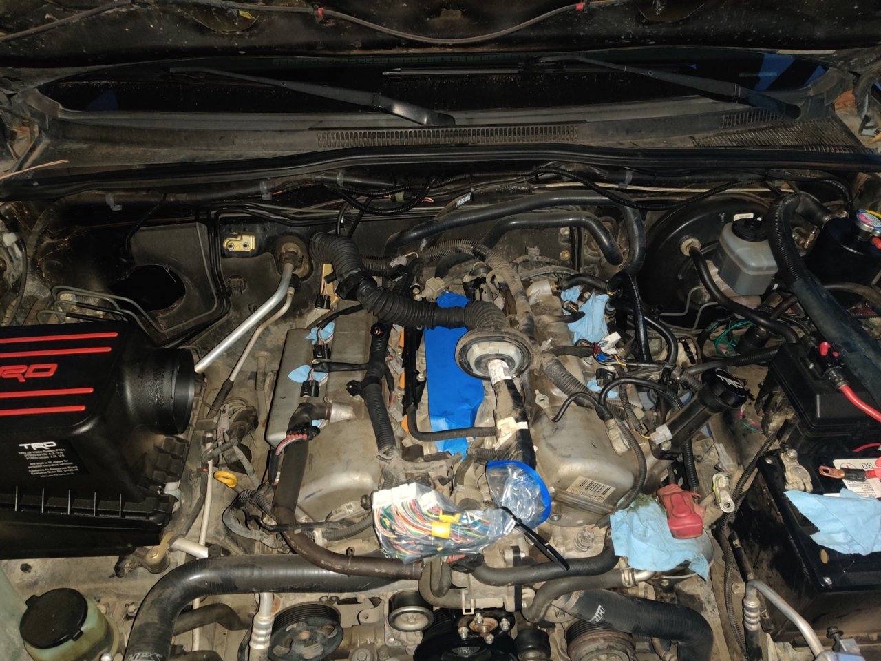

  7. Nov 8, 2021 at 8:10 AM
    #27
    Torspd
    Torspd Tor-nication
    Sep 18, 2009
    #22958
    26,437
    Tor
    The Great America!
    MMVI 4.4L 4x4 Access Cab
    Torspd Custom Turbo kit [] Borg Warner 9180EFR Turbo [] Haltech Elite 2500 [] TiAL Q BOV [] TiAL V44 Wastegate @ 15psi [] CP Pistons [] CP Carrillo Rods [] ARP Head studs [] ARP Main Studs [] ARP Header - Head Studs [] Ported Heads w/ 1mm oversized valves intake/exhaust [] Brian Crower Forged Stroker Crank [] Darton M.I.D. Sleeved Block [] Kelford Camshafts [] Torspd 160* T-stat mod [] APR Large Fuel Rail [] Walbro 460 LPH E85 Fuel Pump [] FueLab FPR [] APR T56 Conversion Kit [] KP RACING Built T56 [] McLeod Racing Custom Twin Disk Clutch [] One Piece Aluminum Driveshaft [] MGW Shifter [] Custom lowering kit [] Ohlins Front Coilovers [] QA1rear shocks [] Custom Ron Davis Radiator [] Dual SPAL Electric Fans []
    I have honestly never pulled the harness out from the cab, in all of the swaps that I have done. Interesting to see it done.
  8. Nov 8, 2021 at 8:11 AM
    #28
    rheath08
    rheath08 [OP] Well-Known Member
    Nov 16, 2016
    #202554
    1,766
    Russell
    Bakersfield, CA
    Frankenstein's Monster
    converted AWD, RC62f swap, Supercharged
    Additive? The engine went south during the last 5k-5.5k miles. I just had to put the high end oil anyways to I could the drive truck home from work. I decided to take a picture of the oil that only had 15 miles on it.
    The oil that I just put in has a green hue to it by design.
  9. Nov 8, 2021 at 8:11 AM
    #29
    clip

    Agreed, but looking at the first two pics of the oil it could just be a lighting change. My thinking is if it ate far enough into the journal bearings for 6 qts of oil to change color, you'd get a severe knock.
    Looking forward to more pics!

  10. Nov 8, 2021 at 8:12 AM
    #30
    rheath08
    Nov 16, 2016
    #202554
    1,766
    Russell
    Bakersfield, CA
    There was 5 maybe 6 connectors at the ecu and the junction box and one clip to hold it to the bracket on the inside. Then there was power, ground and I think 3 connections and under hood fuse box.
    clip likes this.

  12. Nov 8, 2021 at 8:15 AM
    #32
    clip
    Mar 12, 2021
    #359021
    616
    VA
    15 OR
    This is always how I pull them. Disconnect from inside and pull the whole harness and grommet from the firewall. A lot easier to disconnect and reconnect sensors on the stand.
    SR-71A likes this.

  18. Nov 8, 2021 at 8:35 AM
    #38
    PhoS
    PhoS Proffauxssional
    Apr 8, 2020
    #324146
    1,289
    PNW
    08 FJ Cruiser
    Contains MSG
    This is how normal people do it. :rolleyes:
    Torspd[QUOTED] likes this.
  19. Nov 8, 2021 at 4:13 PM
    #39
    wrmathis
    wrmathis Dark Lord of the Sith
    Sep 10, 2008
    #9126
    9,457
    Bonaire, GA
    2006 Tacoma TRD OR 4x4
    parts and stuff
    same, i jsut disconnected everything from the engine and shoved everything over to the pass side somewhere
