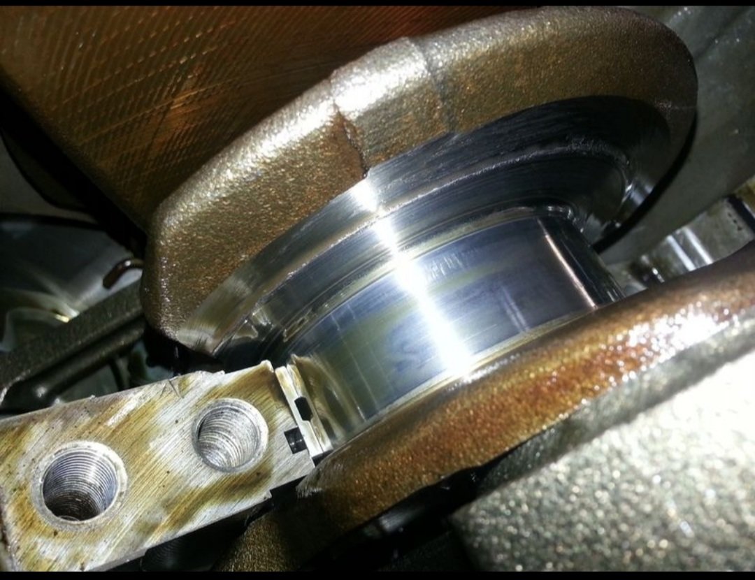

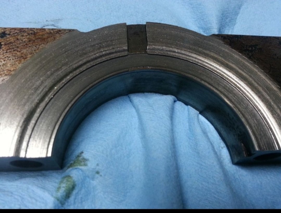

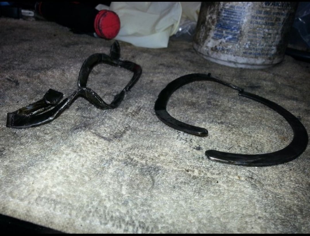

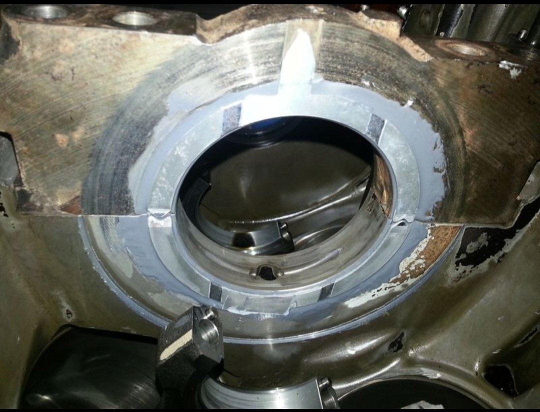

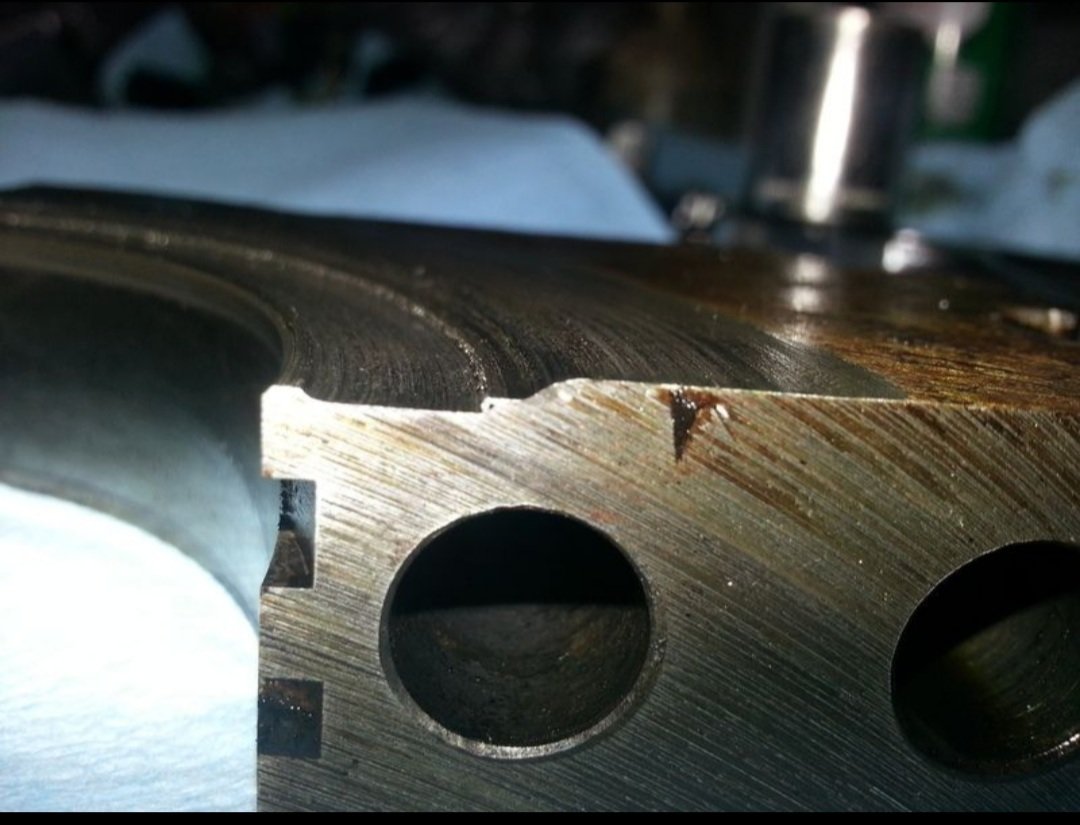

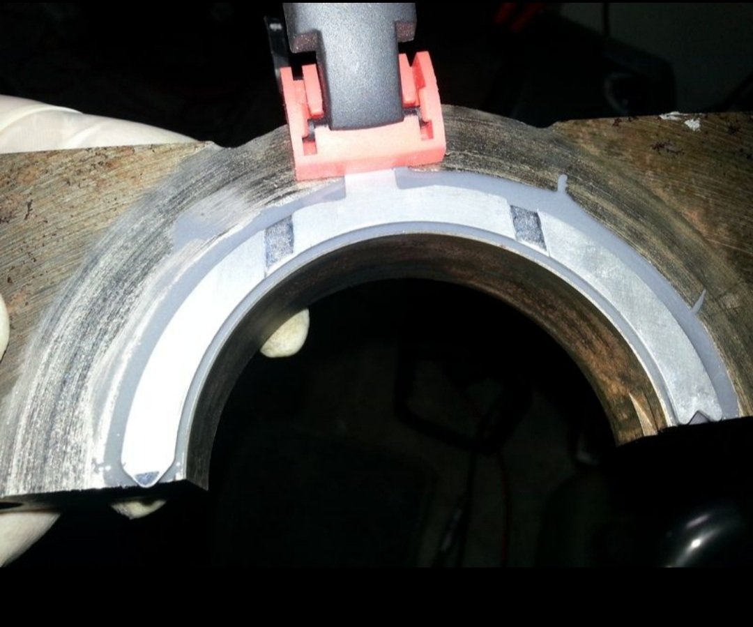

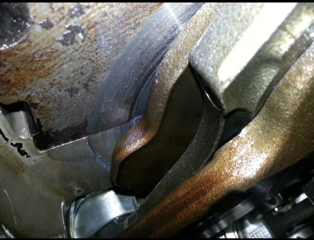

    Going to post these photos in here for fun. Since it is related to engine tear-downs. The engine life, after disowning the thrust bearing.
    Screenshot_20211119-113231_Photobucket.jpg Screenshot_20211119-113252_Photobucket.jpg Screenshot_20211119-113304_Photobucket.jpg Screenshot_20211119-113325_Photobucket.jpg Screenshot_20211119-113331_Photobucket.jpg Screenshot_20211119-113351_Photobucket.jpg Screenshot_20211119-113359_Photobucket.jpg Screenshot_20211119-113407_Photobucket.jpg
