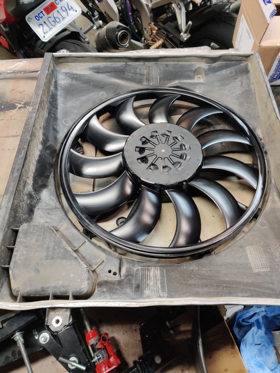

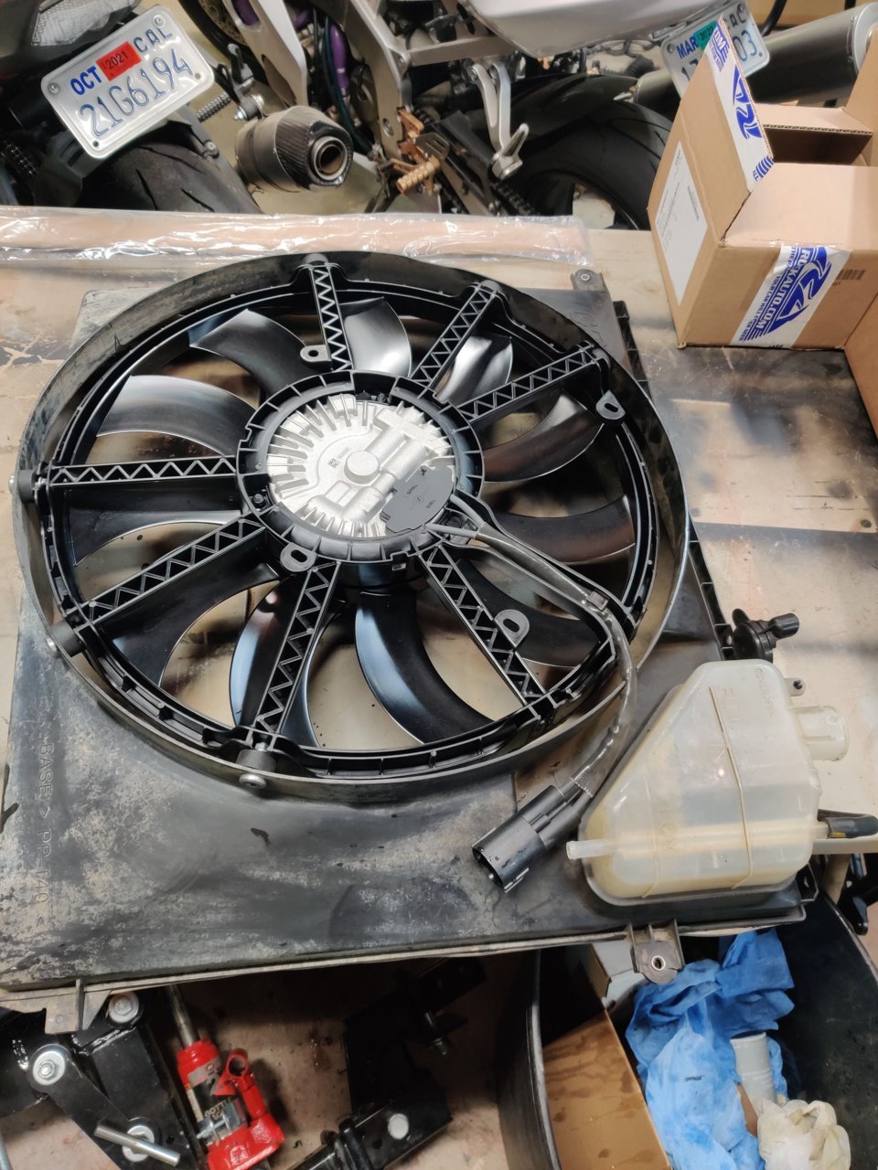

    Tonight I was working on a side project for Frankenstein's Monster. I will be installing an electric fan. The fan is a 850 watt brushless fan from an '18 Camaro. I cut out the fan keeping the reinforcing ring around the blade. I mocked it up in the fan shroud. I mounted it by some 25mm long flanged button head cap screws, (needed to be about 22-23mm to keep from bottoming out, I just drilled a little deeper, I don't recommend if you follow suit) after mounted I notched the shroud wire the wires to have a clean look. Then drilled two small holes so I can use the Christmas tree clip that was on the connector to keep it secured.
    I added one touch up after the pictures. I put felt tape over the gray foam and the bottom edge. The gray seal is foam window insulation. It stuck to the radiator when I removed it, so this will keep it from sticking again.

    Looks good but how are you planning on controlling it? I believe those need a PWM signal on the control wire to work.

    I have a pwm fan controller I got off ebay a while ago when I had a different electric fan set up.
    I was not able to get everything to operate to my liking, so I went back to the fan clutch. The after market fan clutch I had locked up 80% of the time it FUCKING drove me nuts!! Now here I am revisiting the electric fan after a little more research. I'm hoping this controller will work. :rofl: I have a dedicated temp sensor for it mounted in the heater hose on the supply side. The fan will be direct wired to the battery with a high amp relay that I acquired through work. "thank you BMW for make a nice 125amp relay" well their supplier anyways.
    So will a little more time and patients this go around my cooling will be top-notch. I do have a back up plan if need be. I will run the Lingfelter controller, their price went up to $200 now.
    The controller: https://www.ebay.com/itm/143561646769?

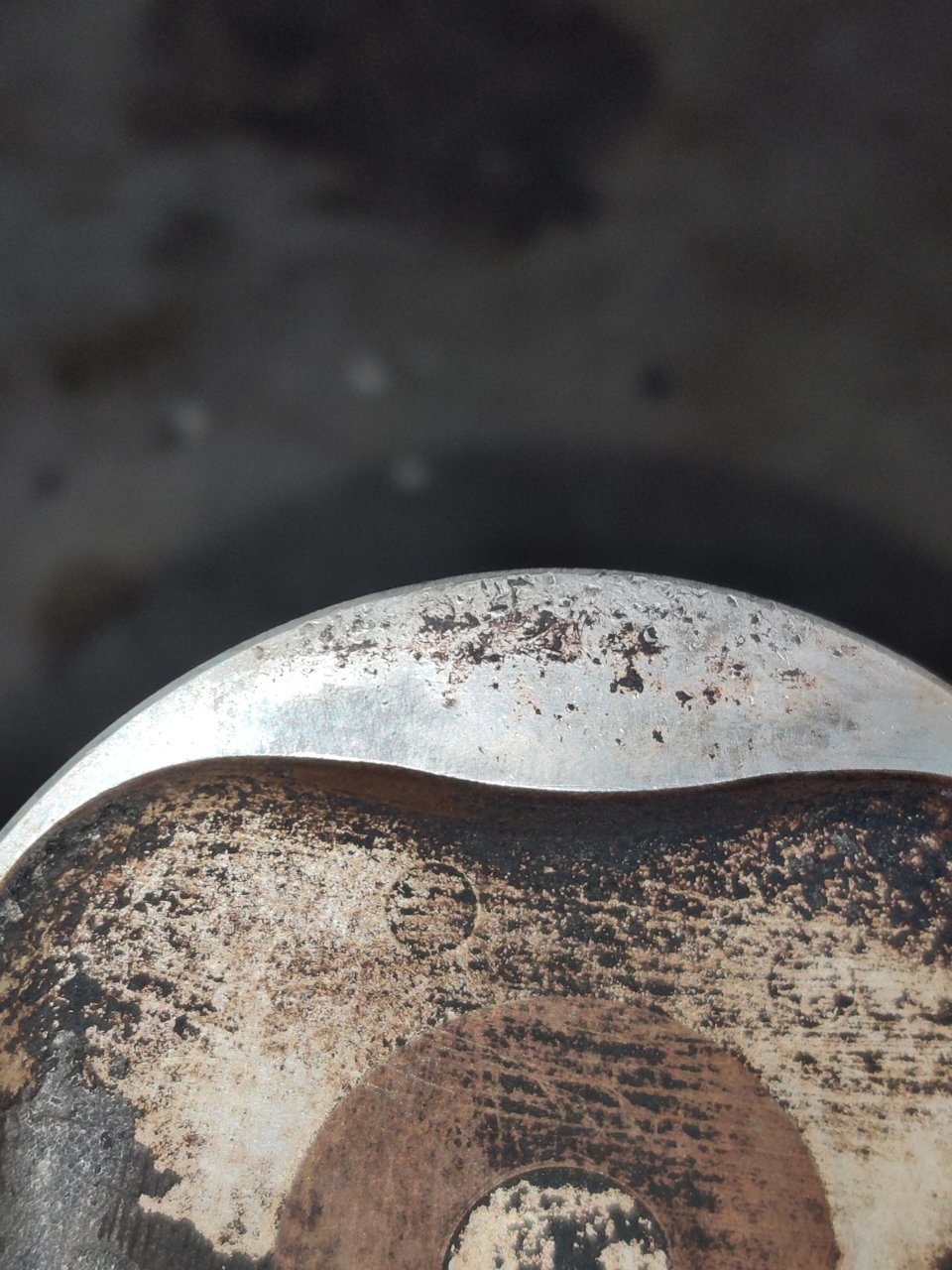

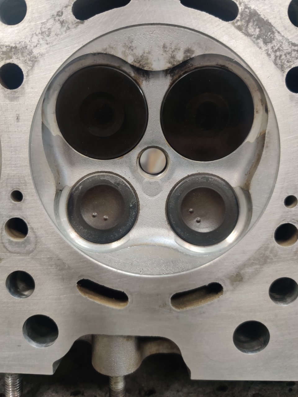

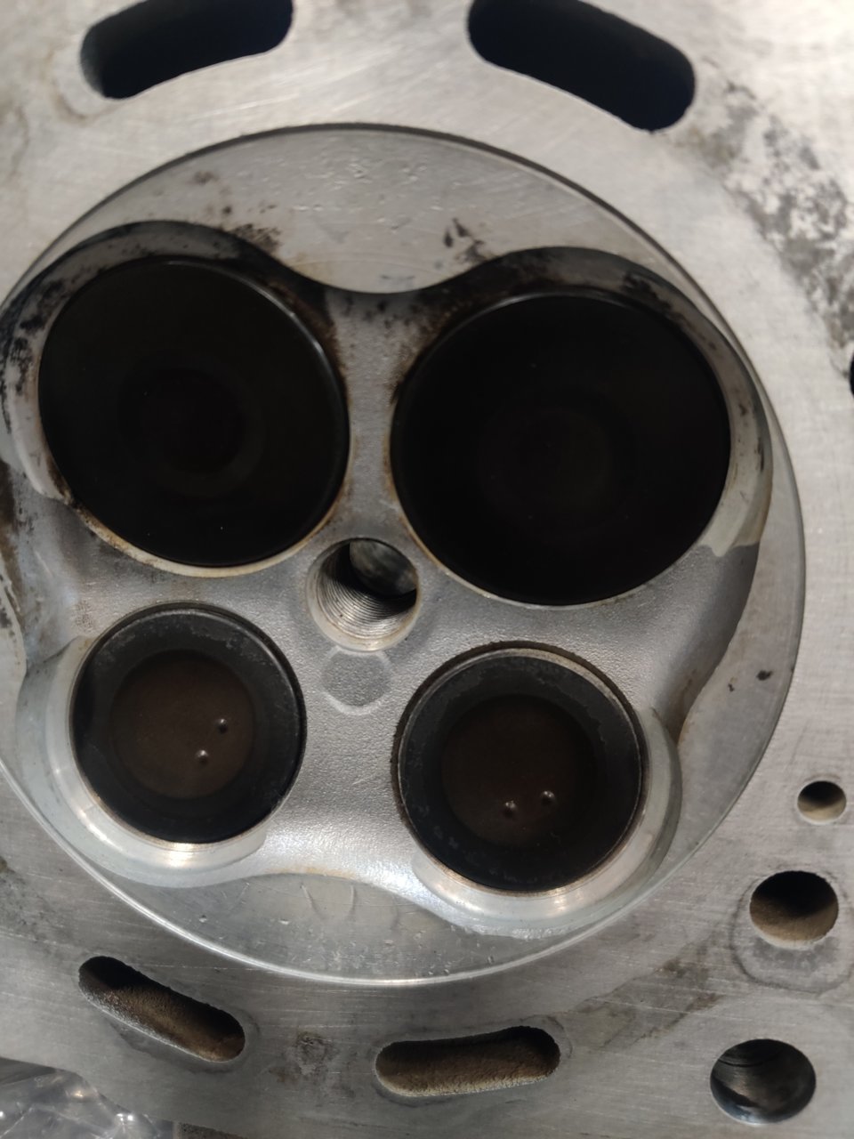

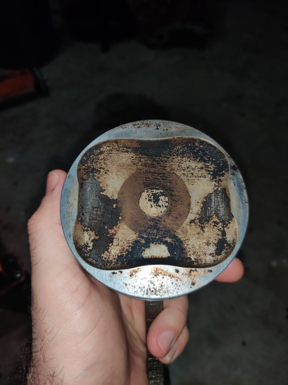

    I going to go back and revisit the Pistons and their putting I was talking about. I have looked at the bottom of the cylinders heads, now that I have them back. I see that the putting is on the pass bank, cylinders 1 and 3.
    Maybe it is timing. @JustDSM any input?

    It certainly looks like detonation pitting to me.
    Did you find a lot of carbon build up on top of/around it or was it freshly pitted looking when you first pulled everything?
    I ask because I know you don't have the ability (or did you ever pick up a MPVI2?) to log. I'm confident in the tune you're running as most folks with the 2.8-2.7's run a very similar calibration. It's been one of my solid performers now for quite some time. I just recently had a guy do a dyno test with it.
    https://www.tacomaworld.com/threads/hp-tuners-for-2005-2015.600793/page-375#post-26010933
    https://www.tacomaworld.com/threads/hp-tuners-for-2005-2015.600793/page-375#post-26011068

    @JustDSM I did not notice the pitting until I cleaned the carbon build up off the pistons. There was a good amount of carbon build up on all cylinders. I will say that my attention was more towards bearings to find a source of metal in the oil. I have picked up a MVPI2+ with all the other parts for the engine. After break-in I will send you some logs to see how it looks. There should be more pics of the head off in earlier posts.
