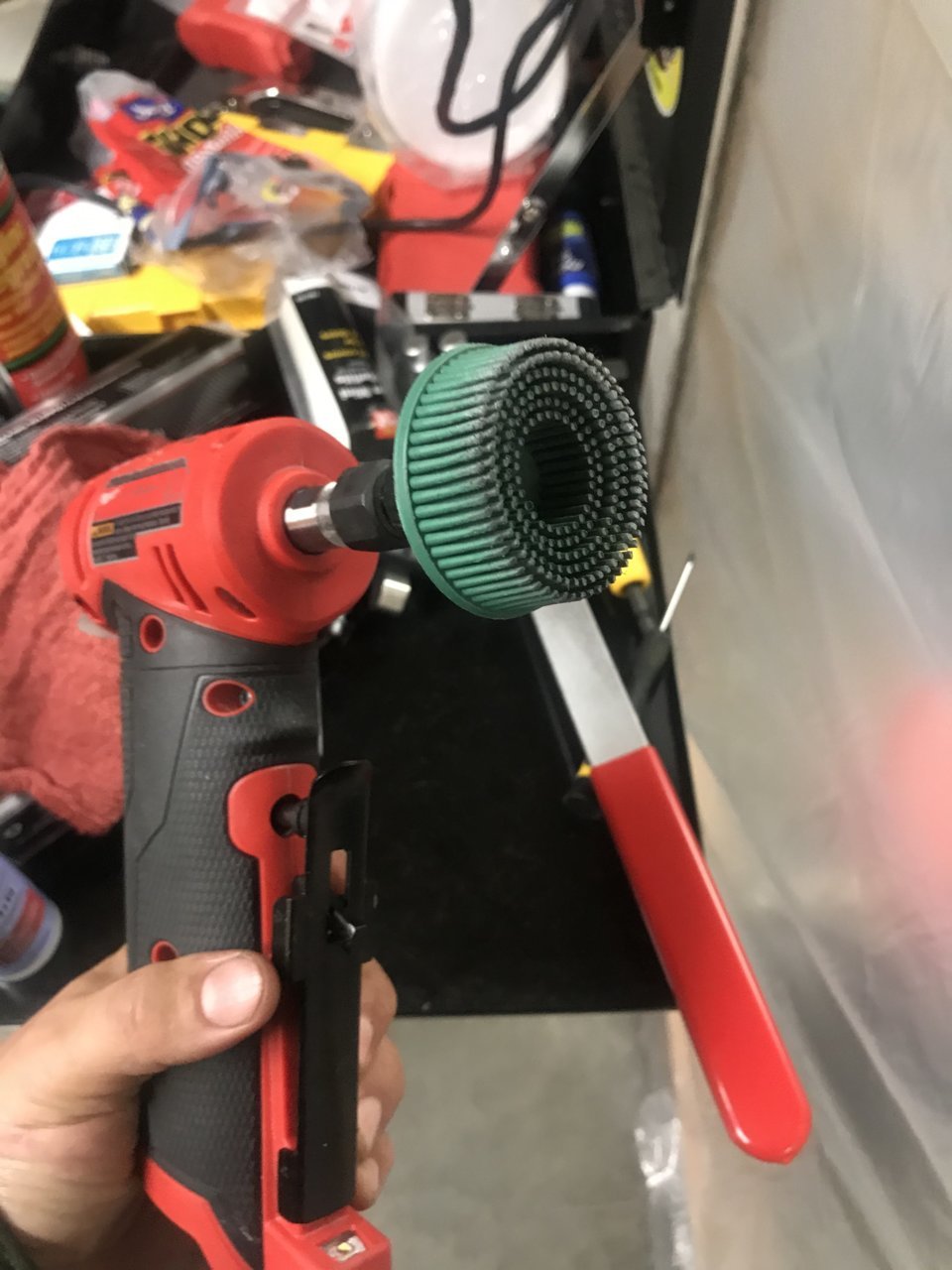

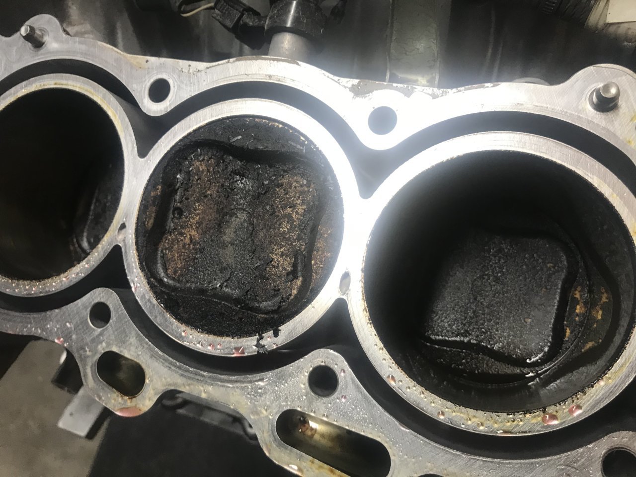

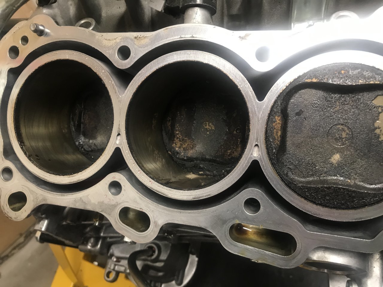

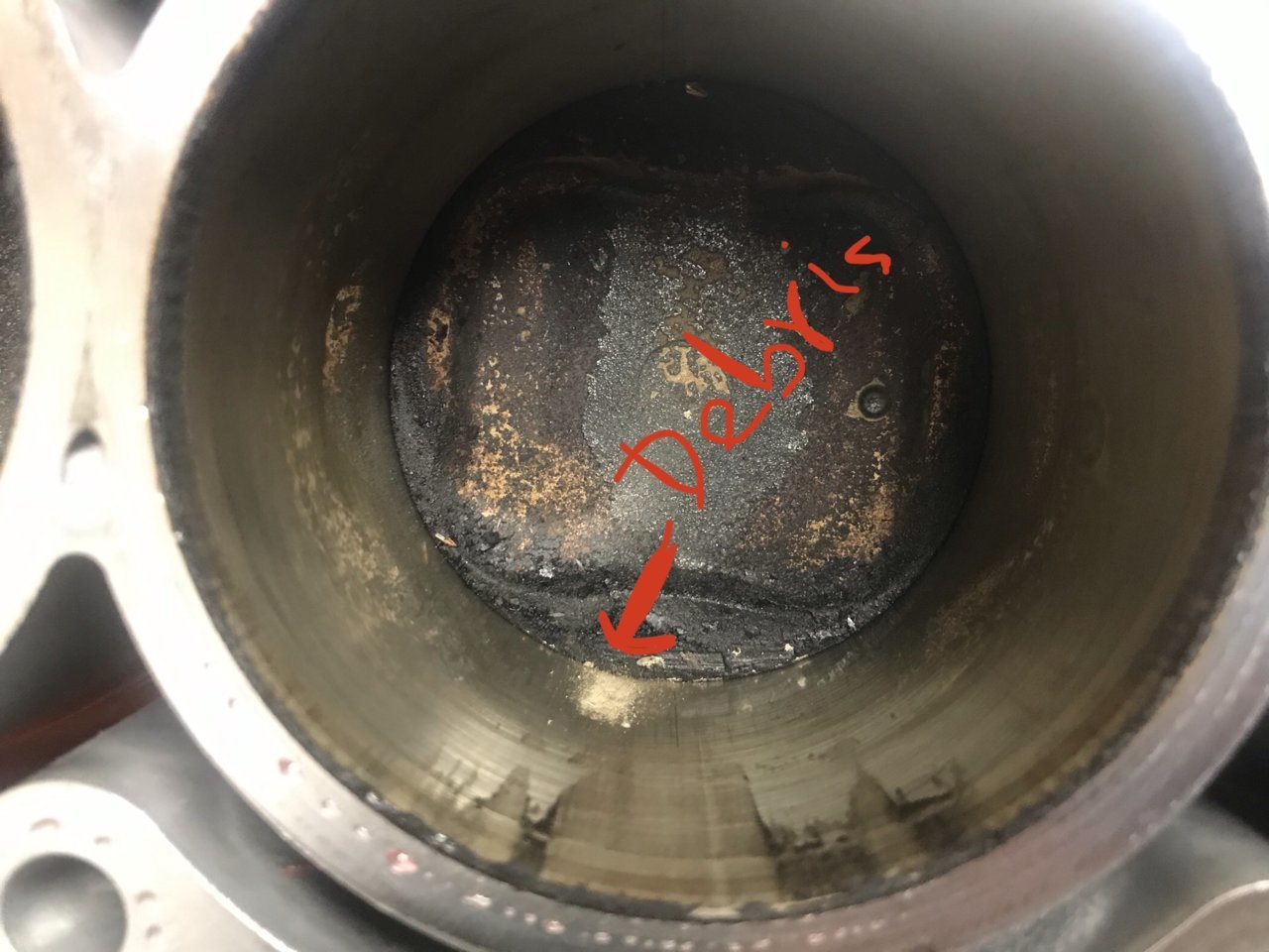

    @Torspd Using borescope I found some debris in one of the cylinders in the new to me engine. I have a head gasket kit. Against my better judgement I decided to clean the pistons with a silicon brush. I didn't think I hit the cylinders but I did very slightly. Do you think I'll need to re-deck the block? I just don't want to hassle with removing pistons/rods, etc...

    What does the brush look like?
    Is any of that detectable by fingernail?

    Impossible to tell from the pics how much you ground off the deck, but to get the debris out of the cylinder, take an air blower hold it close to the piston and blow in the middle of the piston. That will pull the debris out.

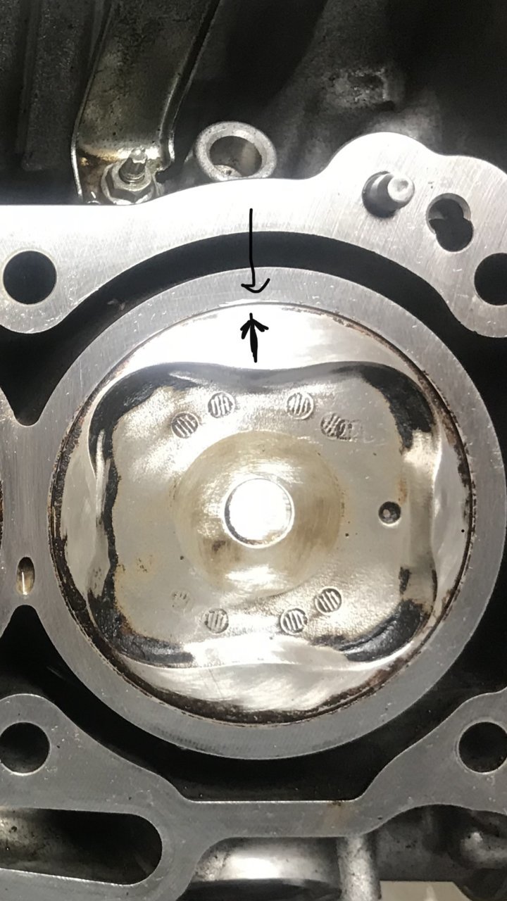

    Cant feel with fingernail. Very subtle to the eye at the right angle.

    Which head gasket?

    Driver side

    Sorry. Which brand?

    Stock from Toyota. Got the kit from Toyota.

    The Felpro ones take up for some irregularities. I'd say the copper coat, gasket, and call it a day.
    Your decision ultimately.

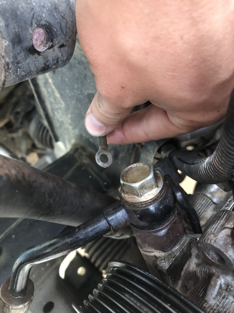

    forgot where this little guy goes and it’s probably right in front of my face but anyone know?

    Toyota service manual does not allow for resurfacing of the block or heads. If it is 0.0020 or less, you are ok.

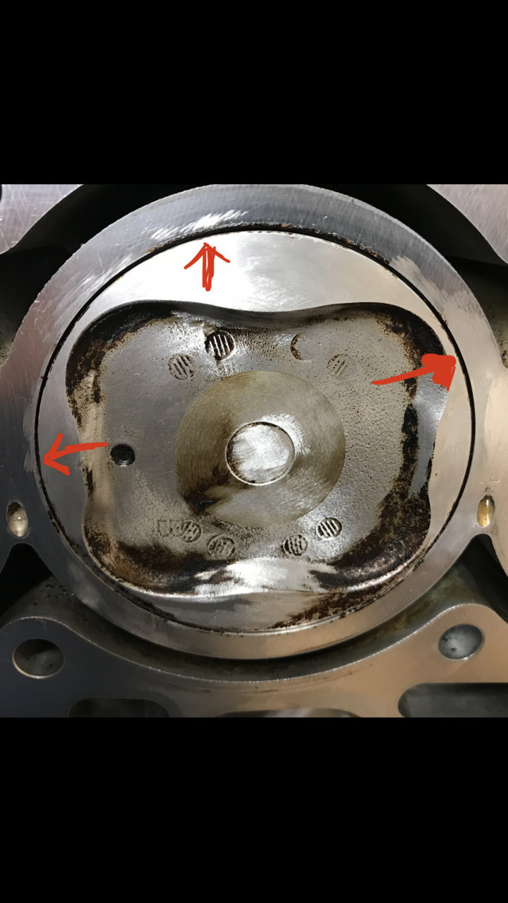

    Looks like ground behind the passenger side head.

    Found it, took this all apart over a month ago, little rusty

    Yup. Gonna drop it off at machine shop tomorrow.

    I would check the flatness before committing to a decking job.
