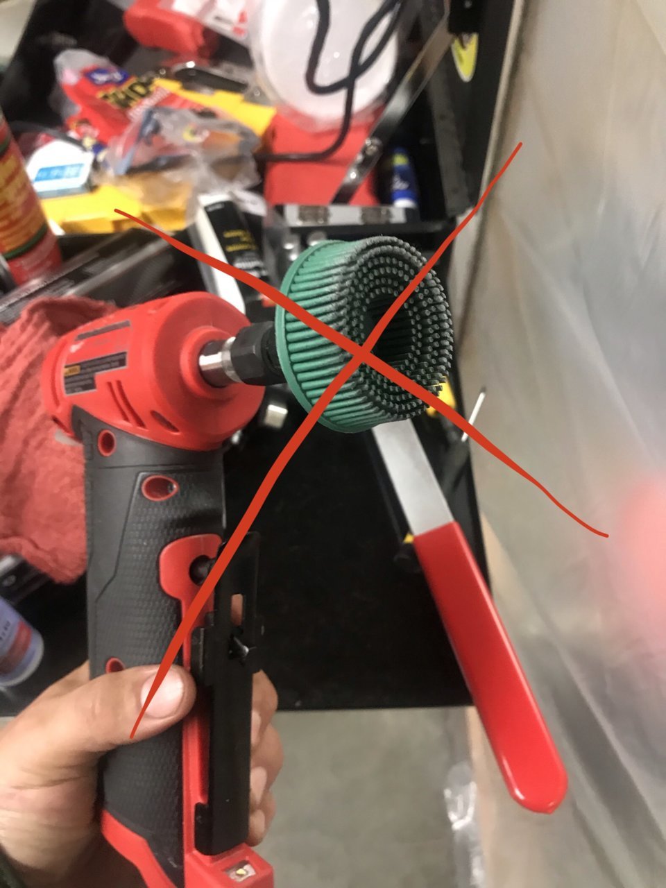

    block saved. I checked myself with straight edge/feeler and had machine shop double check me. does not exceed spec of 0.002"!
    to anyone following this thread in the future. Avoid the silicon brush. Was an old technique no longer used. machinist said one of his most common reasons for re-decking on backyard mechanics/DIYers is this darn brush. Through it away! he said.
