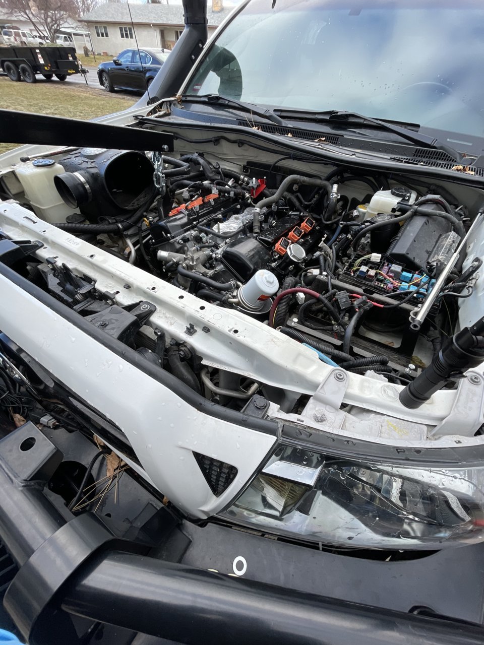

    Engine is in the bay, now parked inside garage. Gotta get it all buttoned up over the next couple of weeks. Too much work and too little time for fun. Have a daily driver so I’ve been taking my time.
