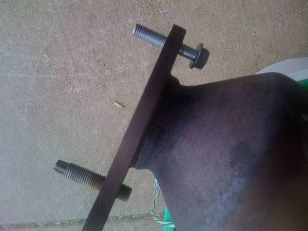

    Here's what I did for lift hooks. Theres a hole at each side of the heads, they're pretty thick. I bought some links at Lowe's, each having over 2500 lb rating... the pin fit perfectly through the hole.
    Worked great!

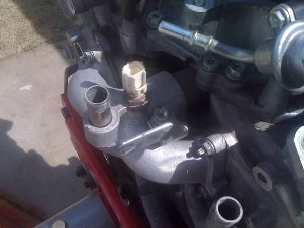

    A couple things that slowed me down today... When removing the exhaust I twisted off one of the studs. Had to drill it out. The other issue I discovered close to the end of my reassembly. As I was reattaching the manifold that required surgery, I noticed a connector hanging around the rear of the block that didnt have a mate. It turned out to be a water temp sending unit located in an impossible position. Here's what it looks like... this is the only time you will see it unless you pull a good portion of your intake and water lines on the raer of the engine.
