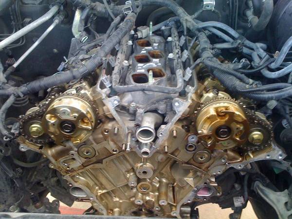

    I've seen several people here report replacing head gaskets without pulling the engine. You still get to pull the timing chain cover since the chain has to go to pull the head. I've done a number of head gasket jobs for various family members over the years, haven't had to pull an engine yet. Of course a front-wheel drive v8 might change that but I am not buying one myself.

    Interesting...I have a buddy who is a service writer at a large Toyota Dealership. He asked one of his lead techs and they said what I've heard from others, that you have to pull the motor because the oil pan to timing chain cover gaskets can't be done correctly unless the engine is pulled. I did see an alternative method by pulling the front axle assembly but that looked like even more work in the long run.
    Funny thing is, the engine is still running fine. It's at almost 190k, but the oil is clean, no signs of coolant in the oil, and the only CEL I did have, the p0304 cylinder misfire and obvious miss on cold starts have gone away. There's a little bit of brown residue in the coolant and bubbles coming up through the coolant, which indicates some bypass from the cylinder into the cooling system, but like I said its running fine. I'm tempted to just let it ride a while and monitor it for any signs of getting worse before I have to pull the motor.

    Heres a couple pics of my old motor still in the truck with timing cover off before I did the swap.
    I've never pulled heads on a 1GRFE, but I will say, there is a lot of space to move around in the engine bay, especially when you pull all the ancillaries, intake, etc...
