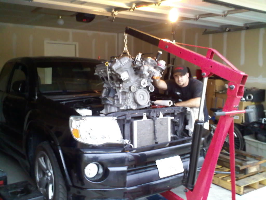

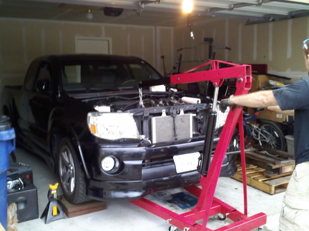

    My struggle is time. I have garage and most tools. Gotta get an engine crane though. @Torspd did you get a wreck yard used one or re-built one?

    I have gotten a few wrecker engines.
    Not proud of it, but Harbor Freight was the only place at the time with an engine hoist, in stock. Hasn't failed yet, amd was only around $150. Start to finish, I could knock it out and running in about 8 hours.

    I've done it many many times on the 2nd Gen. :anonymous:

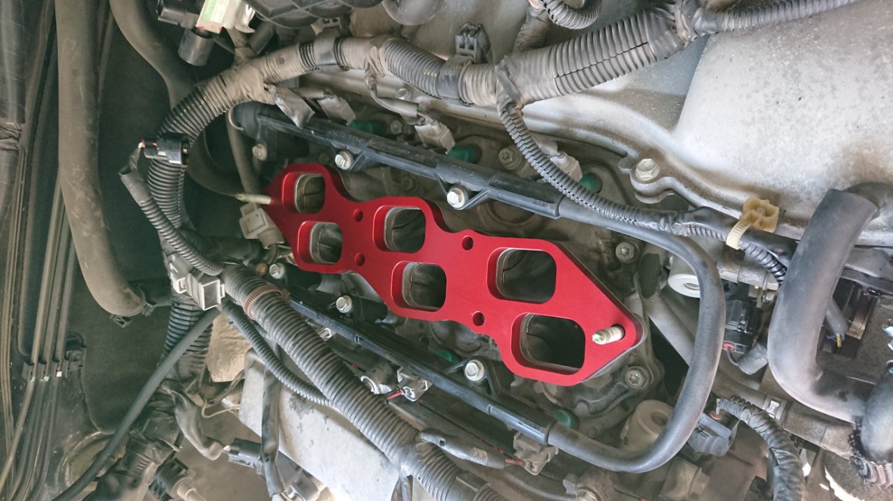

    Passenger side valve cover gasket started to seep a little as many do... replaced it last weekend. Doing driver side gasket tomorrow and while I'm in there, adding an XTP intake spacer just for fun.

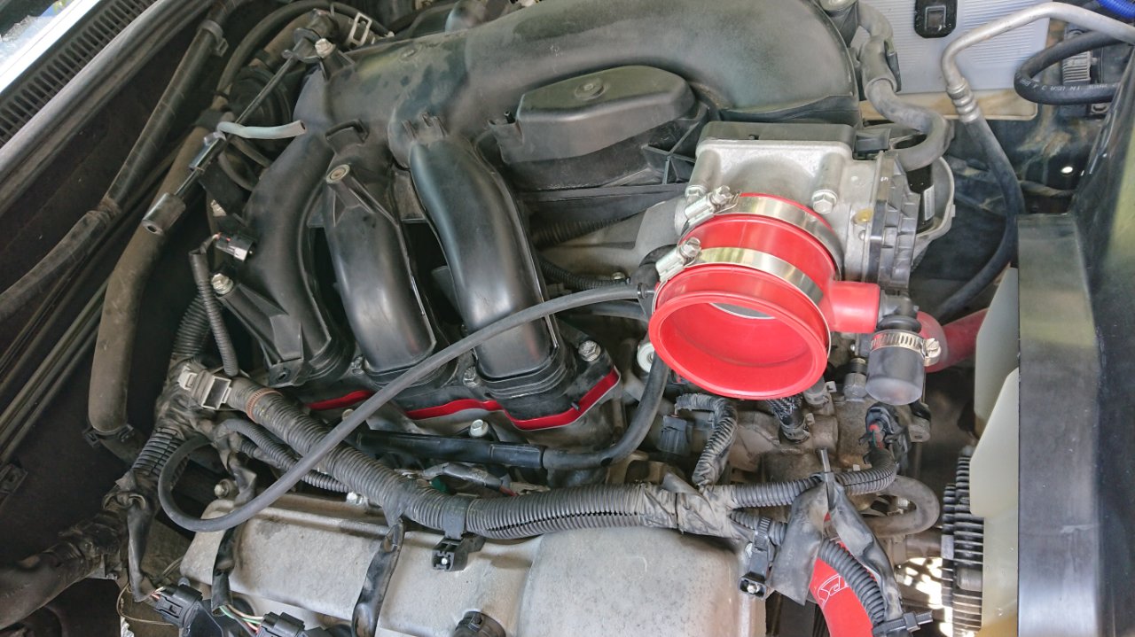

    Did it.

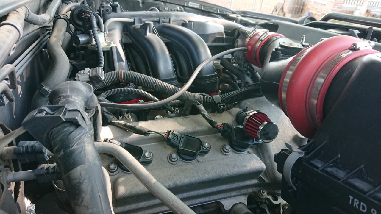

    No PCV system huh?

    Quoted pics have inlet side of PCV line capped off. (right off the red boot in front of the throttle body)

    I still ventilate, just not through the intake.

    Glad to see you still updating this thread @lucky , after 10 years.
    Any pictures of the current intake?

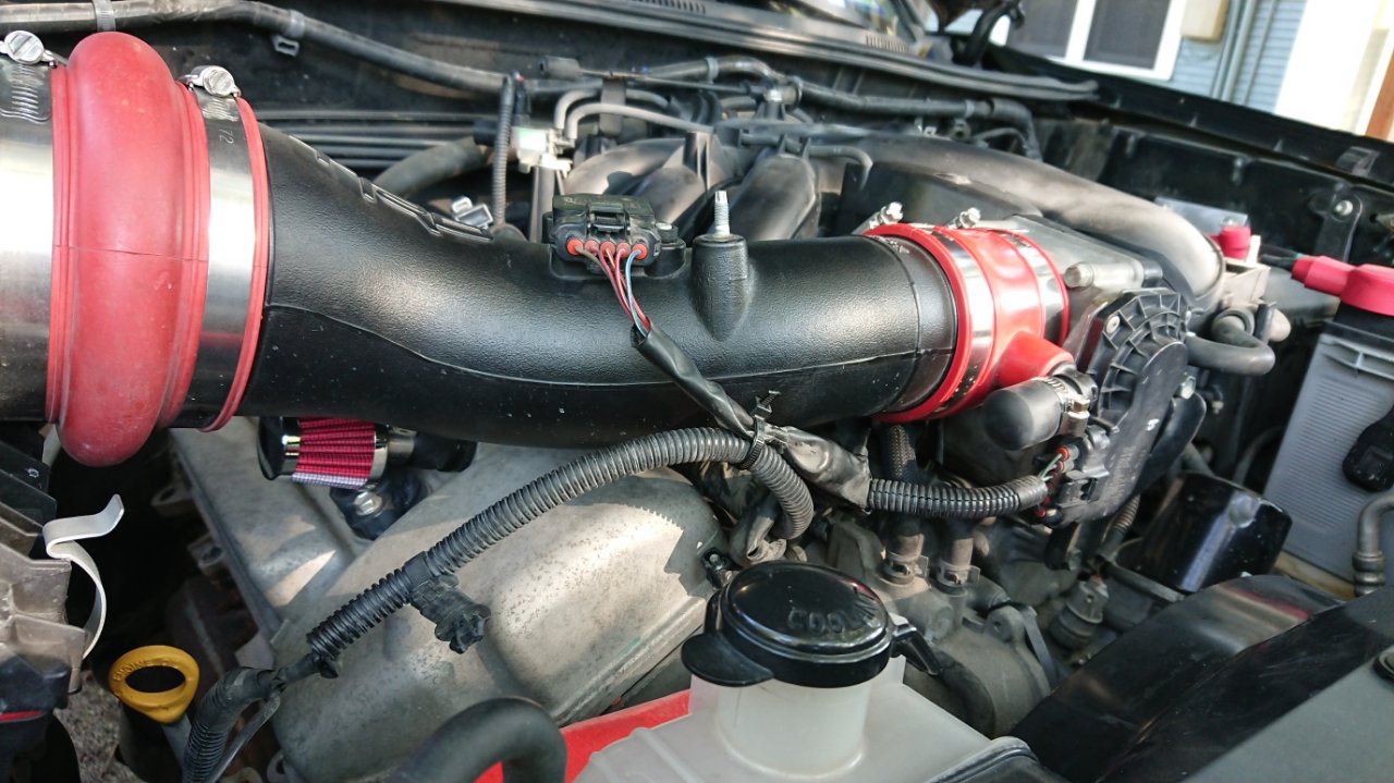

  18. Sep 16, 2019 at 7:51 AM
    #78
    lucky
    lucky [OP] Well-Known Member
    Jun 21, 2008
    #7468
    488
    NB, TX
    07 PreRunnerX4
  19. Sep 16, 2019 at 7:52 AM
    #79
    lucky
    Jun 21, 2008
    #7468
    488
    NB, TX
    07 PreRunnerX4
    I've been running like this for years on the swap. When the filter looks a little dirty, I replace it. If this is a bad thing, some one stop me now. One Taco engine swap is enough for me.

    On the driver side valve cover, is that vacuum hose still attached between the valve cover and intake manifold?
