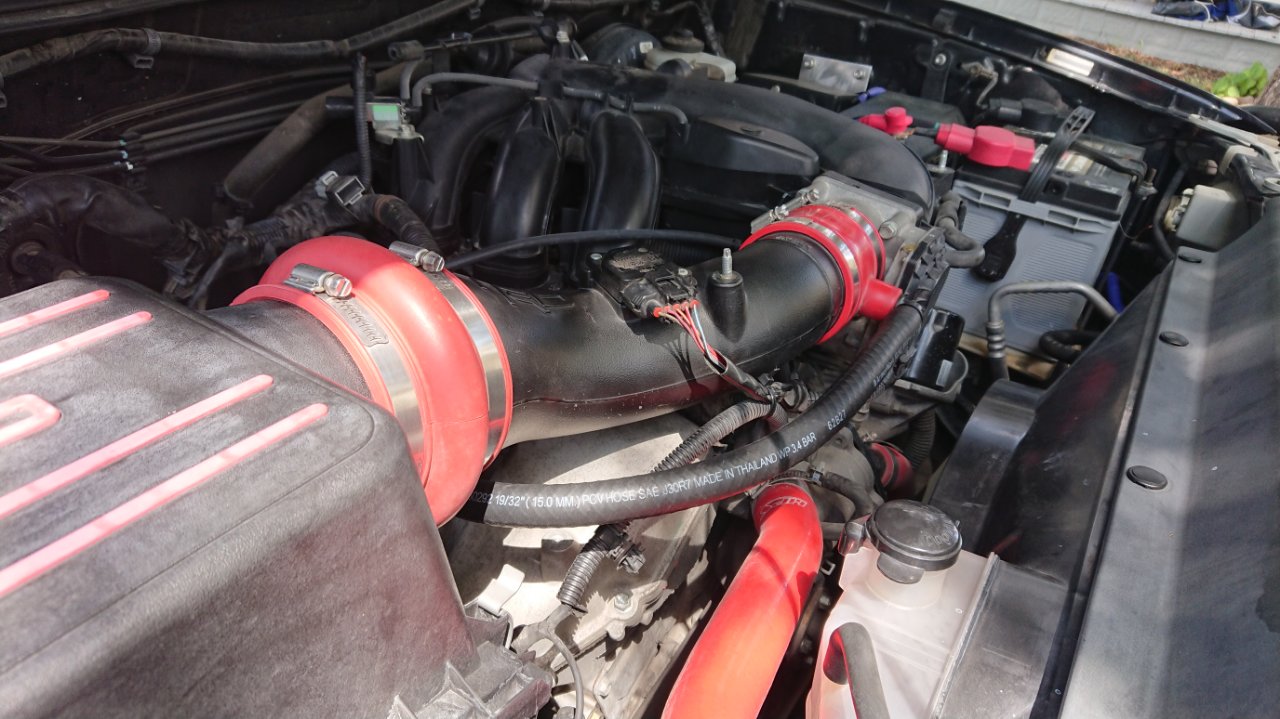

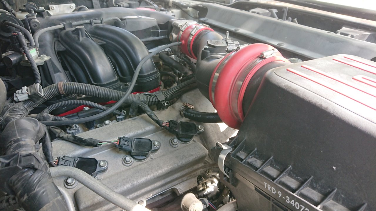

    Yup its there.. I guess I've overlooked that one this whole time.. its toward the firewall side of the valve cover and attaches to the bottom of intake downstream from the throttle body. Have you done anything different with that one?

    The way you have it, with the open to atmosphere vent on the pass valve cover, then the vacuum line from the pcv valve to the intake plenum, you are essentially introducing a huge vacuum leak of un-metered air. Either go back to stock where air gets pulled in via the standard route (after MAF sensor, before throttle body via that big ass cap you have), or much less preferred, cap off the intake plenum, remove pcv valve, and run another open to atmosphere filter on the driver side (this can cause sludging problems though).

    Switching back to stock seems to be the right option. Curious how the truck will react if I have been leaking/loosing vacuum all this time...

    You'll gain some power. As well as fuel economy

    Swicthed back to stock.

    Working from home today... lunch time. Done. AS a coincidence, I had a low voltage pending MAF alert (CEL) from the weekend since installing the XTP spacer... I figured that was the cause, and maybe it was, but first start after reconnecting the vent to the intake, (CEL) fault cleared on its own.

    been running the XTP mid intake manifold spacer for years now. No CEL's of anykind due to it. Low voltage at the maf could easily be due to the bypassing of the PCV inlet like you originally had it.
