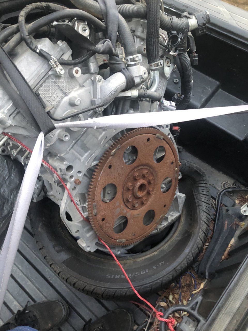

    Even right now!

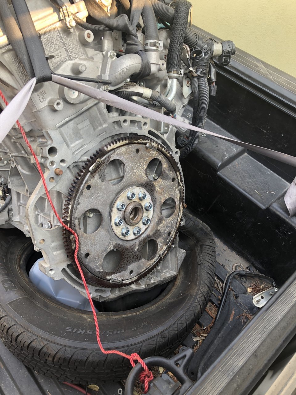

  2. Sep 2, 2020 at 5:18 PM
    #162
    Oreo Cat
    Oreo Cat Worst Member
    Sep 19, 2016
    #197755
    5,381
    Coeur d’Alene, Idaho
    All cleaned up with new bolts
    Minerva09 and Torspd like this.

    Nice and clean. Are you gonna redo the seals?
  4. Sep 2, 2020 at 6:43 PM
    #164
    Oreo Cat
    Sep 19, 2016
    #197755
    5,381
    Engine only has 3k miles on it so no
  5. Sep 2, 2020 at 6:46 PM
    #165
    Oreo Cat
    Sep 19, 2016
    #197755
    5,381
    Well should I?
  6. Sep 2, 2020 at 6:47 PM
    #166
    Oreo Cat
    Sep 19, 2016
    #197755
    5,381
    The 225k motor doesn’t leak

    I would have probably just reused my original flexplate unless I had a reason not to, but it cleaned up relatively nicely.

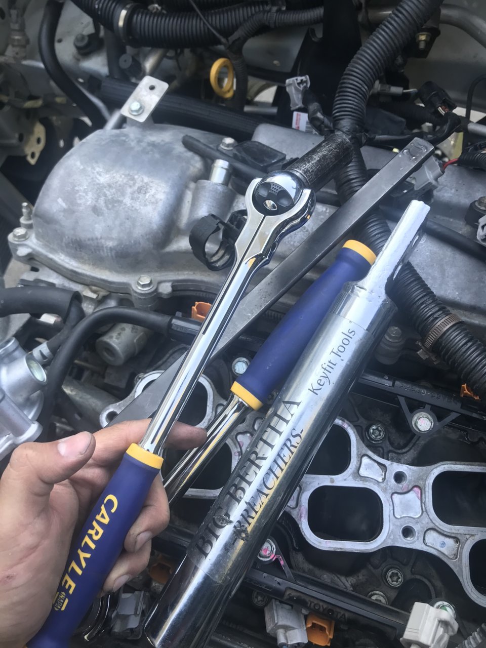

    Anyone have tips on how to remove the top two bell housing bolts without tilting the transmission down?

    Original one was cracked

    I had to get a closed end wrench on the bolt, put a strap around the wrench, stand on top of the engine and pull the strap as hard as I could to get it loose

    Snap-On swivel head ratchet.

    That and big Bertha did it!

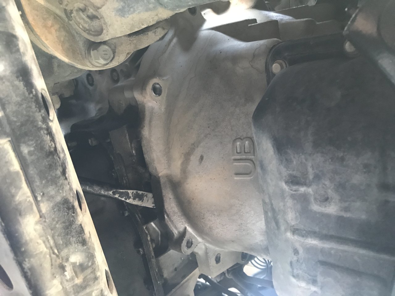

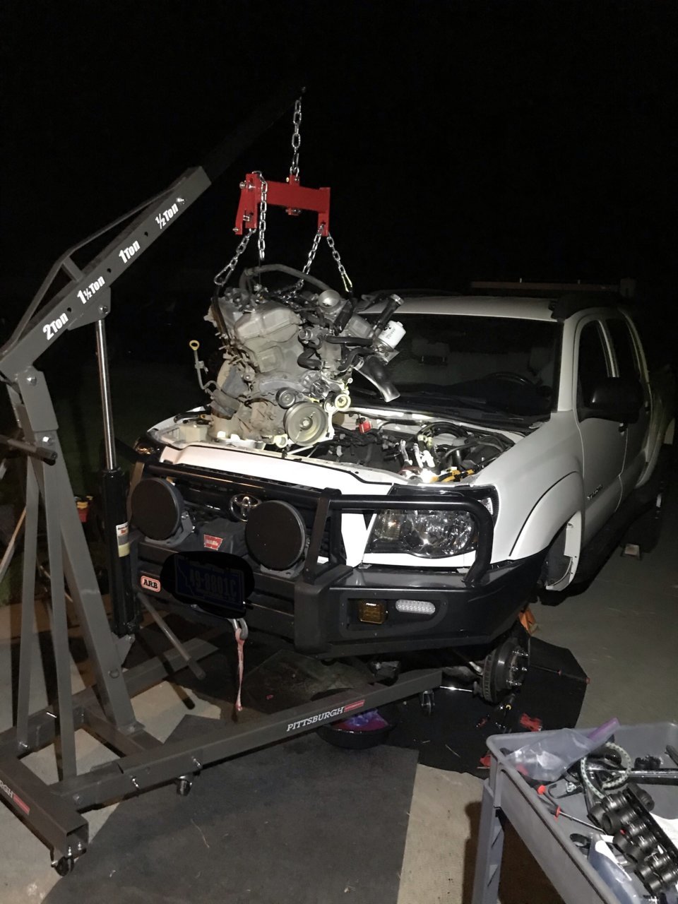

    Got all the bell housing bolts off. Sucker is stuck. Any recs on how to get engine detached from trans?

    Yep that’s where I’m at, got my engine out and found the hard way the new one won’t go in unless the trans is out. Or at least disconnected and pushed back a a bit

    Can't forget the starter bolts. ;)
    For me, because I have been in and out of my engine bay sooooooooo many times, some of those wire harness brackets became pesky. They're gone.
    I reach both of the top two 17mm bolts, from the passenger side of the engine bay. Takes some force though, don't get me mistaken.

    The top 2 17mm bolts. I stuck my oldest son with small hands and an extra long ratcheting combination wrench on them. Butter. He was sitting on the engine to get them/
