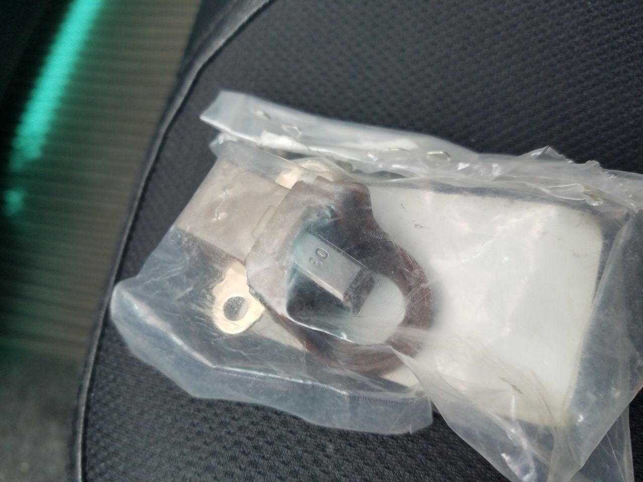

    If it’s the brushes that’s a 15.00 part and easy to fix
    cruiserguy and kuntry09[QUOTED] like this.

    OEM Brushes

    Prolly just brushes. Is it the OEM Denso alternator? If so, definitely keep it and swap in new brushes. They're a very high quality alternator.
