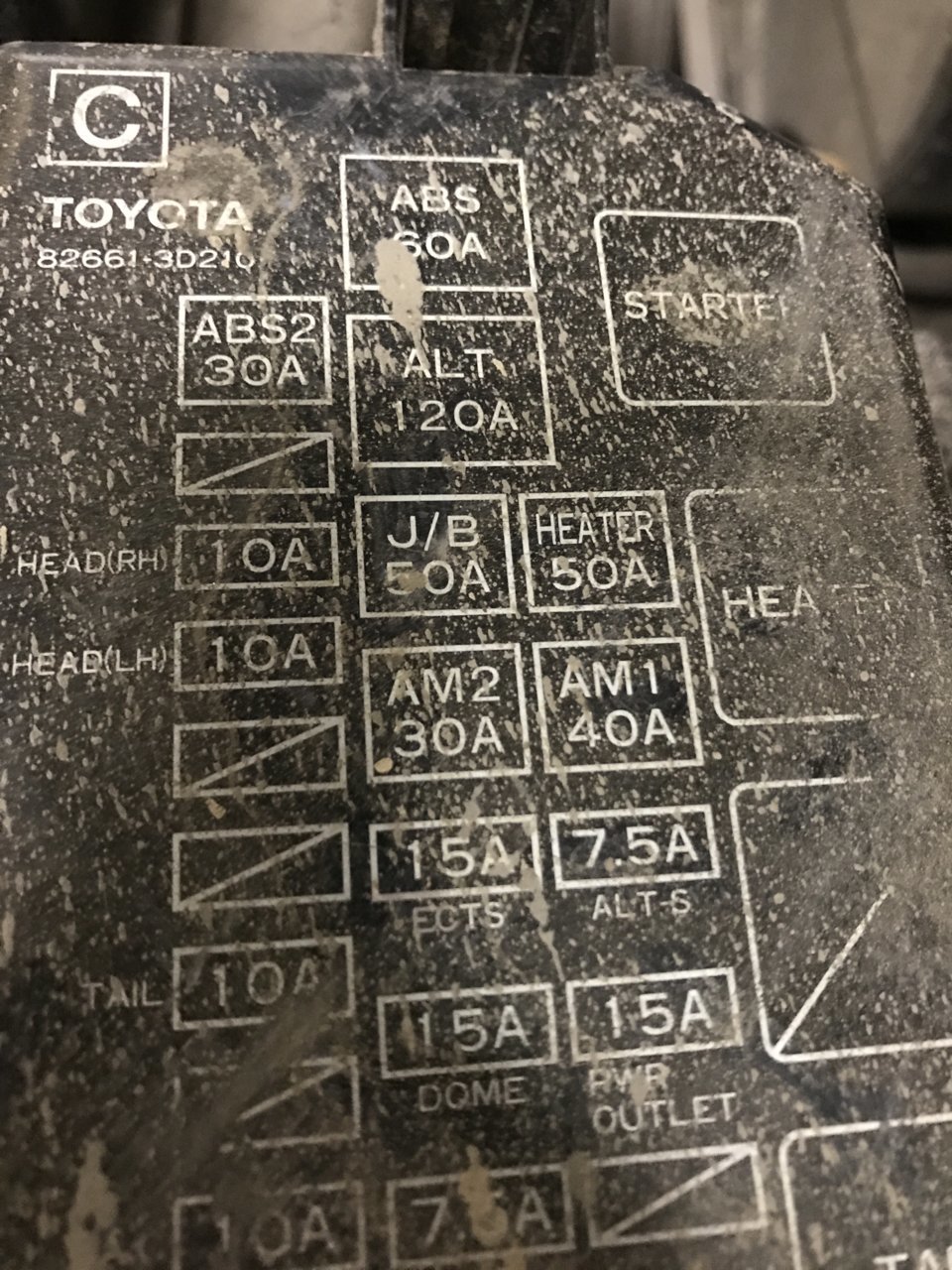

    So I was gonna just run a wire from the alt to the battery and use a blue sea MRBF fuse on it, and I looked at the factory alternator fuse and it's 120 amps? Why is it so high if the 10 AWG wire is only rated for 80 amps max? Is there some kind of different material used for this wire that makes it able to carry more amperage or...?
    I guess the 10 gauge is adequate for up to 120 amps at such a short length according to this calculator

    Is the purpose of the fuse to protect the battery from shorting to ground, like if the cable comes off the alternator and touches ground? Or is the purpose to protect the alternator if for some reason it produces more amps than it should? Or is the purpose to protect the wire between the alternator and battery from carrying more amps than it's rated for?

    The last would be my assumption

    Going off the fuse box in front of me(my tundra) the fuse in the box seems to be for the main bus of the fuse box. That’s it.

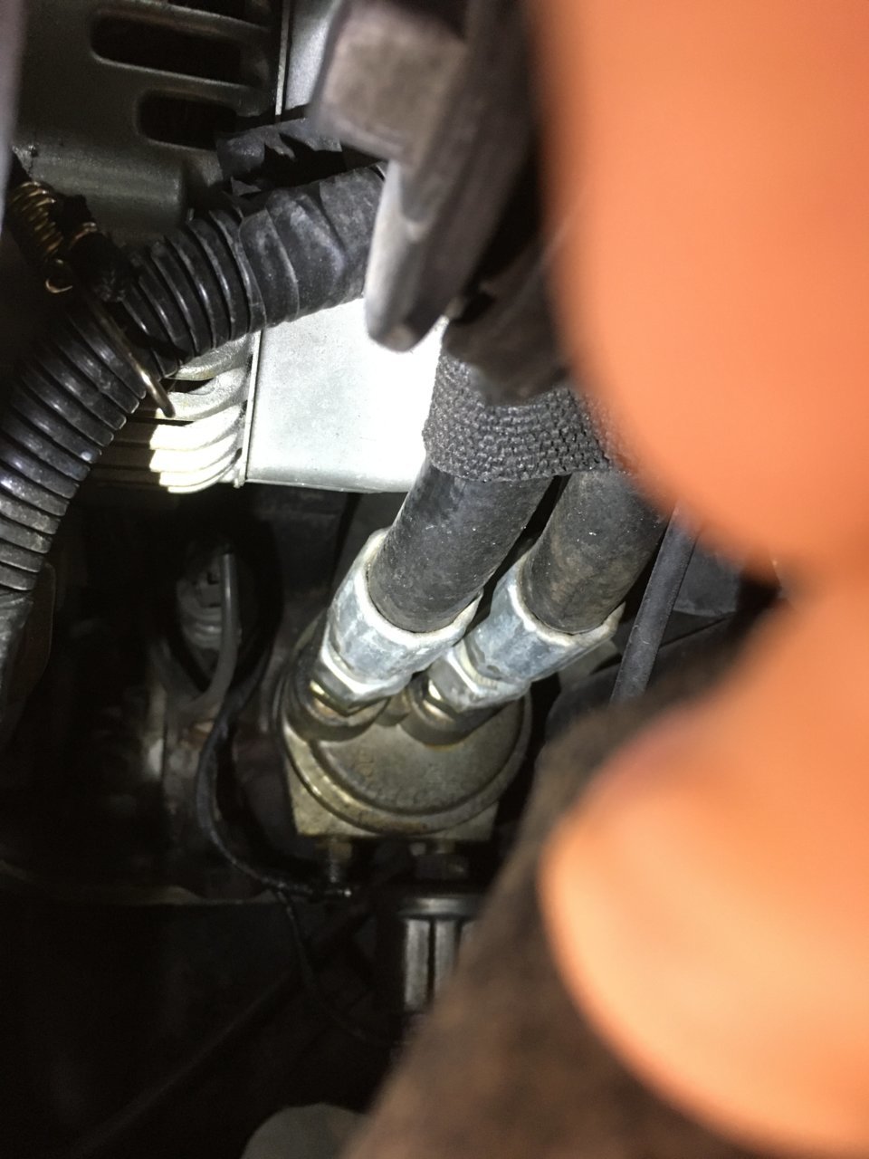

    I got the alternator and brought it home. It is rated at a 120 amps, but the max amps on the test sheet that came with it was only 108. I opened the hood of my truck and noticed something that I had done in the past that was probably going to be a domino effect on this project. I relocated my oil filter, no big deal but the hydraulic hoses are routed pretty tight to the bottom of the alternator, like almost touching. Moving the charge stud to the bottom of the alternator was more of a project that I wanted to do this weekend. I stopped right there, but may pick back up on it this week.
    cruiserguy likes this.
  18. Nov 17, 2019 at 3:22 PM
    #218
    wesb1023
    wesb1023 Well-Known Member
    Apr 8, 2011
    #54586
    649
    Westley
    Eastern NC
    04 Double Cab

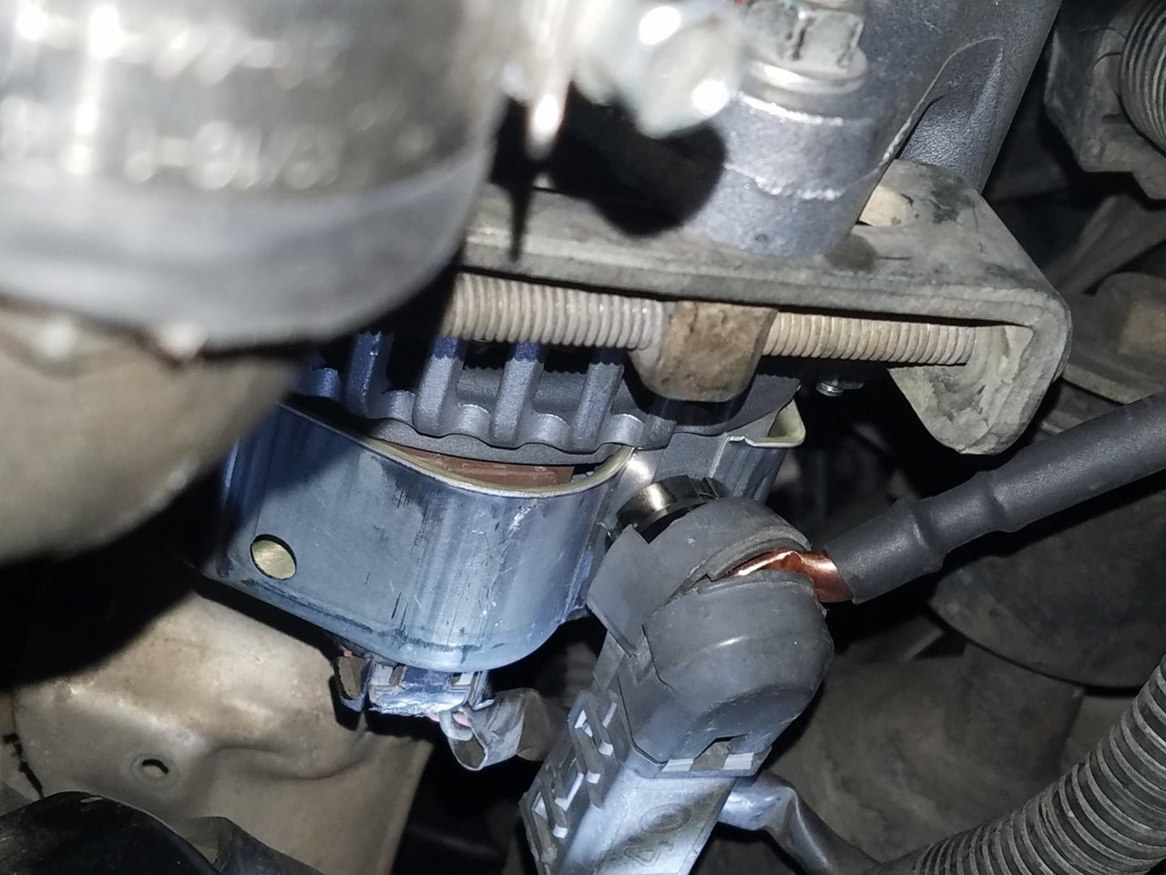

    This is what I’m working with. Can anyone who has installed this alternator snap a photo from the wheel well so I can get a better idea of the exact angle that the charge stud comes out? There maybe room to work with. My truck is supercharged, with the spring tensioner, that allows me to move the alternator towards the engine or away. My length of belt and tensioner will govern this adjustment.D3282BF4-73EE-49D0-A1BB-291314B0E1BA.jpgAB0E6163-F560-42FC-97D4-02EB8AC86BAD.jpg
    Looking back at the photos of the two alternators on the tailgate in the first post, it seems that it’s going to be tight, but may work fine. I’m focused on the angle between the long bolt through the alternator, and the charge stud angle, and length.
    On a further note, any winch is going to overpower any alternator that you install. Those amps are coming straight from the battery, or in my case batteries. The higher the alternator amperage, the faster it will replenish the batteries, and compensate for smaller loads like extra lights, and things like that. A winch draws BIG amps, but is usually only momentarily used its not a constant draw. This is also dependent on the load that you're pulling with the winch. Once the winch gets your truck out of a bind, you notice that the speed of the winch picks up, its drawing less amps at that time. If you have a weak battery, you're also going to have a weak winch.

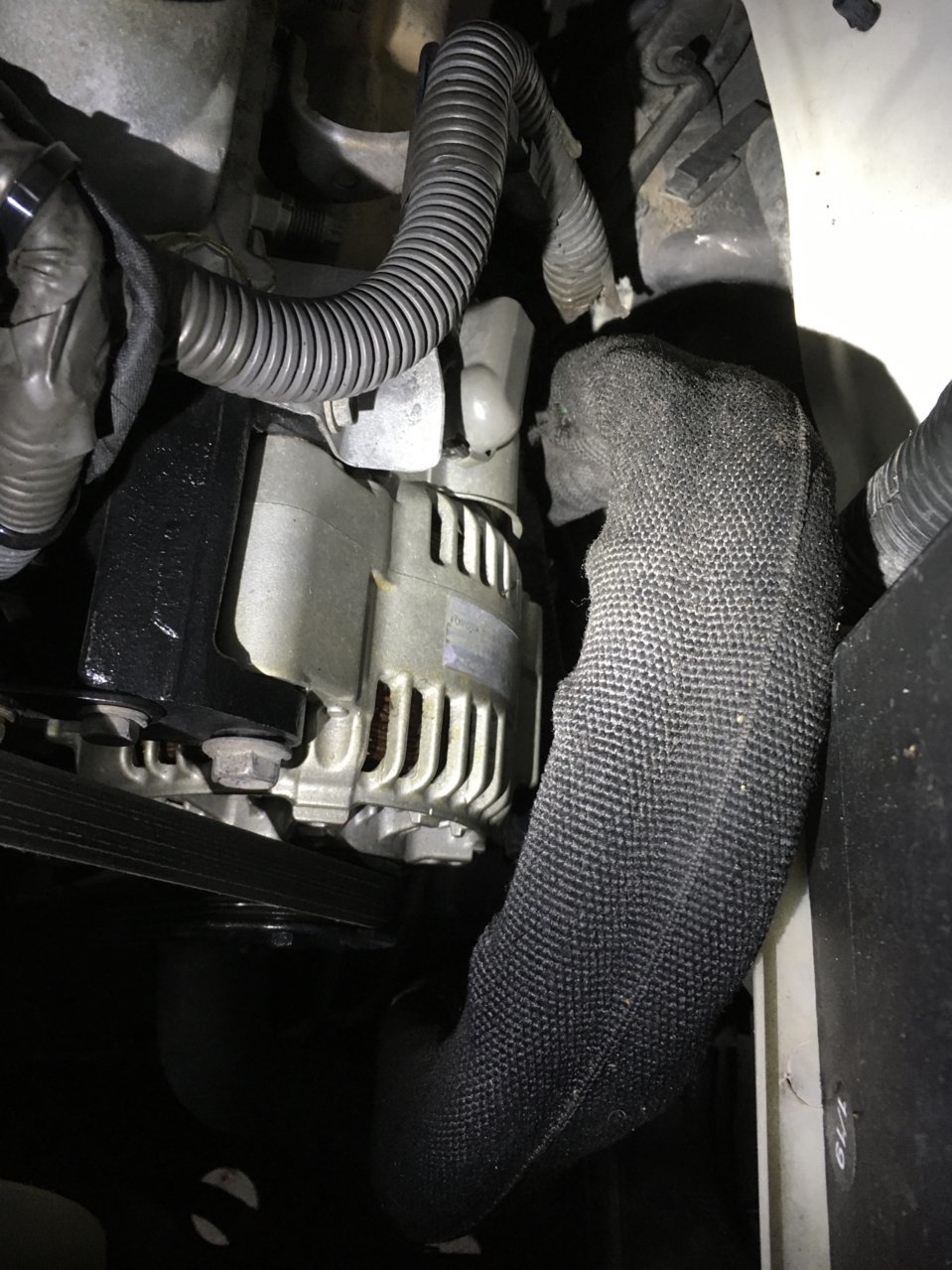

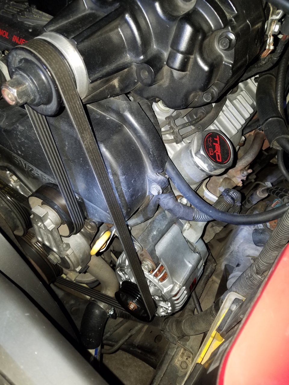

    I’m superchargered and it was no problem to install.
    Its easier to get to it from the underside of the truck.
    The battery bolt attachment is pointing straight down
