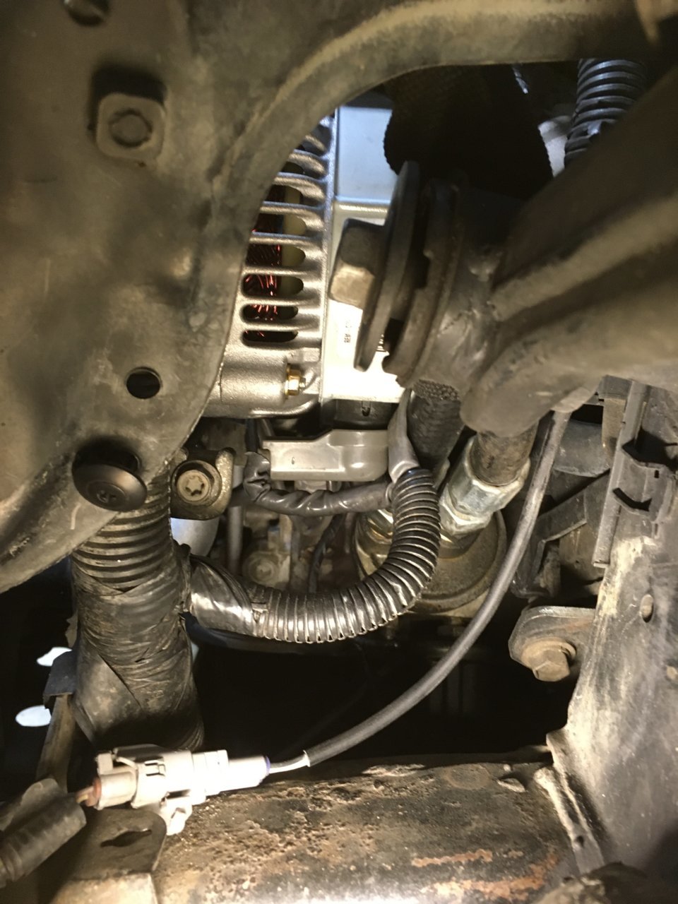

    Got it installed this afternoon. Man it’s a tight fit, but nothing is touching. I’ve still not upgraded my charge wire, but so far I can’t tell a bit of difference in the two alternators.CB122712-5F5D-41D8-A931-F3DE3929E4E3.jpg

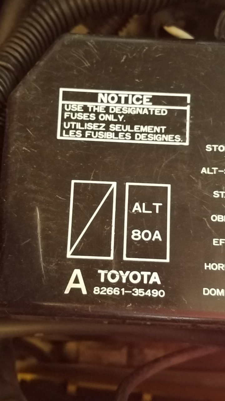

    Also, do I need to up size the fuse to match the alternator listed output? Original fuse size is 80A.

    Only upgrade the fuse if you upgrade you wiring. Something like the "big three upgrade"

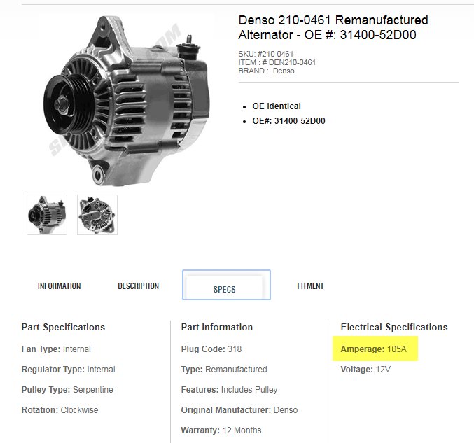

    Definitely keep us posted. I hope the guy at Carquest was looking at something different maybe by mistake. From Denso's website 210-0461 list 105A.
    https://densoautoparts.com/find-my-part.aspx#ProductDetail

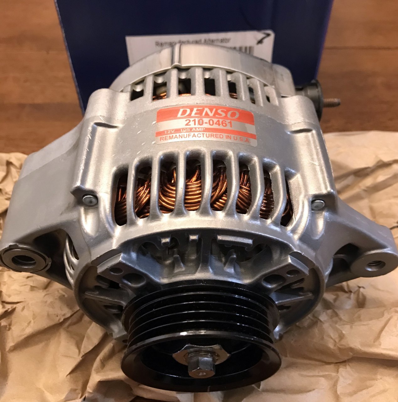

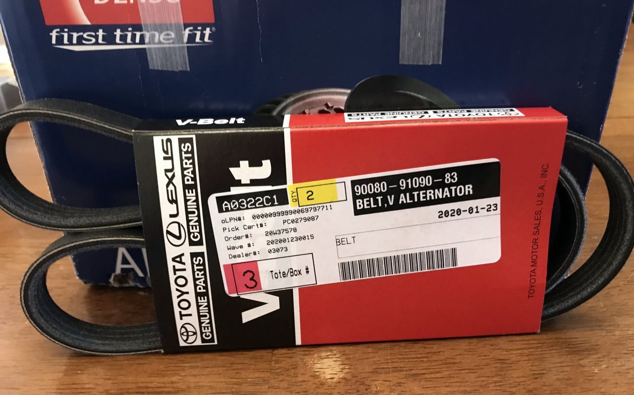

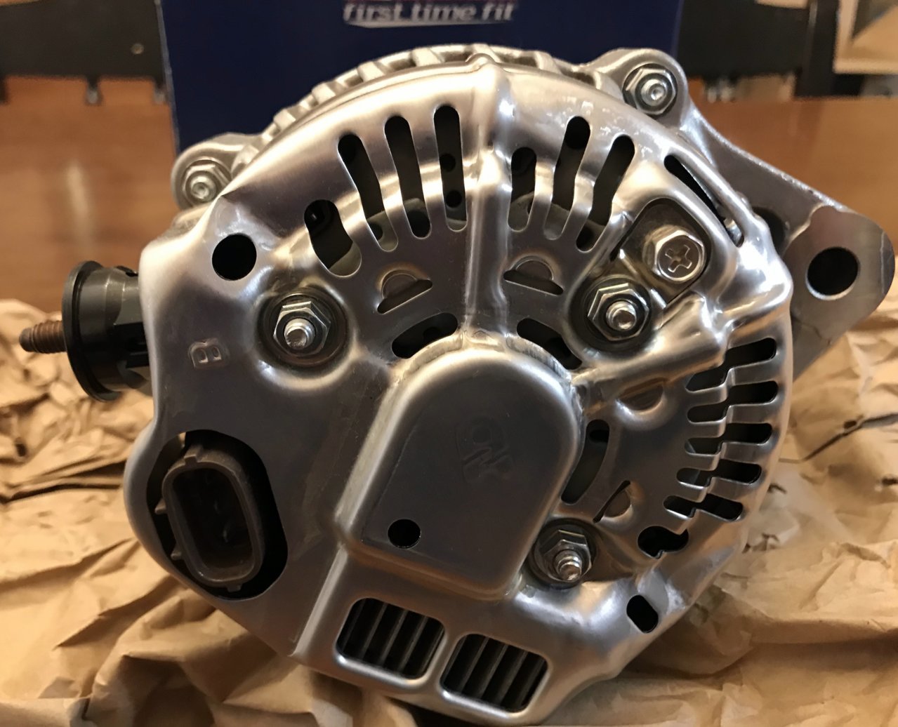

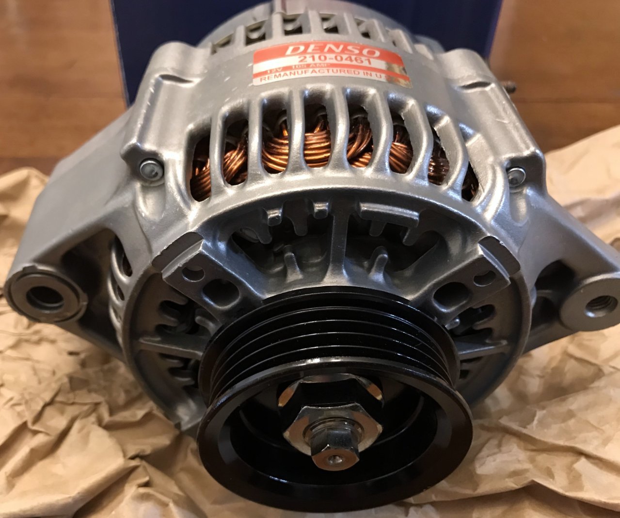

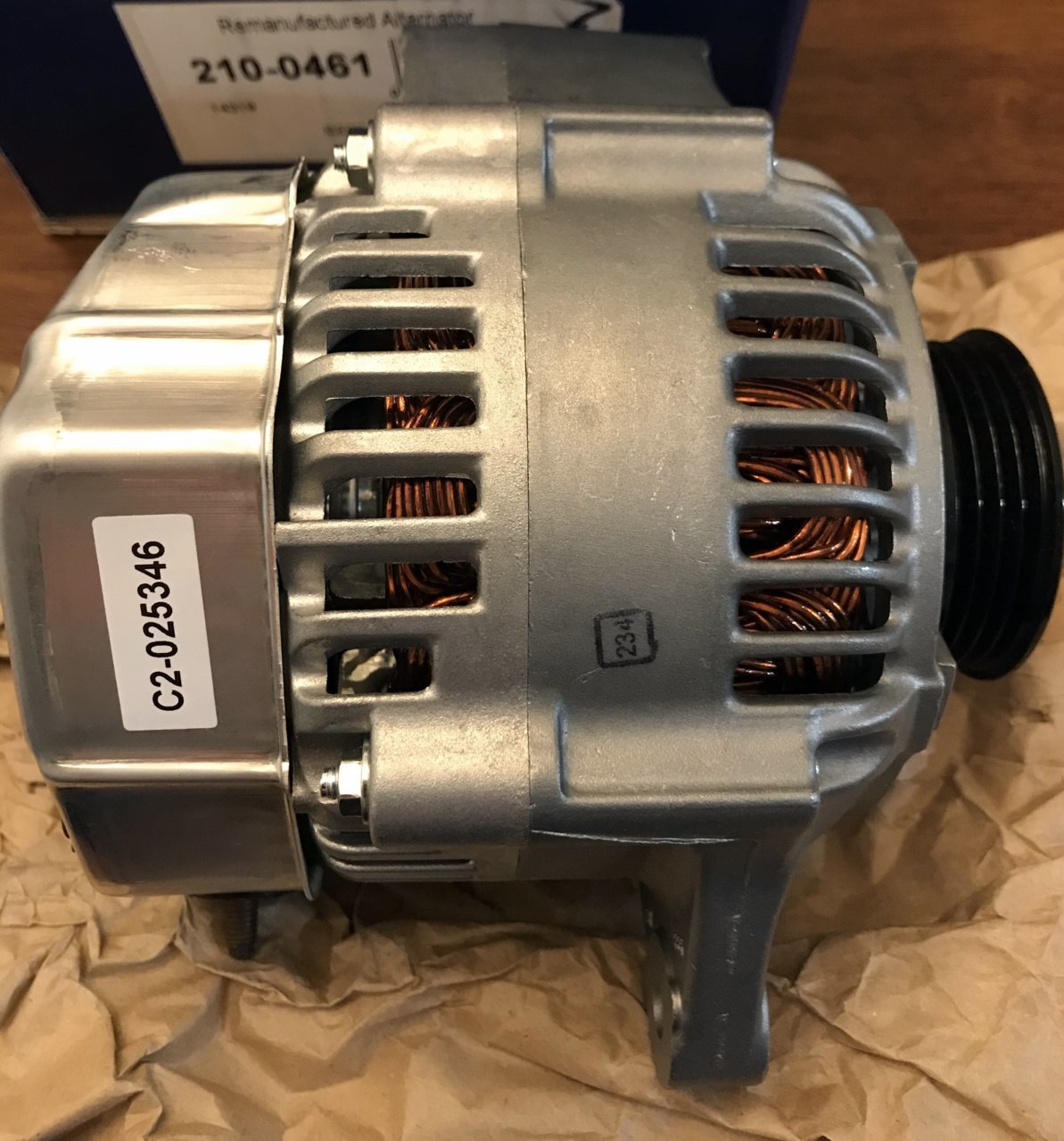

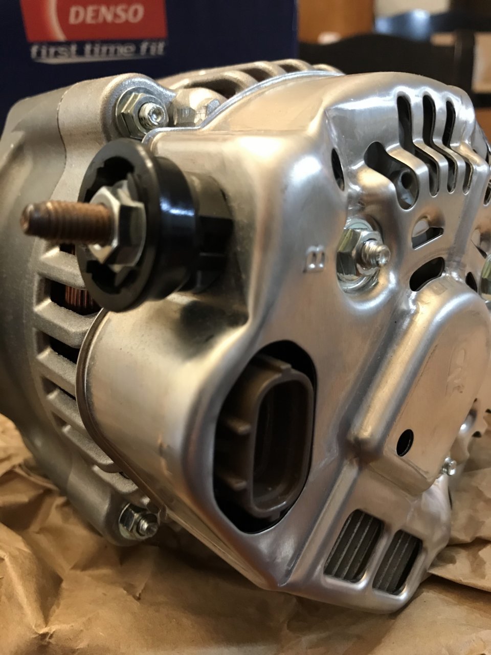

    Alternator arrived!! I'll probably be delayed in getting it installed because my wife had to travel out of town and my 9yr old son has this uncanny ability to want something as soon as I get involved in something.
    But, I did want to post some pics. Also purchased a new alternator belt. Just won't feel right putting an old belt on a new "remanufactured" Alternator!
