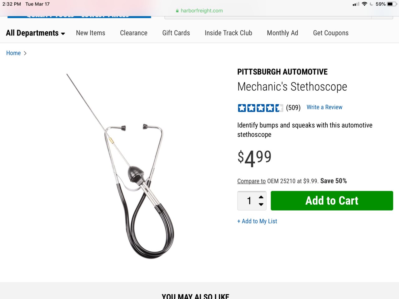

    Keep a 5.00 automotive stethoscope and a truck for when it makes a noise and go track it down

    Was about to say, shits almost double in Denver than it is here in south MS.:spending:I've got the stethoscope but the noise is so come & go its hard to track, the attached video was take a couple of months ago at its worst.
