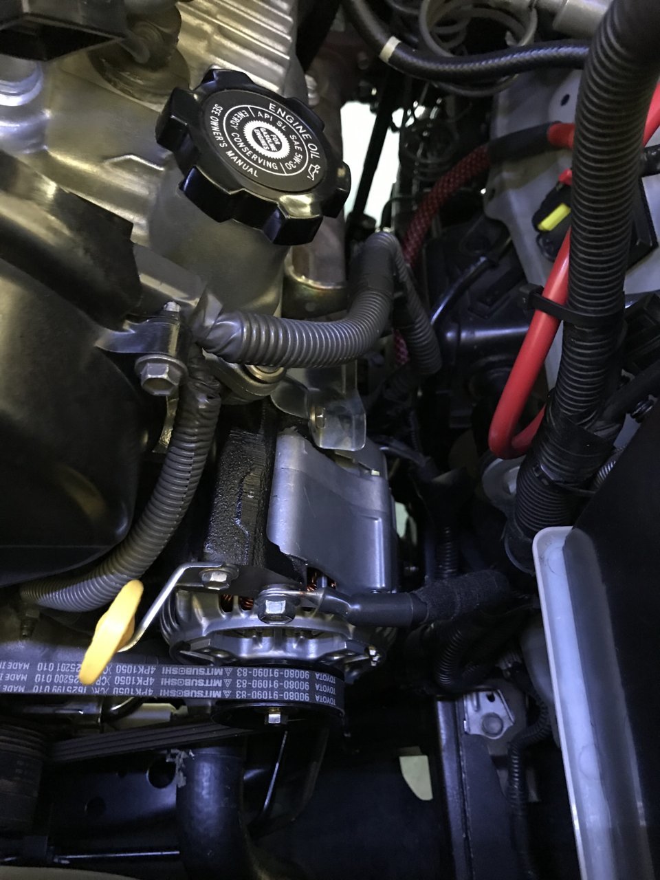

    Finally got around to installing the 105 alt. As stated in previous post it was pretty straight forward.
    I was prepared to drill out the adjustment hole but there was no need to in my case. The long 14mm bolt on front of the alternator fit and the bolt that screws to into the back (12 or 14mm) that you tighten once you have the belt adjusted fit.
    Also, it’s plug n play. I cleaned the plug with electrical cleaner and smeared some delectric grease on the pins and snapped it into the new alternator.
    I can’t really give a good comparison right now because I haven’t driven at night yet. I’ll post an update when I do.

    That is a clean engine compartment!

    Did you relocate the main block ground wire to the alternator bracket? Or is that an additional ground?

    That's an additional 4 gauge ground.

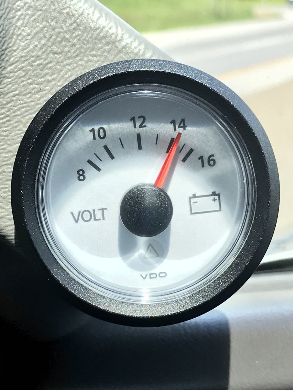

    Well so far I’m very happy with the swap. I took the below pics today while at a red light (turn signal on, brake lights, ac on, radio with under seat sub on).
    I mention the turn signal because with the original 80 amp alternator the VDO gauge needle would drop a little with each blink of the turn signal. Needle doesn’t move now.
    Also included a pic of the Ultragauge reading at the same time.

    you may want consider relocating that ground on the alternator to where the factory ground is on the block. It’s a good practice to have your grounds bond at the same location.

    Upgrading the wires/cables is normally a good idea. You just don’t want to be adding ground wires to different points of the vehicle especially in the engine bay. If you google star point grounding there’s a lot of good information on why.
