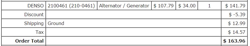

    I looked o Rock Auto and found these results: Suzuki Grand Vitara (2001, 2.7 only) or XL-7 2001-2004.

    Wow thanks, figured it was at least late 2000s
