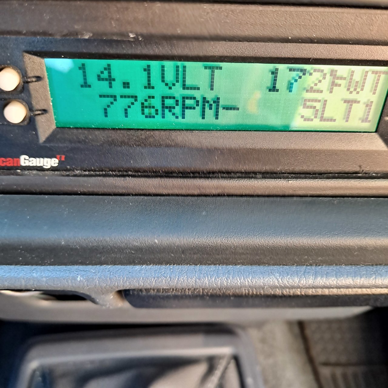

    Mmmmm
    Mine stays at 14.2 all the time

    My stock old alternator would hit 13 plenty of times

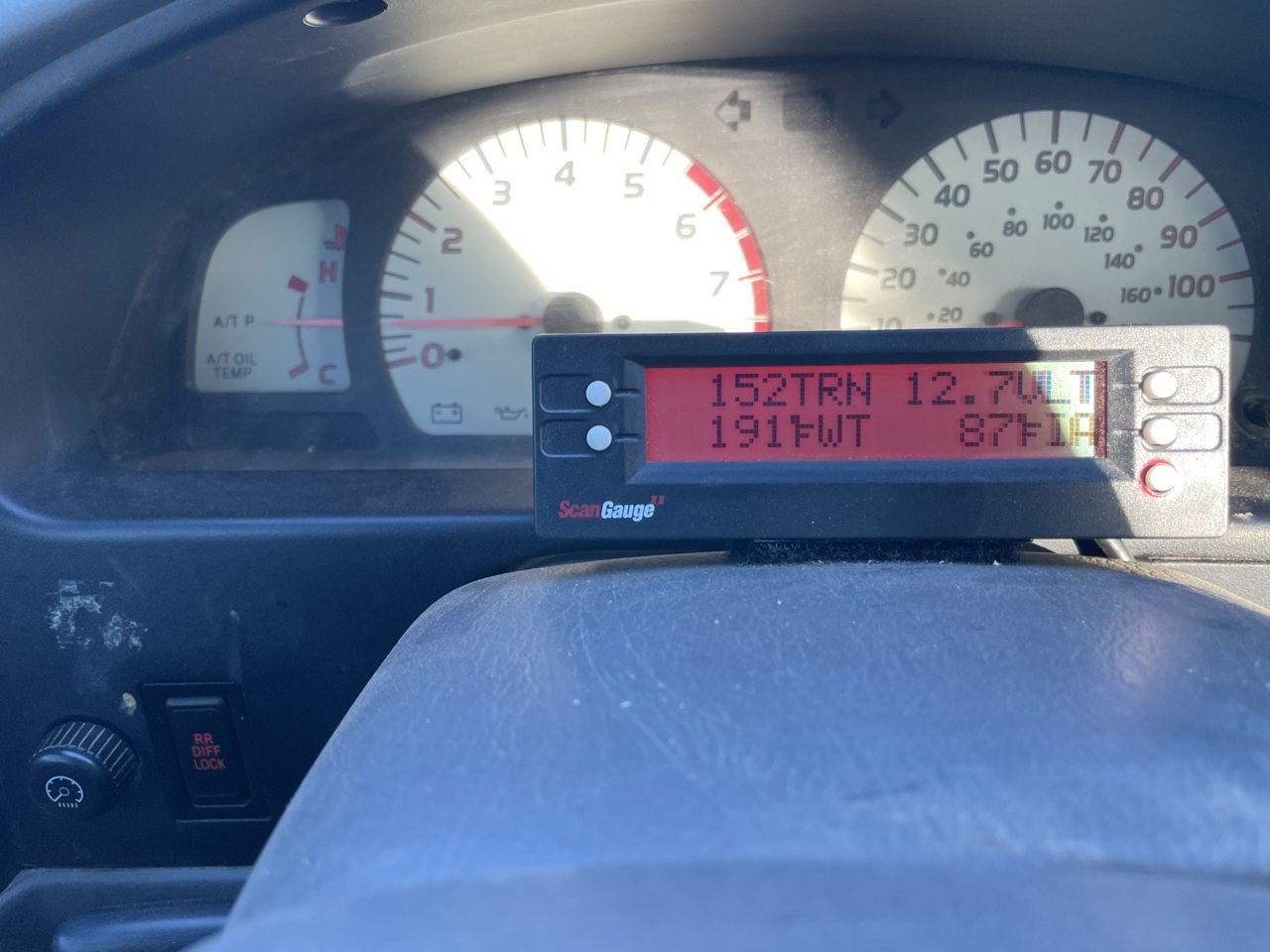

    So I noticed it starts to drop as soon as the RPMs drop below 700. Does your truck idle lower than 700 ?

    My truck idle is around 800rpms give or take

    My idle drops to 600-650 and the voltage drops after 700-750

    The voltage dropping to 13.5ish at idle once the trucks warm and the battery is charged is normal. Anything below 13 I’d say would be concerning
    you have a good battery for sure? Has it been tested for a bad cell? All connections are solid? There is also the possibility the alternator is just weak.. warranty that one out maybe? A lot of variables exist

    Battery is good newish 2x power agm . I didn’t have this issue pre big 3 upgrade it was always 14.2 volts but I’ve gone through every connect to double check i don’t see any issues. Not sure what could have changed

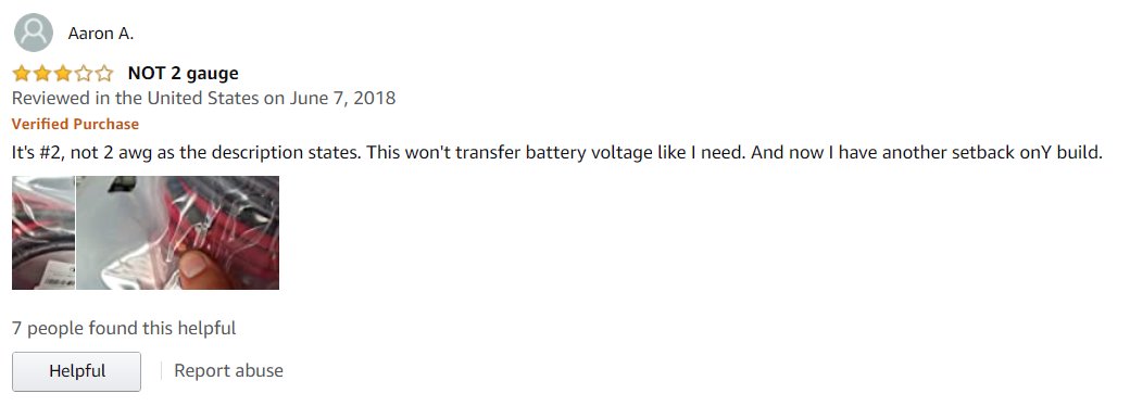

    any suggestion on a voltage booster?
    here’s the wire I used
    https://www.amazon.com/dp/B0167K7DO2/ref=cm_sw_r_cp_api_glt_fabc_80PT6NM3S39ZDMX054JJ?_encoding=UTF8

    That statement isn’t true though right?

    I saw the 'voltage transfer' and just jumped on it :anonymous:
    Yeah, you're right. lol. I still like to read all the shit reviews. Still, you never know when dealing with Amazon or Fleabay. :notsure:
