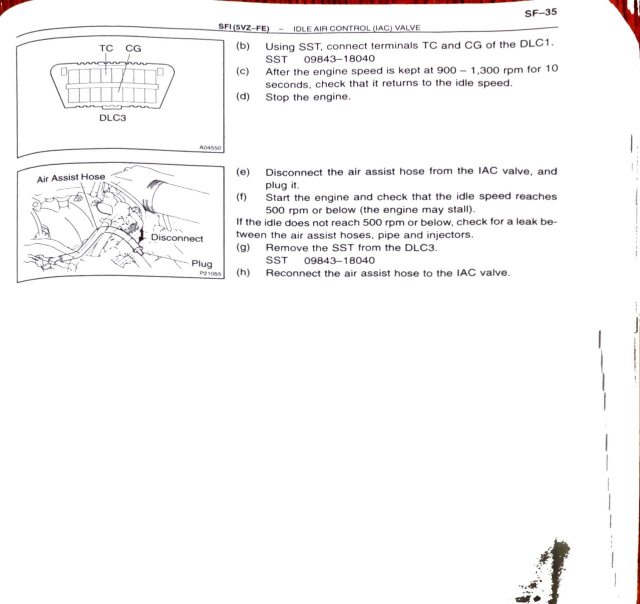

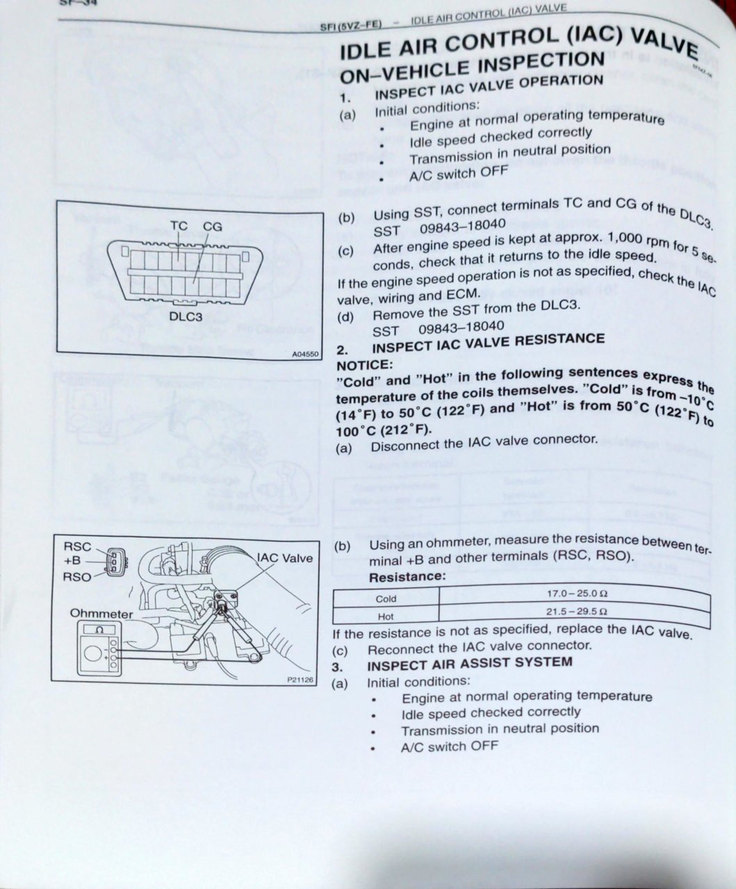

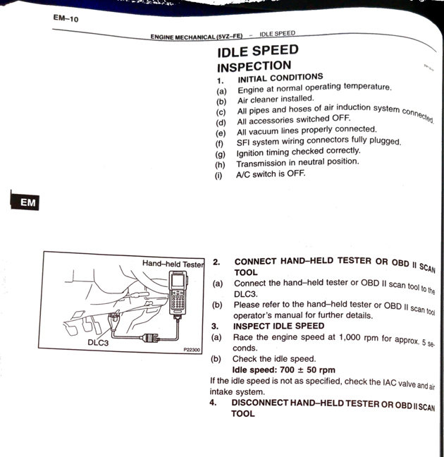

    I think yours is pretty close if it's hovering about 650 after warmup. Says spec is 700 + OR - 50

    Yeah following those step, my idle is spot on. Around 709

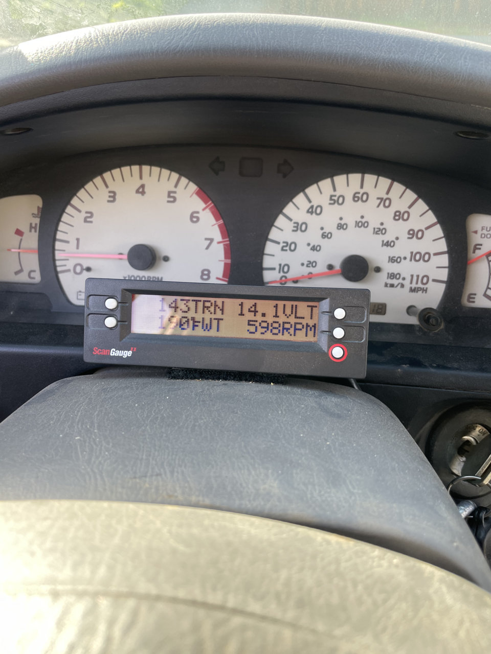

    Concord, California
    2004 Tacoma ext cab TRD 4x4
    CBI sliders, ADS extend travel with compression adjuster coil overs, 9” Bilstein 5125 rear shocks, Icon Tubular UCA, Alcan custom leafs, All Pro Apex bumper and skids, NWTI rear diy bumper, 295/70/17 Cooper St Maxxs and nitro 4.88s.
    I think it might be fixed, just took it out and got it warmed up and it steady above 14 at idle. I wonder if it could have been the dielectric grease causing connection issues. D047AFDB-7600-46D9-8E65-640AA701E9F1.jpg

    I put it on after, but from my reading it can cause resistance on direct connections. So I think the additional resistance and the low rpms I was getting a voltage drop

    Ah took it for a bit of a longer drive today and it started doing it again the drop again. I’m starting to consider returning the alternator and going with the Cs144. Maybe I’ll just run it for a while?
