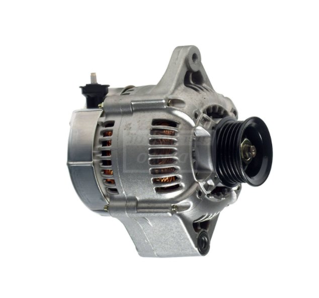

    Did anyone ever install this on a 3RZ? My replacement OEM alt has started to fail after 3 years (original lasted almost 20).
    I'm only reading 13.3v at idle and can watch it drop off and on.

    Also curious. Will this work on the 2.7l?

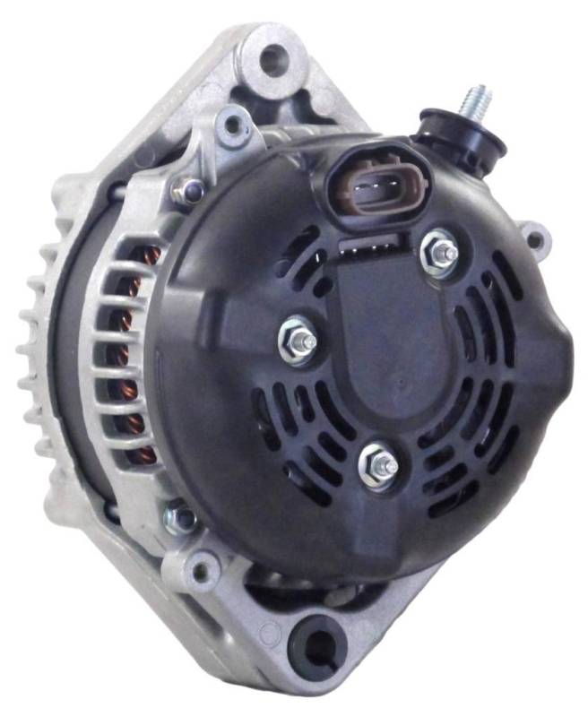

    Orientation and plug look good. Need to swap pulleys and probably add a spacer to the bottom wedge as it doesn't look as wide as the stock alt.

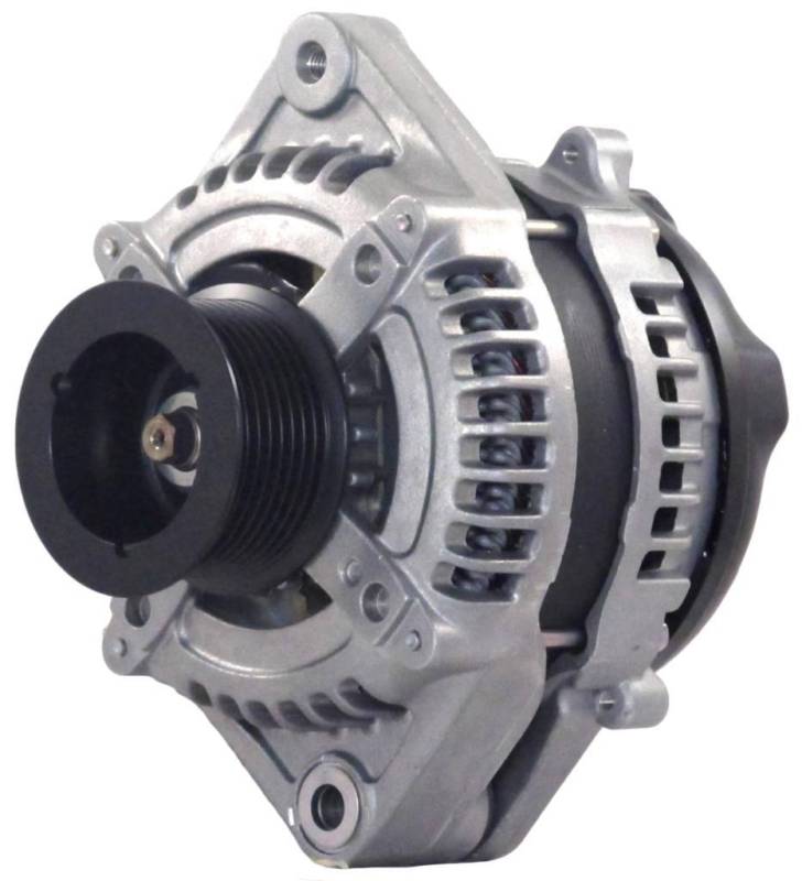

    Did you ever end up finding a decent fuse? If I remember correctly, your alt to battery wire is 6 gauge, right? I’m wanting to do the same setup but having a hard time finding a 120A inline fuse for 6 gauge cable.

    Recently finished upgrading to the 105amp alternator and so far measurements are looking great (Thanks OP!)
    Now that I’ve improved the charging system, what do people recommend for a choice of battery? Eventually I’ll need to get a new one and I’m wondering if it’s smart to get a better battery or just stick with the regular 24F-DL.
    Currently I’ve got an aftermarket stereo system but I’m also wanting to get some extra lighting.

    Any 24F AGM battery should suffice and it fits perfectly.

    So is the denso one op used the biggest denso amp i can put in my 97 3rz?
