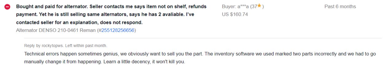

    Unfortunately this denso alt is still on back order. :rant:
    Wanna sell it? :p
    Area51Runner[QUOTED] likes this.

    I checked this morning. They have several that will fit but none of the 105 amp densos.

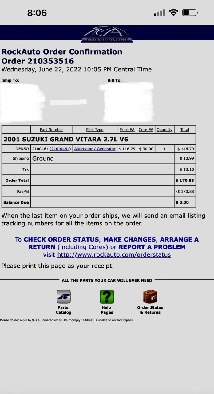

    Keep looking, one will pop up soon! I’d check first thing every morning and when it popped up I couldn’t believe it! A lot of the online ads show when stock is projected to be replenished.
  12. Jul 9, 2022 at 11:57 AM
    #392
    packman62
    packman62 Member
    May 20, 2022
    #397601
    23
    Mesa, AZ
    1999 White Tacoma Pre Runner Ext TRD
    I was able to order the 105 amp alternator on June 22nd. Their website said they were projected to have stock on the 23rd.

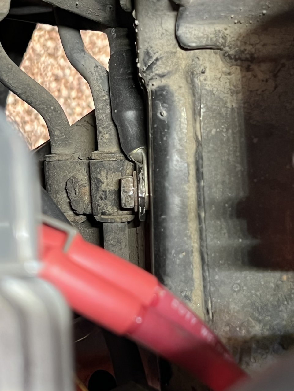

    Where on the block did you put the ground? I just need to make that cable and i can put a new battery in and start it up.

    Here is a top down photo. I just used an existing bolt/bracket to ground the negative cable to the frame. I just put the skid plates back on or I’d get you a picture from below.
    Hope this helps!
