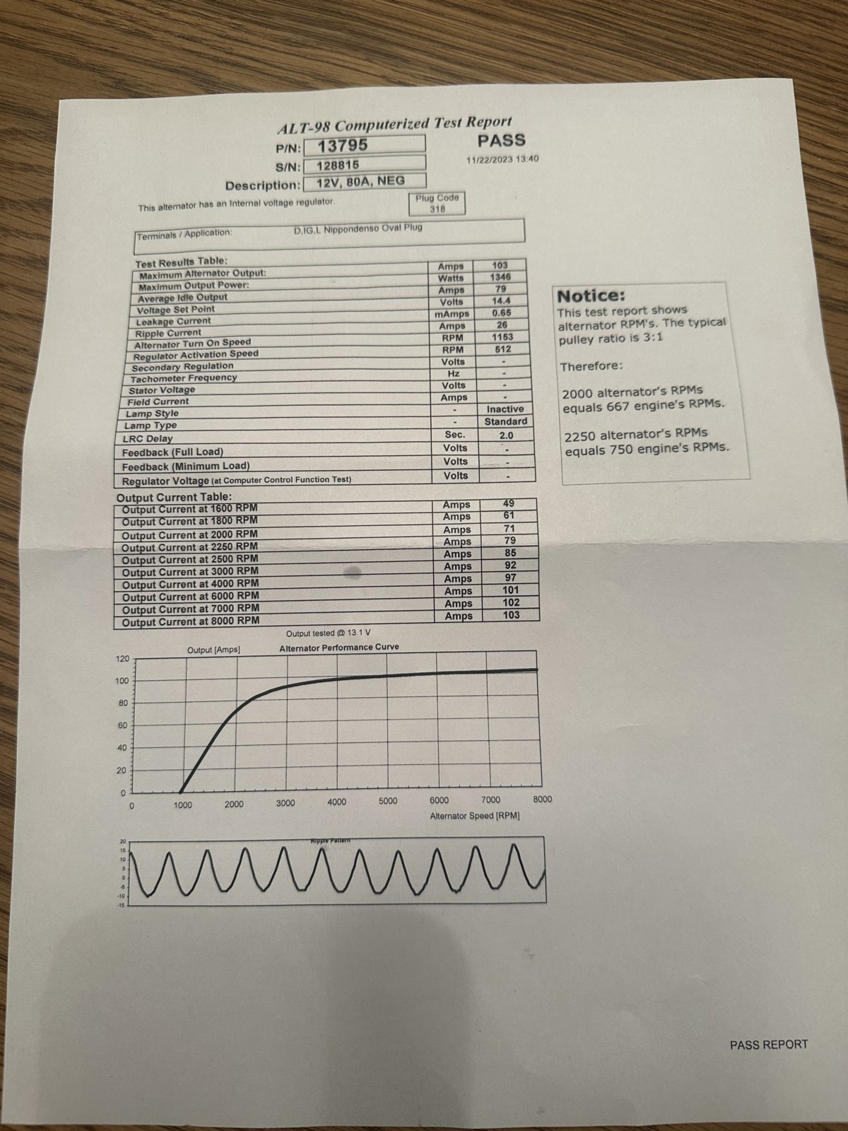

    Does anyone know if Denso’s 105A rating is peak or at idle? A local alternator company sold me this unit as a direct replacement for 210-0461, but the description on the test sheet says 80A… Looks like 80A at approximately engine idle speed and close to 105A at cruising speed (report is at alternator RPM, not engine RPM).
    is this a comparable unit or lesser than? Thank you!

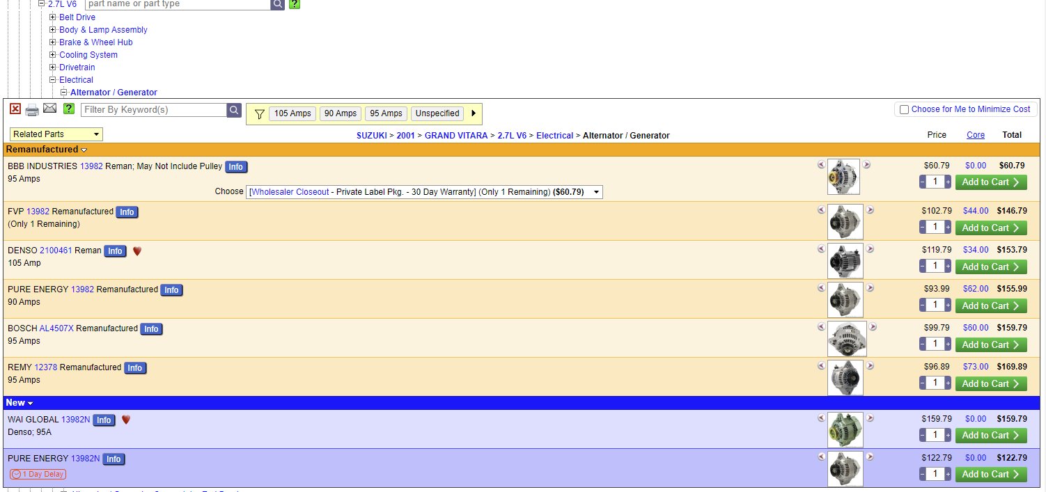

    Has anyone purchased a Denso Alternator recently? I'm looking at RockAuto and the only options list for the 105amp is a remanufacturer for the 2.7L V6 Grand Vitra, all the old links appear to be dead. I'm looking to add in a large house battery for a cabover camper shell so this is the first time I've really looked in to alternator upgrades.

    I got mine a few months ago, looks like they still have stock. P/N 210-0461
    https://www.rockauto.com/en/parts/denso,2100461,alternator+/+generator,2412

    Usually they are rated at peak, usually around 2500-3000rpm

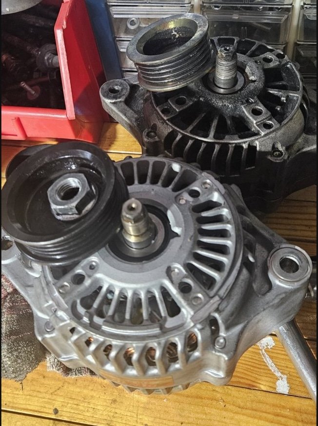

    Hi, guys. I have a 1997 2.4L 2RZ. Based on this post, I went ahead and bought this Denso model off of Amazon. When it came it, there were several surprises. The sticker on the unit did have the desired part number - 210-0461
    However, I expected the post to have a different orientation to my stock one. It did not. It was in the exact same orientation.
    I expected to have to bore out the ear hole - but did not have to - my bolt screwed right into it.
    Those surprises were weird, but not showstoppers.
    The last surprise was.
    Thankfully, before I did all the work installing it, I took a close look at the pulley. The one that had been on my engine had 4 ridges. The 210-0461 only had three. My belt wouldn't work and it didn't match any of the other pulleys on my engine.
    I tried to swap pulleys, but the shafts are shaped differently, so that wasn't possible. I thought I would stop screwing around while I was still ahead and had a returnable alternator!
    This is my first time messing with this engine, so I don't know what the hell's going on. Any thoughts?
    Did my engine come with the wrong alternator and somebody changed all the pulley to fit it?
    Or did Amazon send me a misnumbered part?

    Somebody swapped alternators and returned it.
    My first one from Amazon had a CarQuest sticker on it, not Denso.
    Returned it, bought another and got the right one.

    I’m pretty sure the 4 cylinders use a different alternator from the V6, so this mod shouldn’t work for any 4 cylinder trucks.
    I swapped a Jaguar XJ6 alternator into my 3rz and just used a harness to adapt to the stock plug.
