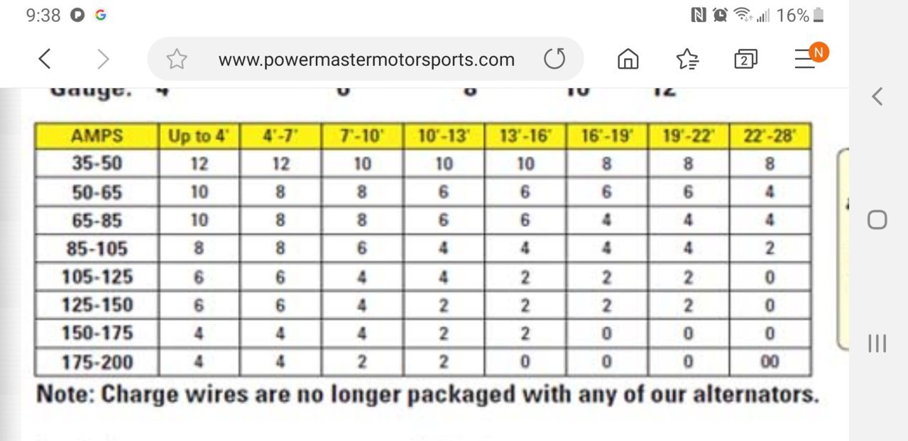

    As near as I can figure, the factory alternator wire is a 10 gauge. According to powermaster the minimum for a 100 amp alternator is 8 gauge so I may do that. Screenshot_20190923-213851_Samsung Internet.jpg

    you should be able to make 8 gauge fit in the factory loom if you really wanted and keep it factory looking
