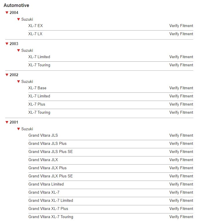

    Hey @chagovatoloco I have a question: do you think you could look in your parts catalog there at work and see what year(s) and engine types on the Vitara take this alternator?
    Some of us who love to have a reason to hit the salvage yard might find a used one.

    Just make sure it says 105 on it or cross the number on the alternator, some of the Grand Vitaras are 80 amp and other 105 amp.
    The OE number you want is 31400 - 52D00.

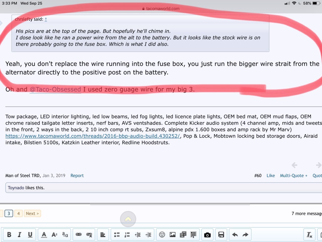

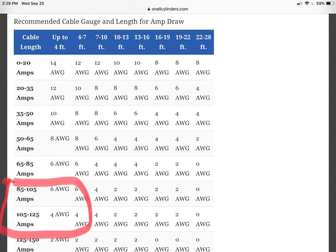

    So I looked to see what options there are for the increased amperage and what might be needed if anything.
    Essentially from what I found it says that all you need to do is upgrade to a thicker wire gauge 4 or 6
    and run it directly to the battery from the alternator and the same with the neg side as a ground strap.
    Is this all correct? If so this is pretty simple.

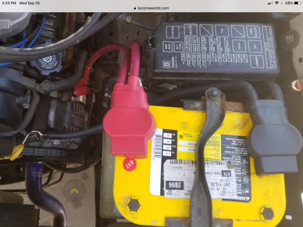

    Where the second big red wire going? In the last pic

    Starter.

    The factory wire is pretty small, so going to a little bit bigger wire may not be a bad idea. I found some 6 gauge in my garage so I'm going to go with that, but don't over think it.

    Fuse box?
    fuse box?
